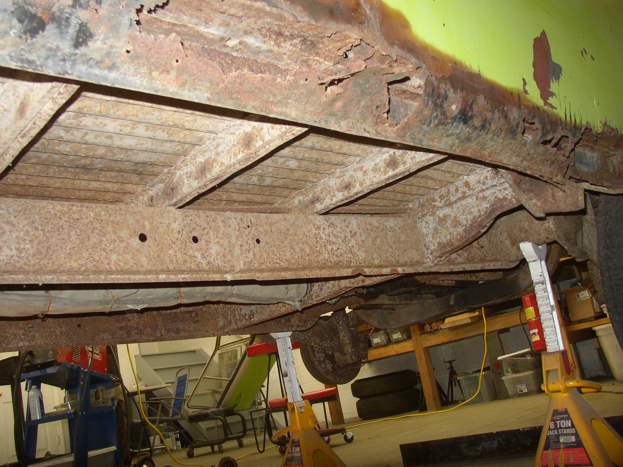

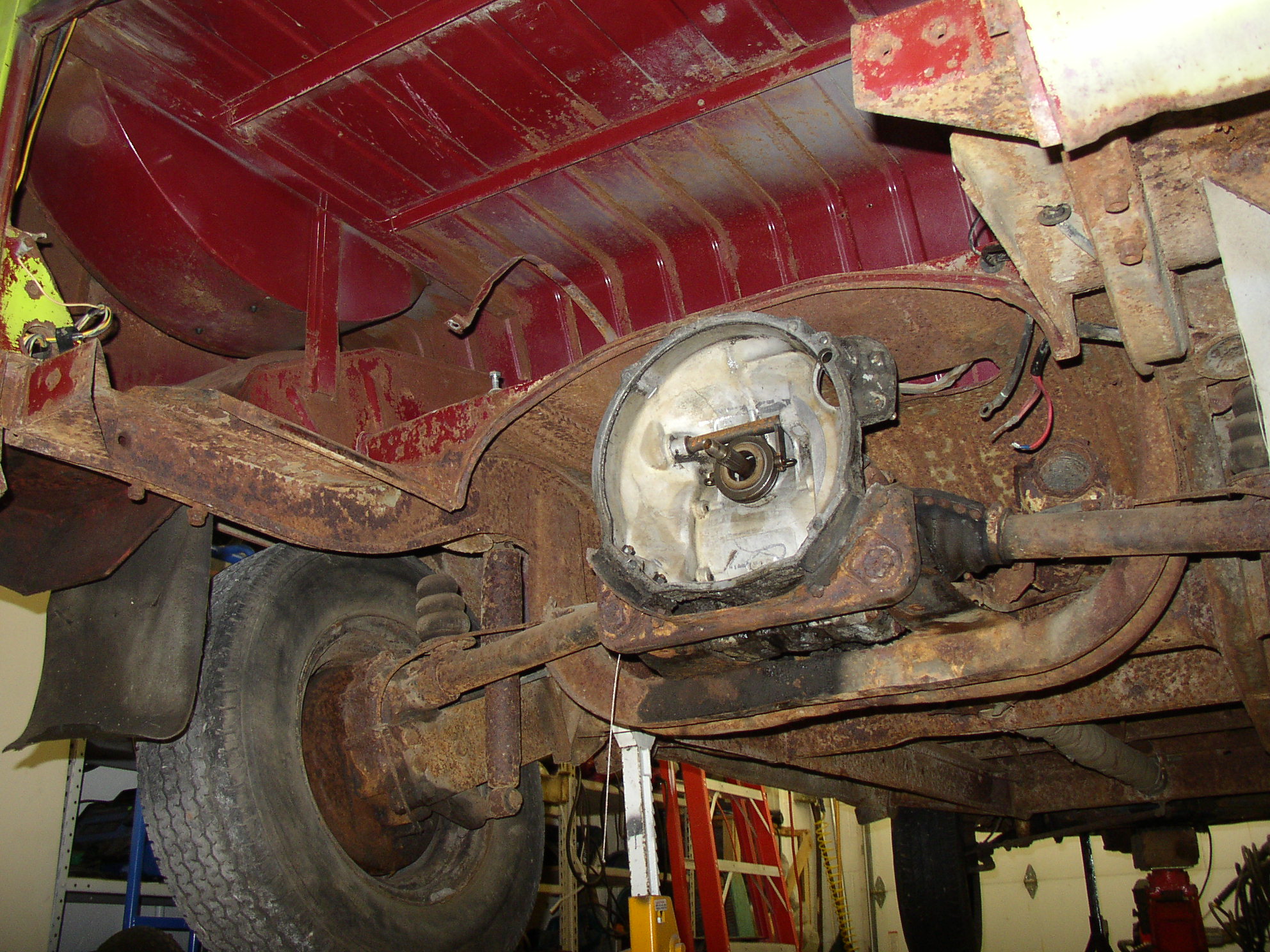

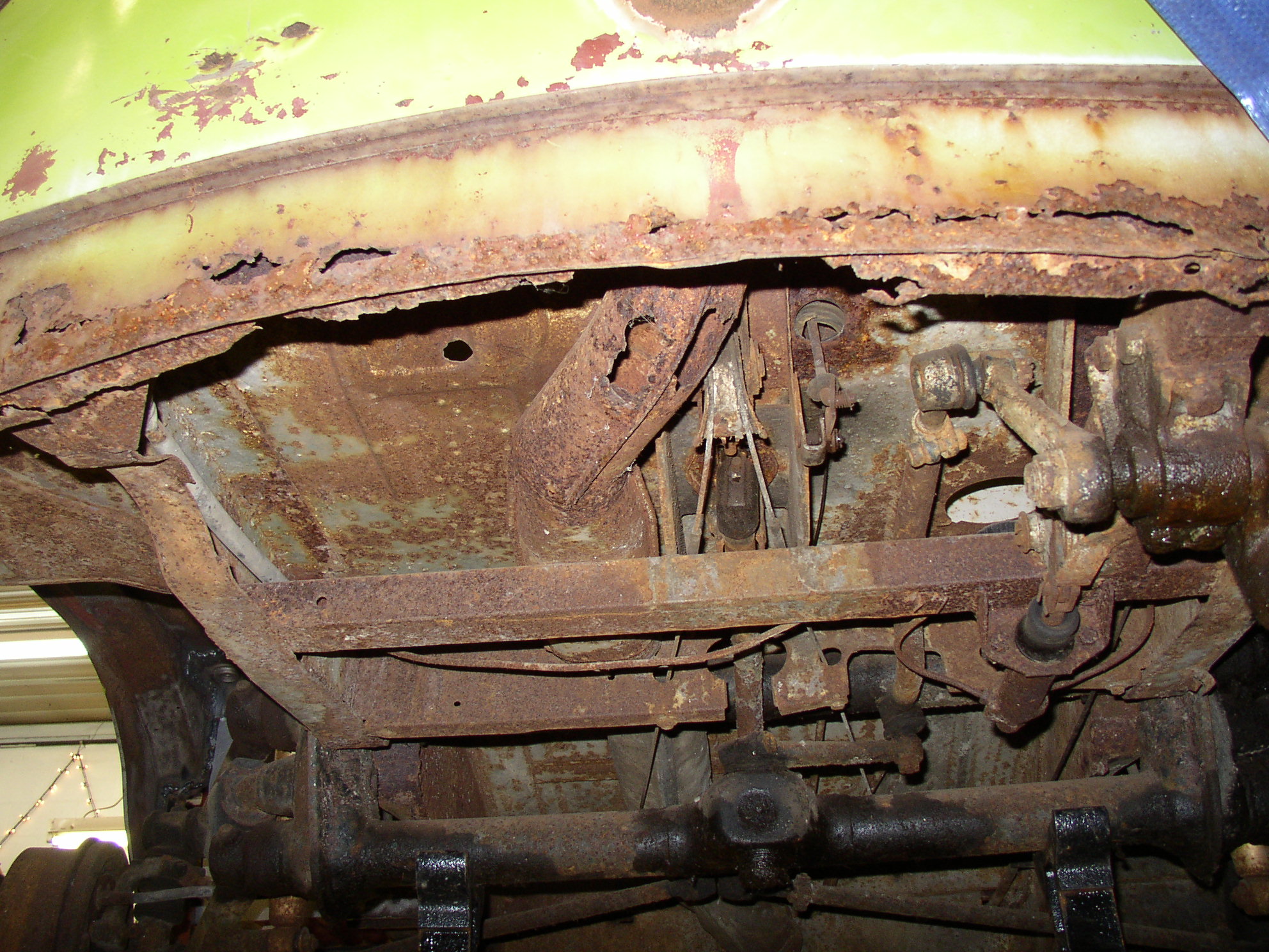

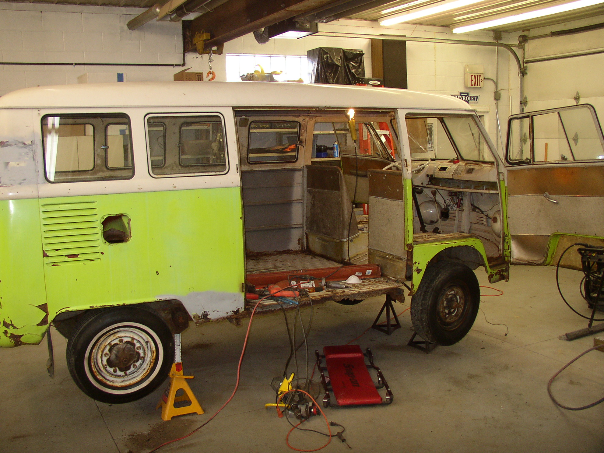

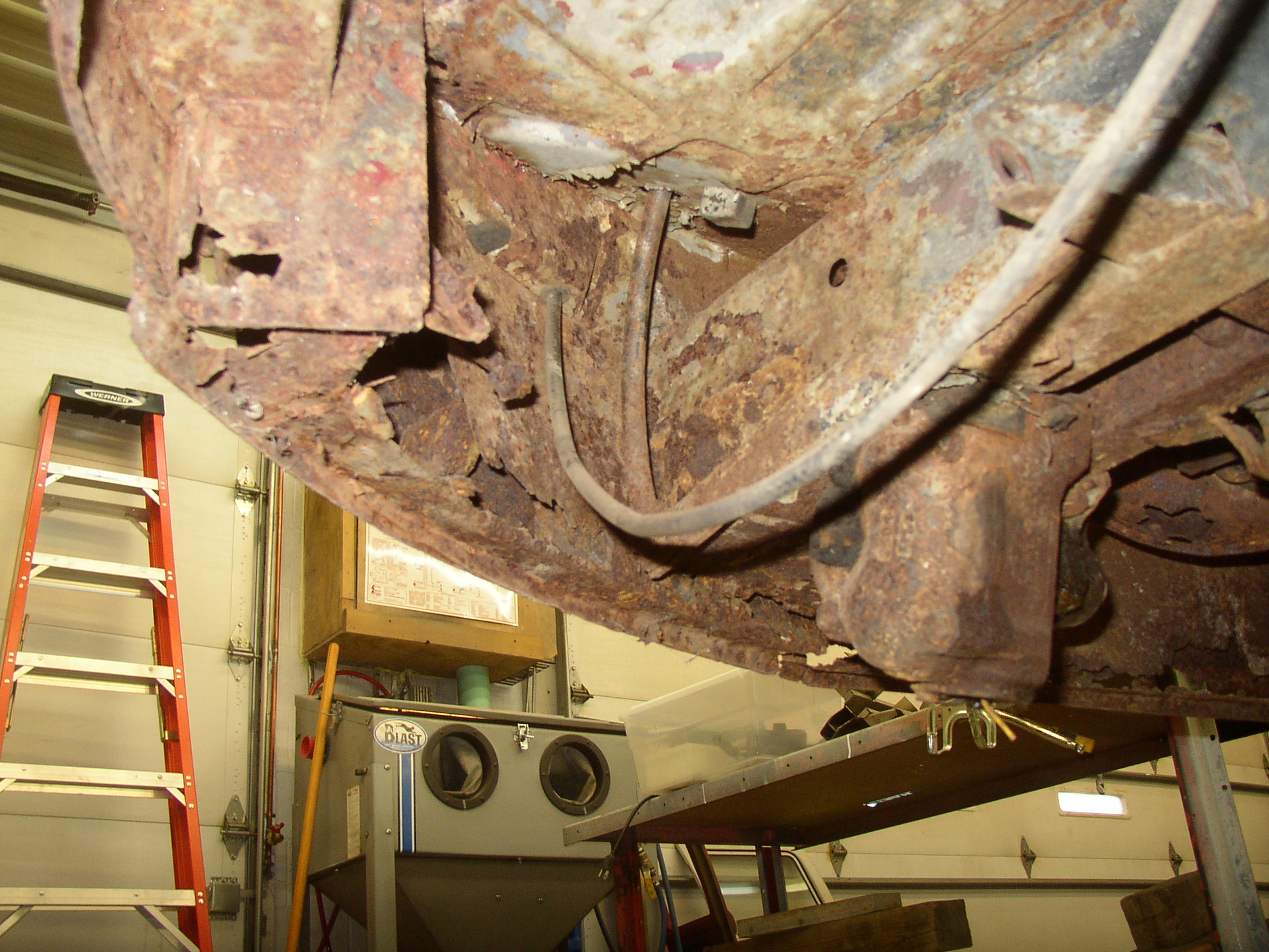

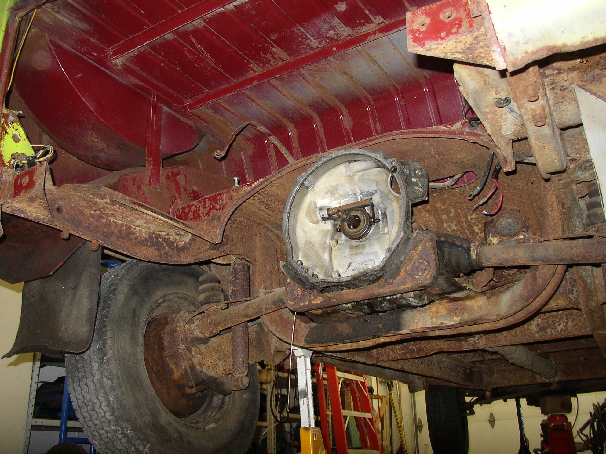

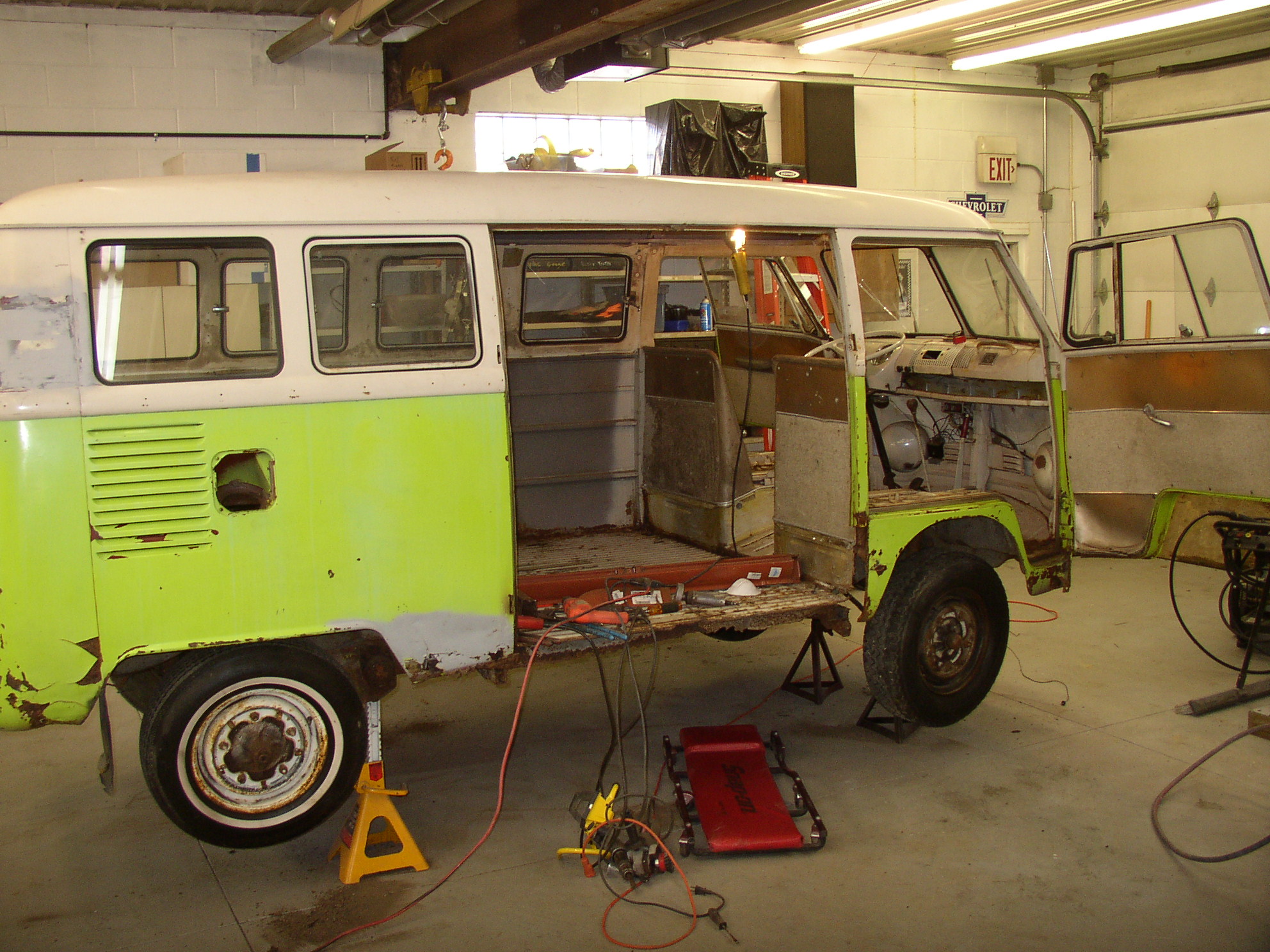

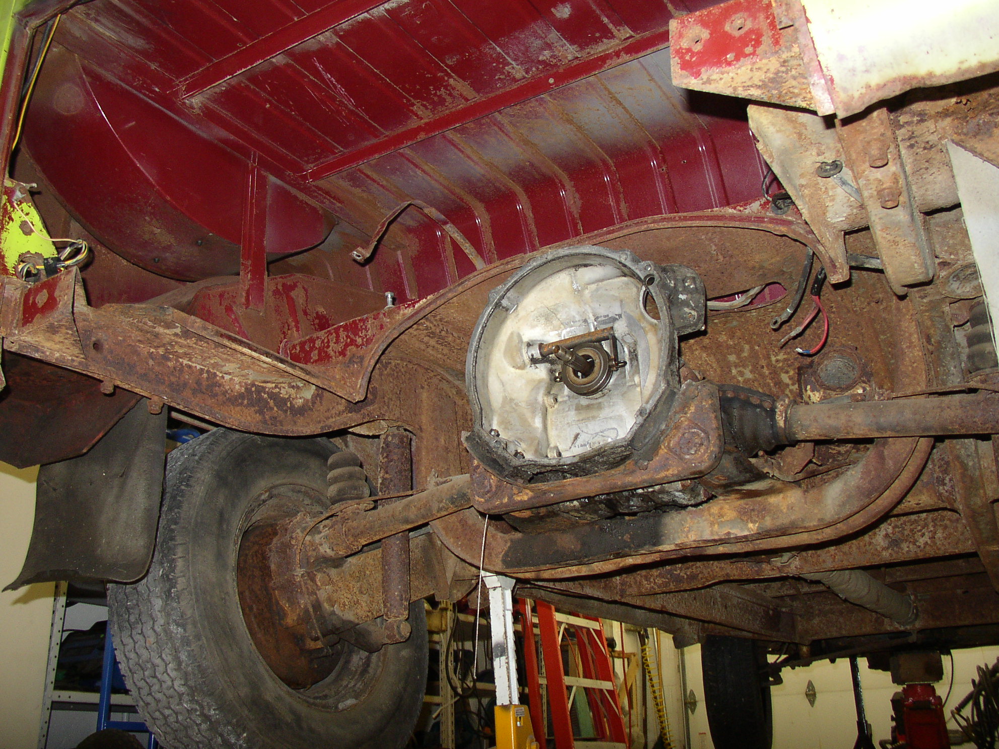

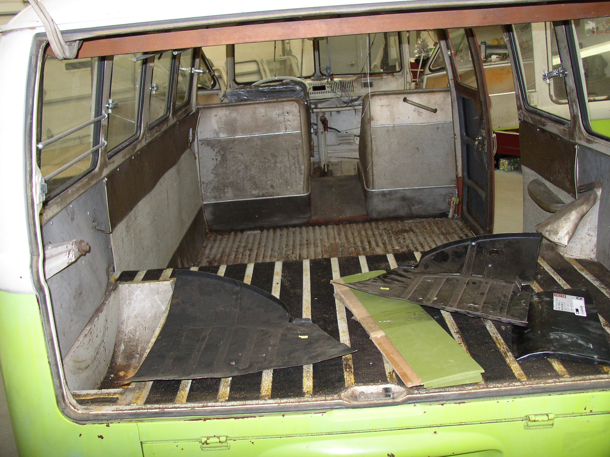

I've got it jacked up, stripped the interior and removed one outrigger today which went smoother than I thought. On closer inspection I'm pleasantly surprised with how good the bottom looks overall, there's nothing underneath that's going to be a tough fix. I shot a ton of pics but they're in my camera at the shop. This should be 6v, right? It "appears" to have a nicely done 12v system in it and I'm wondering if any '66s came with 12v. The 12v regulator and wiring "look" OE to me.
I'm wondering if I can put a '67 harness, TS switch, dash junk and clock into it and convert fully if it's not already. The PO didn't know anything about electrical details but it has a 12v reg and bulbs in it so far. Sorry, Sean!

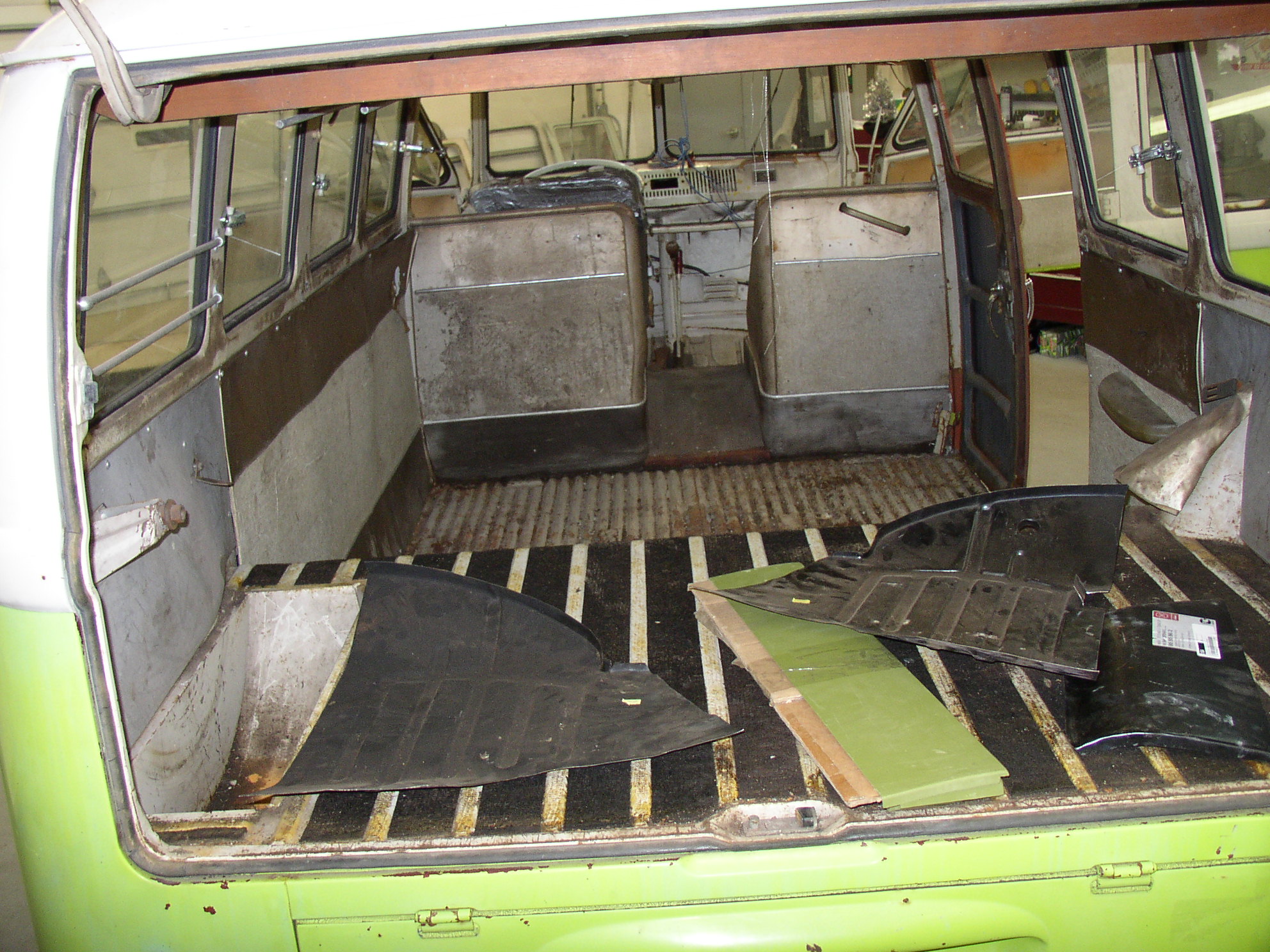

Deluxes have headliner cloth glued to the inside walls around the windows.
Does anyone have any tips for getting this glued-on headliner off the inside walls of the bus? It's glued on there with some ungodly strong stuff!

No need to switch the harness for a 12V conversion 66 and 67 are identical. On a 66 it had a large diameter 6V generator and the reg was mounted on the right side wheel well just like a 67.
Things you need to do it properly
67 only wiper motor - 2 speed with park.
9 pin turn signal relay box - used in bugs and bus till 69
headlight hi/lo relay - it's a cycling latching relay
regulator off the fuel gauge from a 68 and up bug or bus - not really needed but it will make it last longer and be more accurate.
The clock will need a small dropping resistor. The fusible link inside is probably bad and just takes a bit of soldering to repair.
All the other stuff is common bulbs and engine stuff. Do make sure you get 5w lamps for the dome lights, the common 10w bulbs will melt the lenses.
12V systems were optional on 66 transporters. As far as the headlining material glued to the side walls :lol: :lol: :lol: , Razor knife and a putty knife and a DA and lots of DA paper and a couple days.

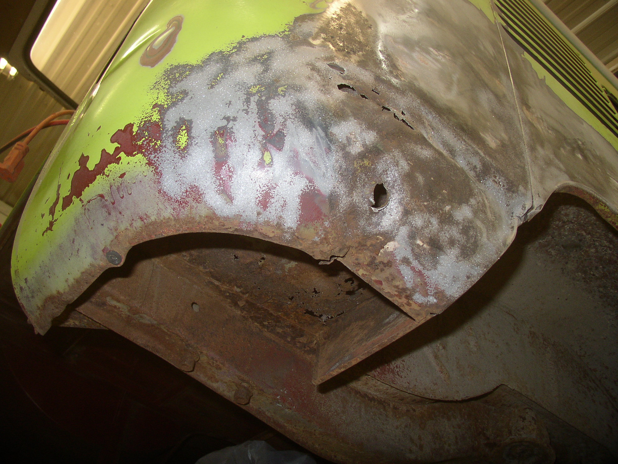

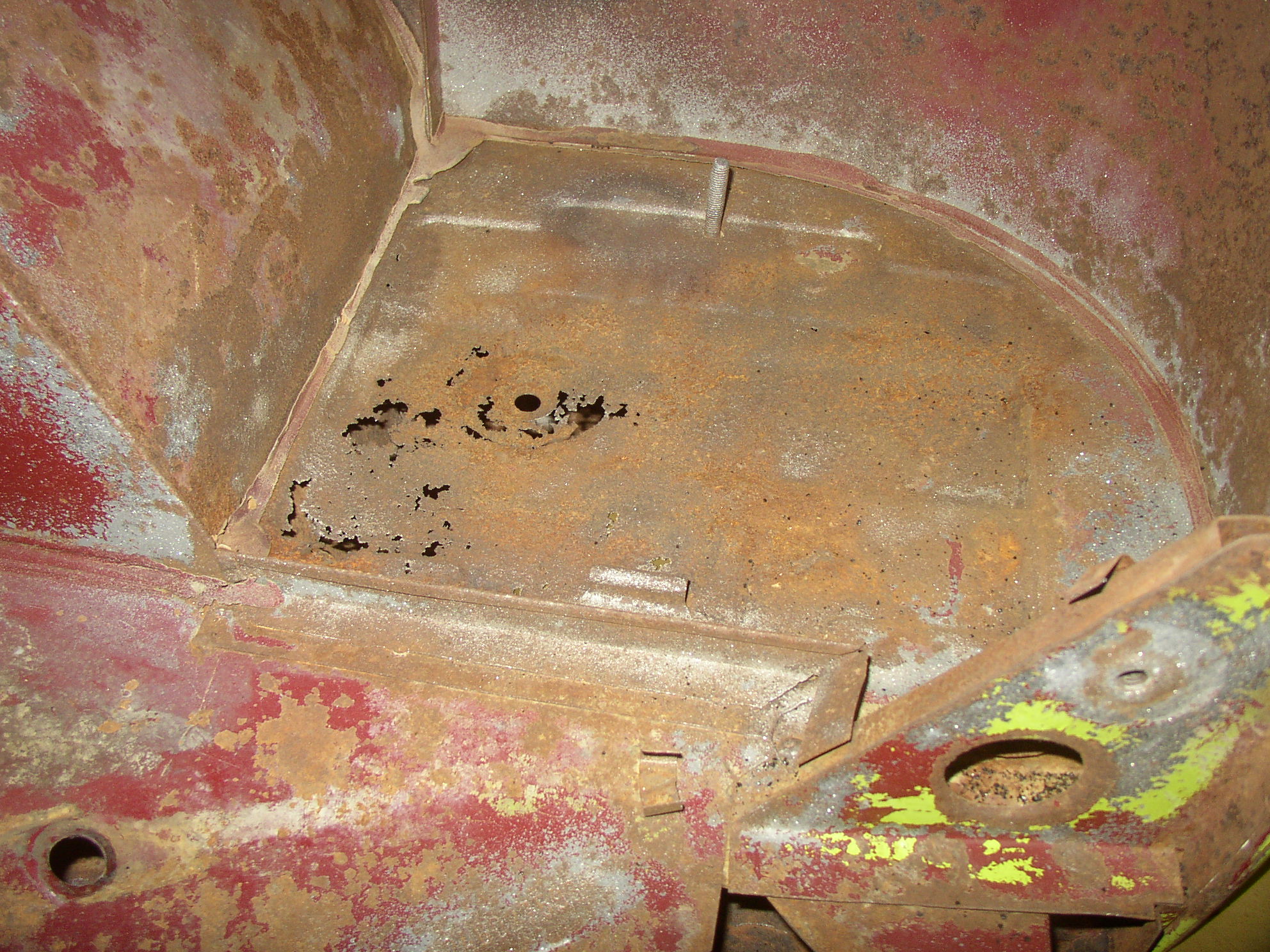

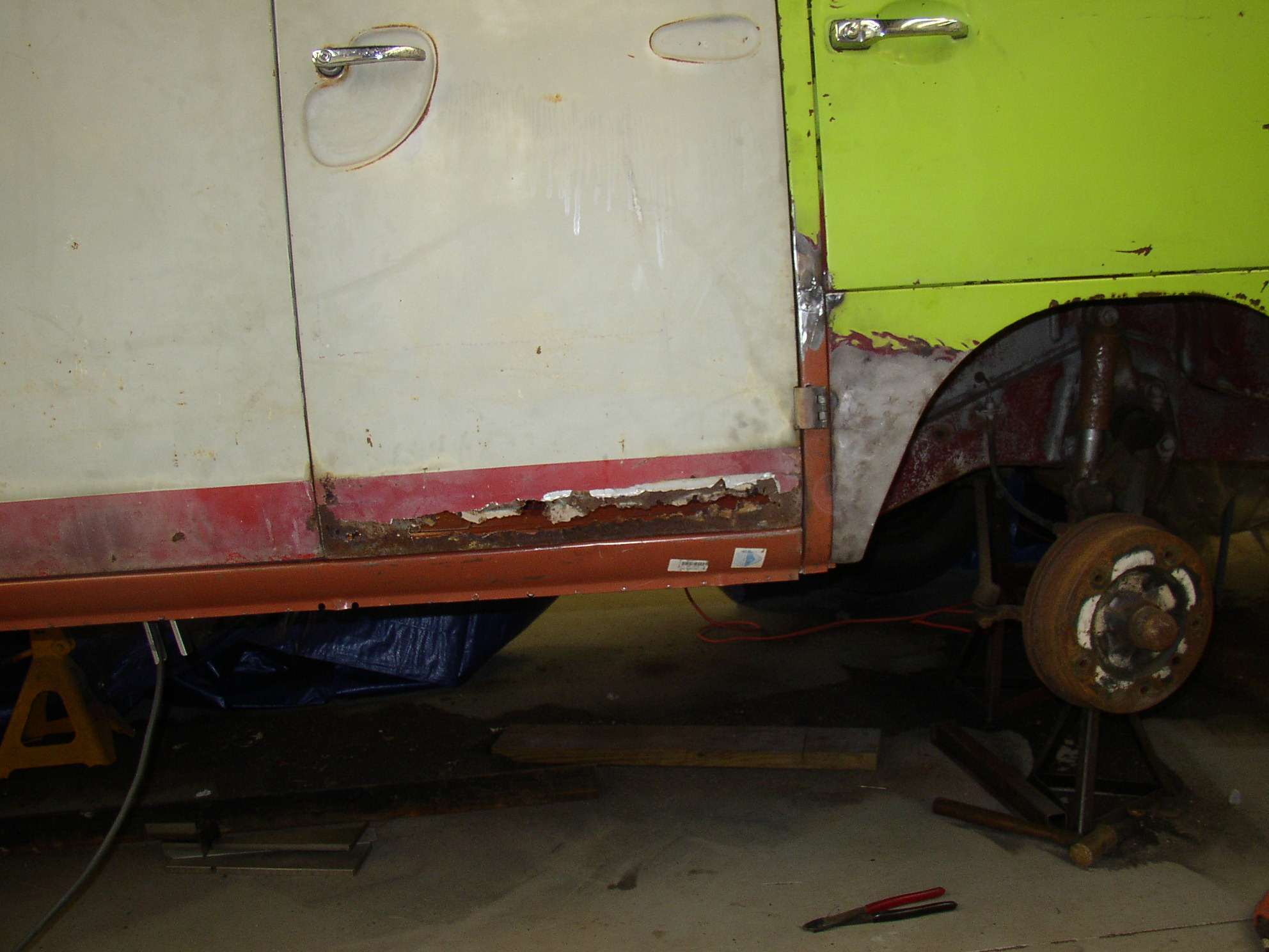

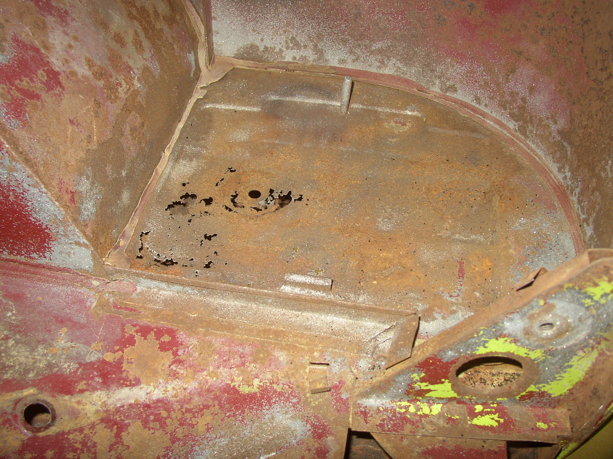

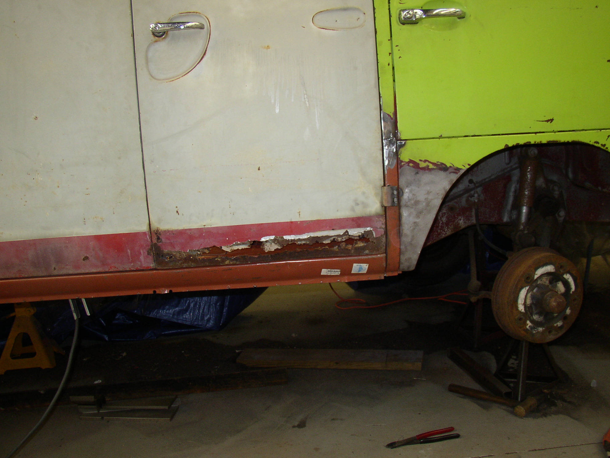

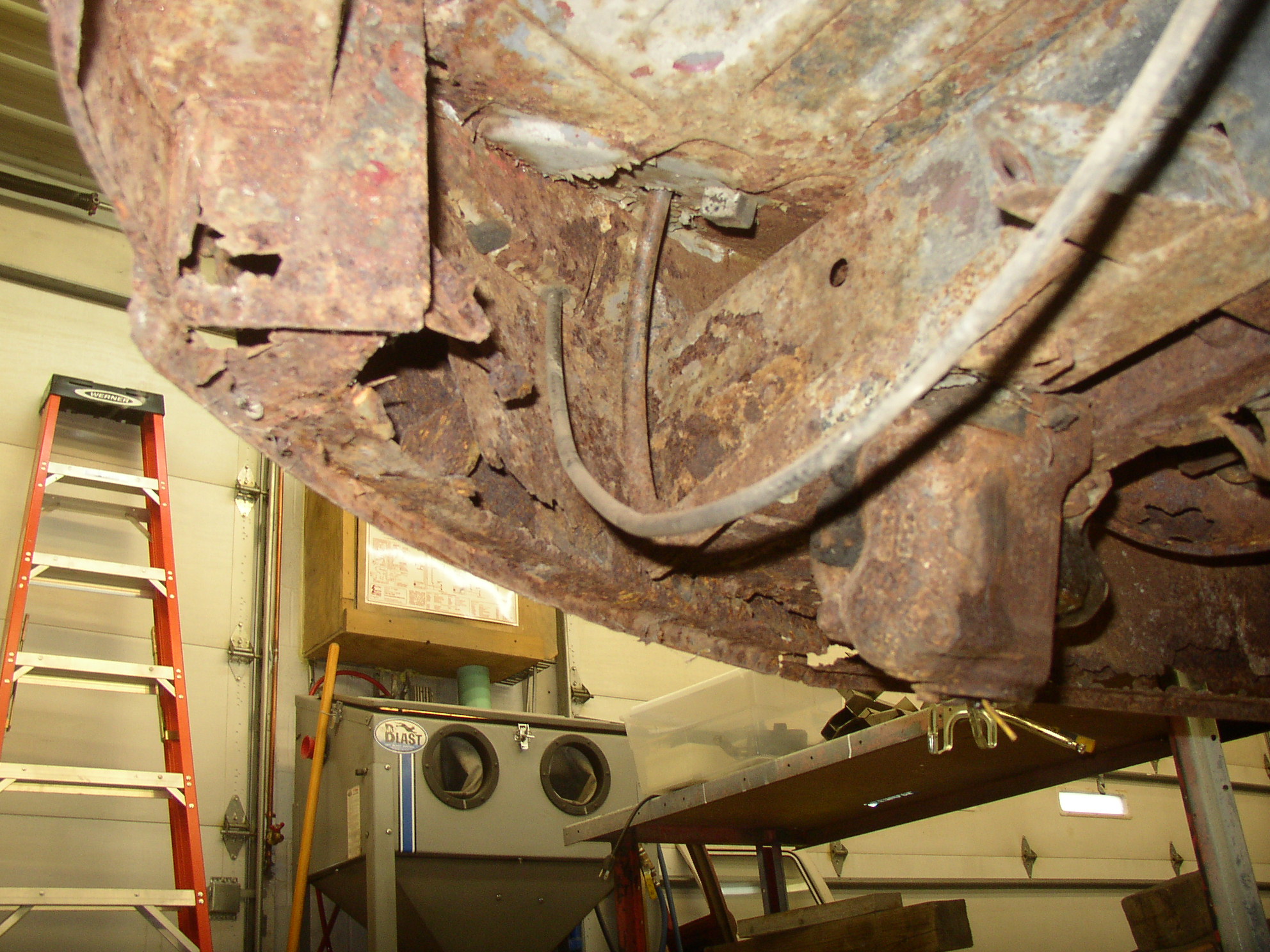

It needs rockers, some floor patching but not the whole floor, and outriggers. Roof is virtually perfect, all side window frames are perfect but there is some rust under the windshield. Nose and the rest of the body has almost zero impact damage, only a couple of small bruises that are easily repairable. This is a very restorable bus and will go back red and white, originally titian red and beige.
