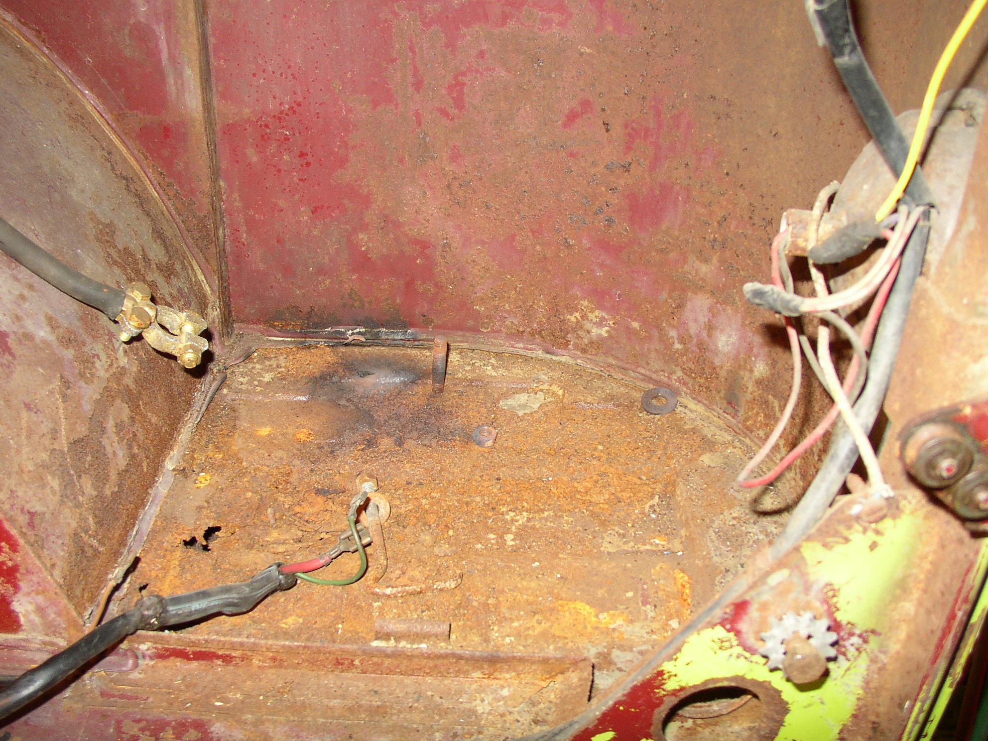

I cleaned the bondo off the RR corner to see what it needs, I ordered a corner for it. The LR is not rotted at all, the reason this one rotted was the shitty repair job done decades ago when it was hit lightly there.
Even inside the battery tray area doesn't look horrible after sandblasting.
There was a mudflap screwed here with 3 sheetmetal screws. Is that OEM? The screws came right out, maybe that's what saved the corner.
It's getting a new tray, of course, along with the corner.
