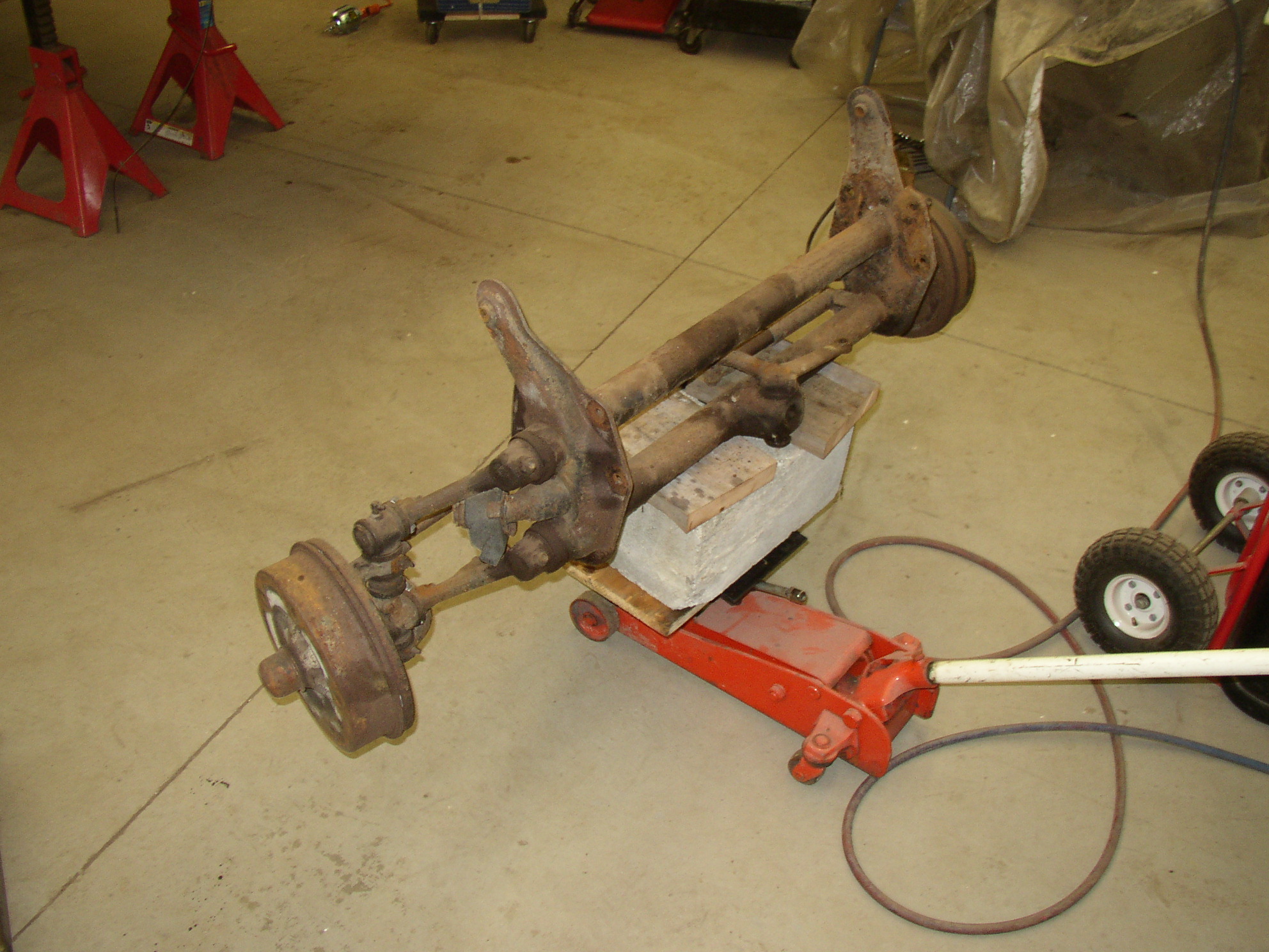

I wanted a little change from cut/grind/weld/grind/cut/grind/weld, so out comes the axle. I'm surprised that nothing is very loose on it. KP's, LP's, tierods, etc, are all tight. Pivot thing in the middle has only a hint of play so I'm going to leave it alone. Left brake backing plate is bent somehow. Wheel bearings are f'ing toast, but the drums have never been cut. Drag link is about ready to fall off, I bet this was a real trip to drive the last time it was on the road- the dude would have been dancing with the steering wheel a half turn to keep the bus headed straight.
Fugly!

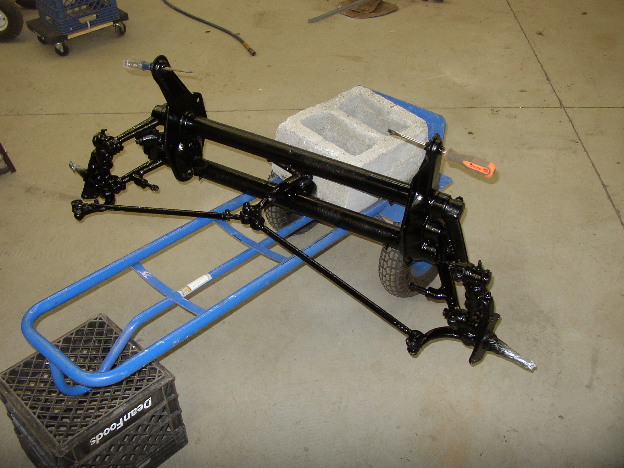

I pressure washed and sandblasted the front axle out in the yard.
I mixed up a cup of paint/hardener and shot it.

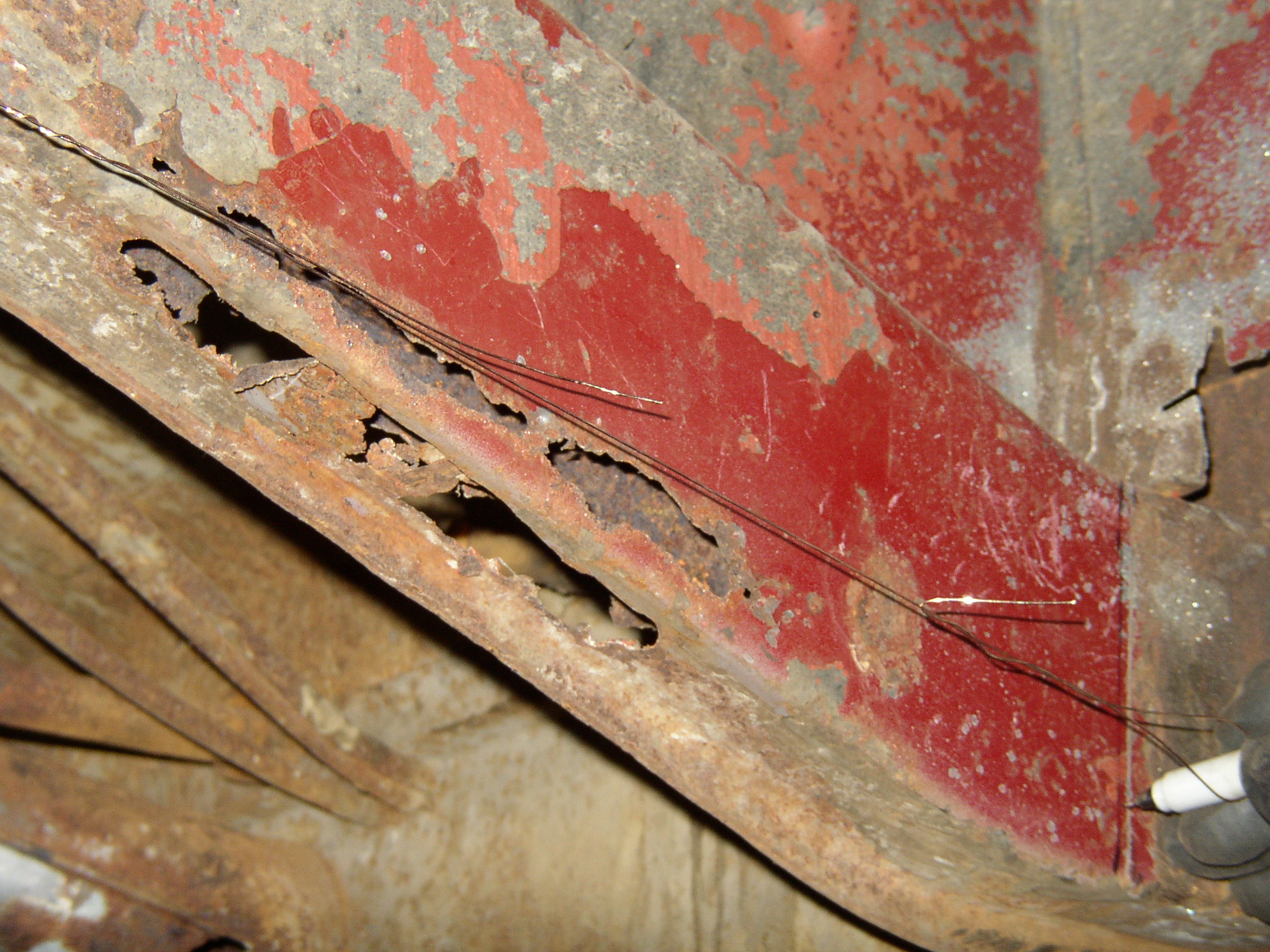

Both front frame rails show a bit of rot right behind the axle beam, but only after you poke and prod.

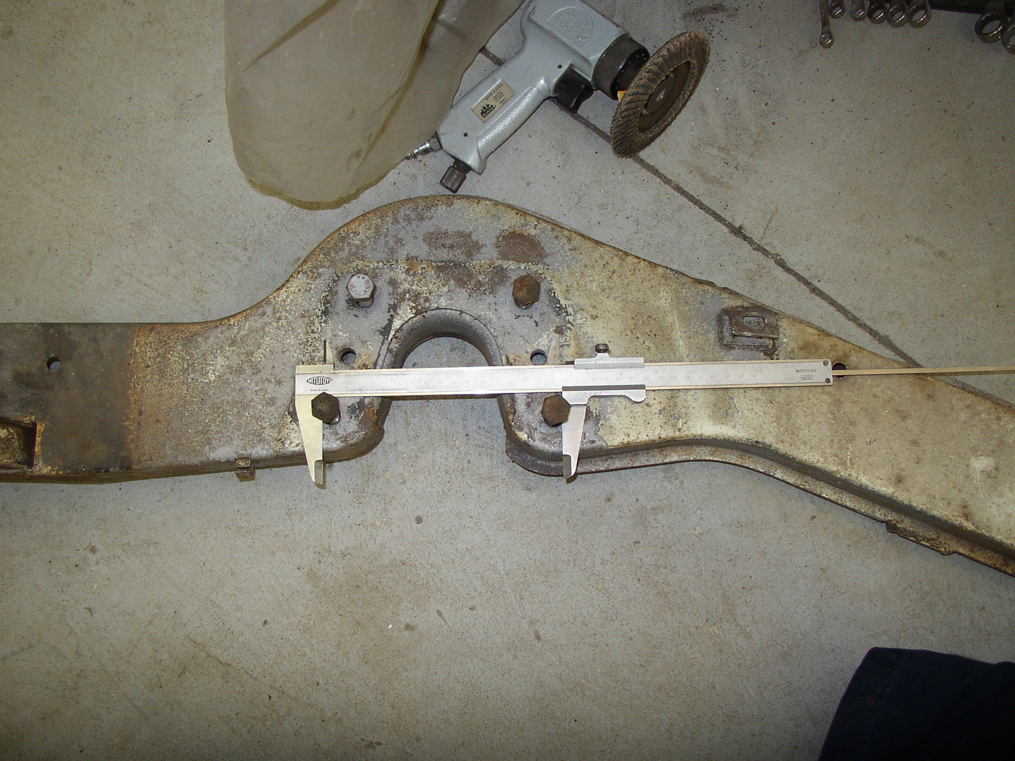

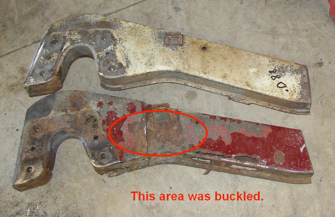

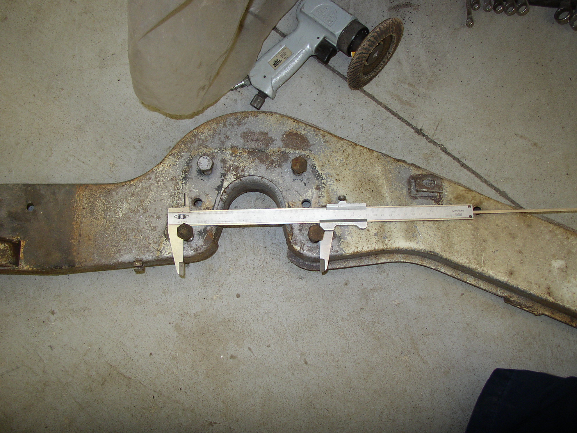

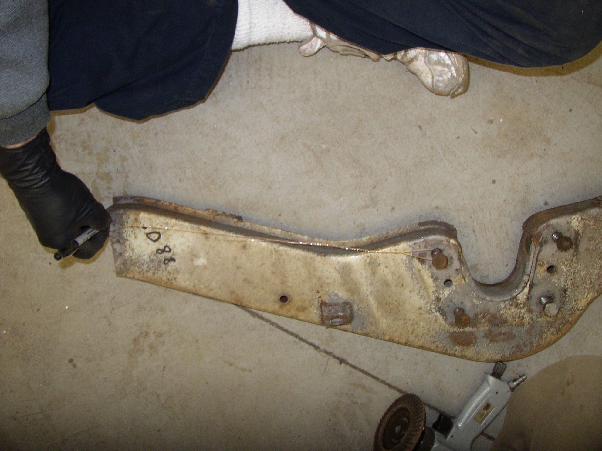

I ordered some nice rust free rails from Samba and they look great. The left rail was buckled a bit, I assumed from rot. I cut it open right at the buckle to find it was not rotted there! I can only guess a PO caught the beam on something in a previous life and the impact caused the buckle. It wasn't terrible, maybe 1/4-5/16" at most, just enough to see. Miking the rails showed only about a .005" loss due to rot at most of the rail. The .088" is what the "new" rail miked on the outer flange, the inner was

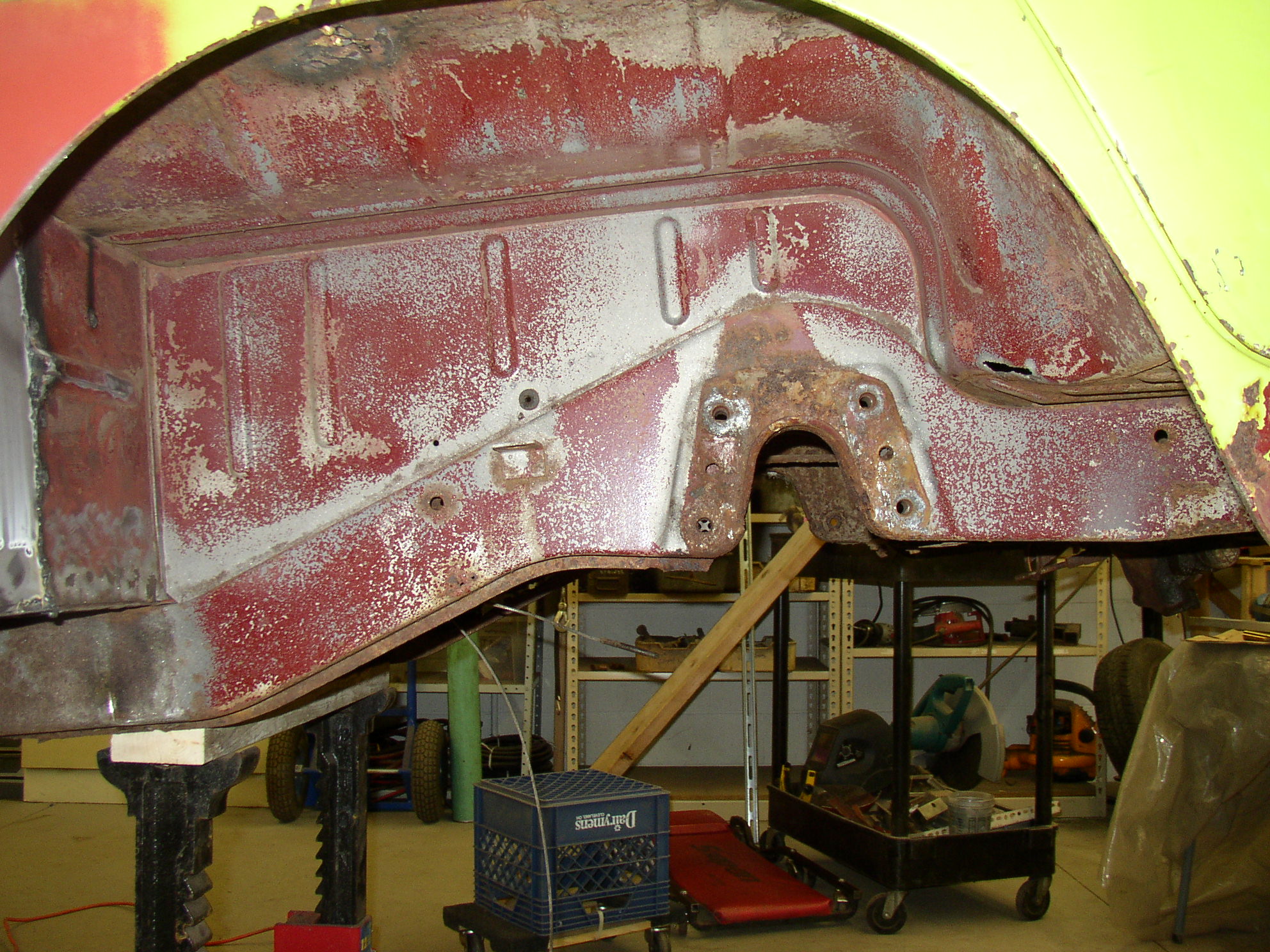

Here's the empty hole:

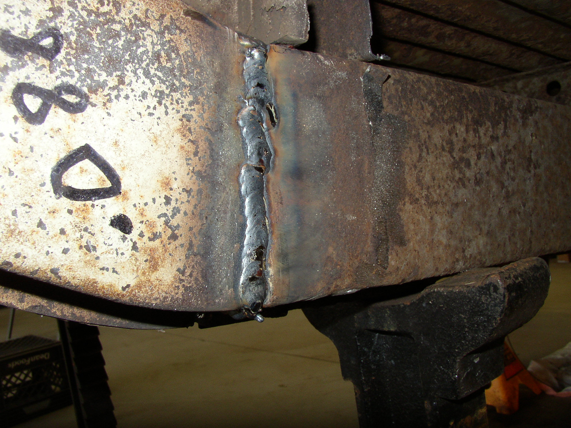

Here it is, fitted, installed, welded. I welded up a jig that double checked my spacing just like sticking the beam back in, becuase that bastard is too heavy to be messing with. I forgot to take a pic of the jig. :( I did measure the flanges, and they are just about exactly the 746mm it shows in the Bentley book. (Hooray! I got my Bentley! (used off of Samba) A bookworm like me loves to read the f'ing service manual for fun. And it gives great info I never knew, like the distance between nearly every point on the bus for the crash guys to align panels!)
My welds are getting better, especially on thicker metal.
