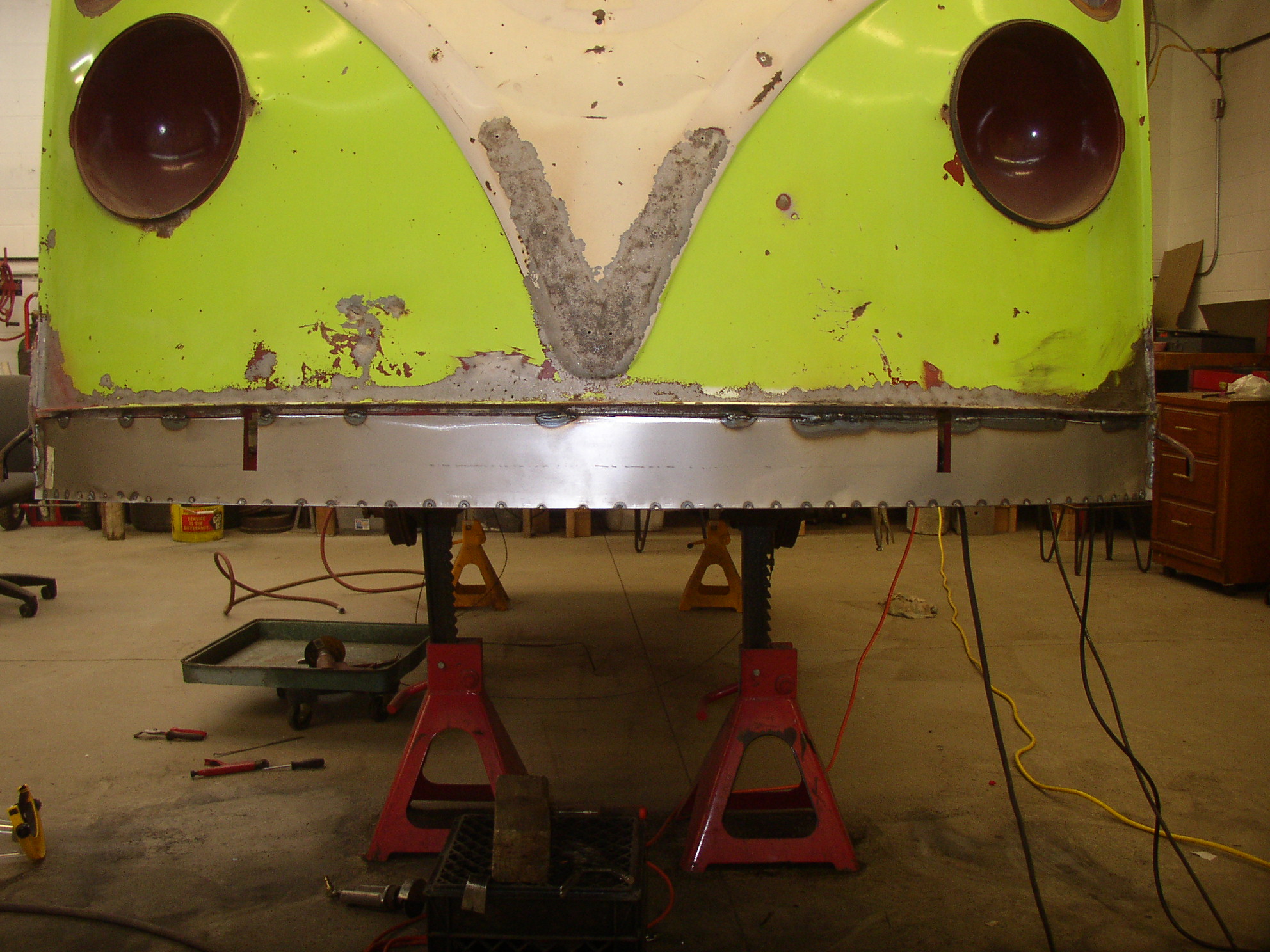

Here's the shots of the inner valance I forgot to post a few days ago. I spliced it using only the lower half, as that makes it easier to change. To replace the whole valance the nose skin must either be cut or removed.
Right floor is done and came out well.

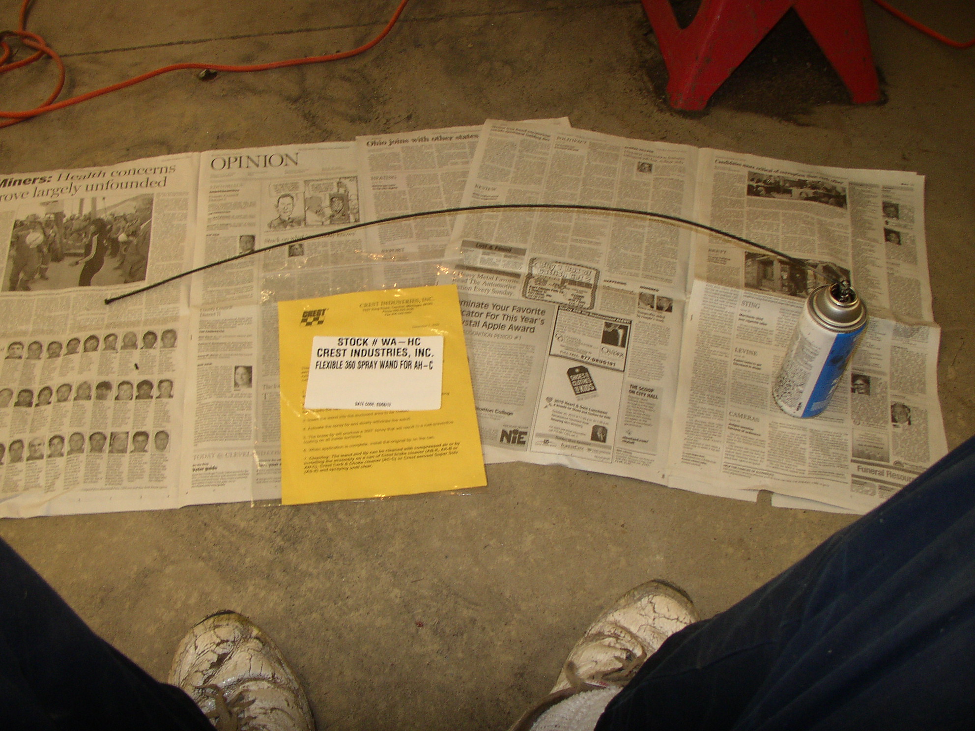

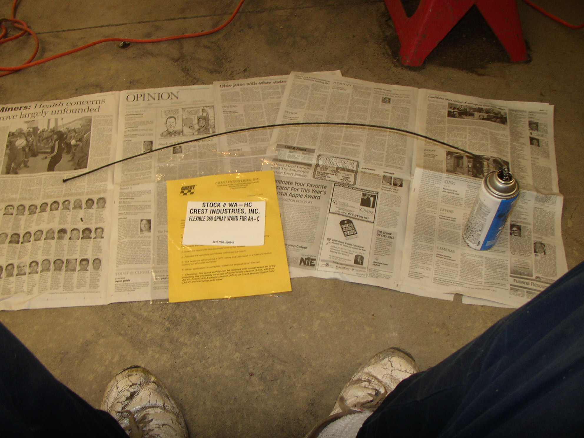

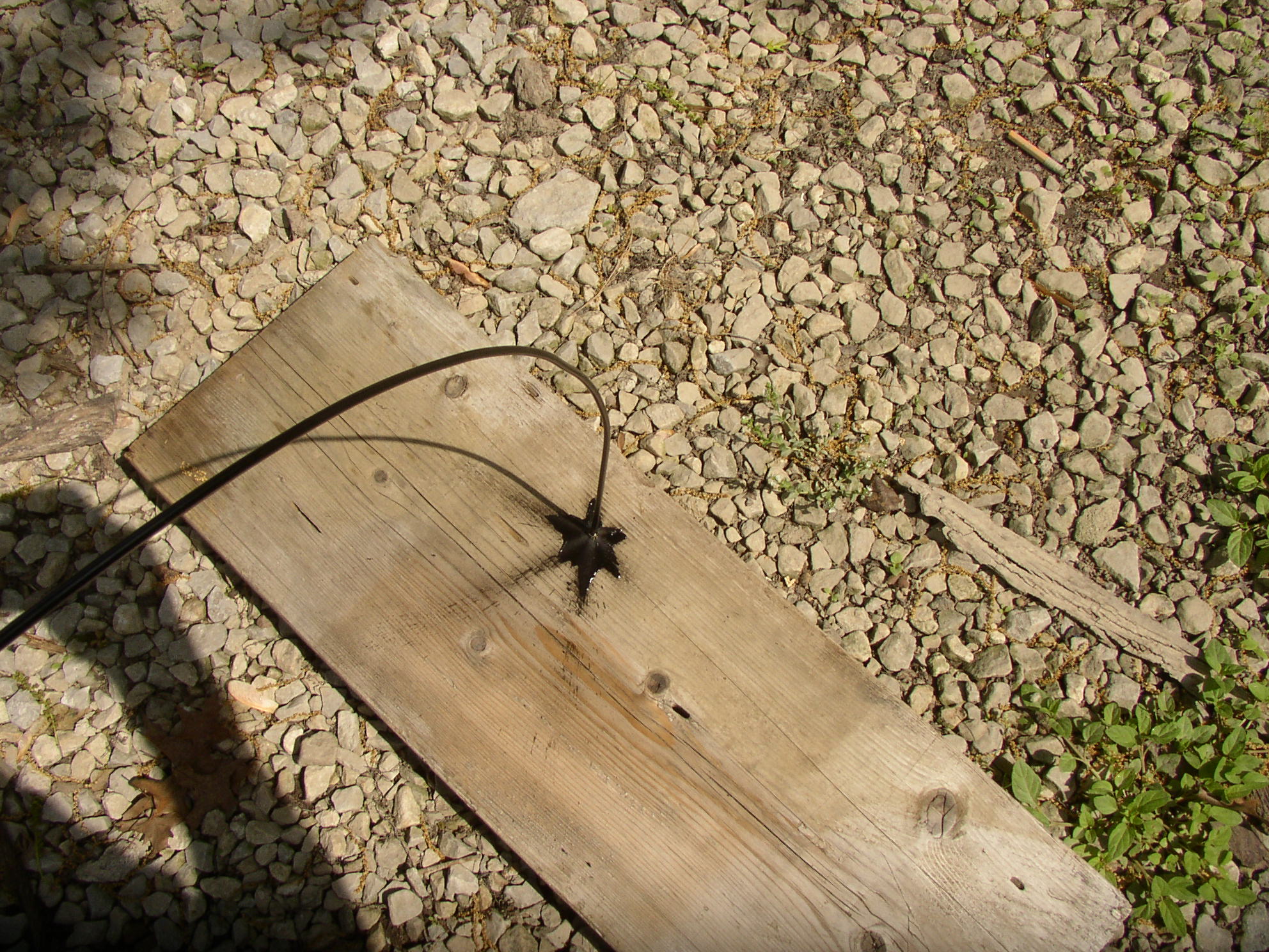

I bought a "wand" for painting inside the doglegs and framerail. It's a 3' tube that plugs into any common paint/rustproofing can with a tip that has 6 ports that spray nearly a 360* circle to coat the inside of stuff.
OK, on to the outer valance. Let's hit the inner with a coat of weld through primer first 'cause it's the last time it sees daylight for a while. :) I also shot the inner side of the lower outer valance for the same reason.
Fitting the outer valance. Once again, I spliced it and only used the lower half.
Here's where I stopped today- the outer valance is 80% done, just needs final welding.
My buddy's spot welder was the cat's ass for the lower edge- a real time saver.
I'm almost done with major welding, making me one fukking happy camper. I still will need to go around the bus and do final touch-ups with the mig, but all small detail shit. :D
On to the Ypsi swap meet tomorrow with a pocketfull of cash hoping to score parts. Aaron's looking for stuff for me at CTS/F'ton, too. :mrgreen:

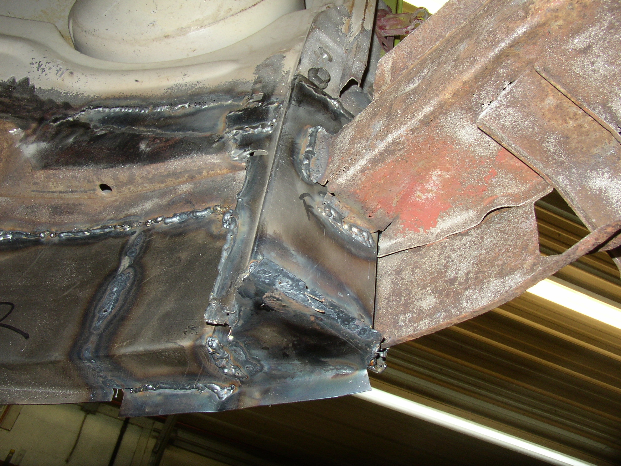

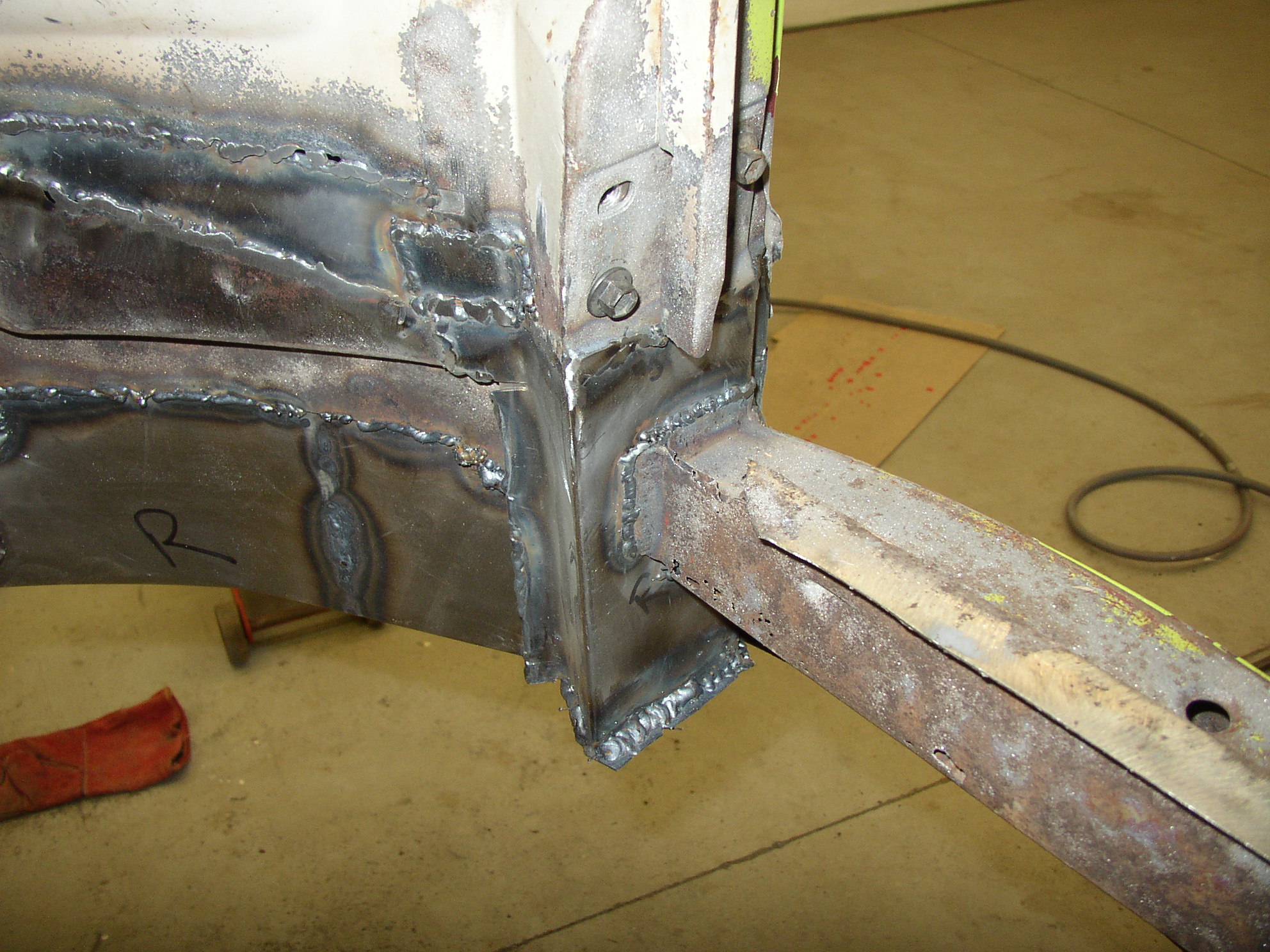

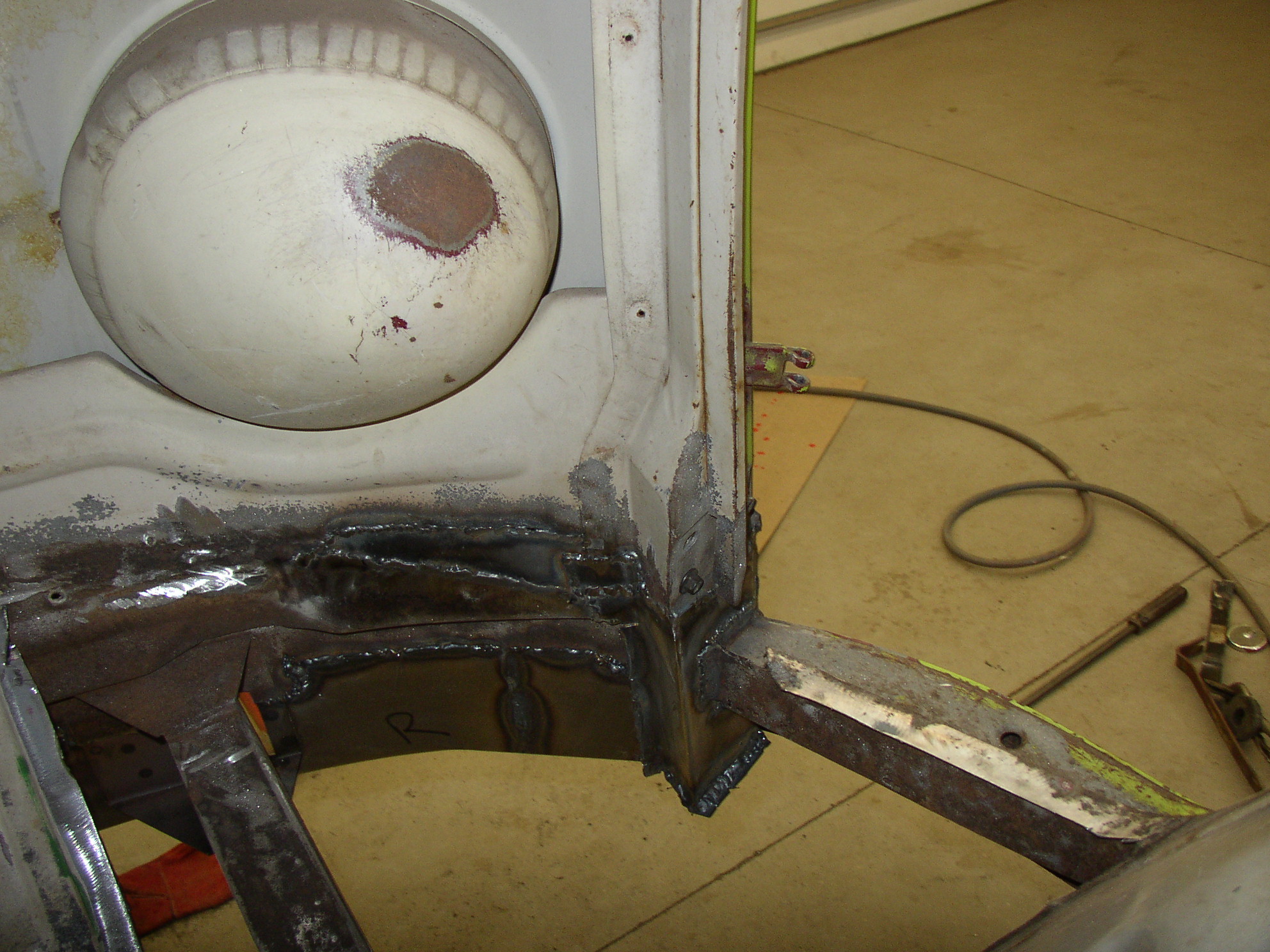

I finished welding and grinding the lower outer apron, it came out great.

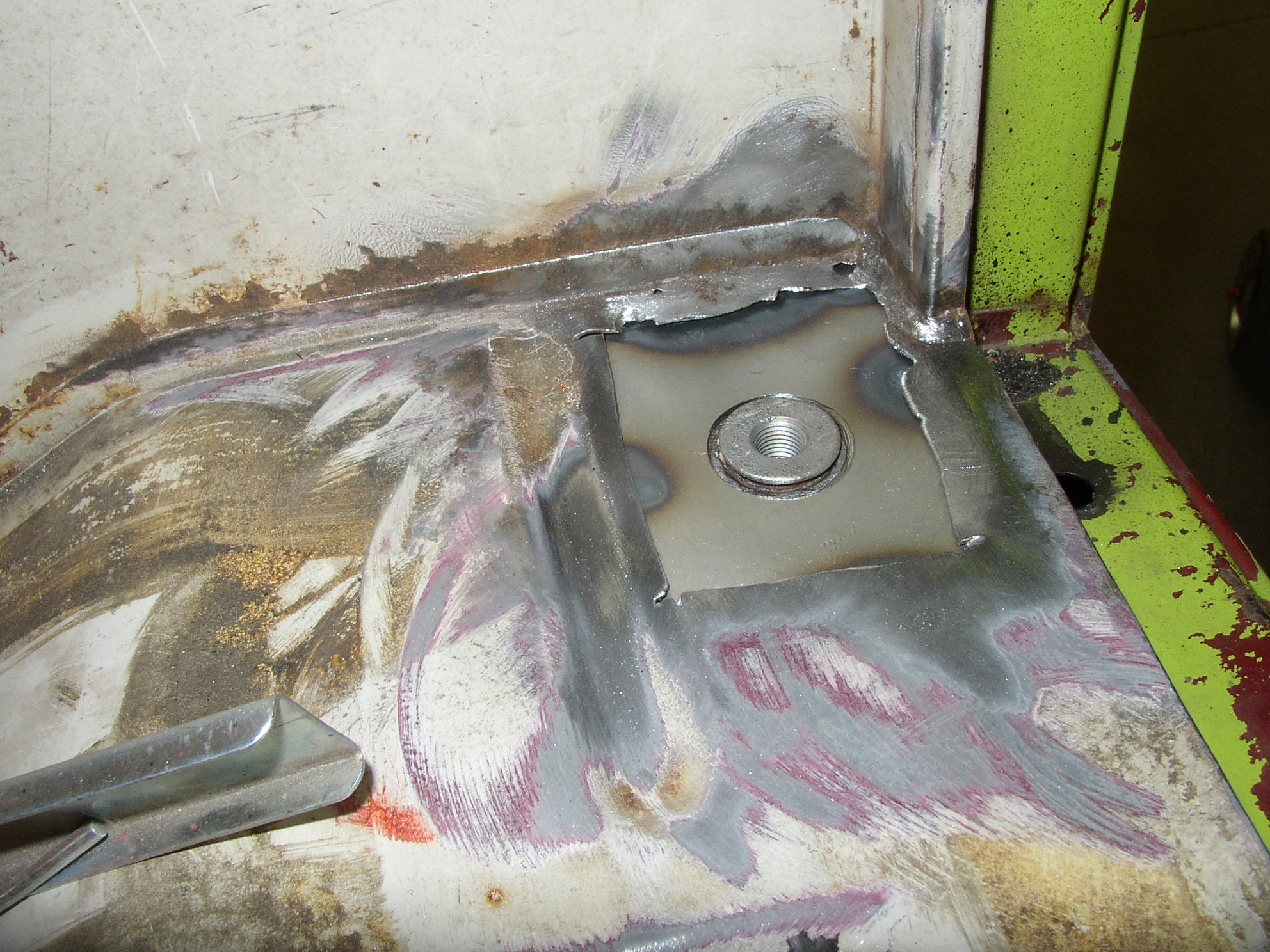

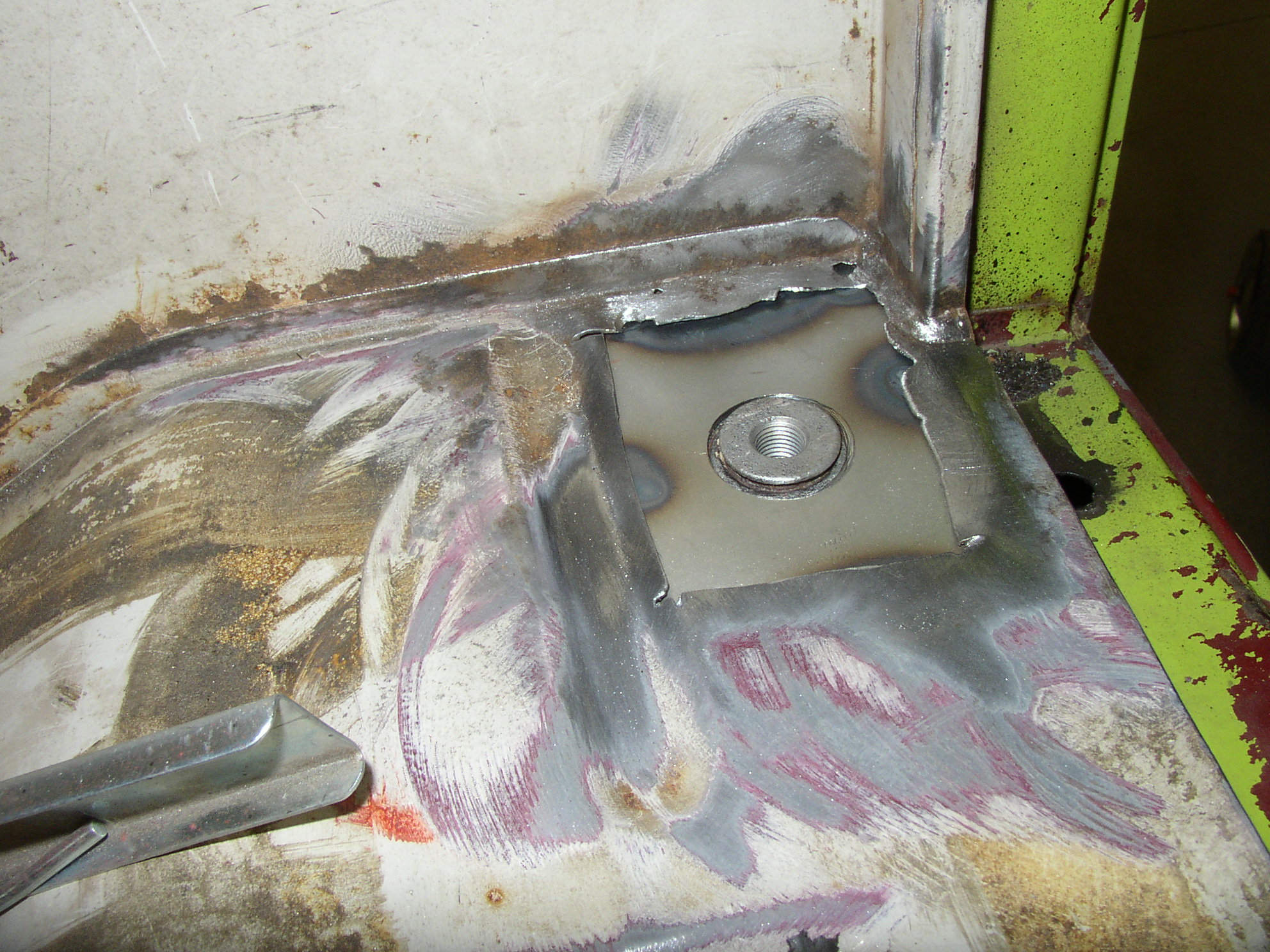

The left seat belt mount was a bit funky looking, but it wasn't until I cleaned it well did I find it was pretty rotted. Here's an old pic zoomed in, I didn't shoot any closeups prior to cutting it out.
Here it is done, it came out great.

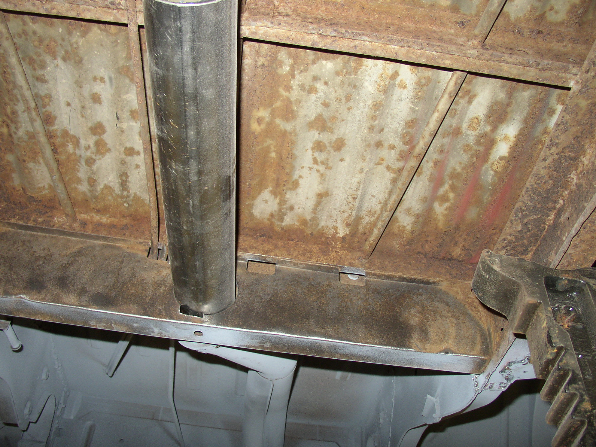

2 3/4" exhaust pipe fits perfect for replacing the rotted long heat tube, it's not easy to buy but Napa was able to get a 10' piece for $30.
Here is a small piece test fitted through the front crossmember and into the bent heater tube.

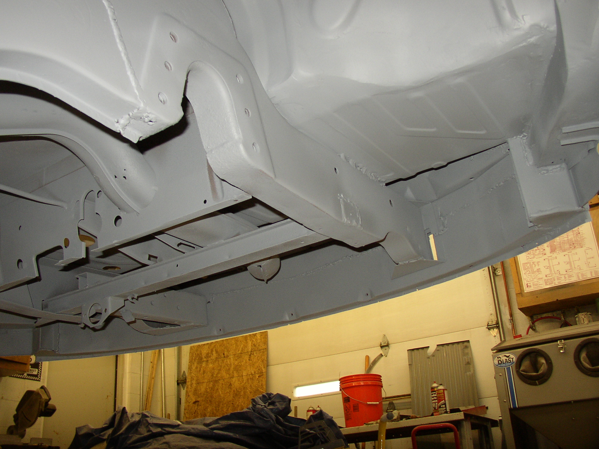

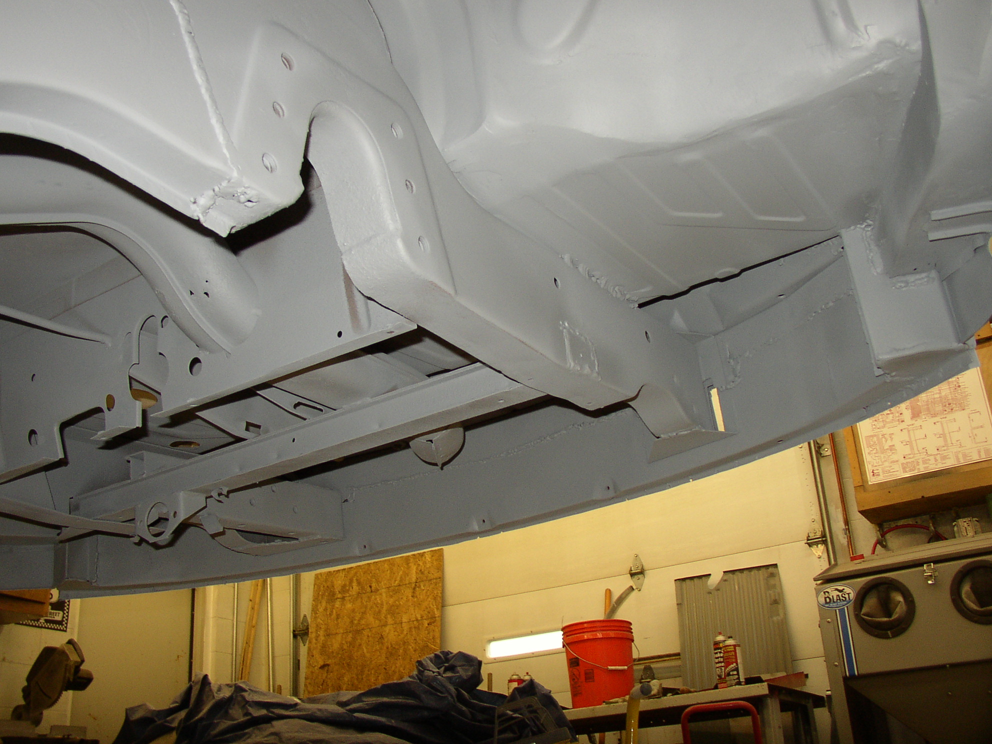

After sealing up the floors and bulkheads with FG, I mixed up some two part primer and shot the bottom. I'll continue working underneath doing a quick sandblast of the entire bottom and end up shooting gray acrylic paint on the whole underneath. I figure this is the best time, as once the outer body is done I sure won't want to be painting the bottom of the bus.
You might remember this front heater tube had a big rot hole in it, so I used glass mat and jelly to seal that up.

This thread is awesome! Great work Bruce! I love the 360 degree sprayer "wand". Also, that's a great tip on the NAPA 2 and 3/4 inch exhaust pipe for replacement heater tube. Great job on the complicated welds. And the fiberglass seal is also a great tip. :D
