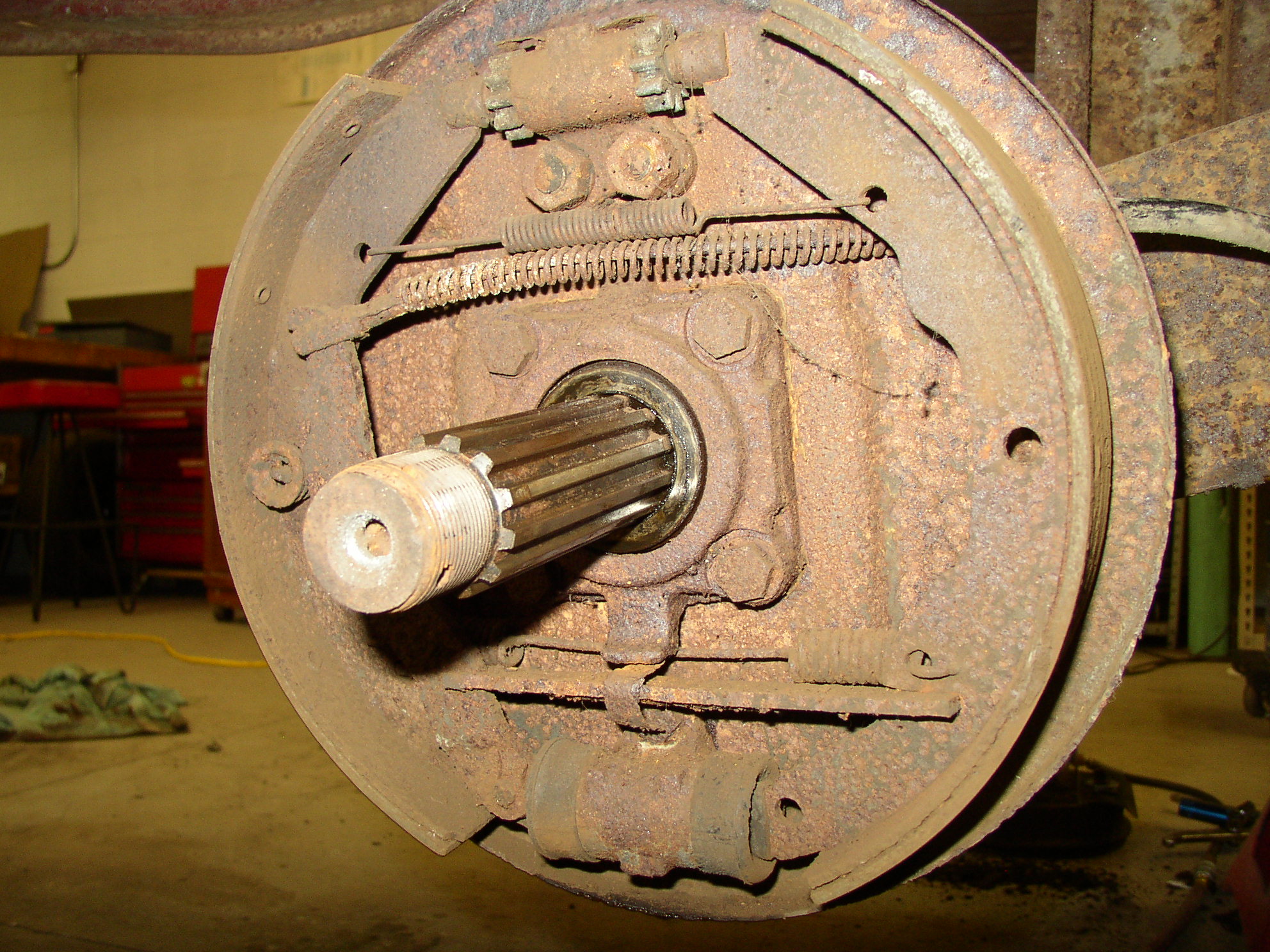

Back in the shop after a bunch of weeks teaching. I'm working toward prepping and painting the bottom of the bus which means the tranny has to come out. I figured I'd pull the drums and see what horror lies inside...
WTF? Are these things always this tight?
Damn, there goes the budget. Maybe I can save that wheel cylinder...

Tranny's out, I'll replace the boots, clean it and paint it to look nice. How do you attach/reattach the axle snubbers? Both virtually fell off when touched. The stores sell them but without the bracket, and it looks like the bracket is welded to the tube.
The dingaling that put this together put the bearing retainers on upside down, the drain ports are up, blocked by the backing plate.

If the snubbers fell off you'll probably have to replace the axle tubes if you want to retain them because they are pressed onto a mushroomed shaped plug in the center of the stand that's welded to the axle tube. If you want to keep it OEM your going to have to find some nicer ones that still have that part remaining. I think this thread is a good example why its better to spend a little more money on a less rusty bus, its the small stuff such as this that will eat up your budget and your time when doing a truly OEM correct resto. Buy something more complete and less molested not something that's been passed around like a prostitute.

Mike- Yes, the pk brake was off, the cables were actually unhooked from the front a while back and hanging loose. The drums were hung on the spline more than anything, but the shoes did catch on one side and trash the holddowns. I'm also used to them sliding on and off on my T1s.

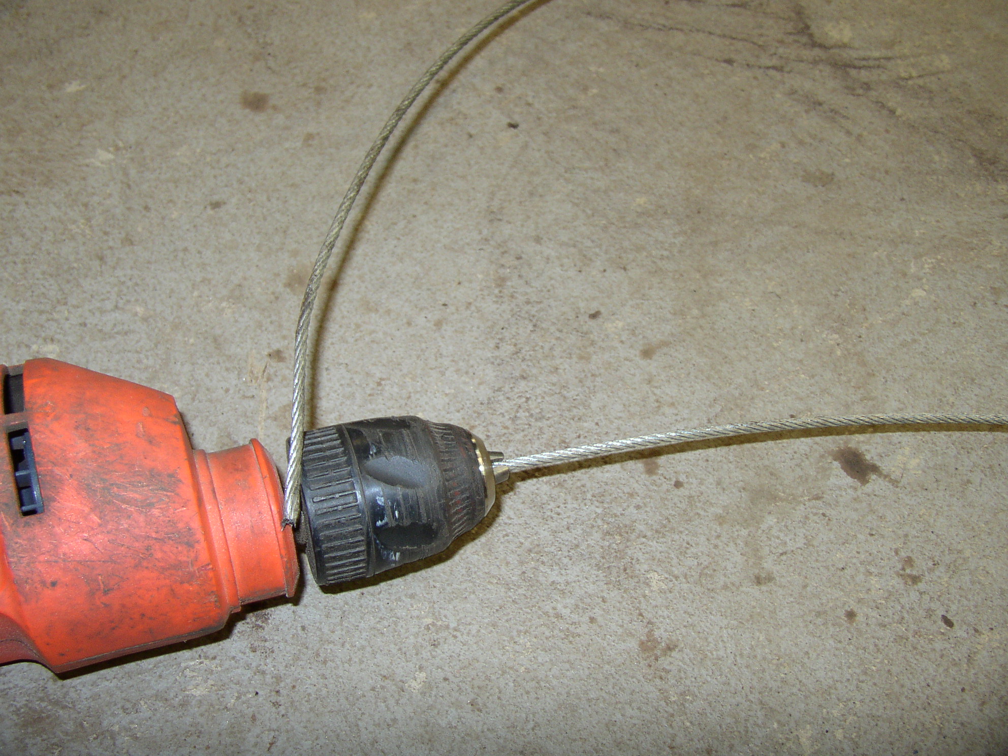

Still cleaning underneath, it's dirty rotten filthy work that makes me envy Kirk's rotisserie. I figured I better do something with my heater cable tubes while I'm down there because the left one was broken off 2' from the tip.
I found the reason is because the other one is also plugged solid with rust, locking the heater cable in where it couldn't be removed from the control by the driver.
I tried the drill bit thing to clean the tube, it's plugged farther than the drill will go. I also tried the cable-in-the-drill thing, but there was no way in hell it was going to clear out.
I decided to cut the end off to find it clogged solid with rust. There was no way it was going to clean out.....
Which released the control allowing it to be removed.
I did ream both tubes with the drill cable, blew them out, and ran some brakeclean through them.

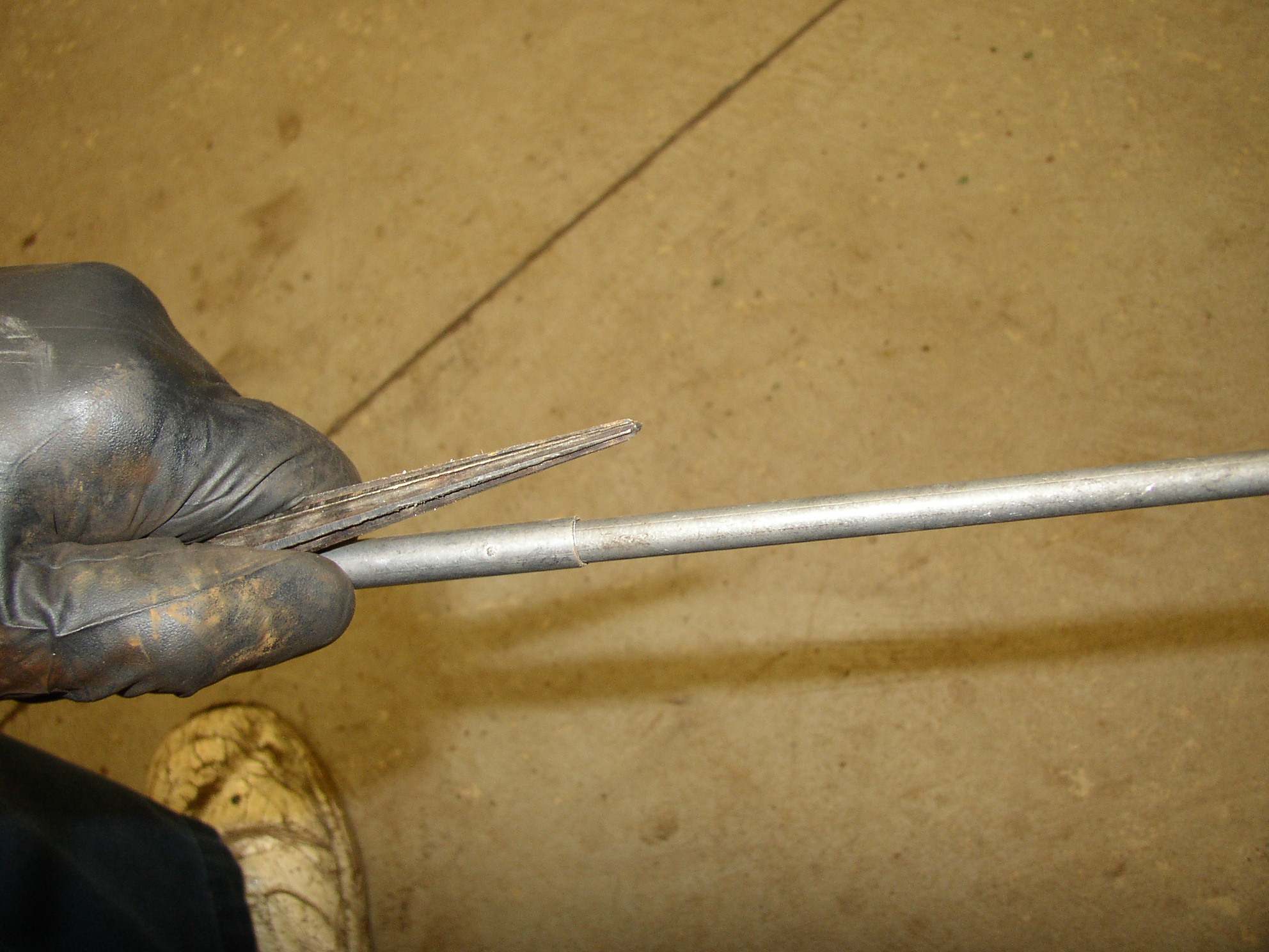

I used some 5/16" brake line to replace the 8mm tubing.
By chance 3/8" flare tube has exactly 5/16" ID which means it "sleeves" the tube perfectly for a splice.
Using a taper reamer removes the edge so the heater cable will slide through nicely.
I brazed the joints and tested them with a piece of heater cable which slides right through the splices.
