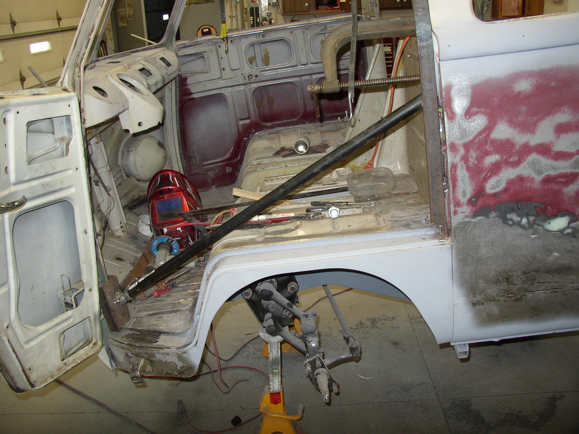

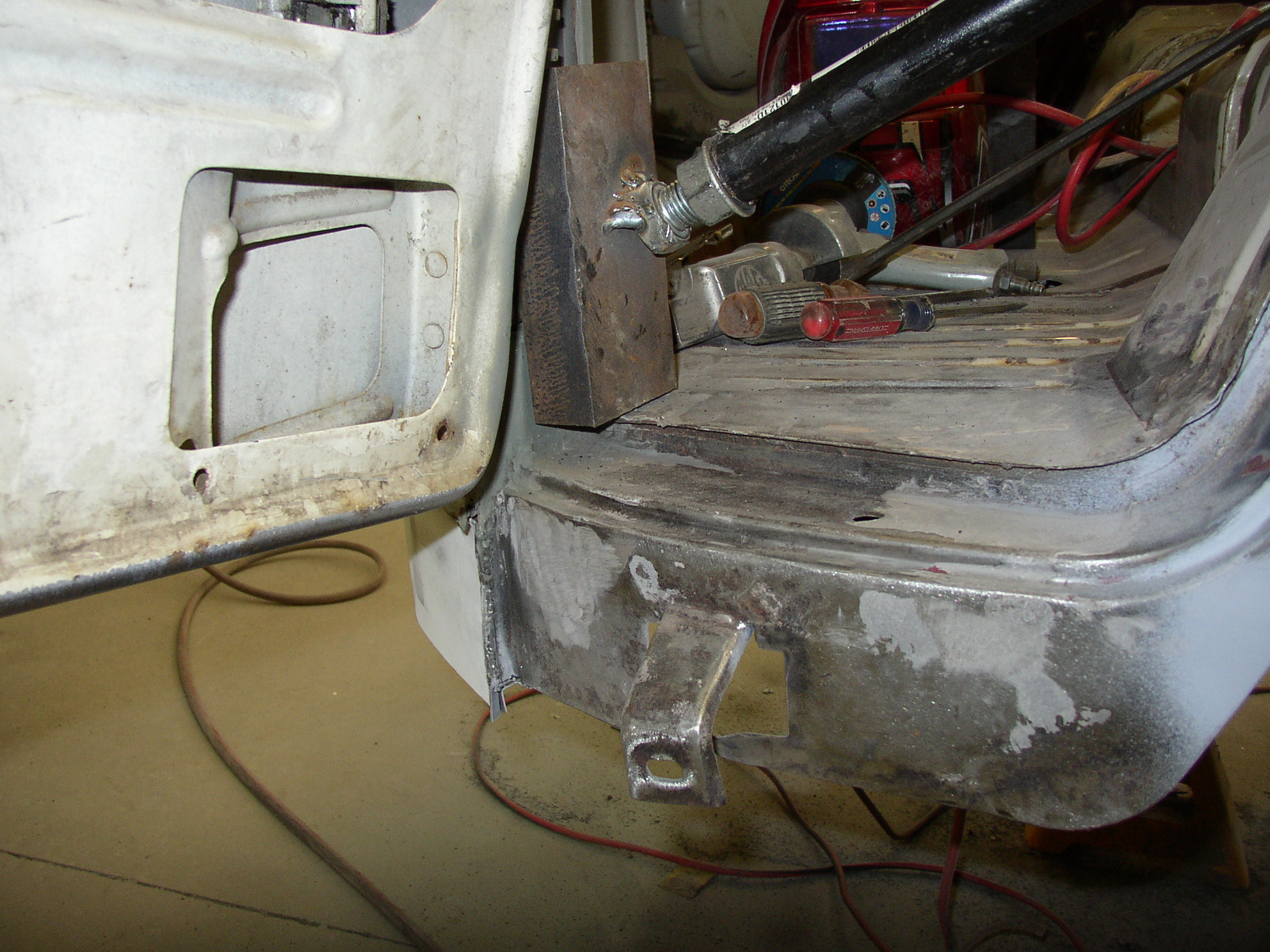

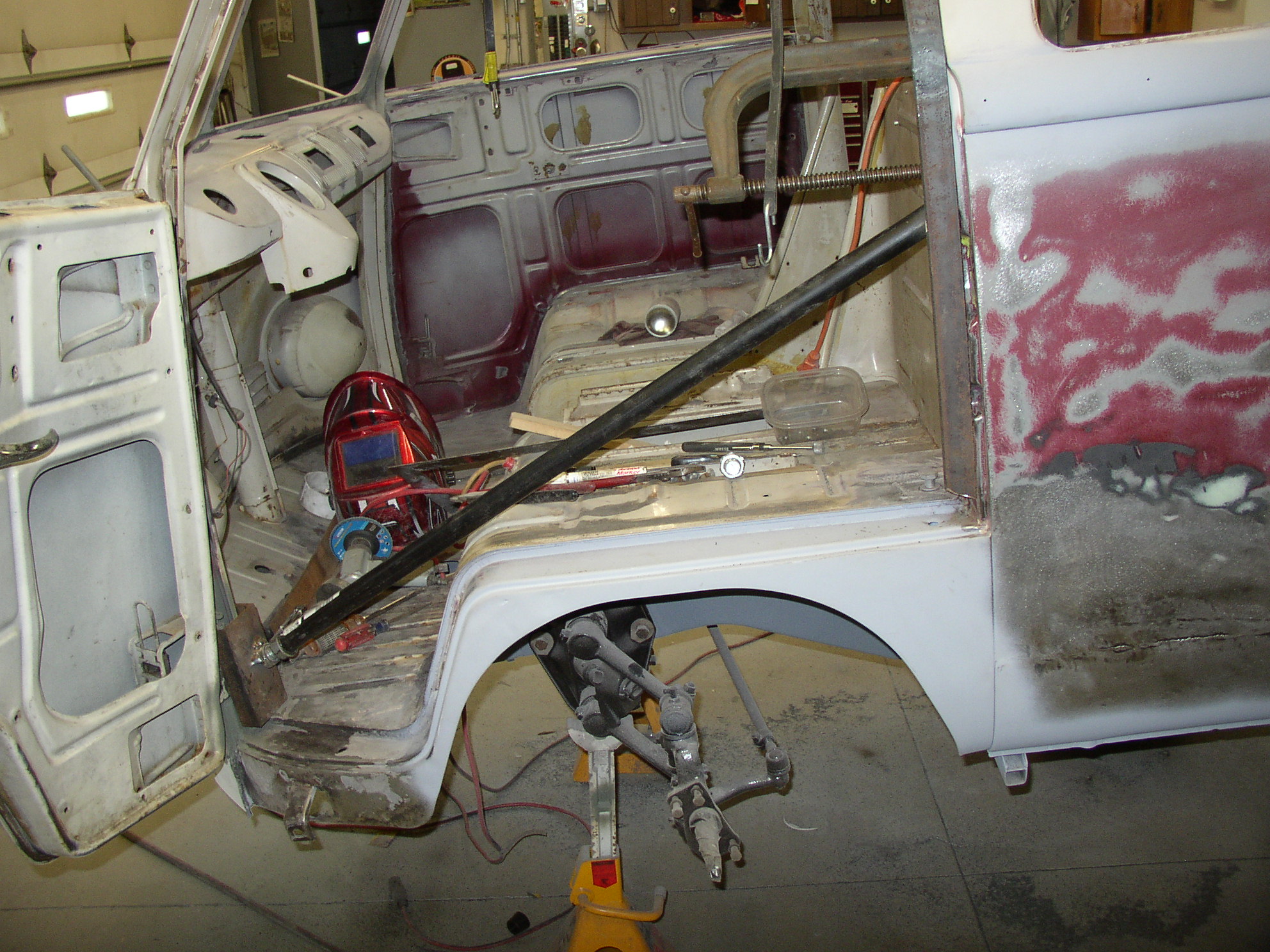

I stretched the door frame a bit to help get the "new" door gaps better...
And it's good but not perfect, the rear edge gap is not even from top to bottom.

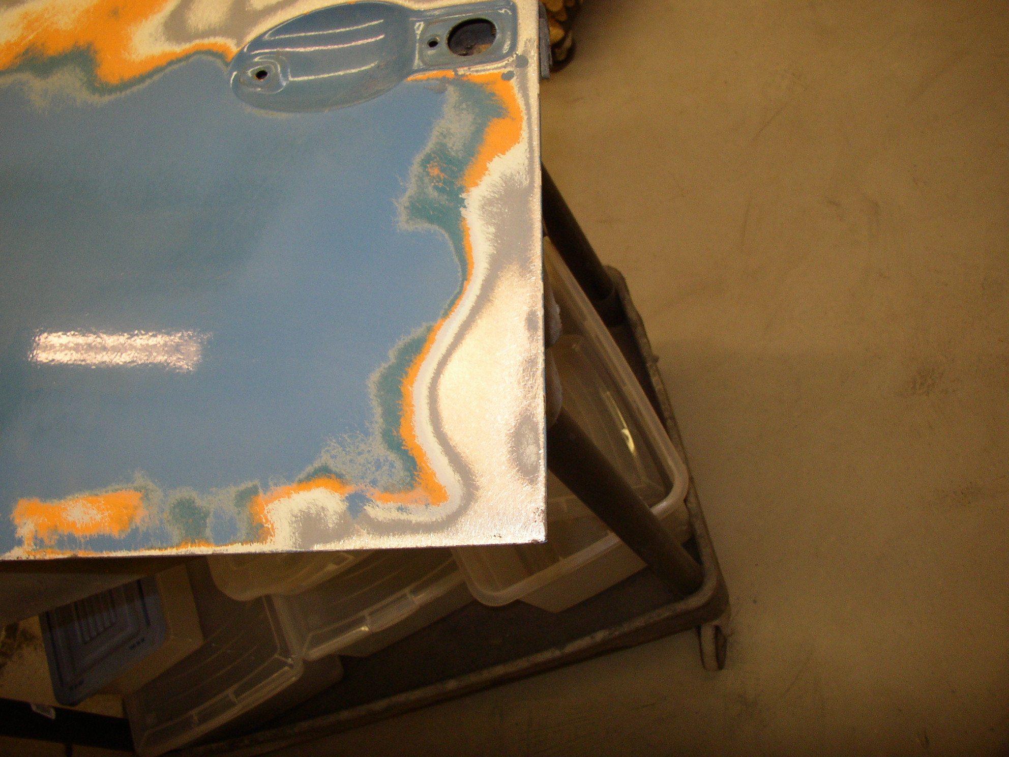

I removed the Bondo from the dent in the middle and worked it out from the inside, it came out quite well and will only need a skim coat instead of the 3/4" it had. I stripped the paint to find many coats, this was a '67 Deluxe door- it looks like the original bus was yellow bottom, white top, and repainted blue, but there's no factory yellow color in splitties, so I guess it changed color at least twice in its life. There might be 7 layers if you count primer- 2 blues, yellow, and white. :roll:
Man, did that SOB have a lot of paint on it. It also had "west coast" mirrors on it so I'll weld up the holes.
In town the next few weeks so a lot "should" get done, I think I'm about 375 hours right now. :mrgreen:

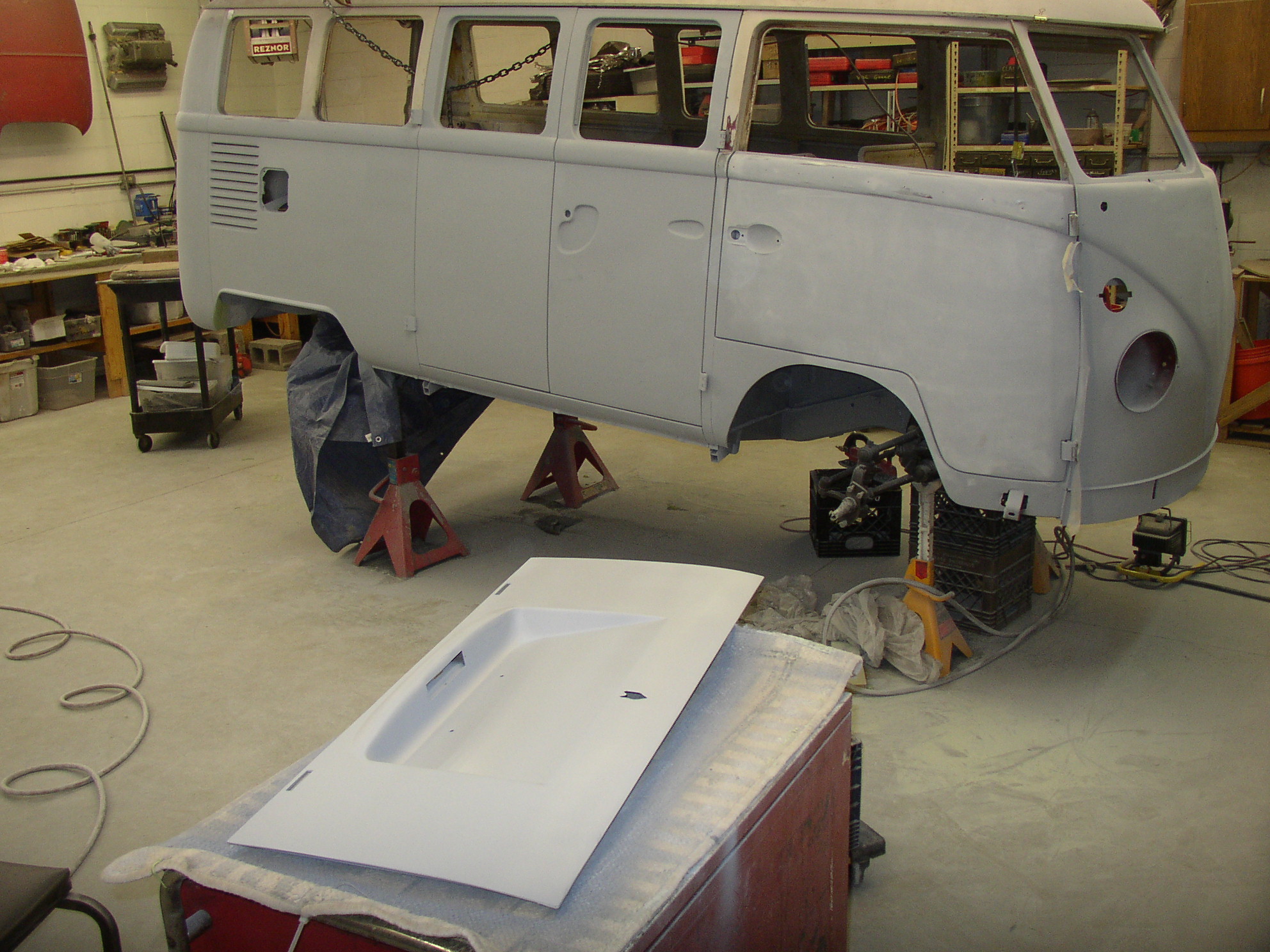

Posts: 1385

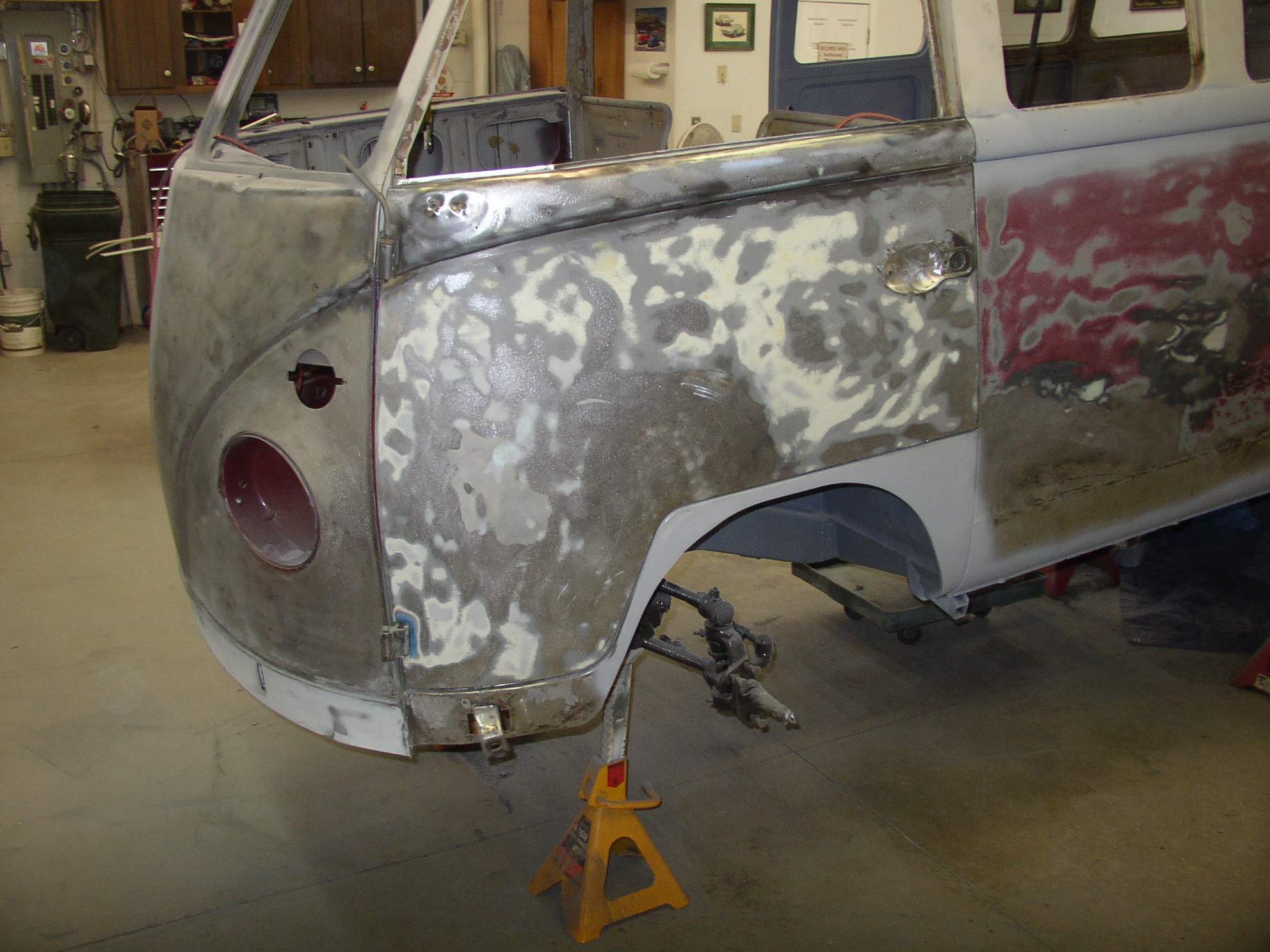

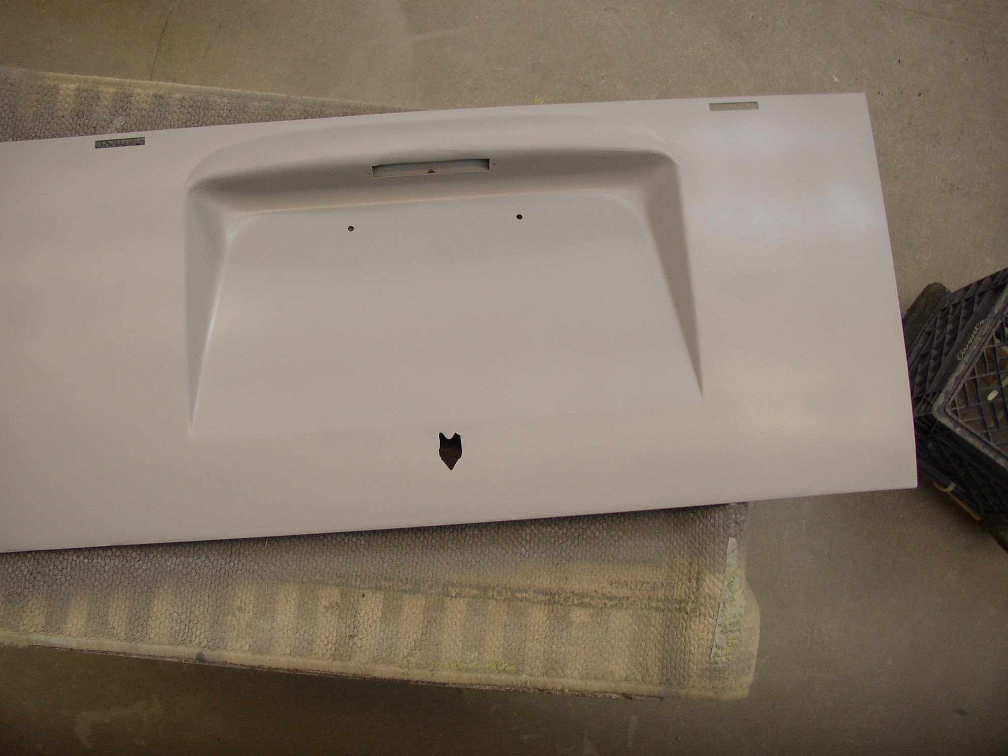

It's kind of tough to show what's been done, but here's an update: Still slinging mud, grinding off almost as much as goes on, things are better but still nowhere near ready for color. Some areas are in primer but probably not ready for blocking yet, just started the long left rocker which will prove to be a challenge.
Chug on, currently at about 410 hours with Chuck's time.

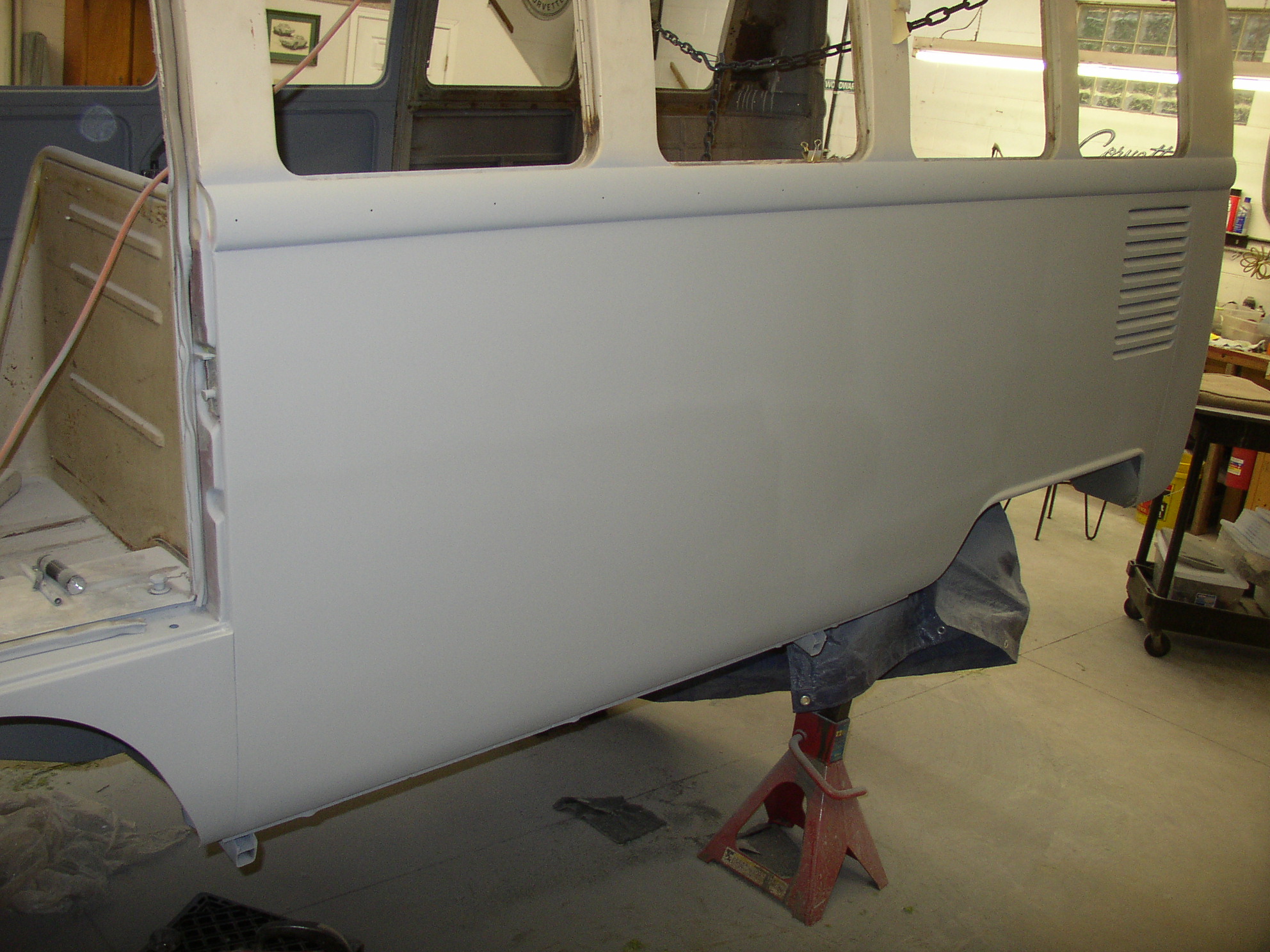

Posts: 1385

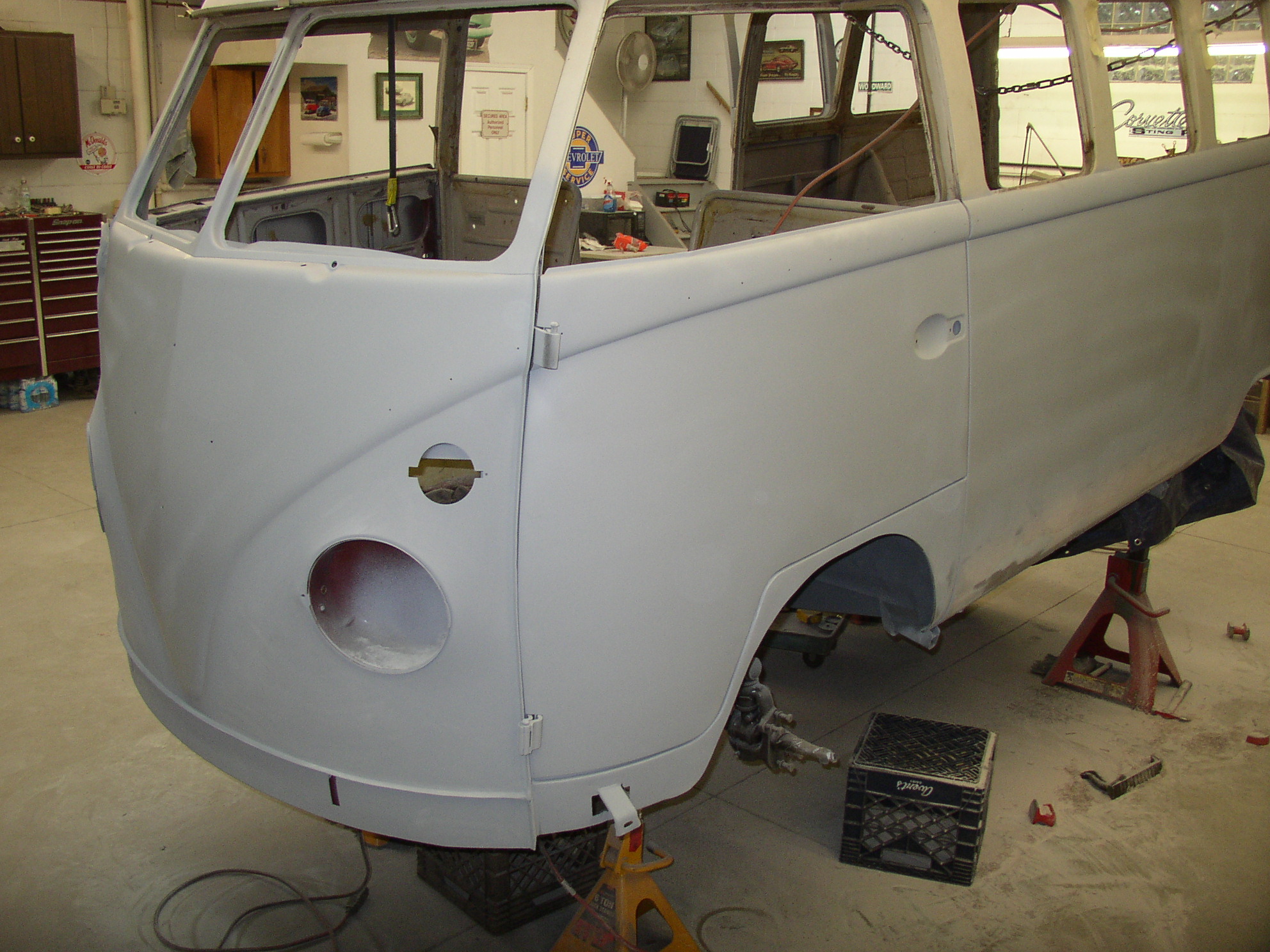

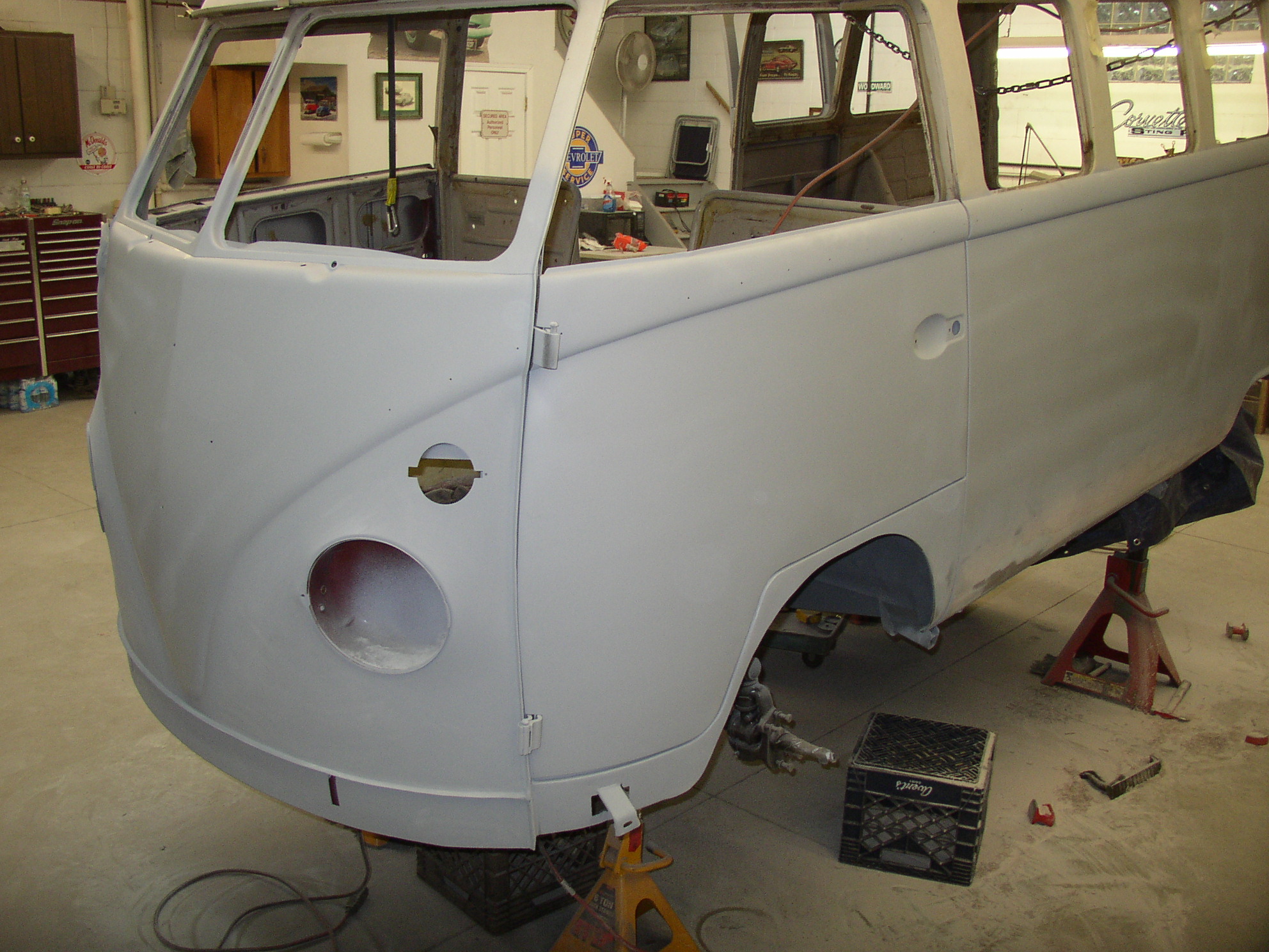

Wow, I can see the light at the end of the tunnel! I have made so much progress in the last two weeks it's unreal, and things are finally starting to fall where they should. I've finally got my skills to a level where things actually turn out like they are supposed to. The bondo is smooth, the primer is smooth, there's no waves or ripples anywhere that I can see or feel. When the primer is wet the reflection is super nice so I'm thinking the final product will be very good or excellent. The left rocker went really quickly and turned out great. I have shot 1.5 gallons of high build primer and run 180 in the air file over it numerous times which heals up pimples and imperfections.
Probably about 435 on the hours and should have color on around 500-550, my original estimate of 600 hours might not be too far off. I will be talking to Bill shortly about scheduling upholstery and headliner after color is on. Still need to prep and paint the interior before the exterior gets color. Getting psyched that this will actually happen in my lifetime!
A lot of credit goes to Chuck, who led the way and helped me hone my skills, it would have been much harder without his help.

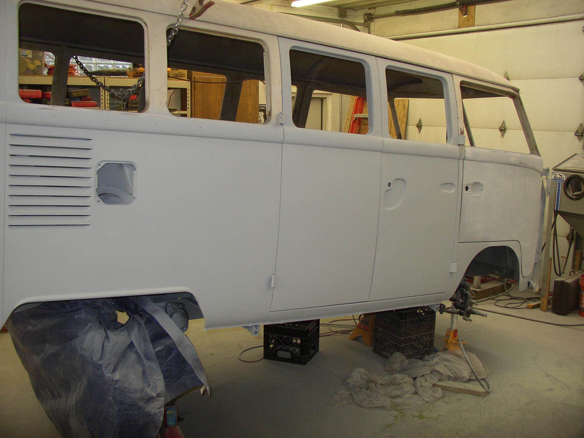

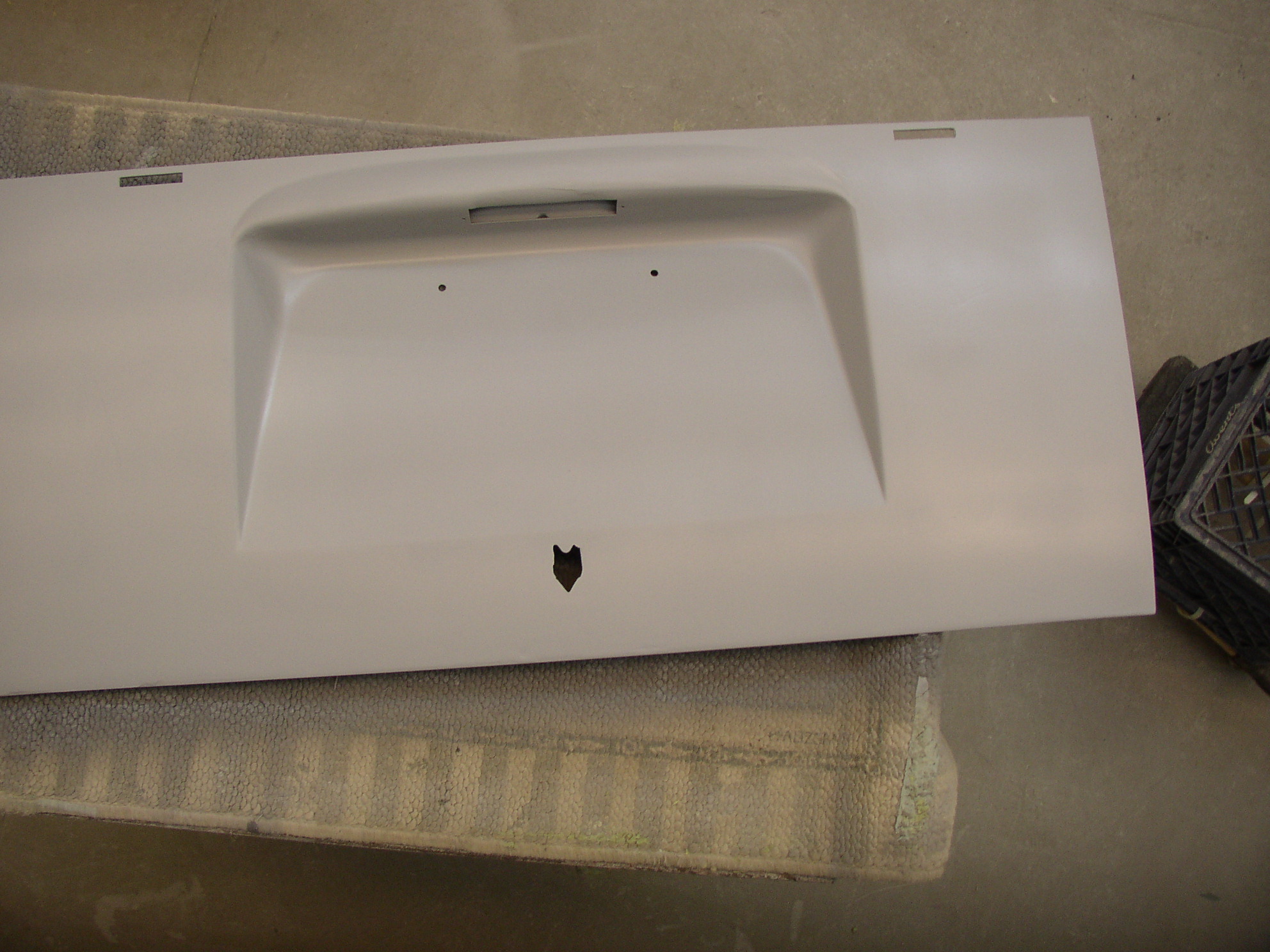

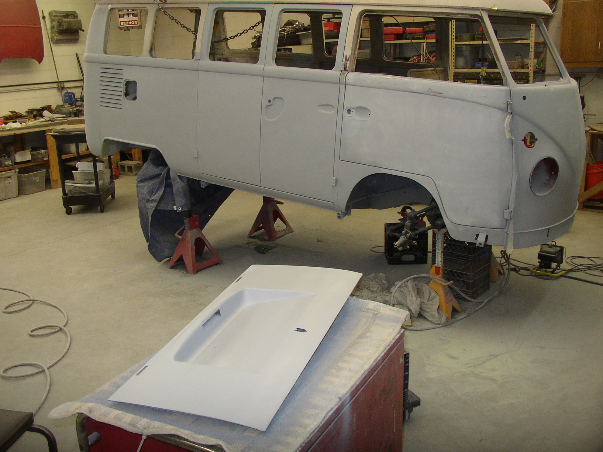

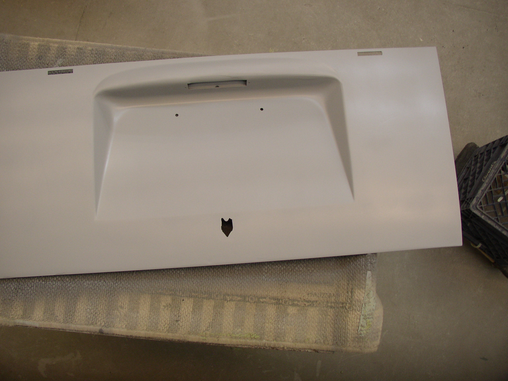

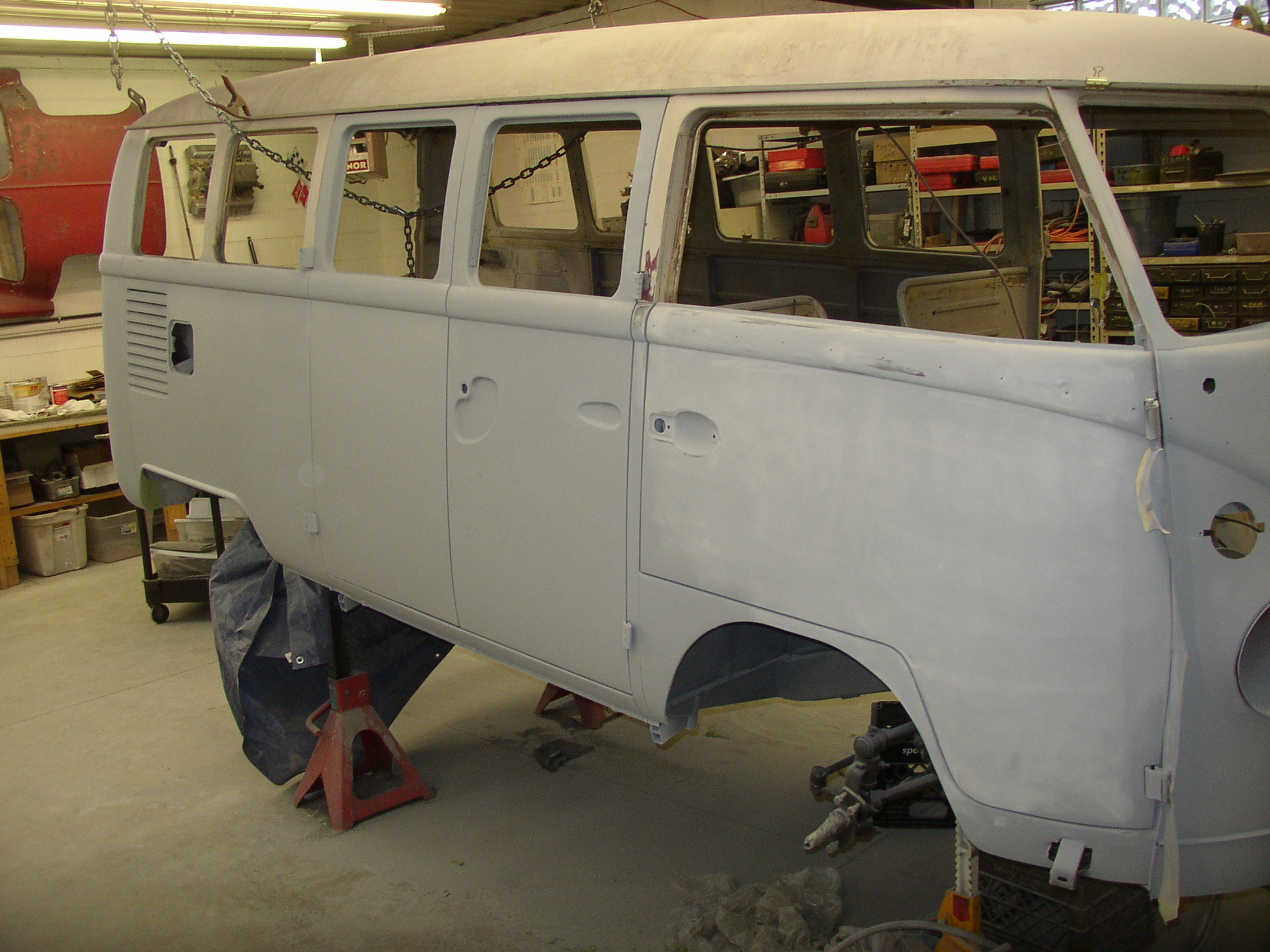

Still making a lot of progress but the bodywork doesn't show as it's still in primer, but the panels are flatter.

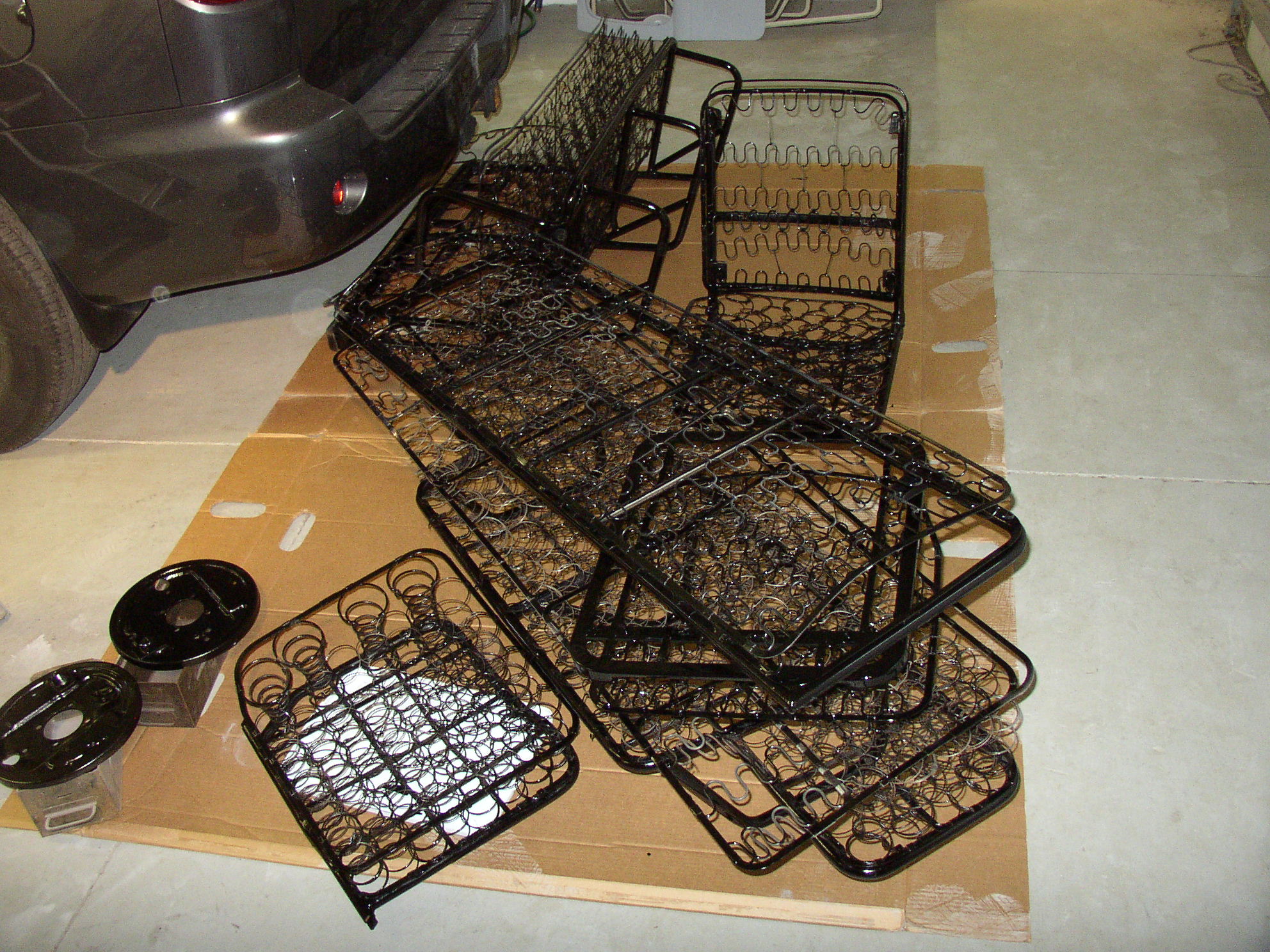

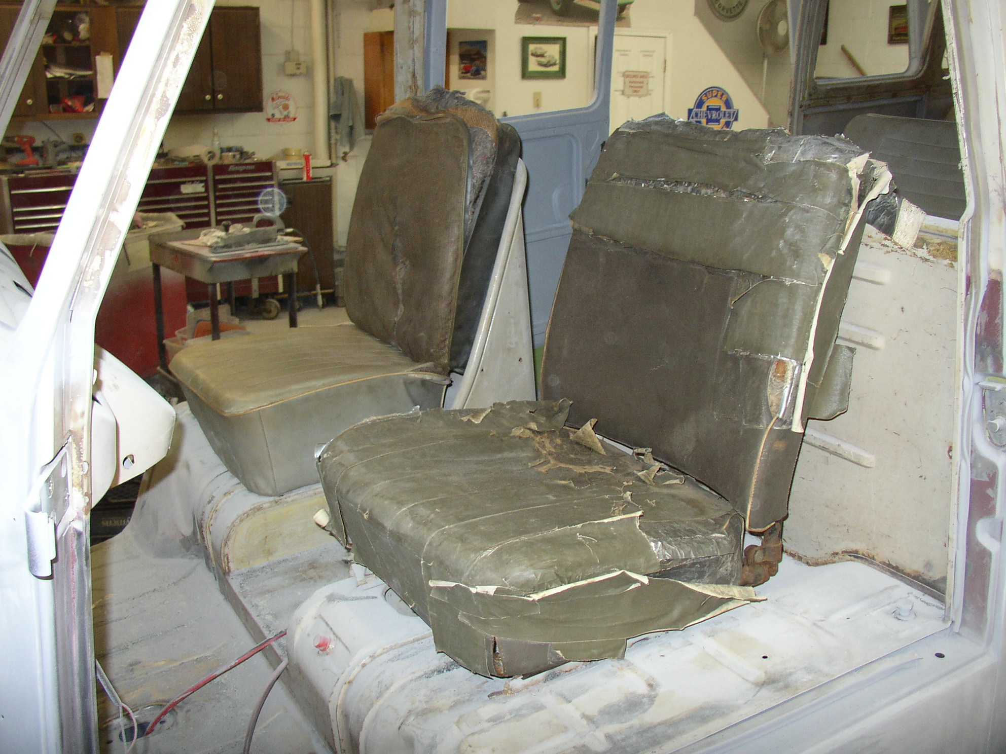

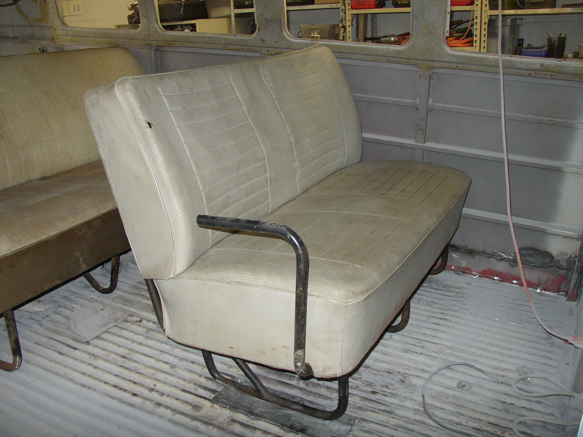

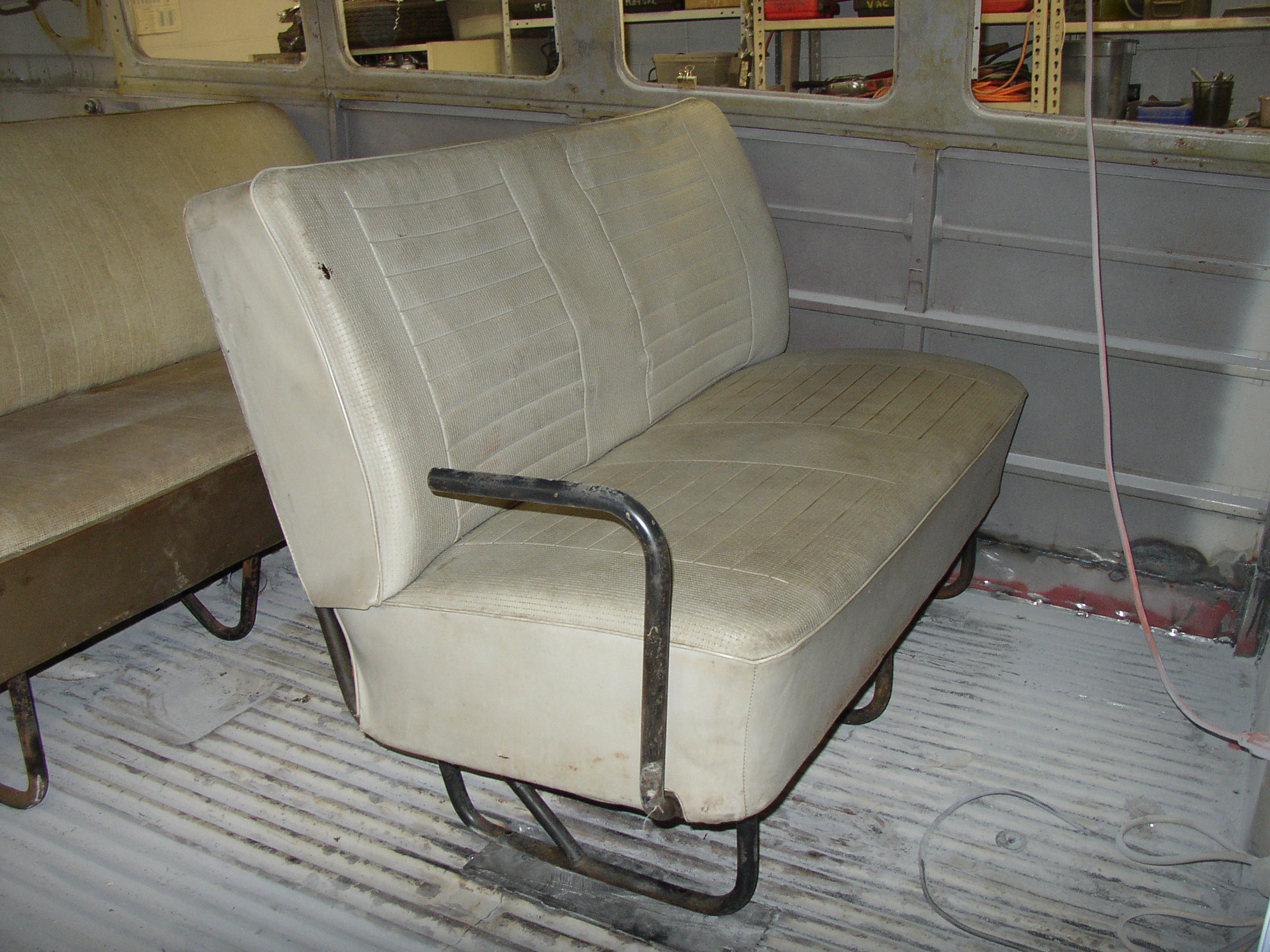

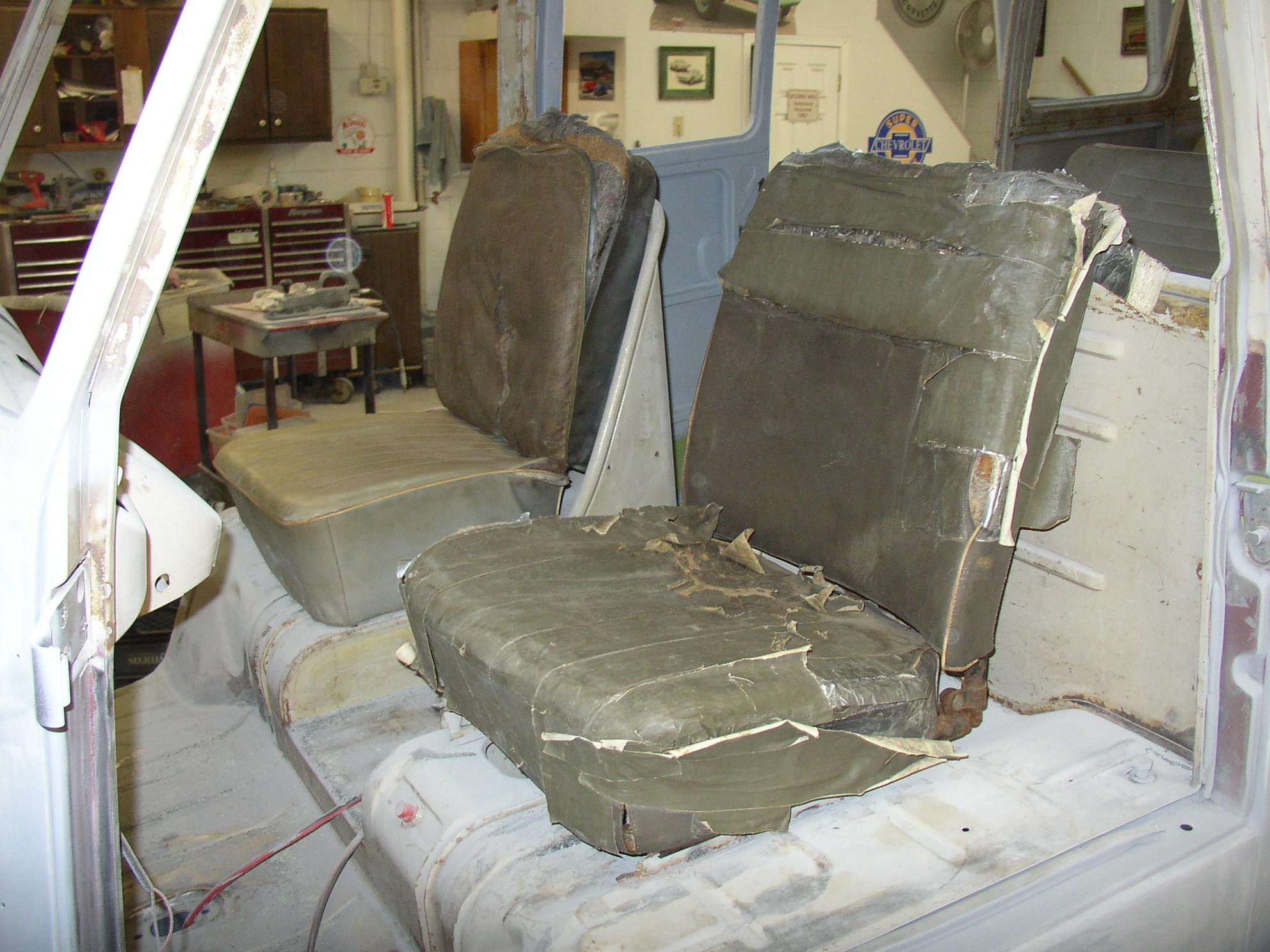

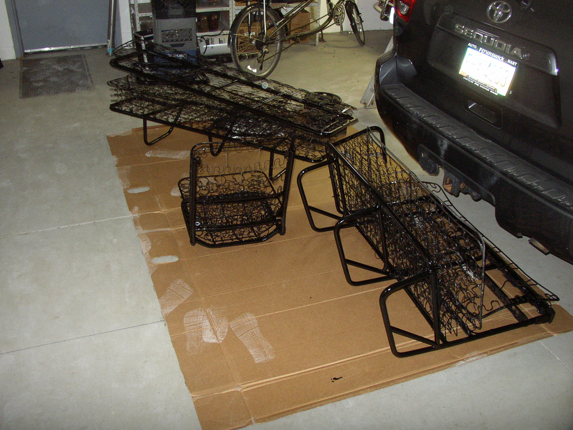

I put the seats in as a last test fit before committing to having them recovered, they fit fine, and Sean was generous enough to set me up with a better Bay middle seat than I had. ;) Boy, do those seats look like hell.
I cleaned the mice nests out and pulled all of the covers off, what a shit job that is. I'll save what padding can be reused but most of it will get canned. (Is that right, Bill?)

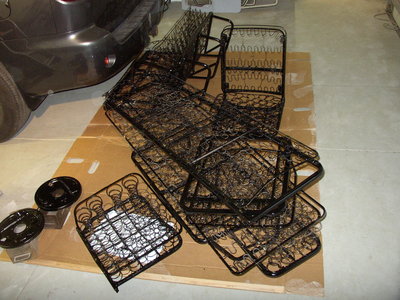

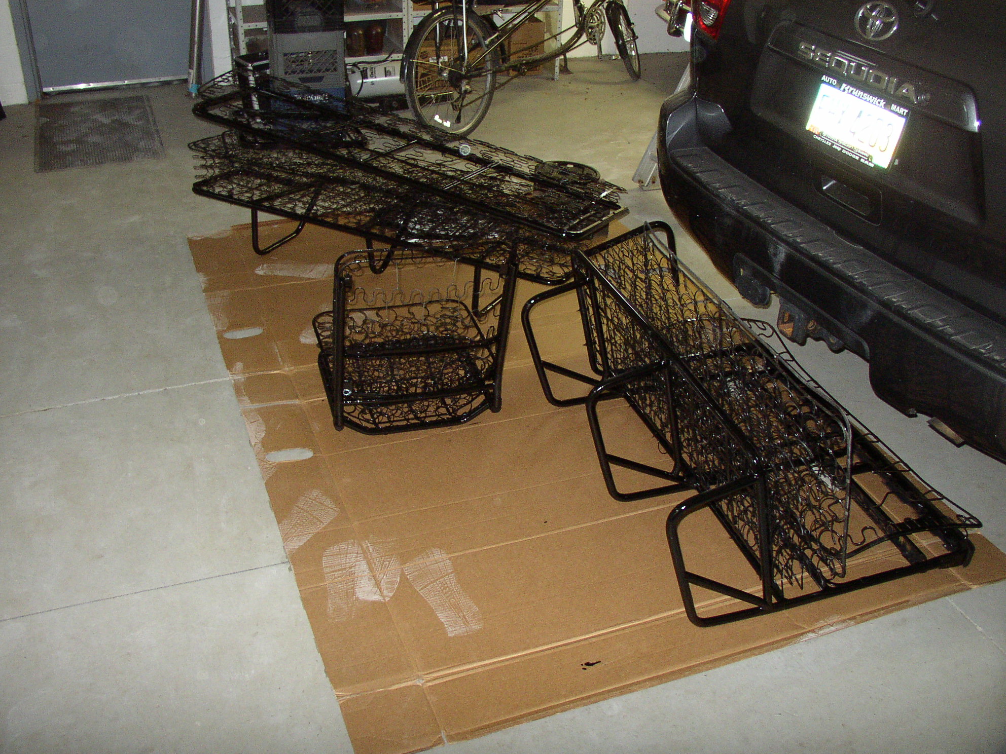

Then I cleaned, ground, sanded, and sandblasted the yech off the frames and shot them in black.
I contacted TMI about covers and they are sending me a vinyl sample out in the mail. The problem is the original style covers are butt-ugly so I may not stick with "correct". Also, their website is kind of difficult to navigate and understand. If anyone has a suggestion for a better looking cost effective cover, I'm all ears.

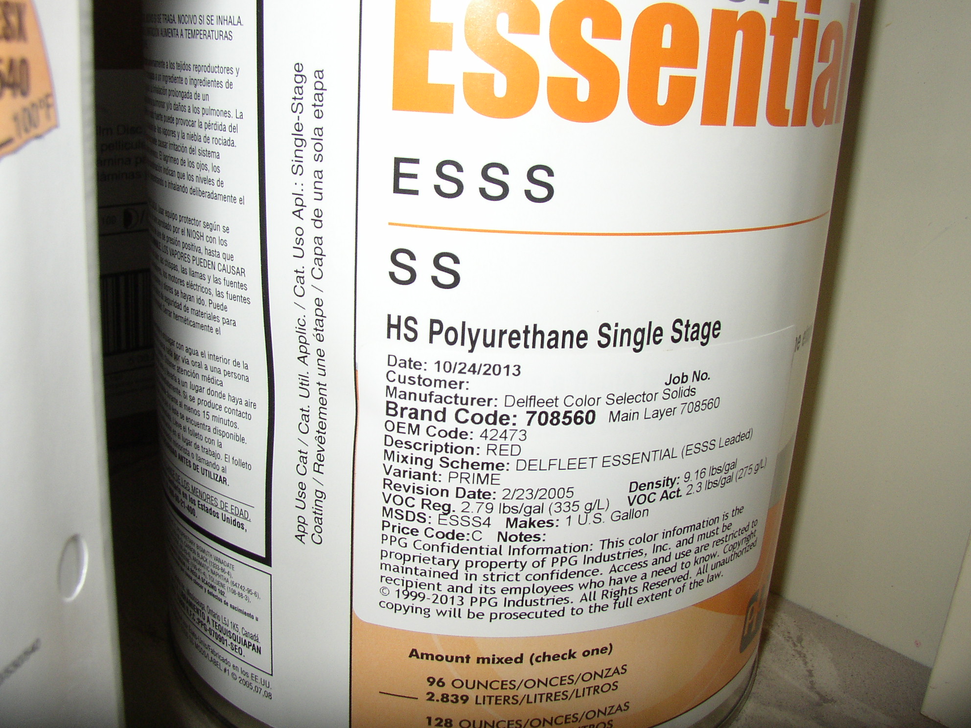

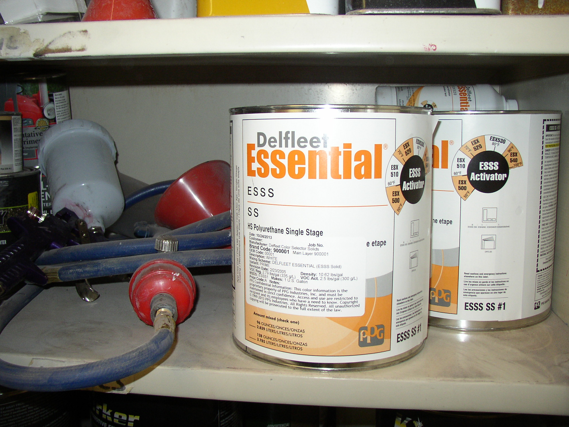

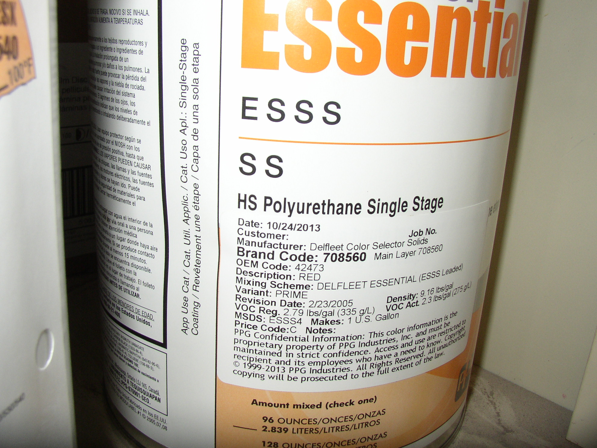

I took a second mortgage on my house and bought the final paint, PPG DelFleet one stage urethane, a gallon of white and a gallon of red. What's funny is the chip charts had at least a dozen formulas that were close enough to virtually interchange, but the prices across those dozen (almost identical) colors varied by $130/gallon. WTF?

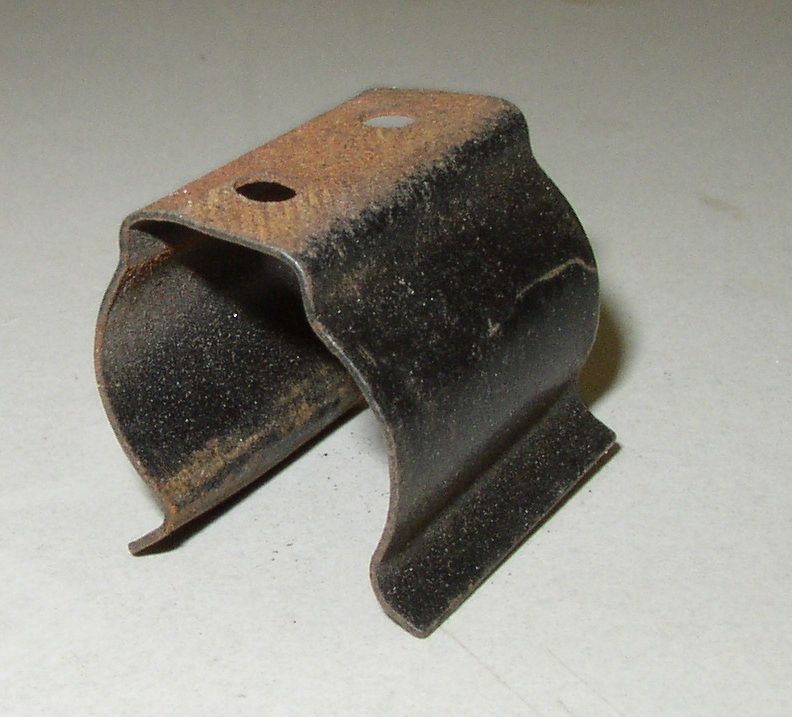

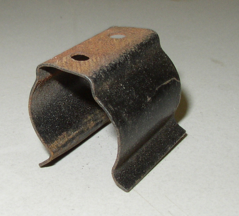

Does anyone know what this is for? It's a (OEM?) clip that was on one of the rear seat legs.

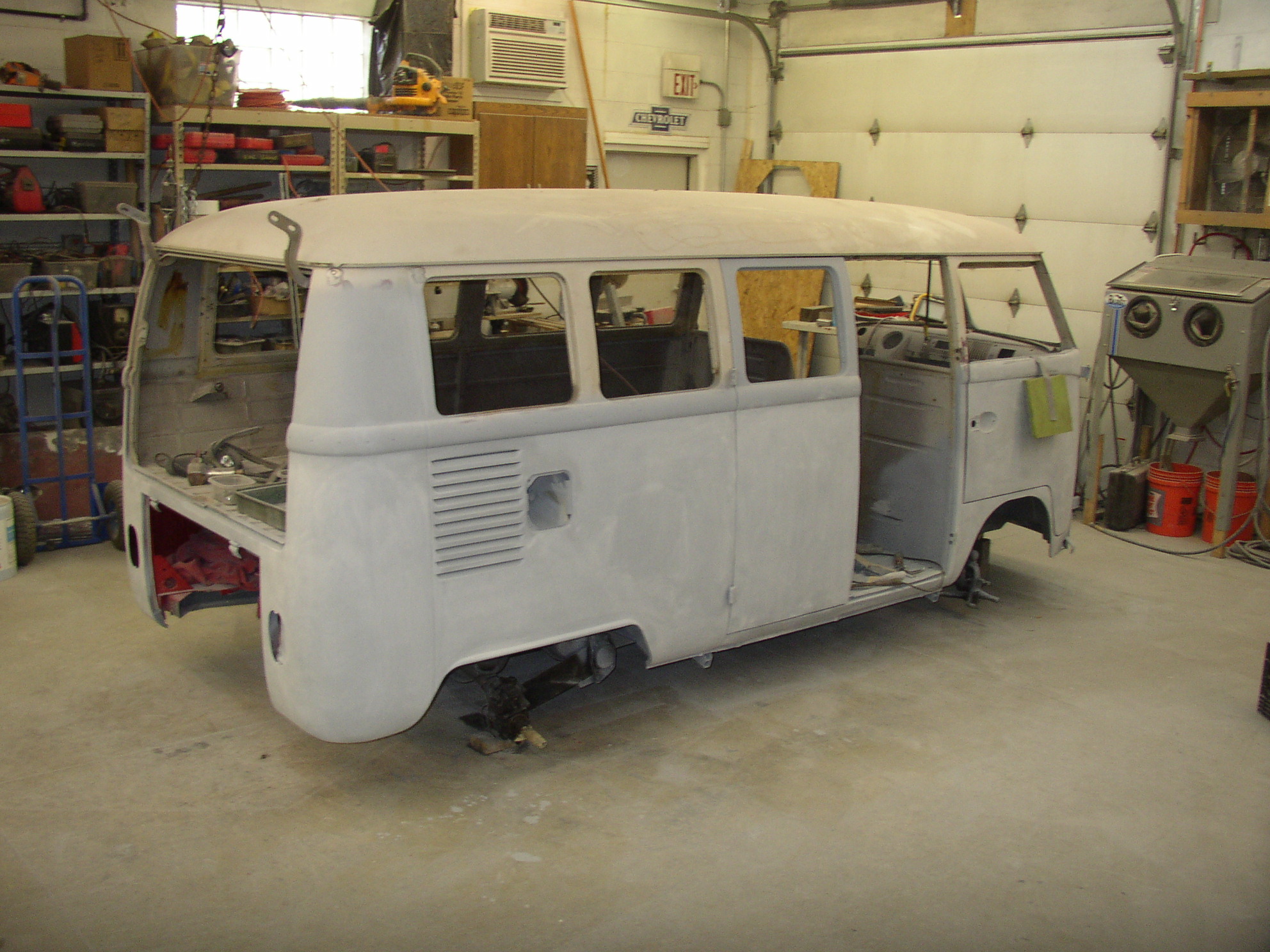

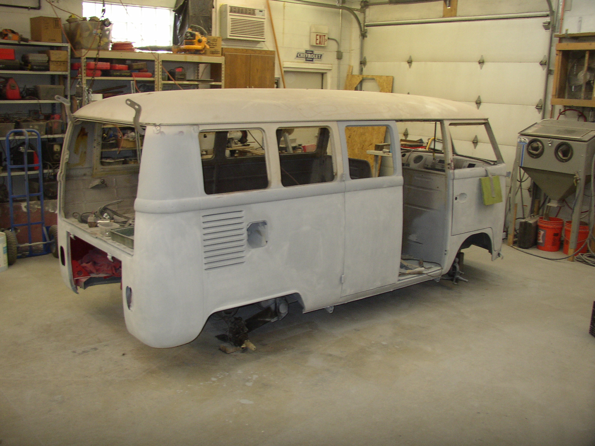

The bus doesn't look any different than before despite the work, so I'll recycle an old pic:
Probably about 460 hours right now. :roll:
