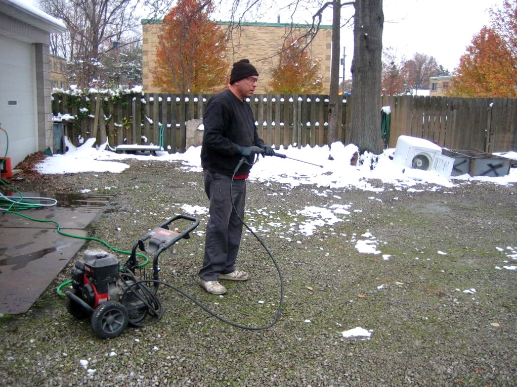

Push it outside and hit it with the power washer. Mind you, it was 28 degrees and the garden hose was frozen, along with me when I was done. I have plastic cork assortments so I corked all of the holes first.

DAMN THING IS ALL FROZE UP - - - - - NICHOLAS ! ! ! - - NICK, DAMMIT NICK STOP HIDING IN THAT WARM GARAGE, GET OUT HERE AND GIVE ME SOME HELP ! !
