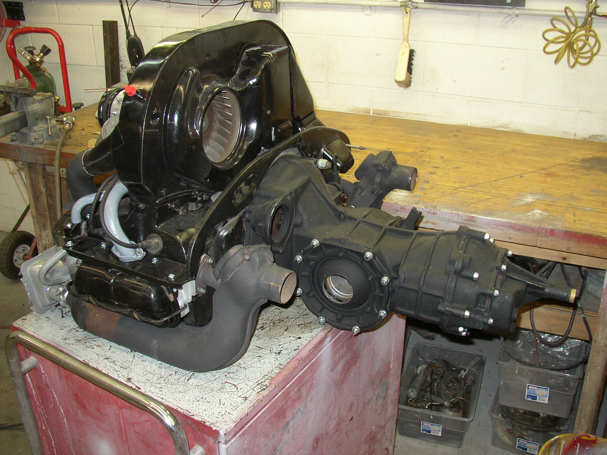

Good thing I test fit the tranny on the engine as the aftermarket tin had to be trimmed in several places or it would be trapped between the bell and case.
I put magnetic plugs in the RGBs, that's a lot of fuzz for 2000 miles. I'm thinking the left RGB has some big problems.... :roll:

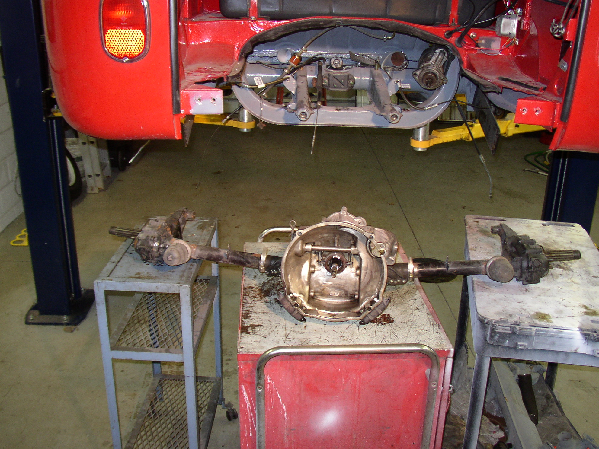

Pulling the engine is simple, unhook the shit, put the cart under it, lower the lift until it touches the cart and slide it out.
Then run the lift up. I'll keep this engine complete as a plug-in spare in case shit goes wrong. If I don't keep 20w-50 in it or rev it up immediately on a cold start it raps a couple of times so it probably has a rod bearing with ten thou of clearance in it. :lol: I didn't take any clutch pics yet but it wasn't as worn as I thought it would be after 2k of second gear starts. The engine bay and under chassis are very dusty from road dirt like I drove on dirt roads or something.
Now the trans. The shoes are dry but there was a teaspoon of fresh gear oil in each drum because it sat on the lift overnight with the axles hanging down. I'll change the axle seals again to hopefully cure this.

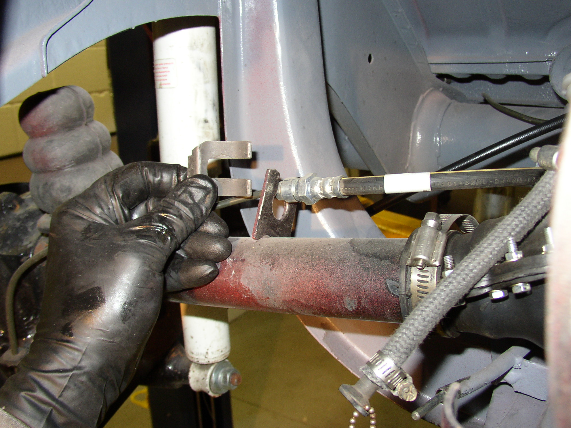

I was thinking I'd have to undo brake cables and hoses, but no- unhook the cables from the levers:
Pull them out of the backing plate...
Unclip the brake hoses from the axle tubes....

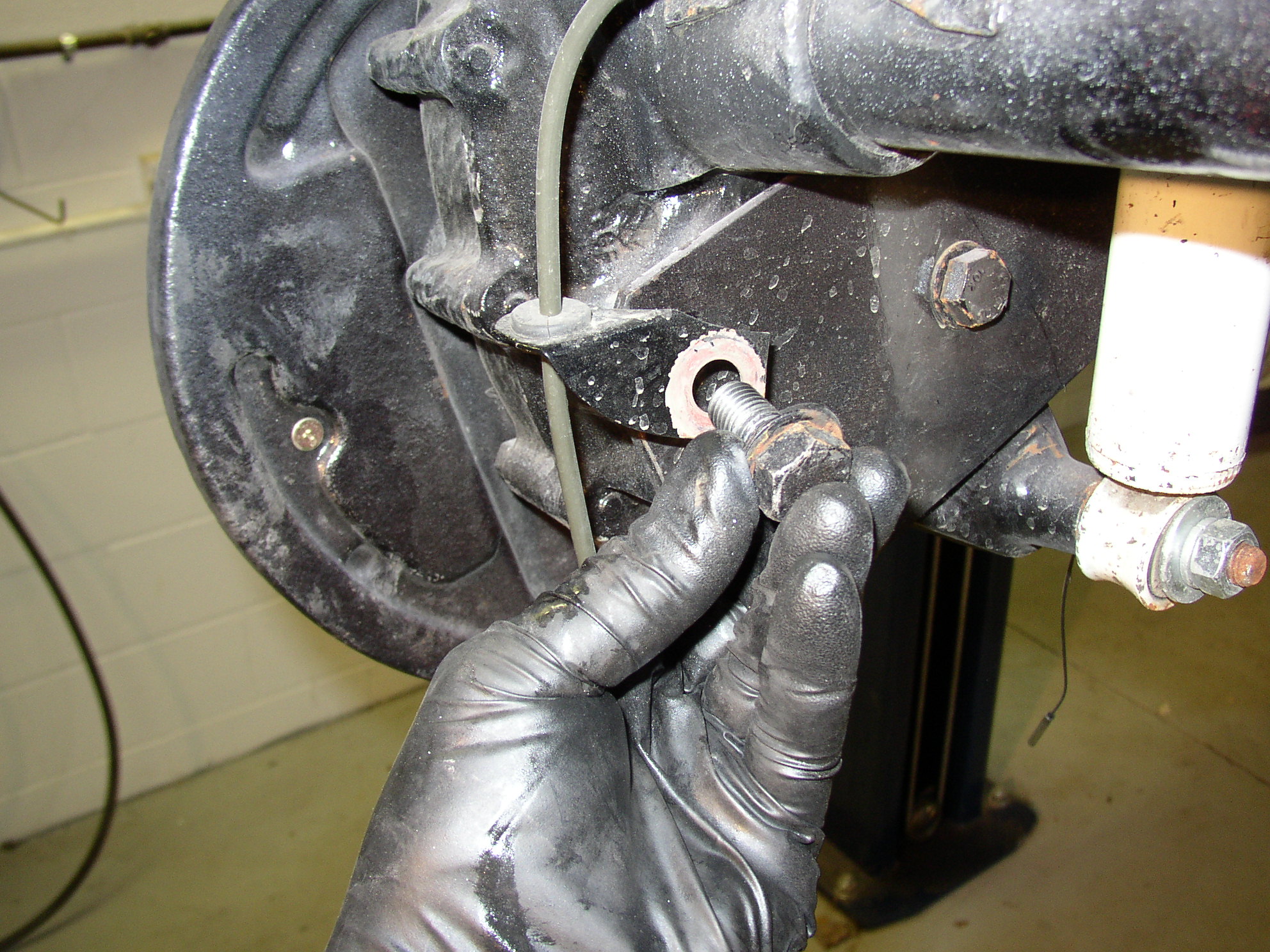

Pull the one bolt from the brake line retainers on the RGBs...

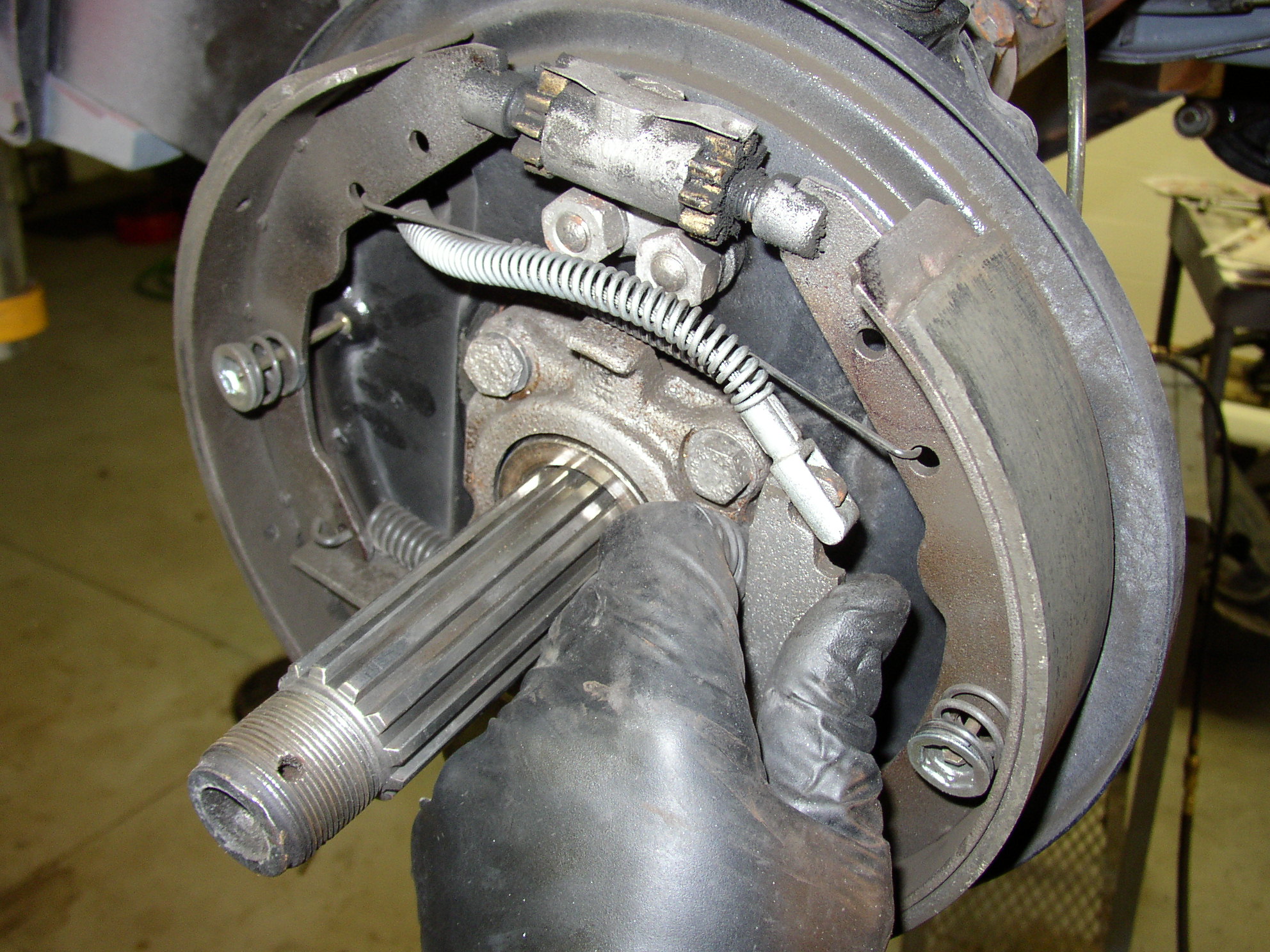

Simply pull the backing plate over the axle stub and hook it up with a bungee hook on the torsion tube.
Unbolt the starter, leaving the wires in place and bungee it to the crossmember. Hmm, did I unhook that battery cable?
OK, the mounts, shifter, ground strap, and everything is disconnected, pop it loose with a prybar and it's just sitting there looking stupid right now.
Place three carts, drag it onto them, and roll the carts back
Ta Da! Exit, bitch.
Having everything organized should make installation easier. This is like working on a brand new car- 2.5 hours to get the motor and tranny out and that was taking my time, if I hustled I could have done it in half that time. It should only take 2.5 to put it back in, right? ;)
Next- swap the axles and stuff it back in. I have extra parts in case those RGBs aren't so healthy.

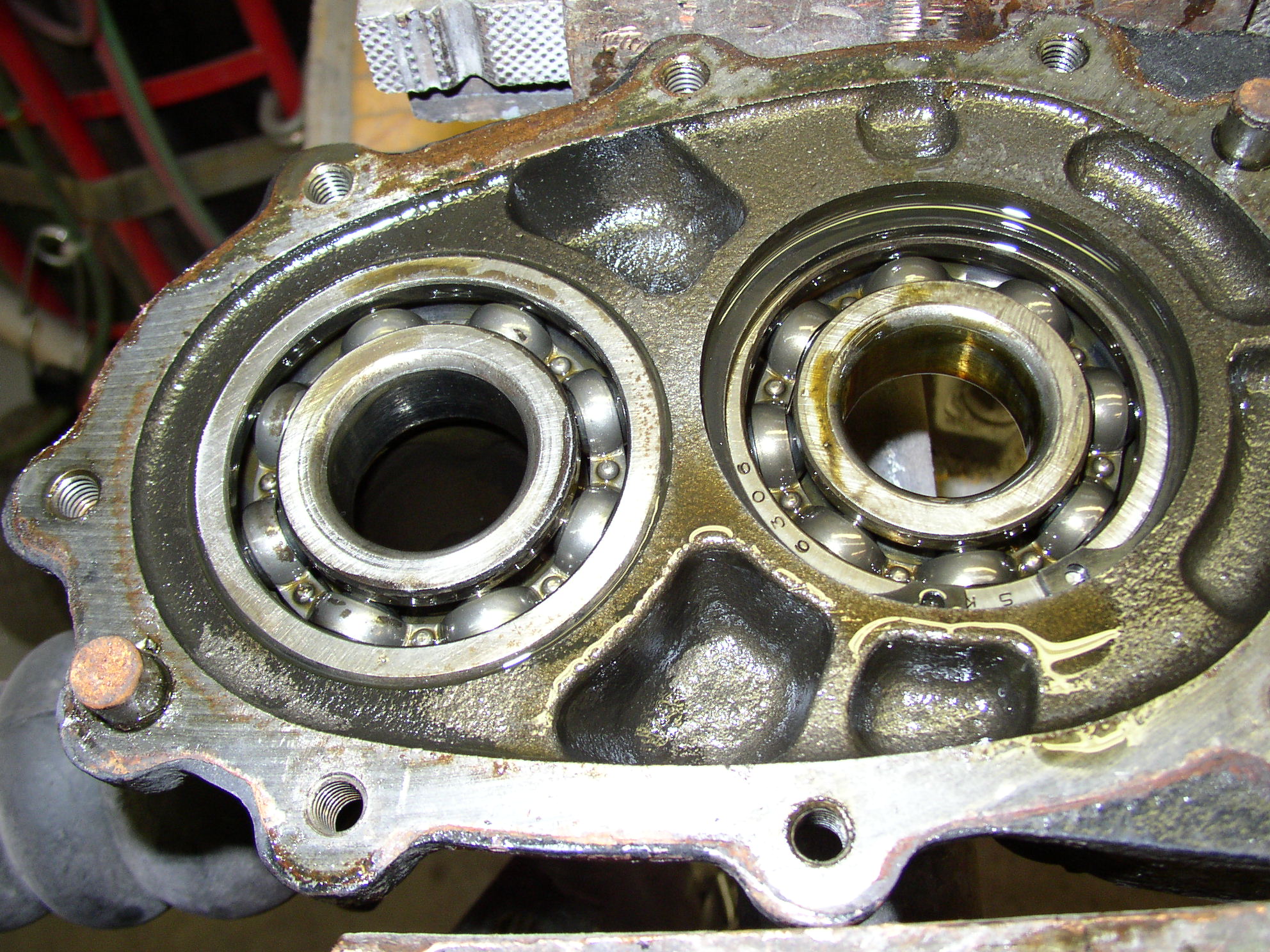

OK, tranny’s out, time to swap the axles onto the new trans from Rancho. First, set it up where you can work on it, I use a cart and a block of wood to raise the hub. I used the Bentley as a guide to do this so it’s pretty straight forward but I don’t have the 5 grand worth of specialty tools that it calls for.
Zip the bolts out and use a soft hammer to break the seal and walk the outer housing off. The outer axle bearing is a mild press fit into this housing so it won’t slide off.

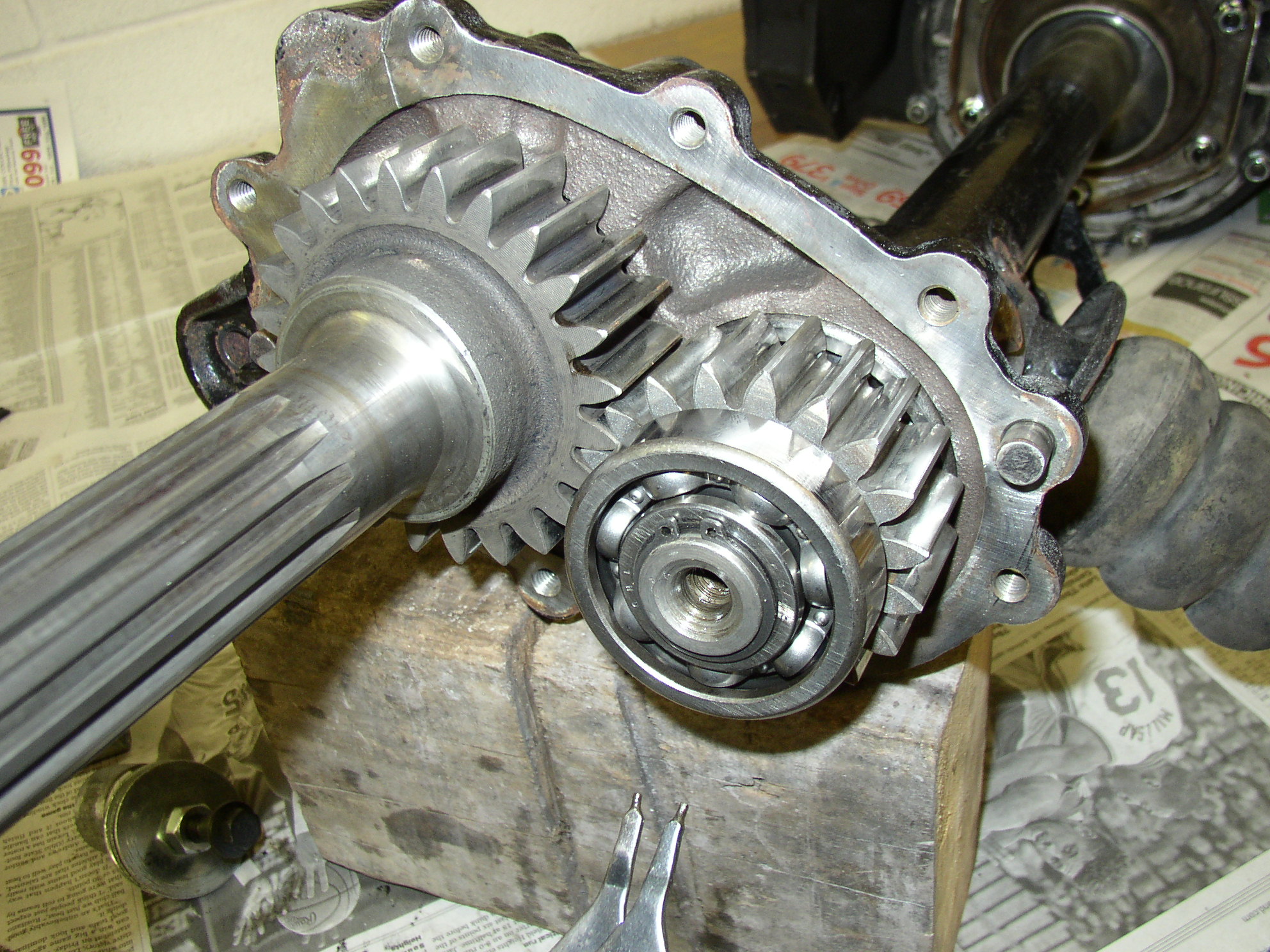

Once the housing is split, there’s a snap ring on the axle end that must be removed.

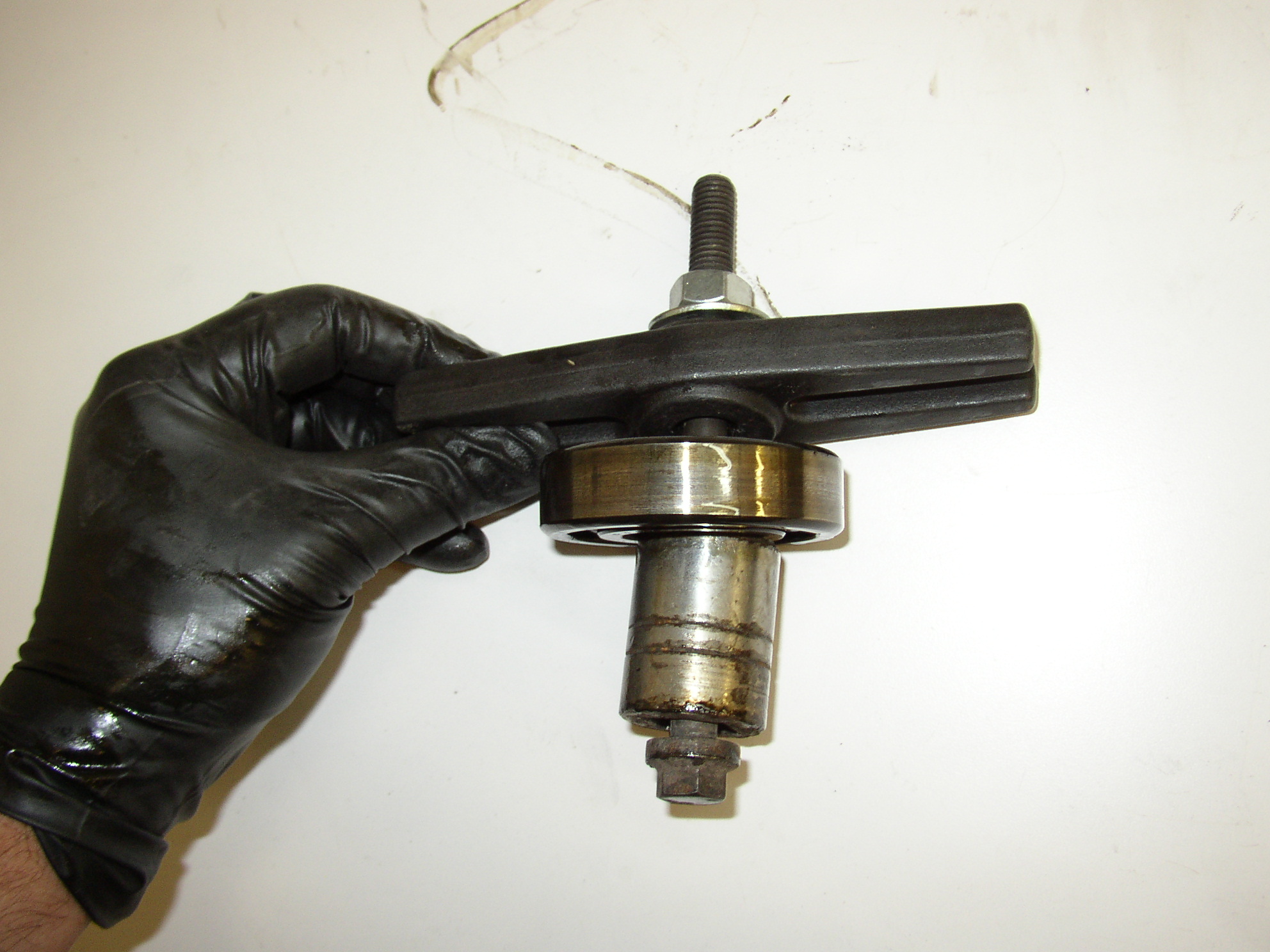

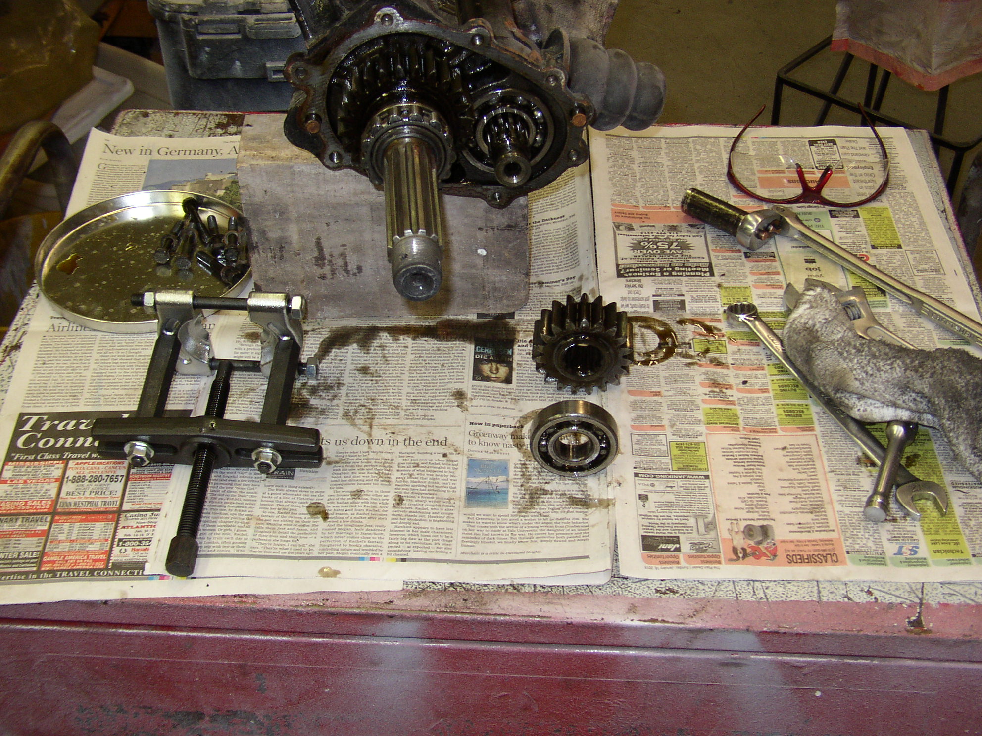

Then the outer axle bearing is press fit onto the axle, I set up a puller to get it off.
The gear is a slip fit so remove it with your fingers.

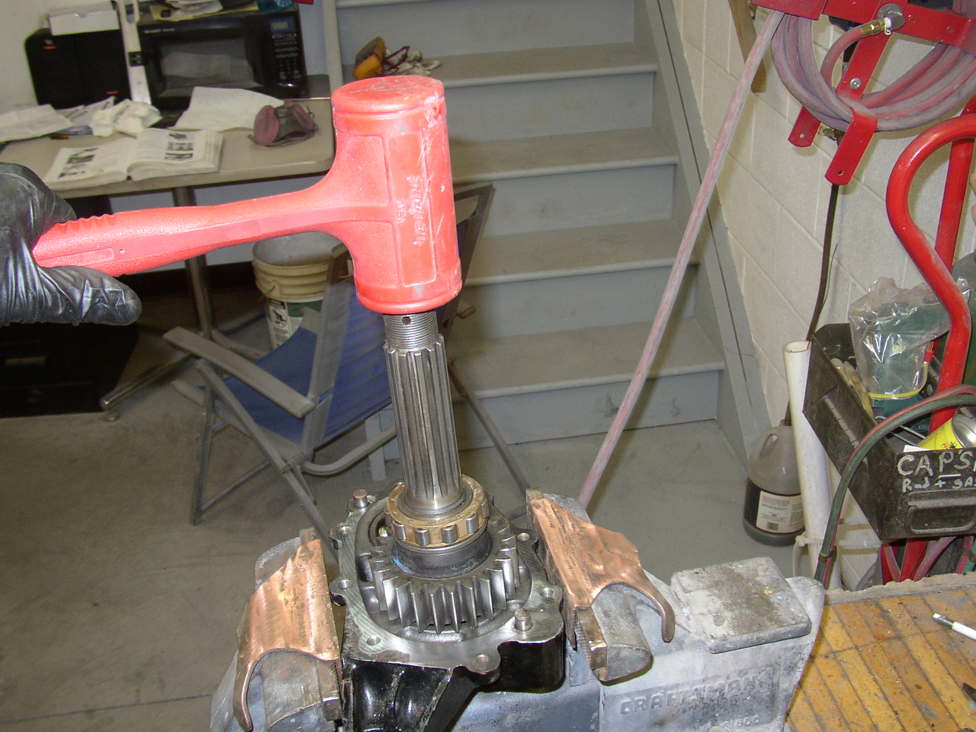

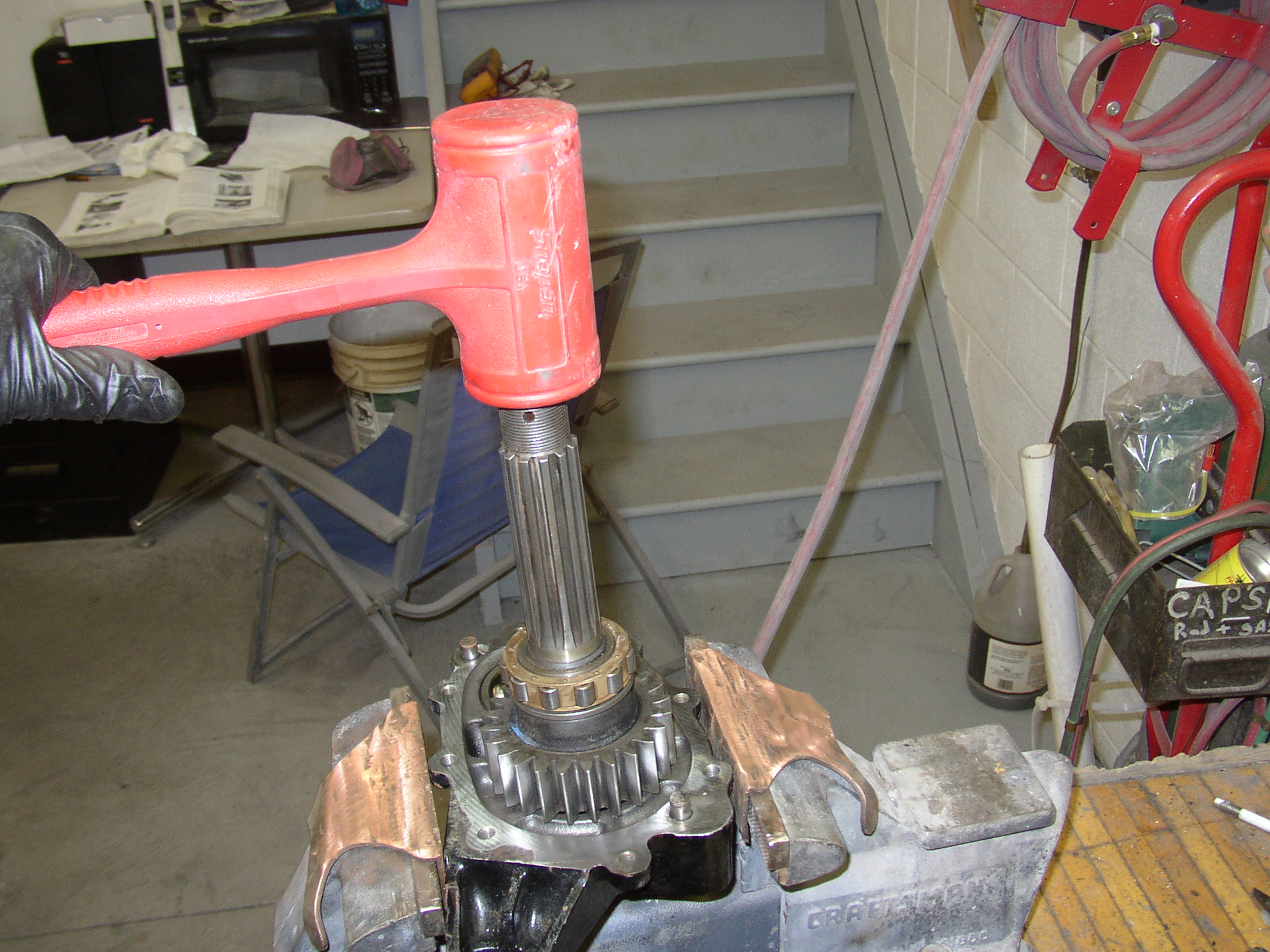

The inner bearing is a press fit onto the axle so start it by using a soft hammer on the back side of the housing to get the bearing moving. If it’s too tight it’s easy to set up a puller across the housing to push the axle stub through.
Once the axle housing is broken free of the bearing, slide if off the axle and set it aside. The axle is now retained in the diff by the side gears using a snap ring and variable dimension thrust washer

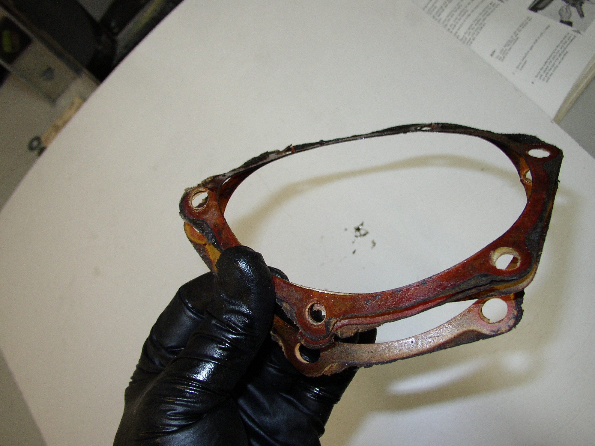

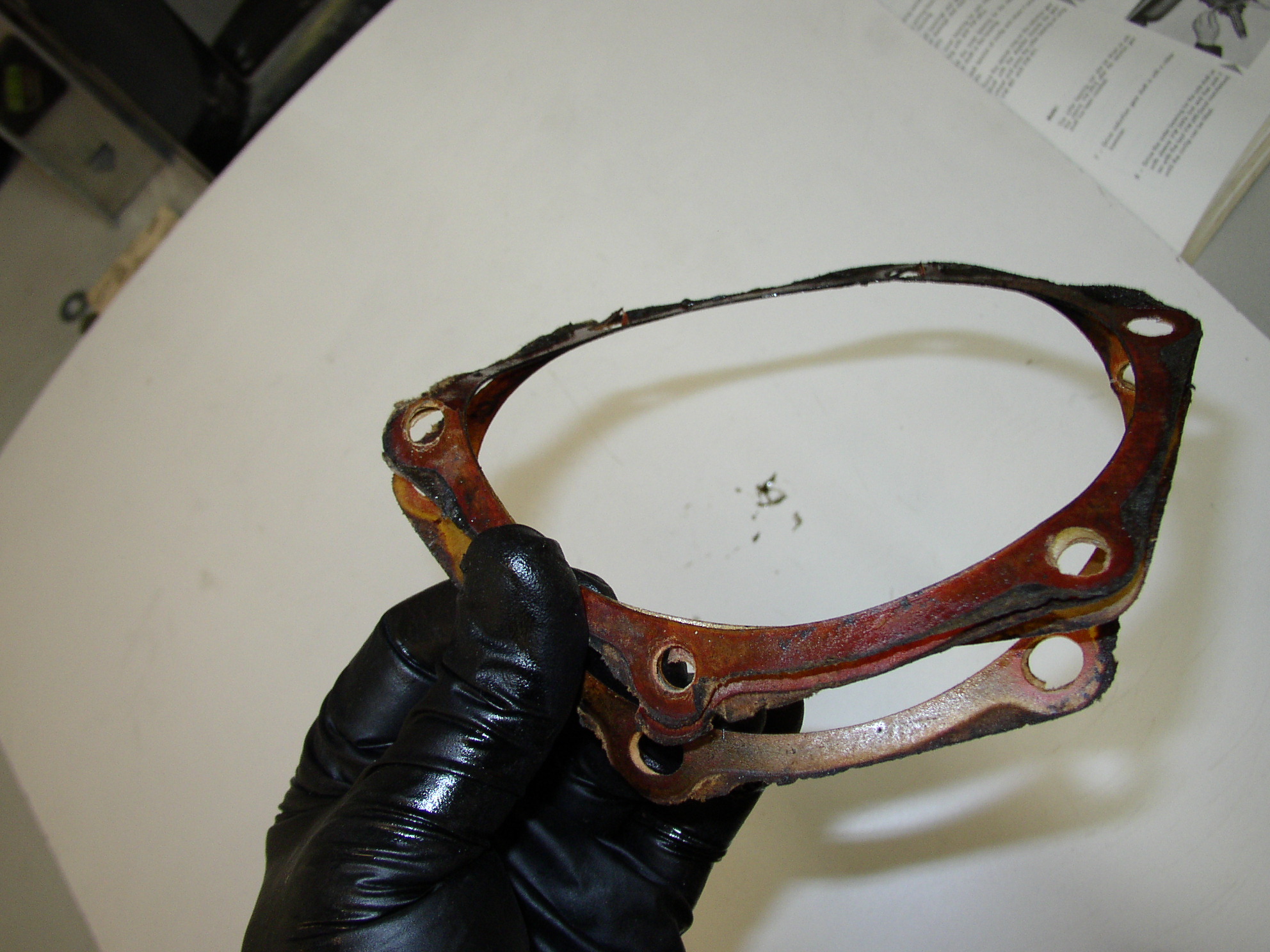

You’ll notice there is a stack of gaskets between the retainer plate and the side cover of the trans, this is for setting the end play/drag of the axle tube, more on this later.
This was the other side- the frigging plastic shim/thrust bearing was missing in the trans! It should have made a clunk on turns and maybe shimmied or wandered going down the road but I never noticed it. The thrust shim is a spare I ended up using.
So how do you decide you need 4 gaskets when the end play is 1/4"?

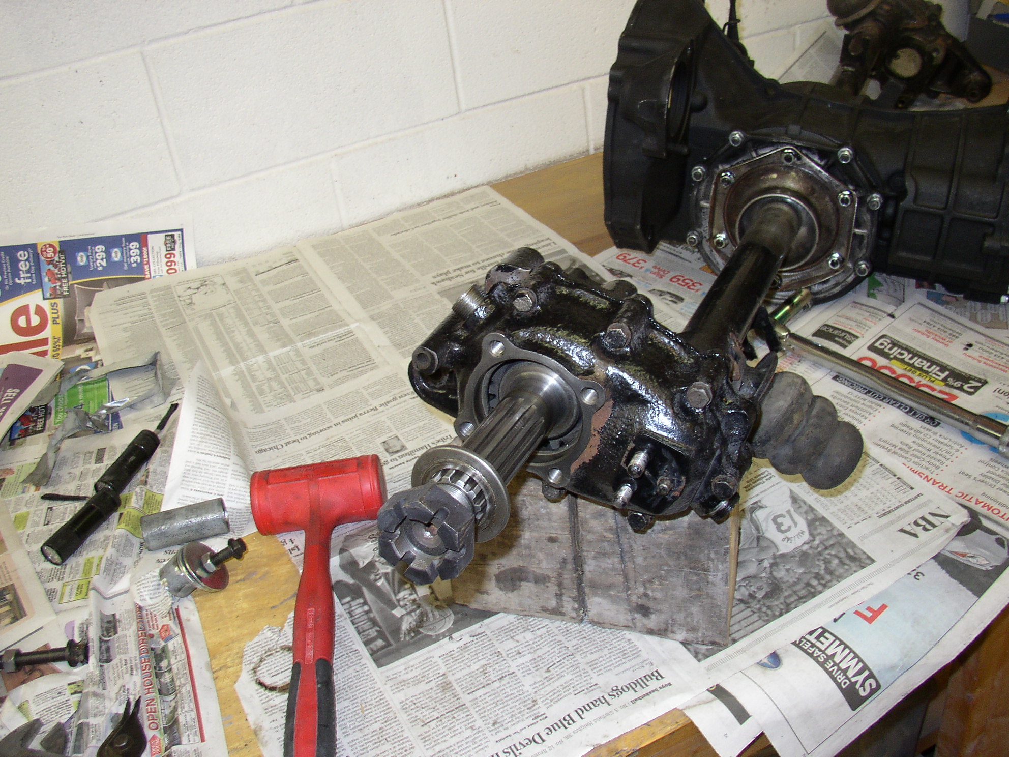

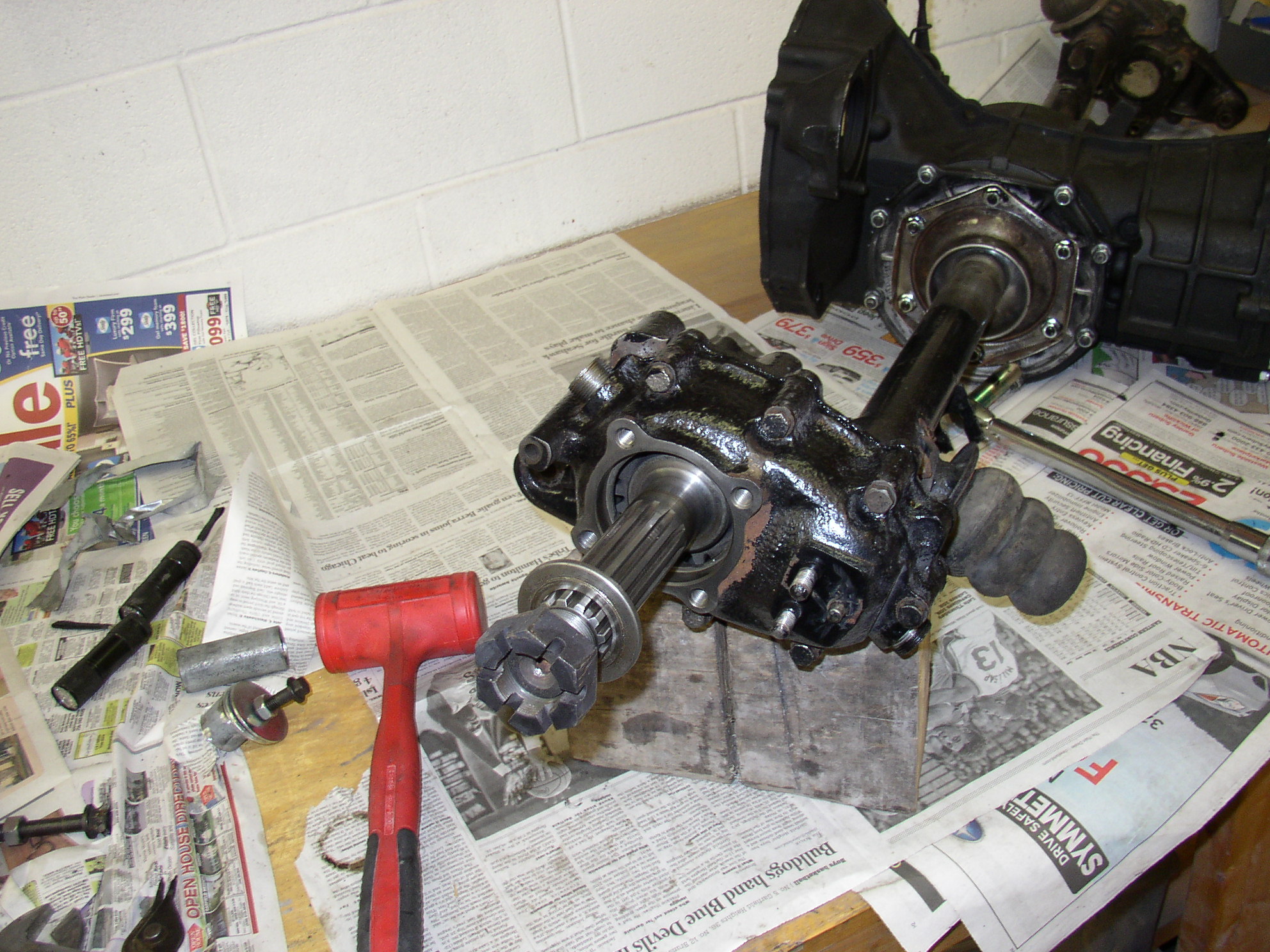

Set the axle tube in a vise and remove the freeze plug on the back of the stub axle. This requires welding a nut or bolt to the plug and extracting it with a puller. Tighten the nut and it pulls the freeze plug out. Use a whizzer wheel and grinder to seperate and clean up the freeze plug for reuse.
Once the freeze plug is out there will be a large retainer nut on the back side of the stub axle, use a center punch to uncrimp the retainer crimp that locks it in place.
Then you’ll either need a 1 5/8” socket or a special 4 tab socket, depending on what your axle has to remove the nut.

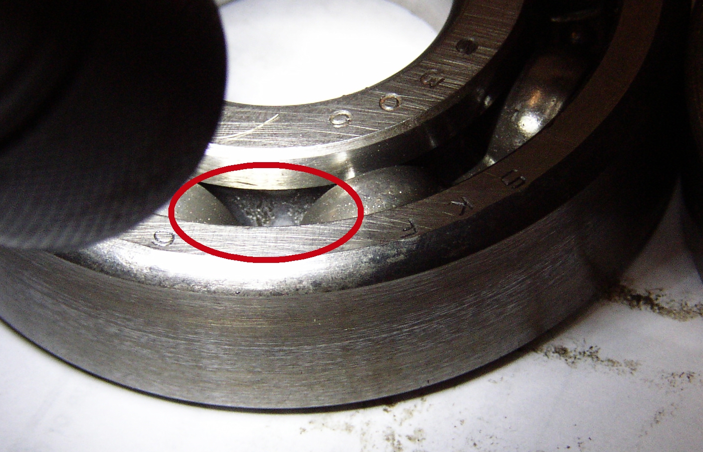

I cleaned all of the bearings I had (3 sets) and picked the best ones to use. A whole bunch didn’t even make the “maybe” pile, the races were pitted quite bad.
Here’s a pitted one.

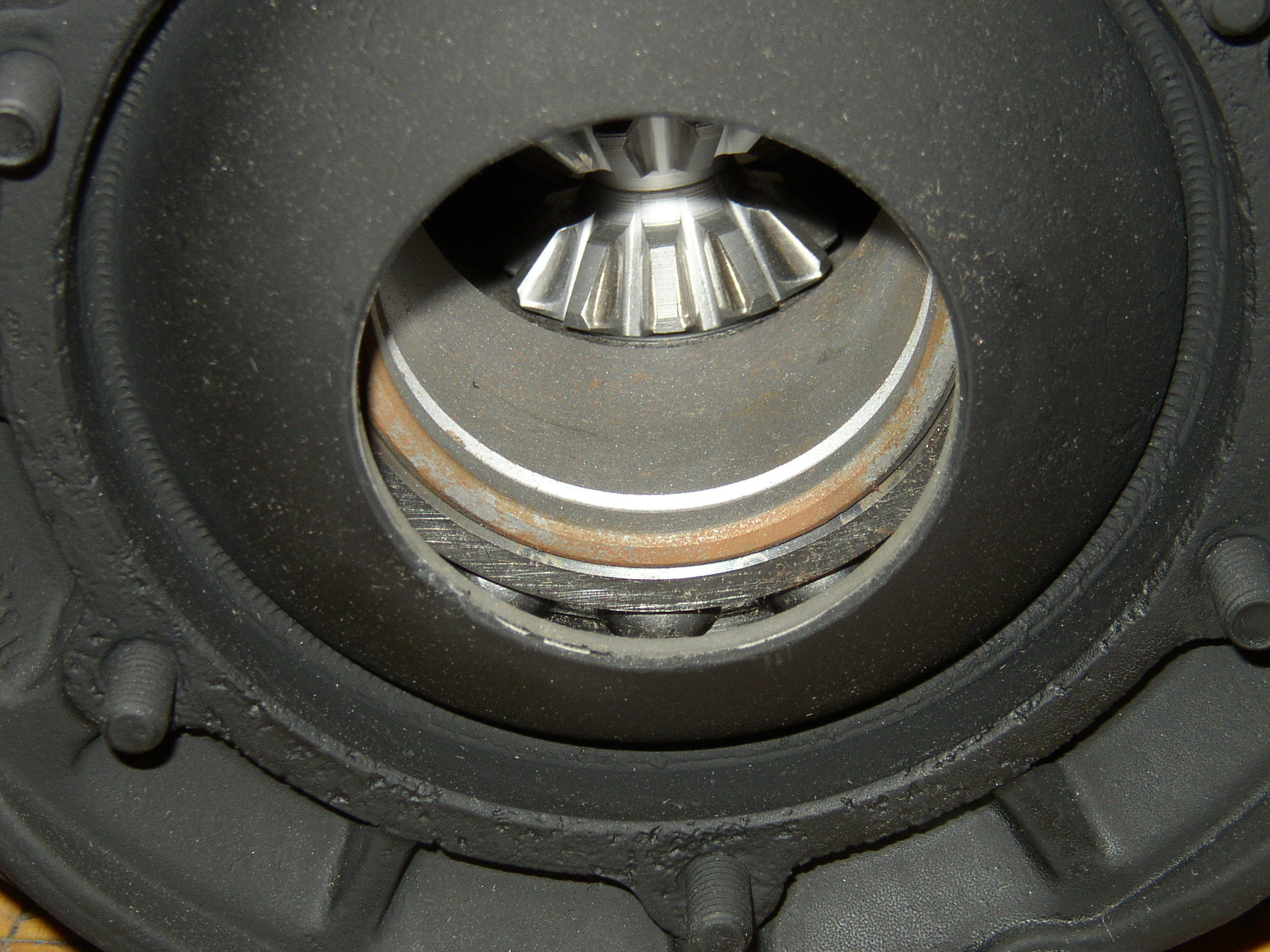

Check the side gears for cracks and the fulcrum plates for wear, the spec is .012" max, I could barely get a .006" feeler gauge between mine.
Put the axle/side gear/fulcrum plates into the tranny.
and lock ring.

Slide the tube in place which already has the inner axle bearing pressed into the tube and start knocking the bearing onto the axle shaft. It's a slight press fit.
When it stops with a hammer use a piece of 1" electrical conduit, fender washers, a long 10mm bolt and nut to pull it into place.
The gear is a slip fit.
Pull the outer axle bearing onto the axle using a piece of conduit, bolt, nut, and washers.

Seal the gaskets with FIPG.
Here I've cleaned the parts thoroughly with a wire wheel, solvent, and brake clean. I ended up using 3 gaskets to get the tension set right. Here I'm dry fitting everything before slopping the sealer on.
Torque to 18.
There should be some drag on the axle tube when it pivots.

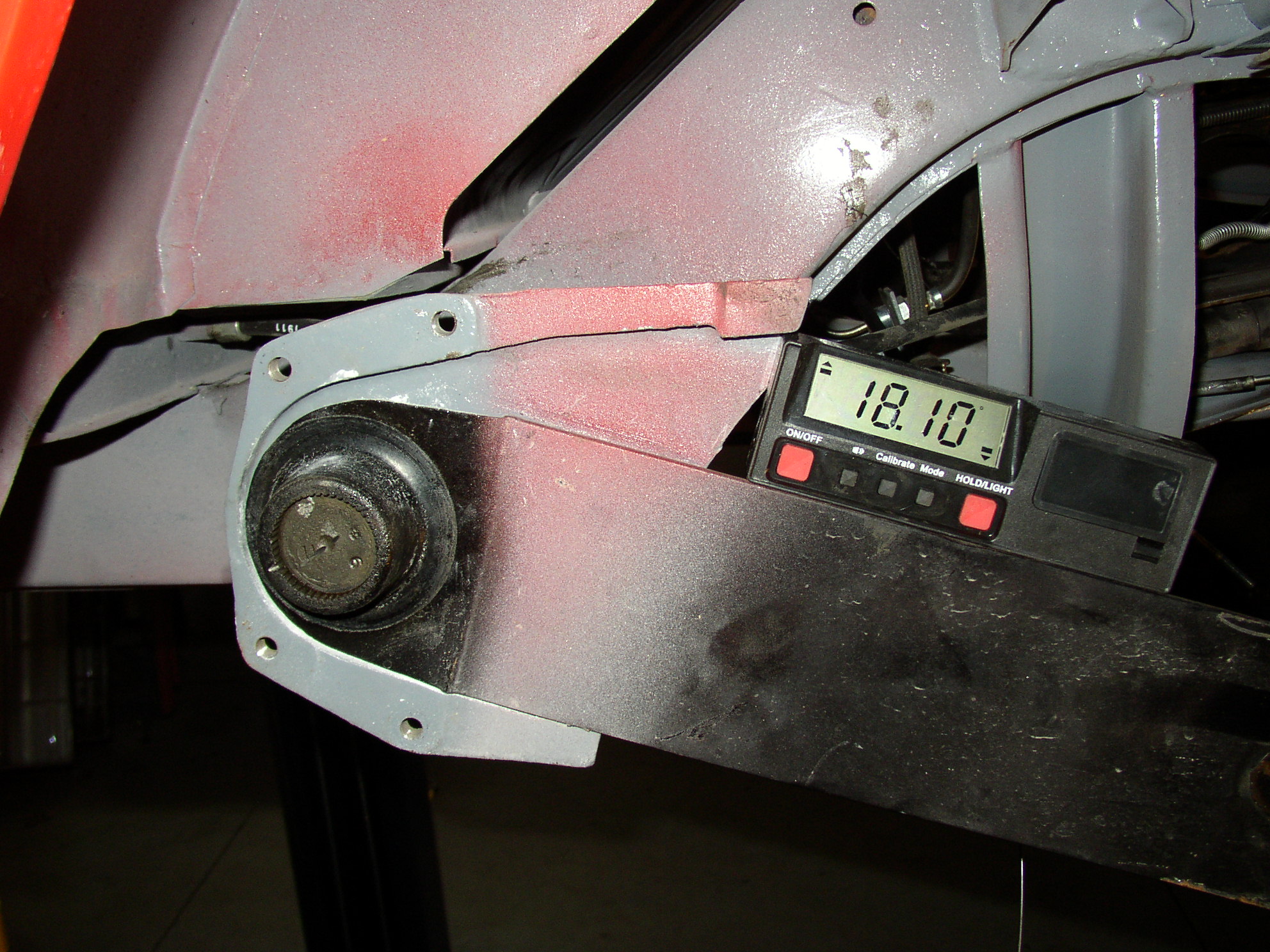

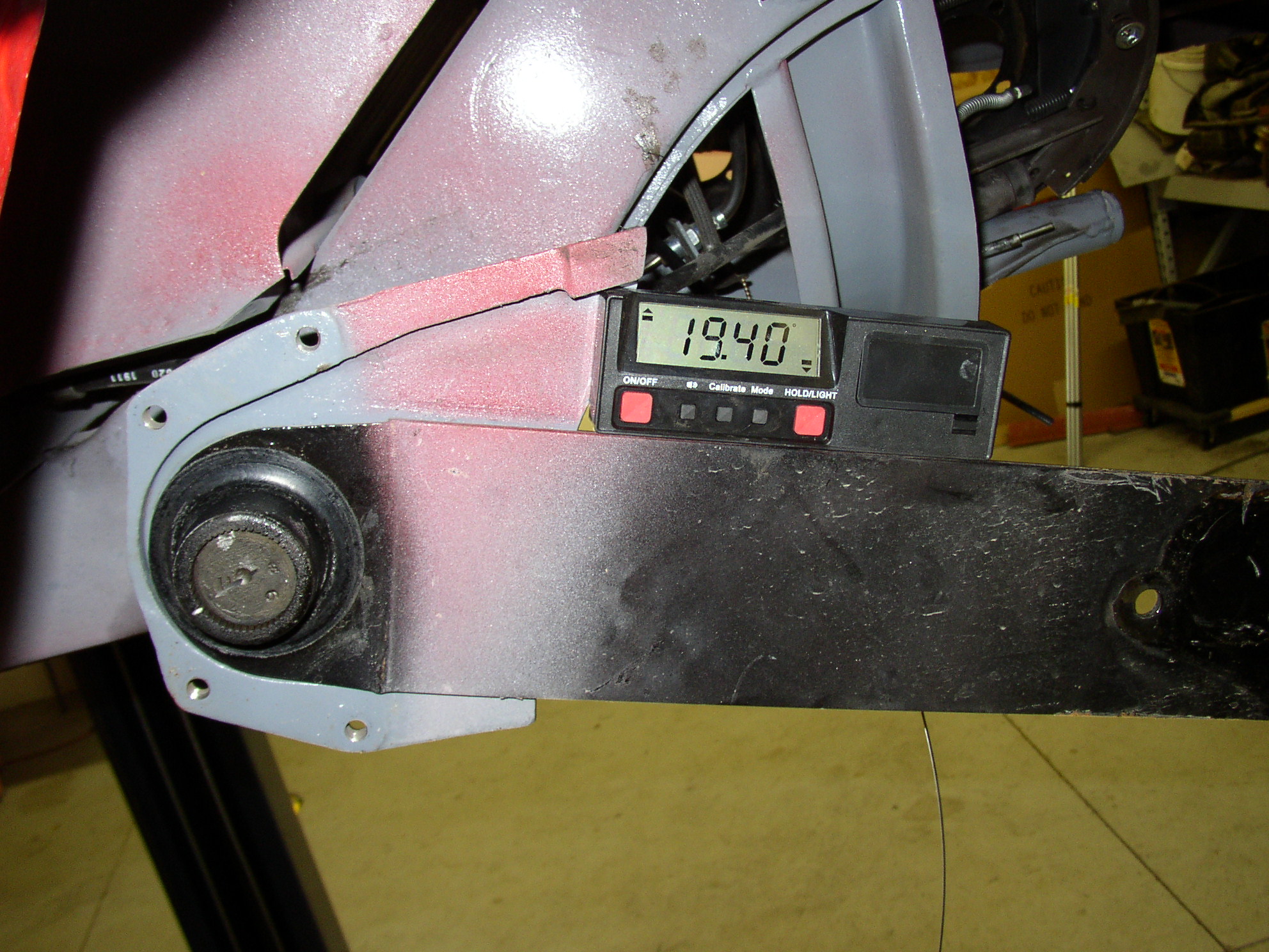

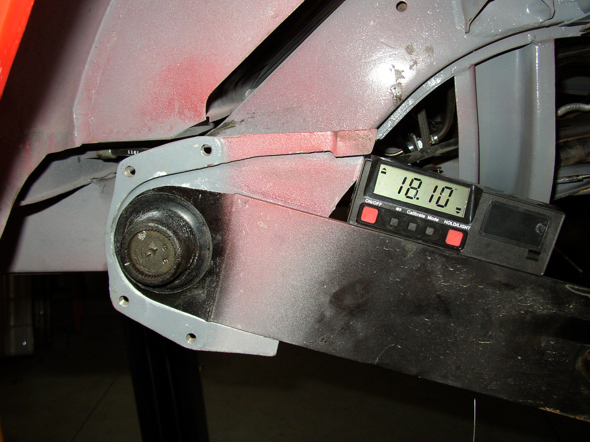

I'm going to reset my torsion bars a bit because I have about 3-4 degrees positive camber on each rear wheel.
Pull the cap to find the torsion bar walked out and was rubbing the cover.
That might be my weird squeak.
Pop the bar over the bump stop.
I used to use one of these....
But recently stepped up to a digital version for $20 from Fleabay.
Look at the handy dandy chart that Tom at ECC linked me.
Let's lower it about 2.9*, which should change my camber about 2.5* if my calculations are correct.
Repaint the parts and put it together, repeat for the other side.
