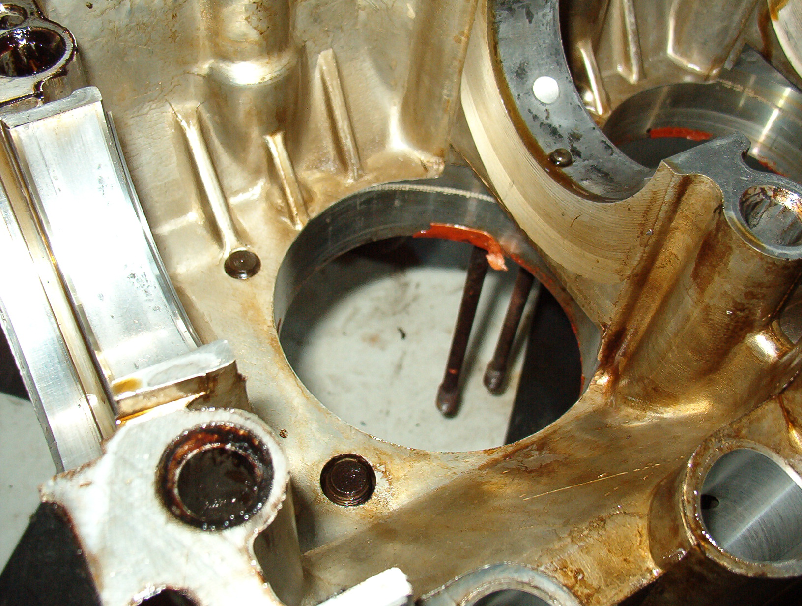

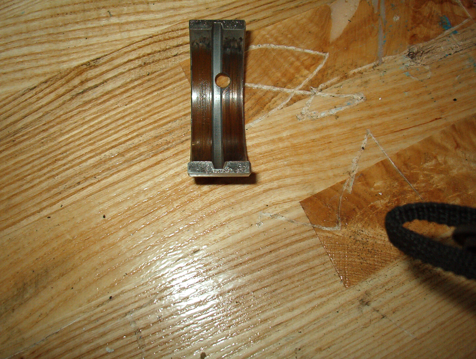

A few pics. After teardown,began to inspect. Center main bearing looked like this. Also was sloppy in the bearing saddle and dowel hole was ovaled . This bearing was definitly moving.
At first I thought that the case would need align bored. Took a NEW standard bearing and it fit nice and tight. Looks like the back side of the bearing took the beating.

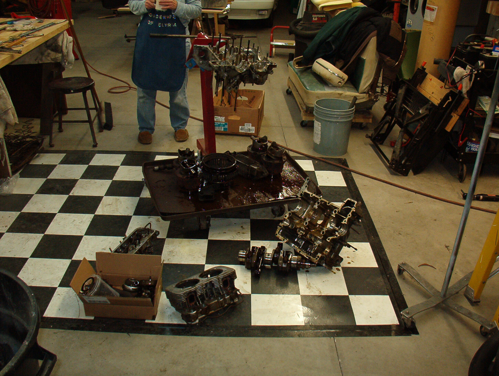

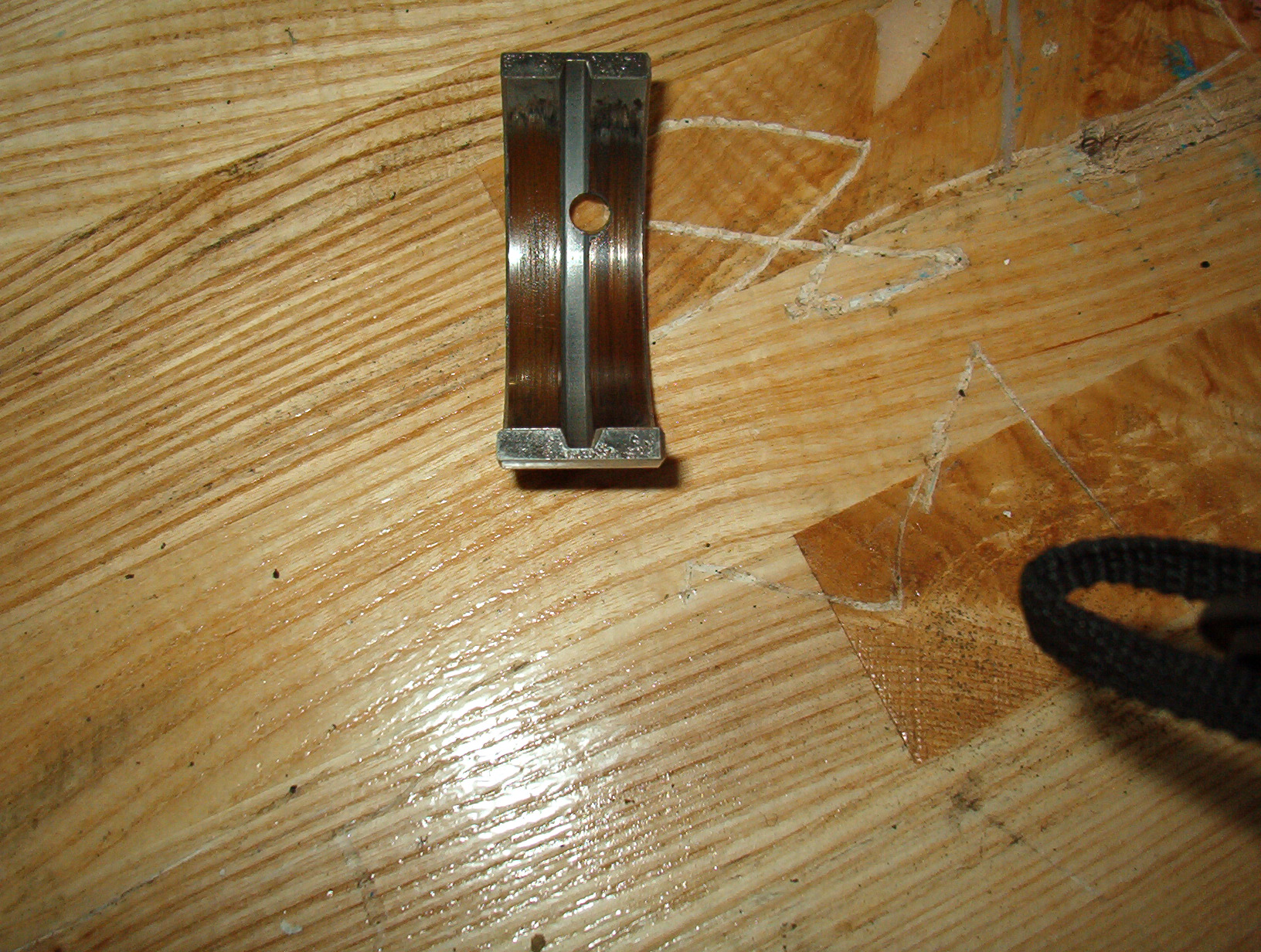

we will be pulling all the oil galley plugs and tapping them prior to going to the machine shop for a thourough cleaning.
More to come in a couple weeks when we get the crank back from DPR for welding counter weights and balancing.
