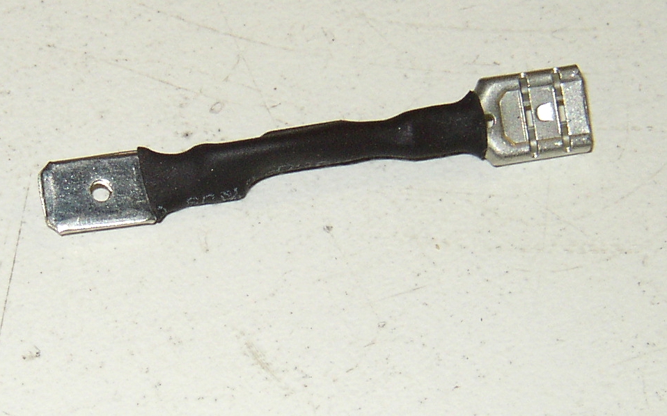

I know you can run a 6v fuel gauge on 12v but I like to install a resistor. I know from prior experience it's a 162 ohm resistor because I bought a pack of 10 a few years ago. :D Here's a nice way to install it with a male and female spade so it goes in series on the power lead on the back of the gauge. When I tested this on my bus the voltage at the gauge was exactly 6v. This makes the gauge more accurate as it loses some of its accuracy running on 12v.

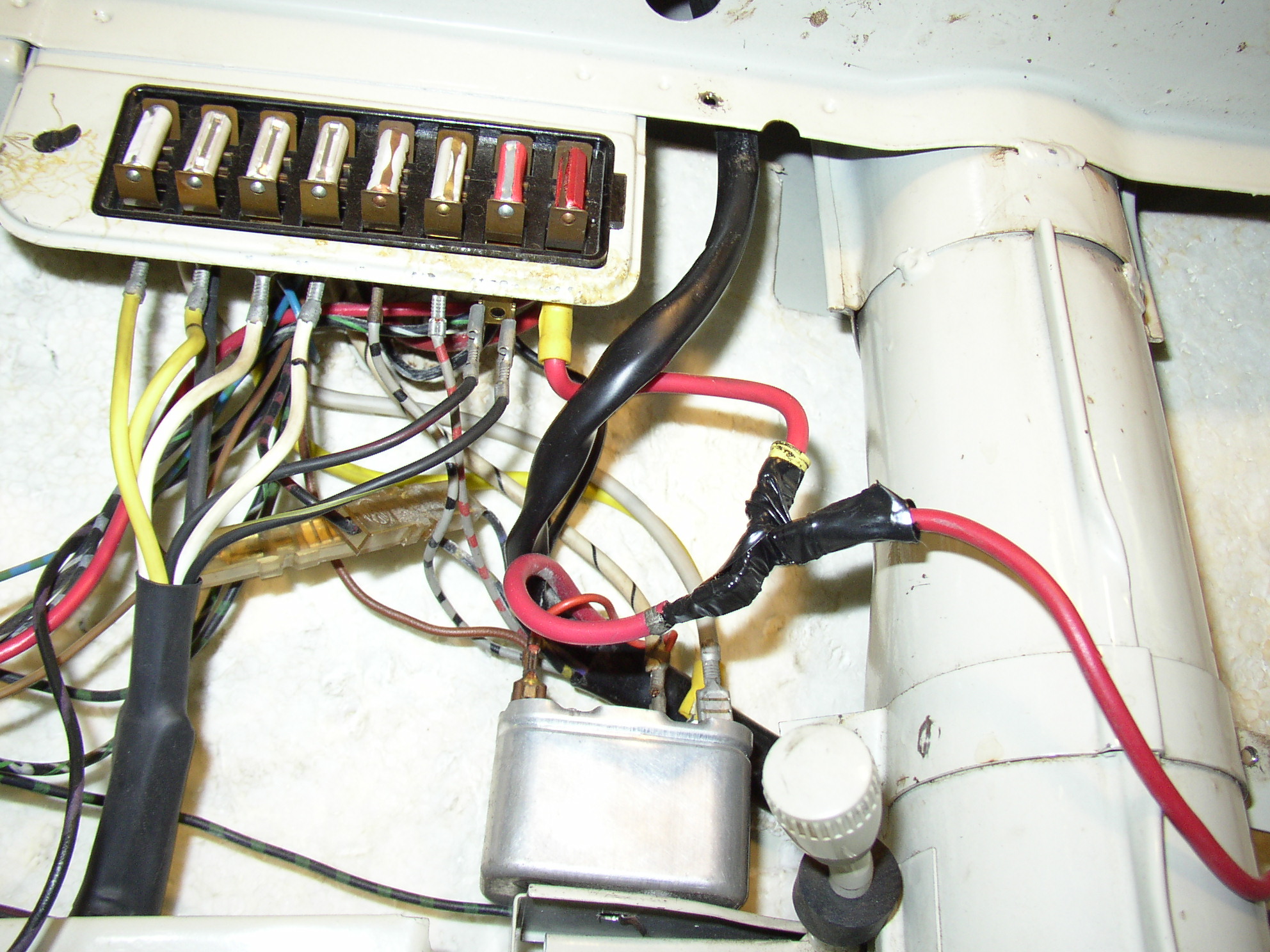

Let's clean up some wiring by the fusebox. I got rid of this splice and soldered in a new power split so the ignition switch won't suffer voltage drop.
Here's the soldered joint,
With two layers of marine heat shrink tubing over it.

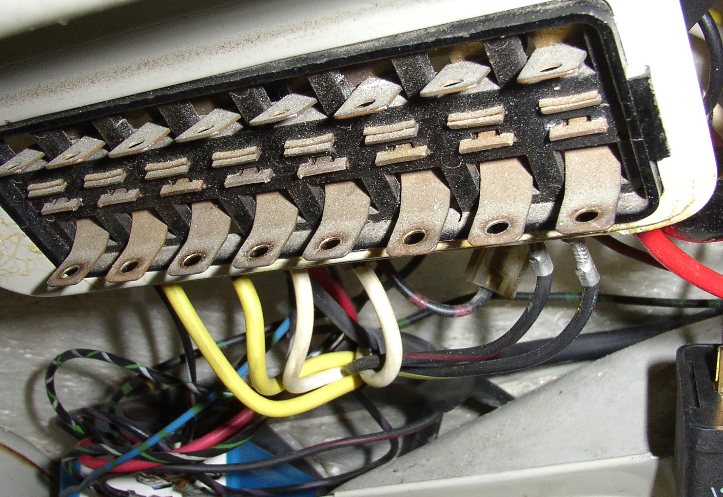

The fusebox was also grungy,
Clean these with a brass wire wheel in a Dremel.

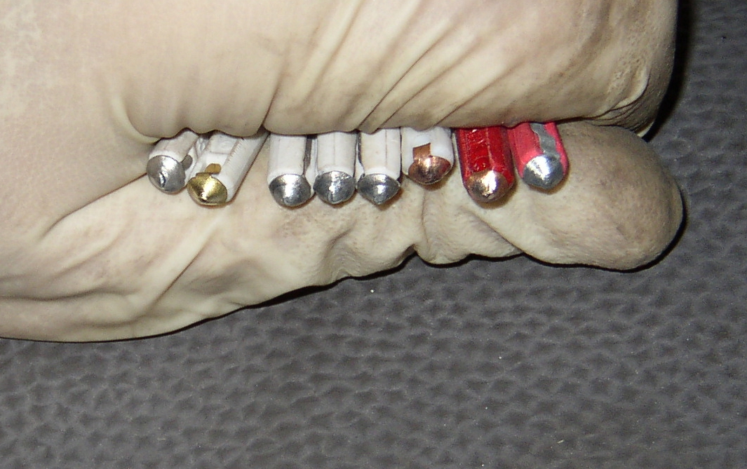

And polish the fuses, too. VW's are notorious for problems in this area.

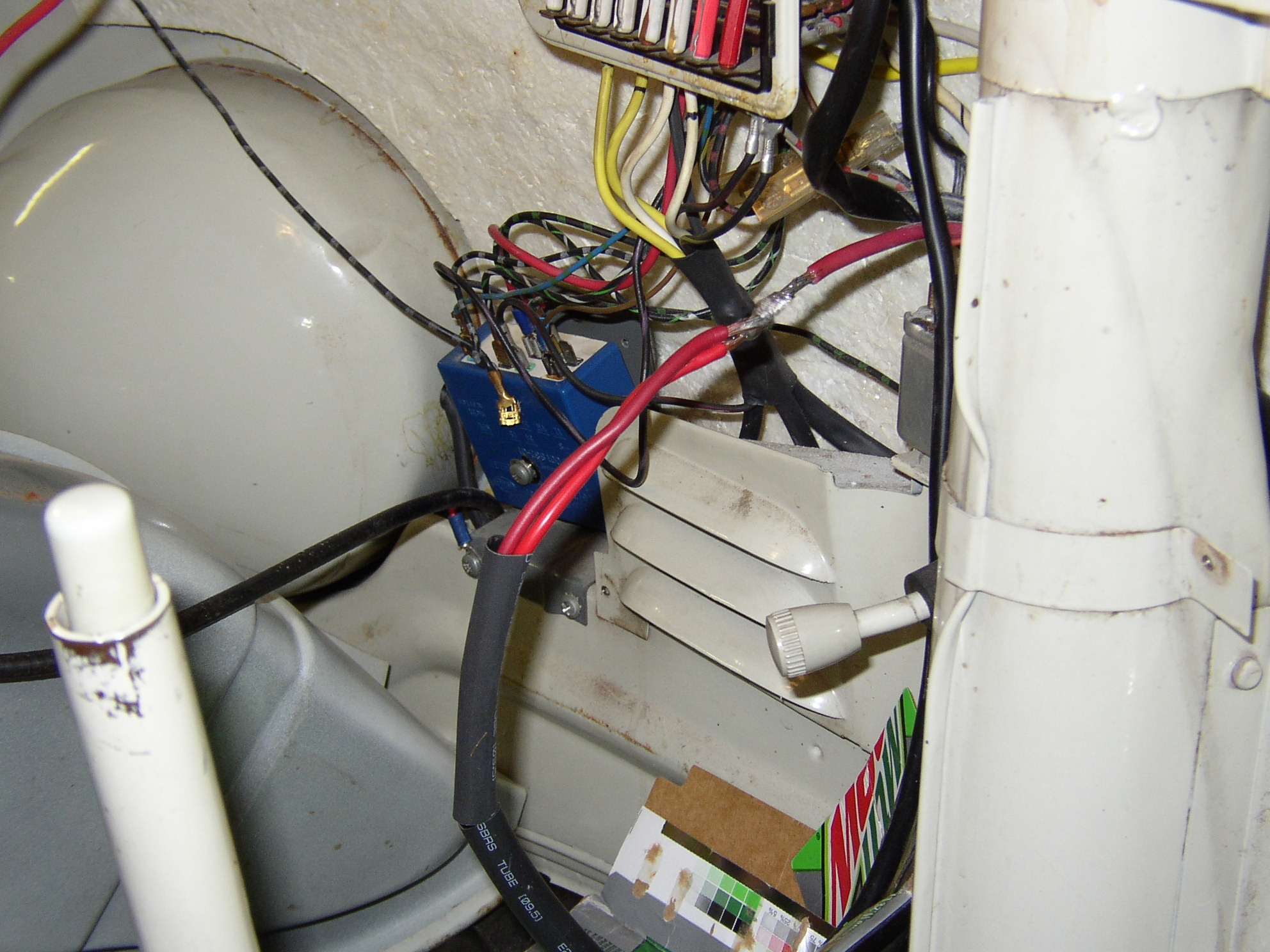

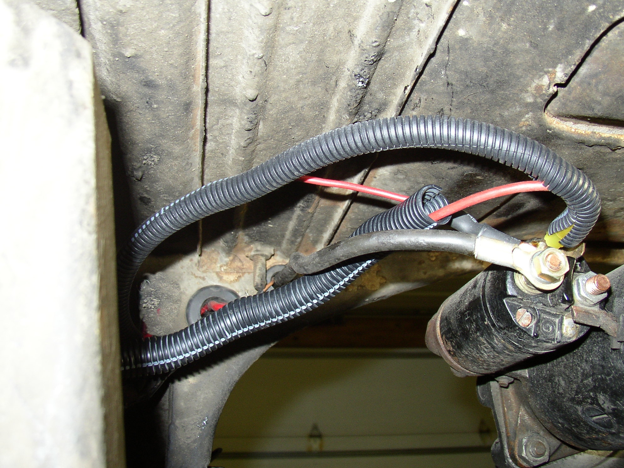

Let's pretty up things back by the starter. All new terminals here but the main power feed is hidden by the battery cable. It has 2-10 gauge feeds soldered and shrink tubed into a copper eyelet, better than OE.

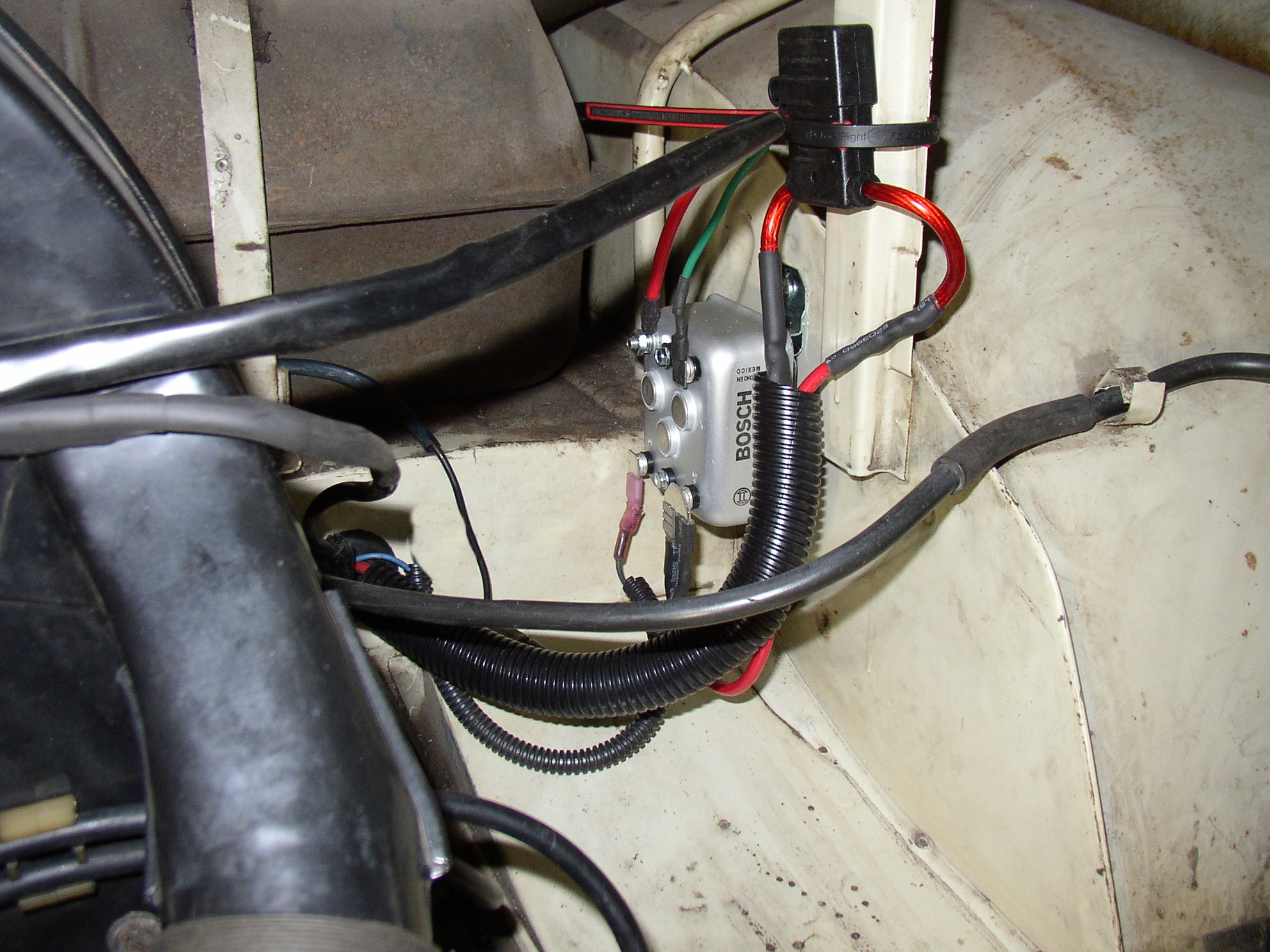

The voltage regulator bolts here but I won't bolt one onto paint so let's buff the metal clean.
Here's the wiring prettied up on the regulator. Lots of splices here as the wiring was toast from heat and age, and every splice is soldered and shrink tubed. I installed a 40amp MaxiFuse to protect the 10ga hot feed going to the dash. If the ignition switch comes loose, or the headlight switch comes loose and shorts on sheetmetal, or the fusebox comes loose, this will stop the bus from burning. That's a rubber covered reusable ty-wrap holding the fuse.

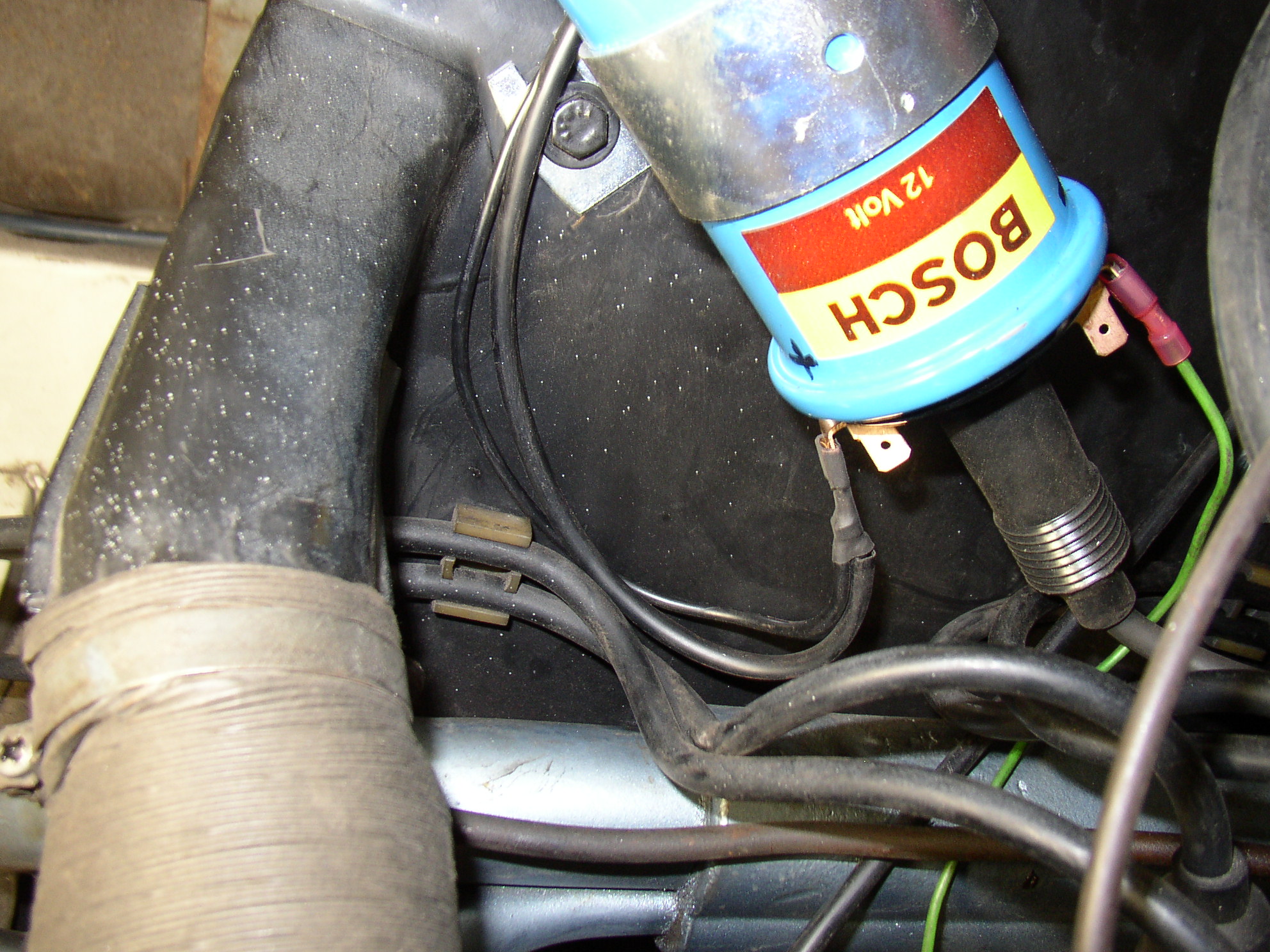

I installed a newer reman German 12v generator, cleaned the commutator, installed new brushes and polarized it. I installed a good German 12v choke coil and ran it on the bench to make sure everything is good.

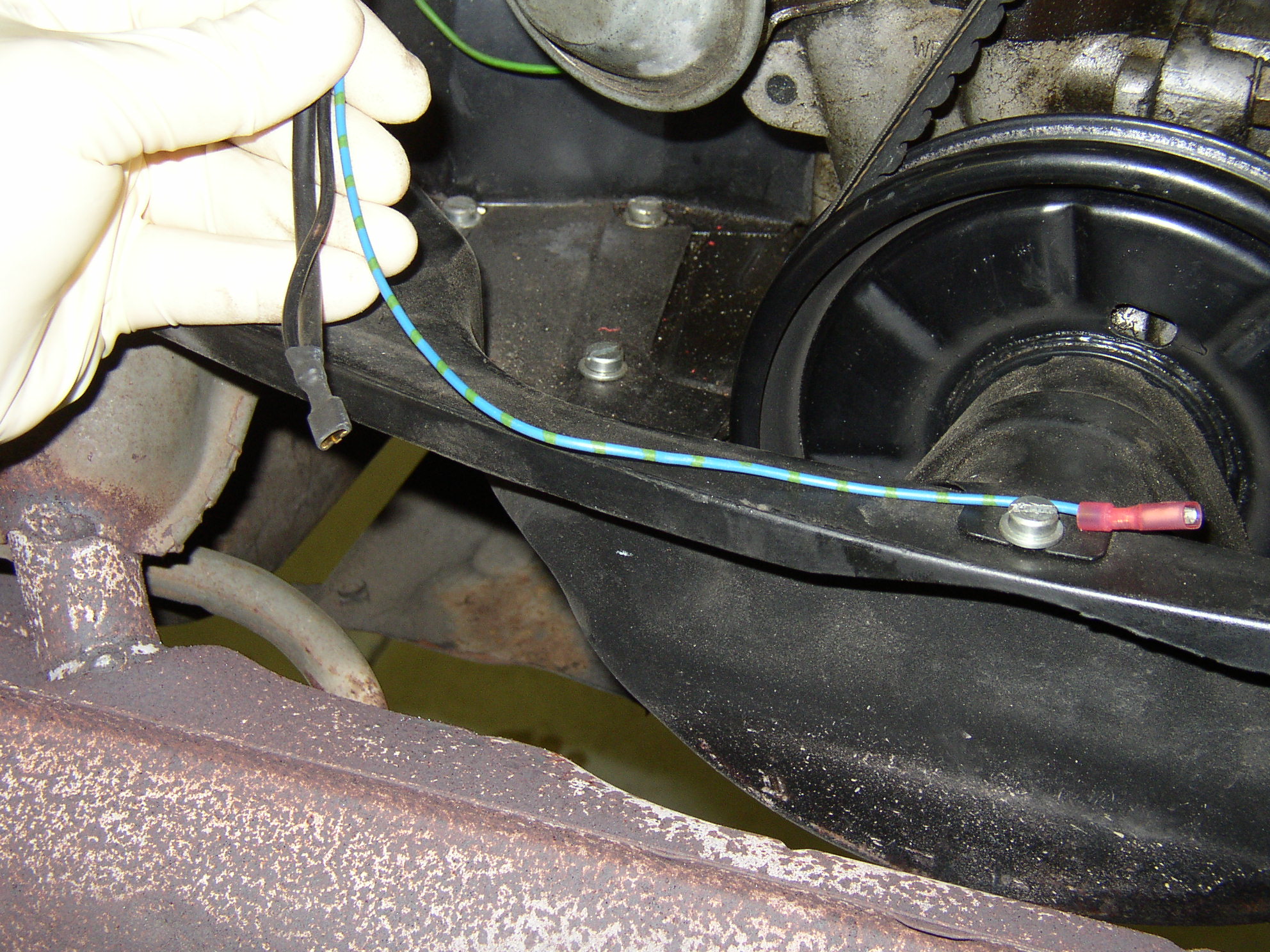

Here's the new coil feed and oil sender wire, I used correct color and gauge, soldered, shrink tubed, and loomed. Most guys would think this was OEG. I put heat shrink on the terminal end in case something touches it, as it's hot and unfused.
Here's the wiring done by the generator, looking like OE.

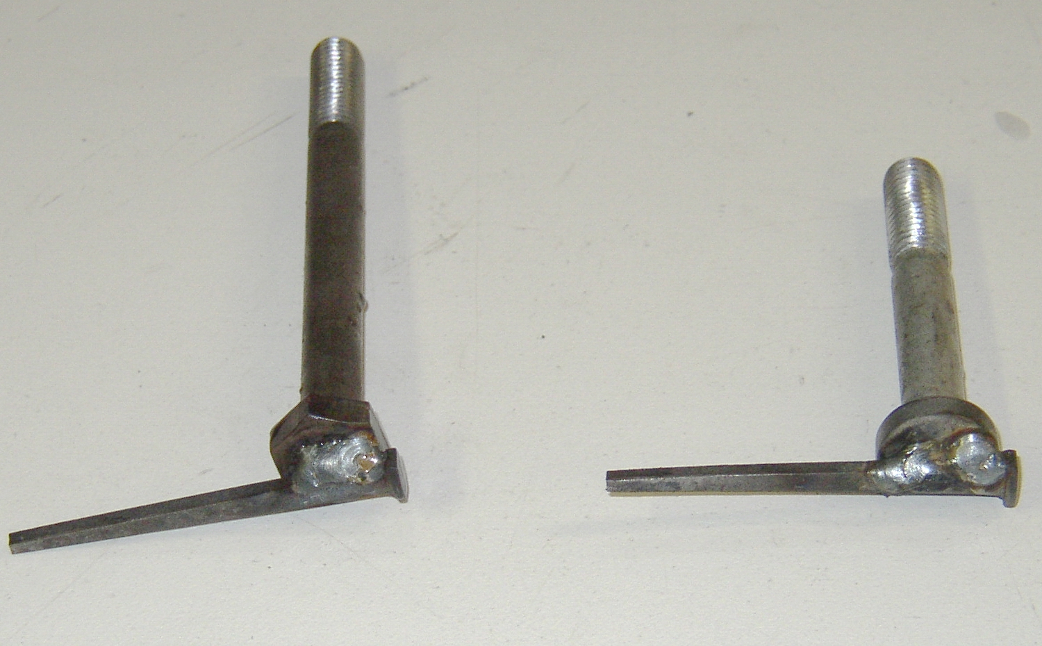

The upper engine bolts gave me a fight because they turned trying to loosen the nuts, getting a vicegrip on the starter bolt is not fun. I welded some spikes to them so they won't turn anymore. :mrgreen:
Bruce, on later vehicles there was a ground installed from the small screw on the generator to the foot of the voltage regulator.
Re: Stuff at the Shop
toolbox wrote: Thu Nov 29, 2018 6:45 am
Dual Port wrote: Wed Nov 28, 2018 8:09 pm
I know, but I don't think that includes split busses. None of the harnesses I've installed included it and it's not in the schematic or instruction book. Maybe later Bugs? Ken's bus has TWO ground straps on the tranny instead of one and they were recently cleaned, I doubt he has a v drop on the ground. I did clean the bellhousing flange with a die grinder to make sure the engine is well grounded to the trans and the charging voltage was spot on when done so I'm pretty confident it's OK.
