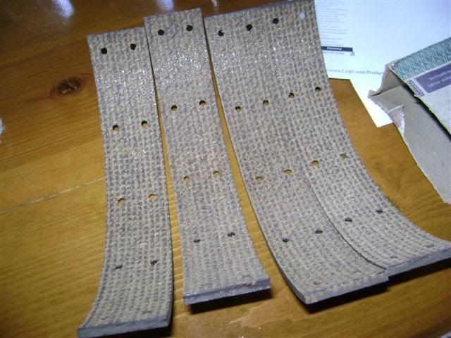

Not certain, but I think you're right. From looking at the WW site, I think #1 shows the '55-'63 front wheel cylinders. Trouble is, I have three of one side and only one of the other. :roll:
I'm thinking #2 may be 'bay' bus rears. (Say that fast 10 times!) The picture on the WW site for bay rears looks like them. Perhaps they used the same WC on type I bugs? I'm thinking #4 may be the rear WC for the '55-'63 bus. Check the picture out on the WW site.
If I get time, I'll turn the shoes over and show the metal side. How do you attach them? With rivets? Drill out the old ones?

hosedrag_r wrote:Would need to see the metal side of the shoes to tell..........
Probably not much help, but here's the other side Jim...
From some samba members, the consensus seems to be the shoes are '55-63 3/4 ton bus.
#1 are '55-'63 bus front WC. #2 are probably '71-'79 bay WC, but not certain. #3 are '64-'67 bus front WC. #4 and #5 are '55-'67 rear WC. One is just missing the dust caps. The other stuff is brake rebuild related, but not really sure what it fits.

The linings you have were riveted on the old shoes by the dealer when they did brake replacement.(pop rivets will not work)

wwebner wrote:The linings you have were riveted on the old shoes by the dealer when they did brake replacement.(pop rivets will not work)
Call me,I have the rear wheel cyls and shoes in stock.
Thanks Bill, I'll get them from you. I need the rear wheel cylynders and the rear shoes. Thanks for saving me from the pop rivet error. That's exactly how I planned to mount the shoes! :shock:
