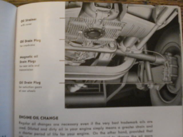

Found this picture in an August 1958 Owners Instruction Manual. If you look real close you can see the split case tranny and the hex head drain plugs. You learn something new every day
Re: CKWA/KWHA Part II
Yes, thanks Todd and thanks to everyone who weighed in. It doesn't matter who's right or wrong. Any discussion helps the uneducated like me.
BTW, isn't it crazy that it has two tranny drain plugs???

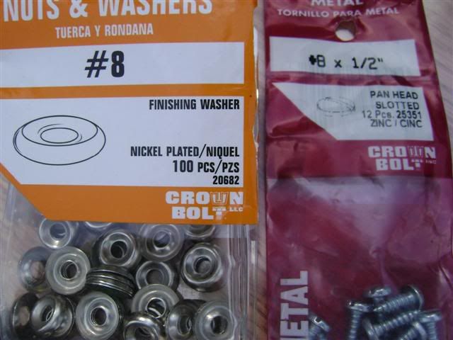

I decided to get more stuff done on the bus. I tried to put the WW ceiling cab panels in, but gave up. More on that in a later post. I did get going on the door and kick panels. I can't find my $16 bag of screws from WW.
I gave up and just went and got some screws from HD. I think the "proper" size is 3.5mm something, but I jsut went for #8 at 1/2". Good enough for me.

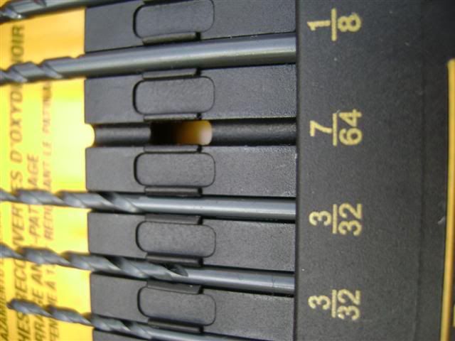

The drill bit was a 7/64

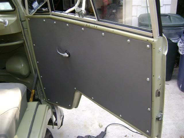

Right door
Driver door
Kick panels were good quality and fit well...

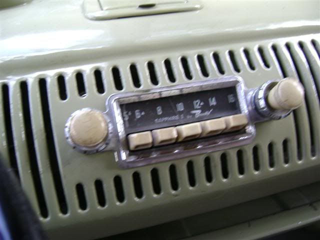

Got the crankin 6 volt AM radio mounted, but I need a speaker and bracket...

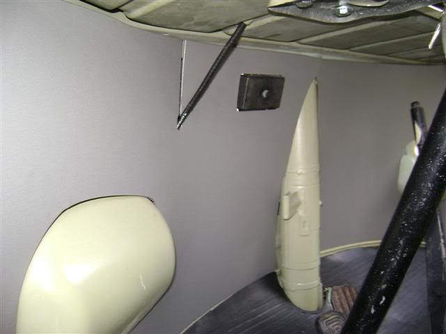

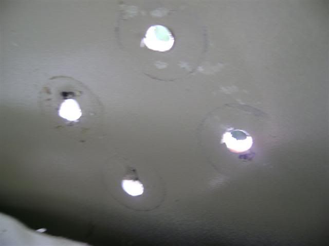

The roof mounts had to be redrilled....

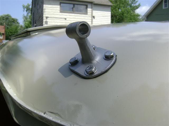

Go tthe front bracket mount in with the new incorrect stainless bolts and homemade gasket...

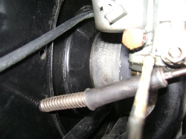

That 28 pci carb has an idle adjustment screw...

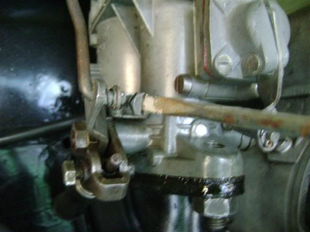

And a volume adjustment screw for the gas. (The screwdriver blade is on it just to the lower right of the brass hex head bolt). ..
You can see I'm running RICH...
Right door
Driver door

Actually all the type 1 style transmissions have 2 drain plugs.Six Volt wrote:
BTW, isn't it crazy that it has two tranny drain plugs???![]()
If you were to see a transmission case disassembled you would see the reason why. There is two chambers in a the vw transmission. The front for the gear stack assembly and the rear for the differential. They are separated by a wall that is part of the casting and are only connected by a couple small holes to equalize fluid levels and pressures inside the trans. Since gear oil viscosity is so thick (especially in cold weather) an individual drain plug for each chamber makes sense. It greatly aides in draining the thick oil from the entire trans.
Just for the sake of it I drained the lower differential section first til it "seemed" empty. Then opened the front or upper one in the gear stack chamber and was quite amazed at the amount of oil still up in there. Those VW engineers knew what they were doing.
As well always make sure you only use GL-4 rated gear oil in your air cooled vw trans and nothing rated GL-5 or higher as they contain additives that will corrode-eat away at the yellow metals in your transmission such as your gear syncronizers.

Sean the radio faceplate is on incorrectly. It installs behind the dash filling the space between the dash opening and the radio.
Thanks for the info on the tranny Todd. That clears it up. I'll check and make sure we put the right type of fluid in the case.
Also, thanks Ted for the correction on the radio plate. I must have looked at it for an hour trying to figure it out and I still got it wrong! I'll fix it tonight after work. Appreciate the info.
Actually, I like the way Sean did it originally, even if it is not correct. But what do I know?toolbox wrote:Sean the radio faceplate is on incorrectly. It installs behind the dash filling the space between the dash opening and the radio.

No moisture barrier!westy66 wrote:good work on the door panels. did you install a moisture barrier? if not, those things are gonna get warped next time you drive in the rain
I'm praying for dry weather!
I guess I'm going to learn a life lesson. One of many errors on this project! In any event, I do appreciate the information and hope I can dodge the 'rain bullet' till this winter.
