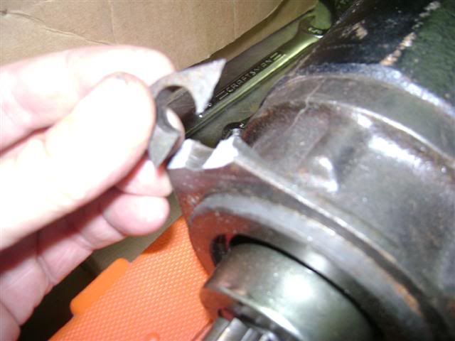

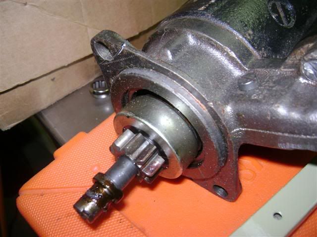

So I was a little concerned running this thing around with what looked like an original starter/solenoid with a "screw on" terminal. Talk about old school!
I noticed every now and then I woud get a "click" and then nothing. Afer resetting the key and trying again, she would roar to life. It wasn't the ground strap issue, or wiring since Kyle replaced all of it, so I figured it had to be the starter/solenoid on its way out. I don't know about you, but there's nothing worse than sitting in a field after a campout and getting nothing in the 'am' when you turn the key to leave.
Since I had a couple of extra starters, (and a few more who knows where), I figured I better get to work. I pulled the old one and grabbed what looked like a good one and got it mounted in a little under an hour. Not bad for me. Well I should have paid attention to the old disconnected choke cable line that broke a couple weeks ago. WW is out of stock on the replacement cable, so I left the original up there to see where it goes when I get the replacement. When you're a rookie, you don't always know the details of what you're supposed to be watching for. I was cranking down on the upper starter bolt while a set of vice grips kept the nut in the engine compartment in place. I could tell I wasn't getting it right. I finally figured I "got it", but I shoud have looked more clearly. I got everything hooked back up and went to start it and nothing.
I checked the battery and at rest it was 6.30 volts, so it couldn't be that. I figured the starter was bad so I pulled it out. Well you know what's coming.I realized I got the disconected cable trapped somehow in the starter housing up top and cranked the bolt so hard I cracked the starter housing and never got the starter all the way in to engage.
Don't repeat my rookie mistake. Be sure everything is flush and tight before assuming it's in. A little more patience on my part and I would have had no trouble.
I went back under and pulled that starter and put another one in. Got everything connected properly and she starts fine now.
Here are the autopsy photos...
