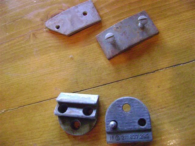

What are these? The bottom one's look the stricker plates, but the top ones????

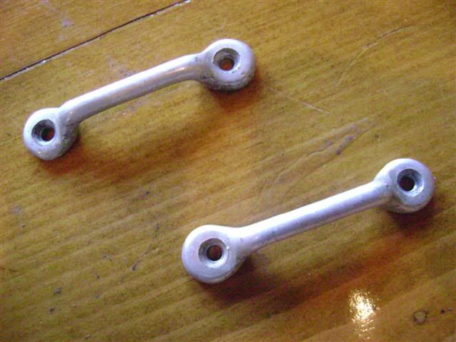

What about these? Some kind of cargo strap holder? I haven't a clue. :oops:
