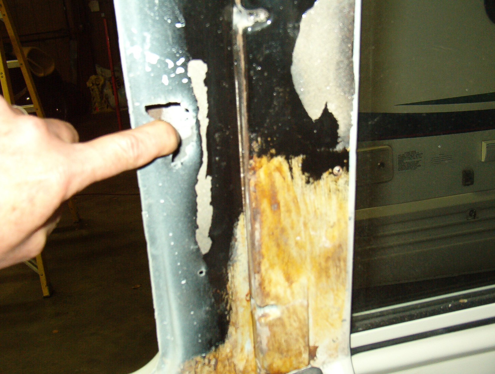

The bus came to me for an interior. It was soon obvious that while the exterior was beautiful, The body shop had not touched anything inside the first half inch of ANY of the openings.
So much for just installing an interior.

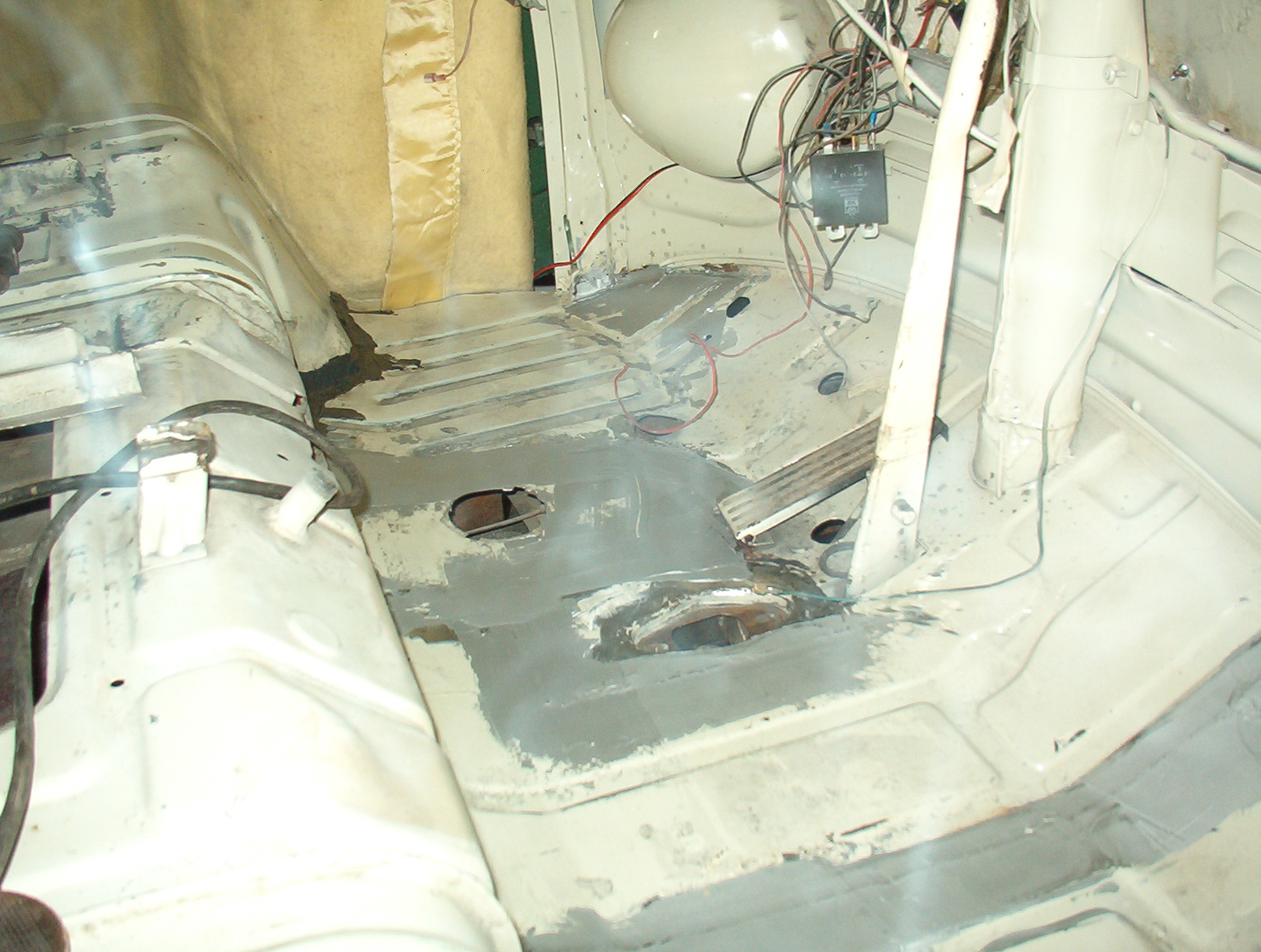

After we striped out all of the interior and Dennis started sanding we found lots of holes,including what looked like a complete replacement floor panel that had been cut up and used to patch the cab floor,which should have been replaced as a complete floor.
Not a bad job except for very globby welds and LOTS of daylight coming thru. For the holes,we used a product called U.S. Allmetal, a bondo/putty like product that actually has metal in it. It will even allow powdercoating. We used a fine screen and packed it with the allmetal and let it cure. then it could be ground and sanded.
dennis then ground all the ugly welds smooth and did the Allmetal treatment to the cab floor.
Now just waited for the Allmetal to cure for more grinding and sanding.

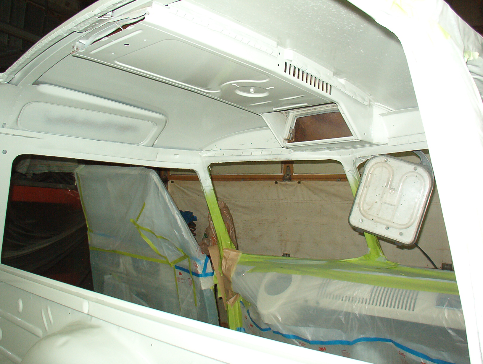

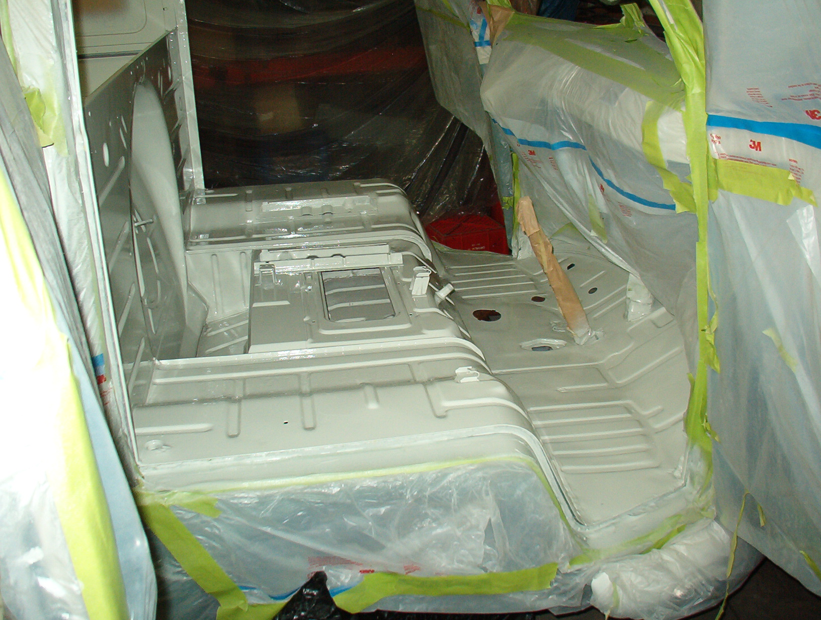

after better than 40hrs of sanding,grinding and prepping.
Pretty much the same had to be done on every square inch of the interior
finally!
