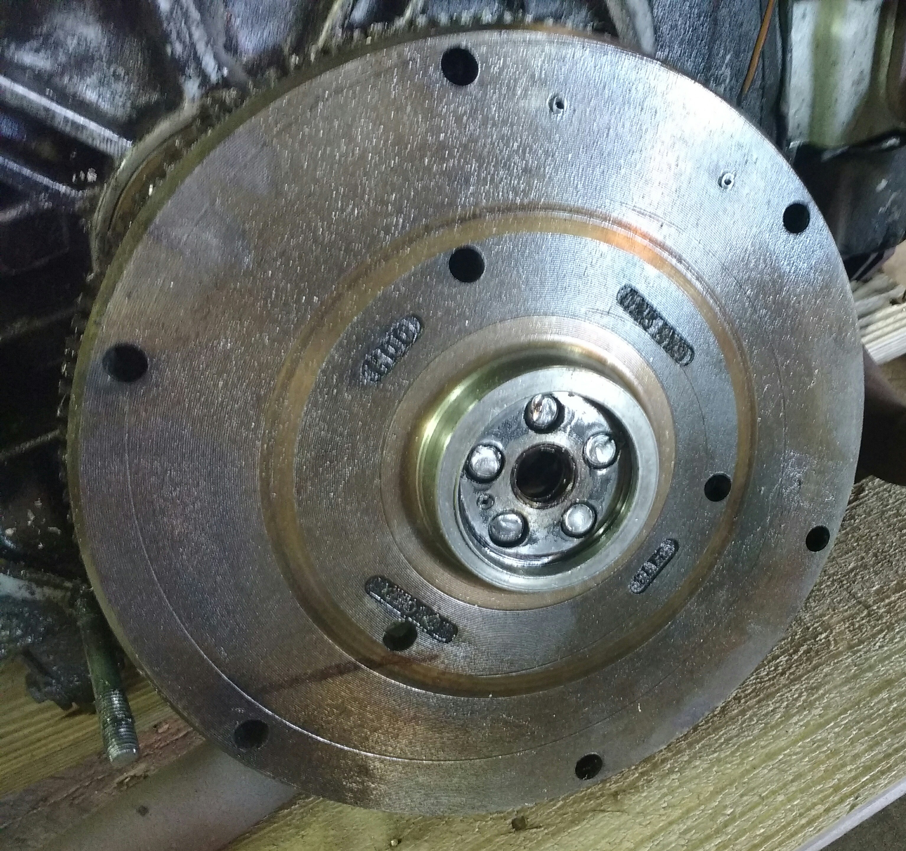

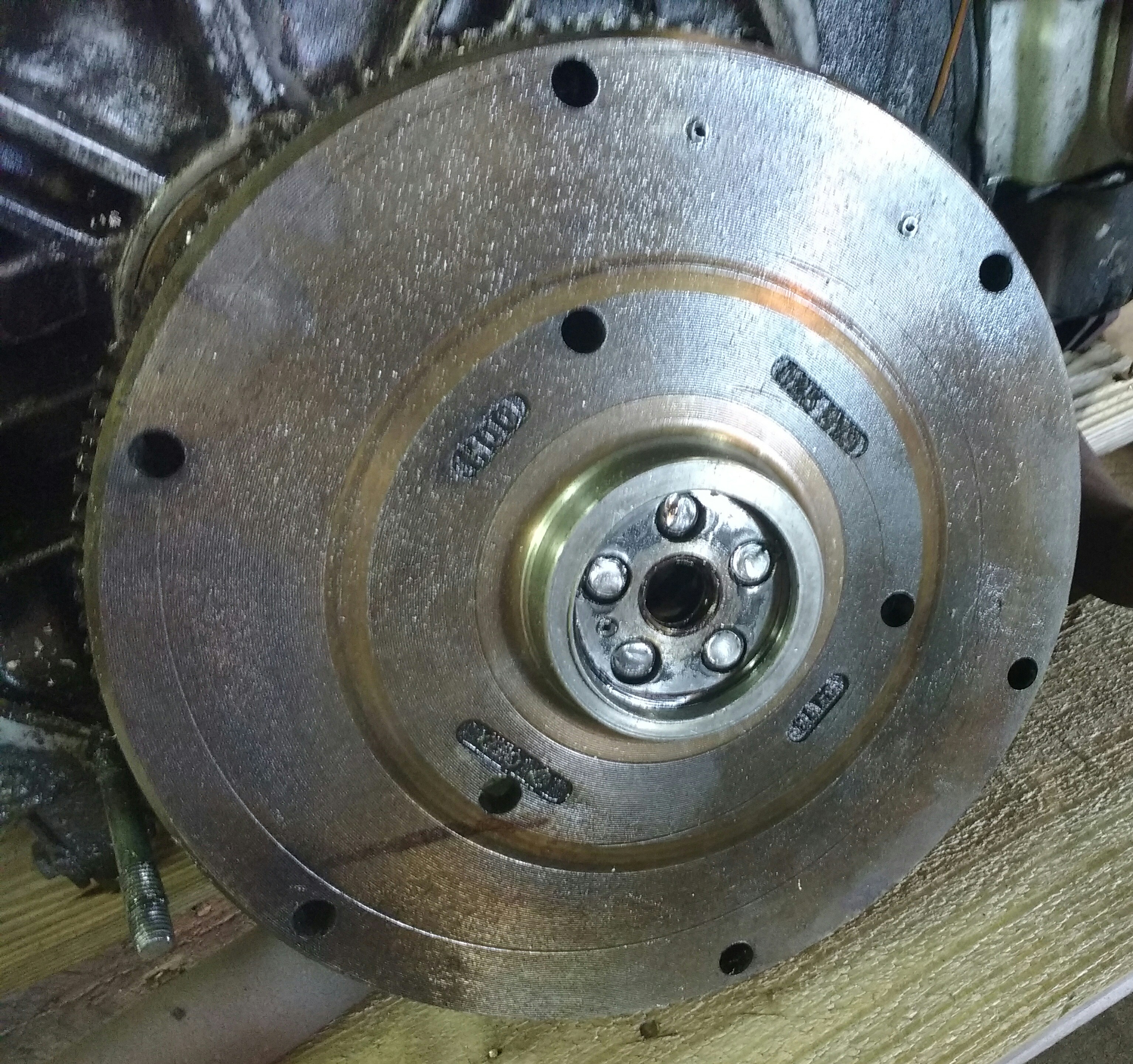

Hit a construction cone at 55 on Route 2 heading to Kelley's.

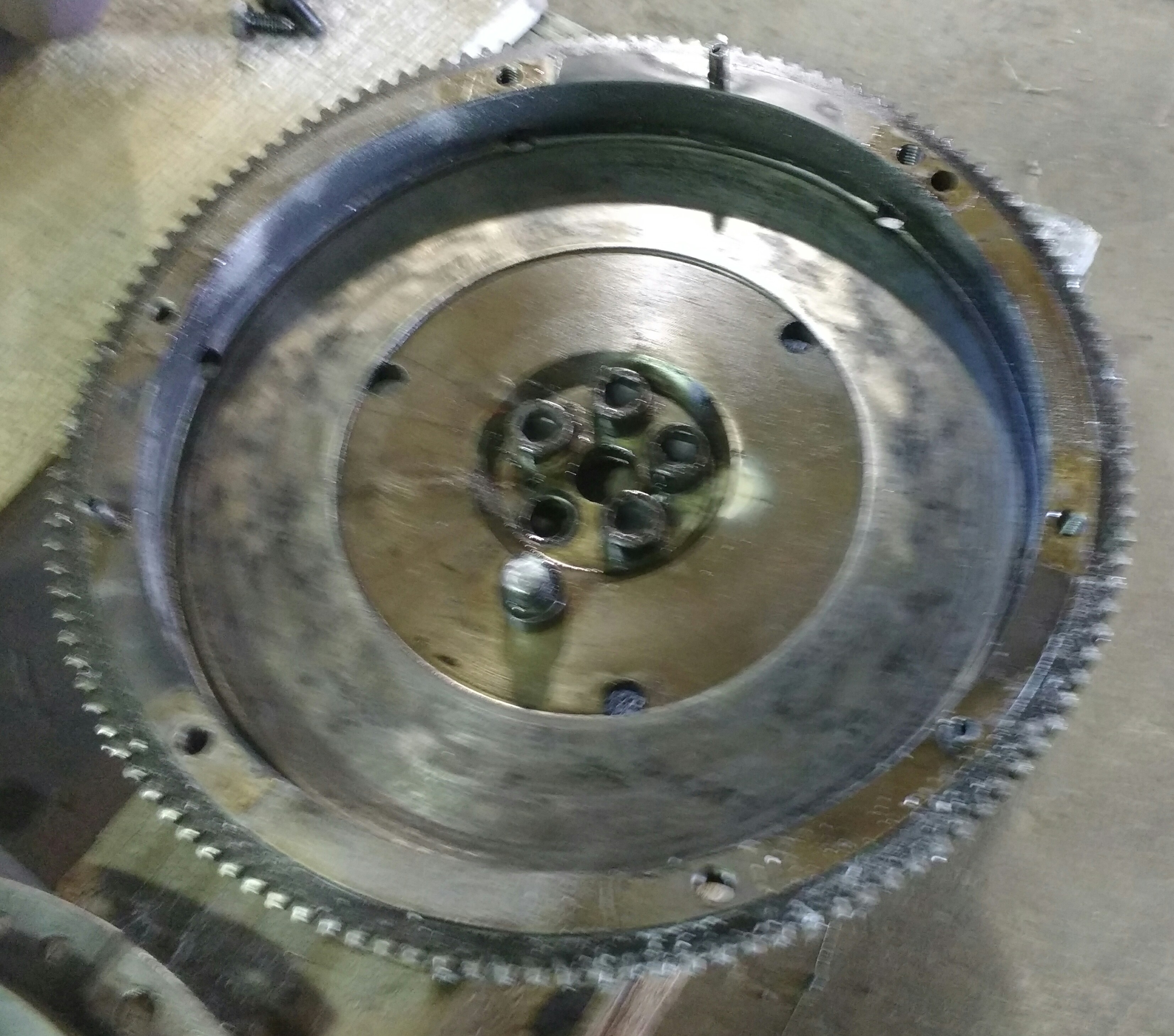

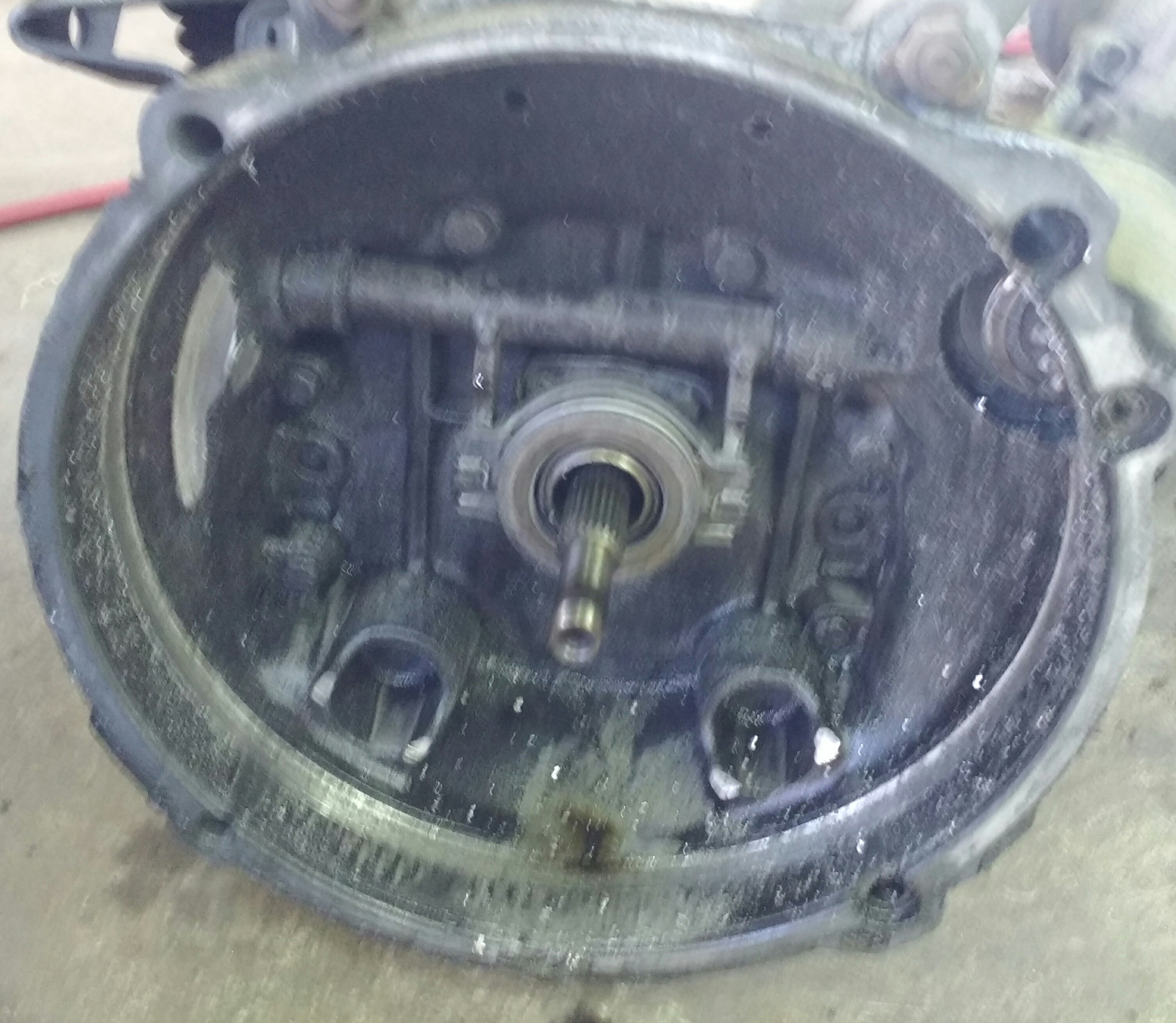

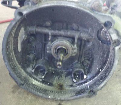

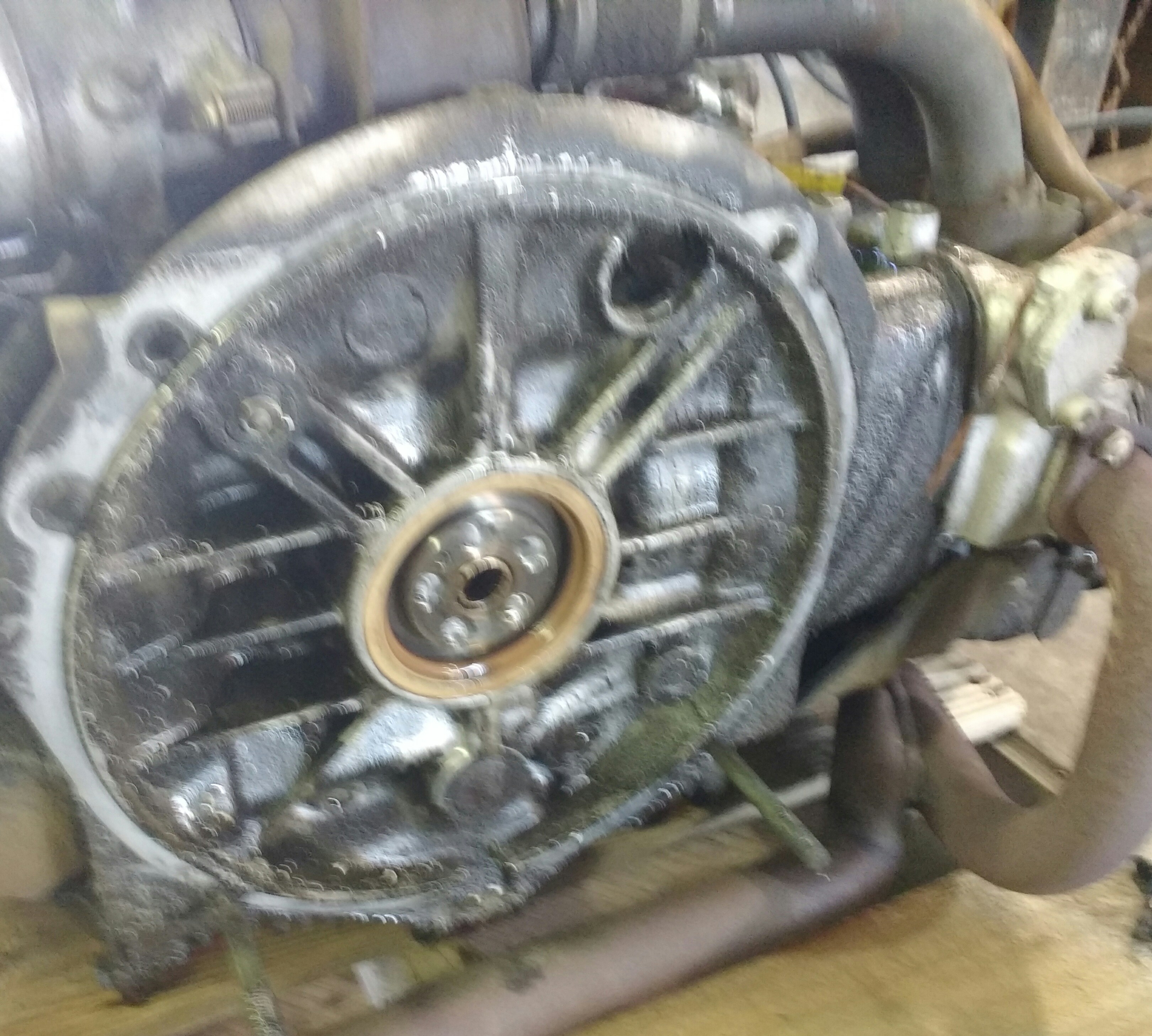

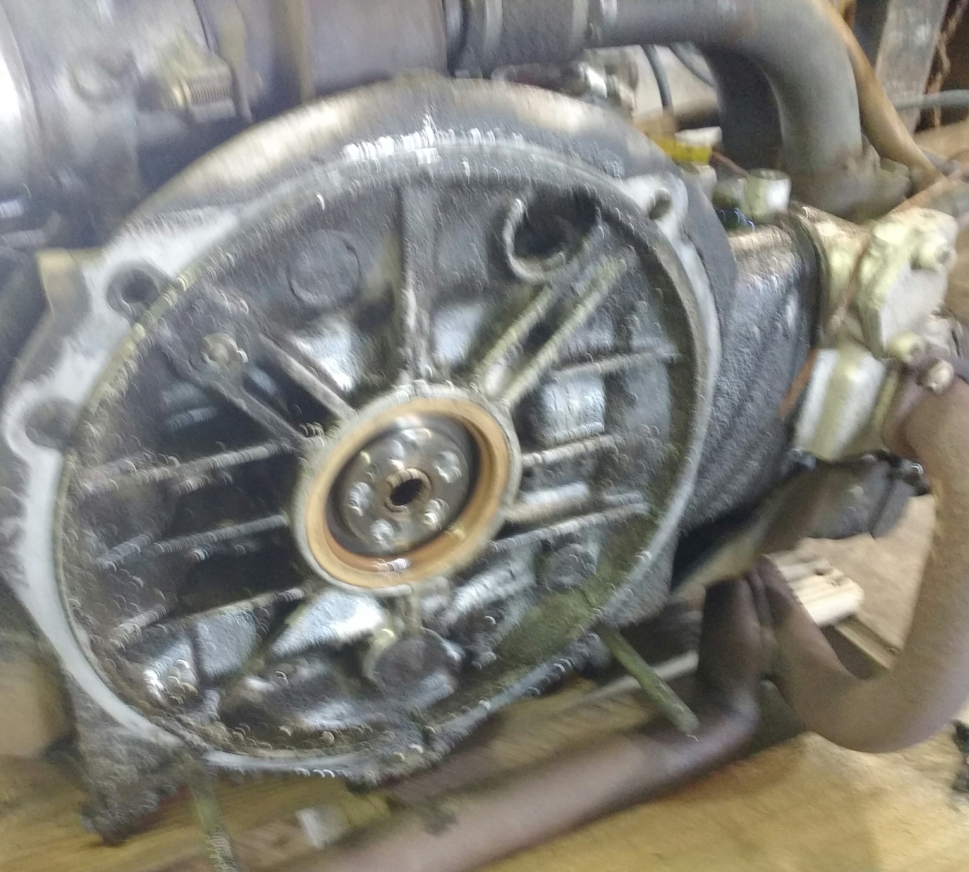

In case the pictures dont help you, the flywheel has sheared completely off of the Levine's 1.9l vanagon motor. No evident external damage.

Yes hardware, and a flywheel & crankshaft.

wow, that was an advanced construction cone....how does the flywheel shear off with no external damage?

Knocked out of gear at 55. Put back into gear without any decel or engine racing. So back into 4th?
More disassembly needed to see what else failed.
