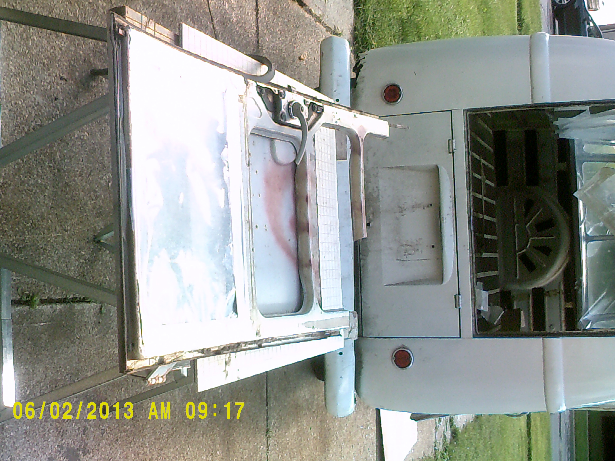

After the rains last night, I decided I should work on getting the door back on, the right side was involved in an accident during some point in the vans life, so the cargo doors are a little wonky. I have tried to get them as best I can, but I think I will ultimately have to replace them. I am going to use them for now, because I have them, but I know toward the end of the build I will not be pleased with them. Aside from the fact that they are not straight, they are heavily pitted from rust and age.
Sadly it took me all 6 hours to get the door and B pillar back on, and I am not even that happy with the work I did, so rather that get angry or keep plodding along, I decided just to wrap it up and enjoy the sunny day.
todays time line
started by getting the door frame back together
door on the van
