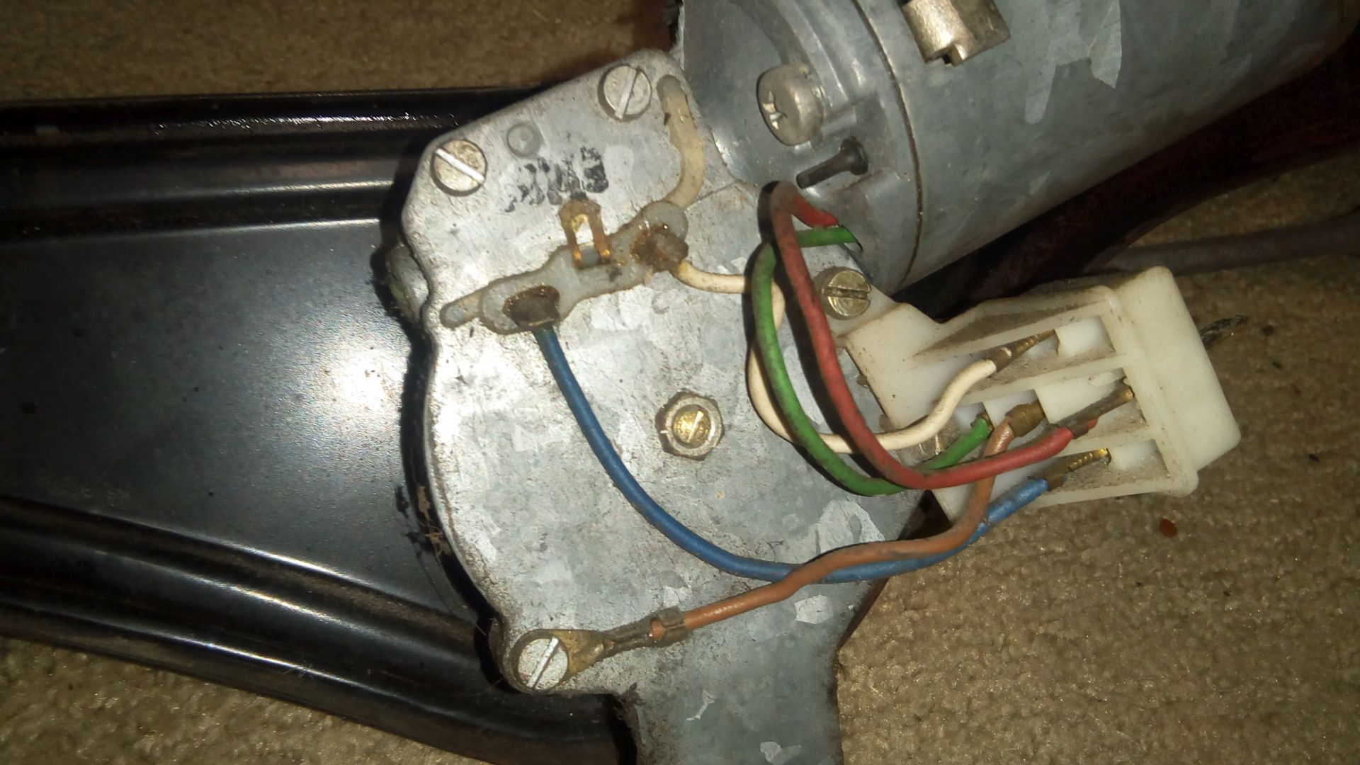

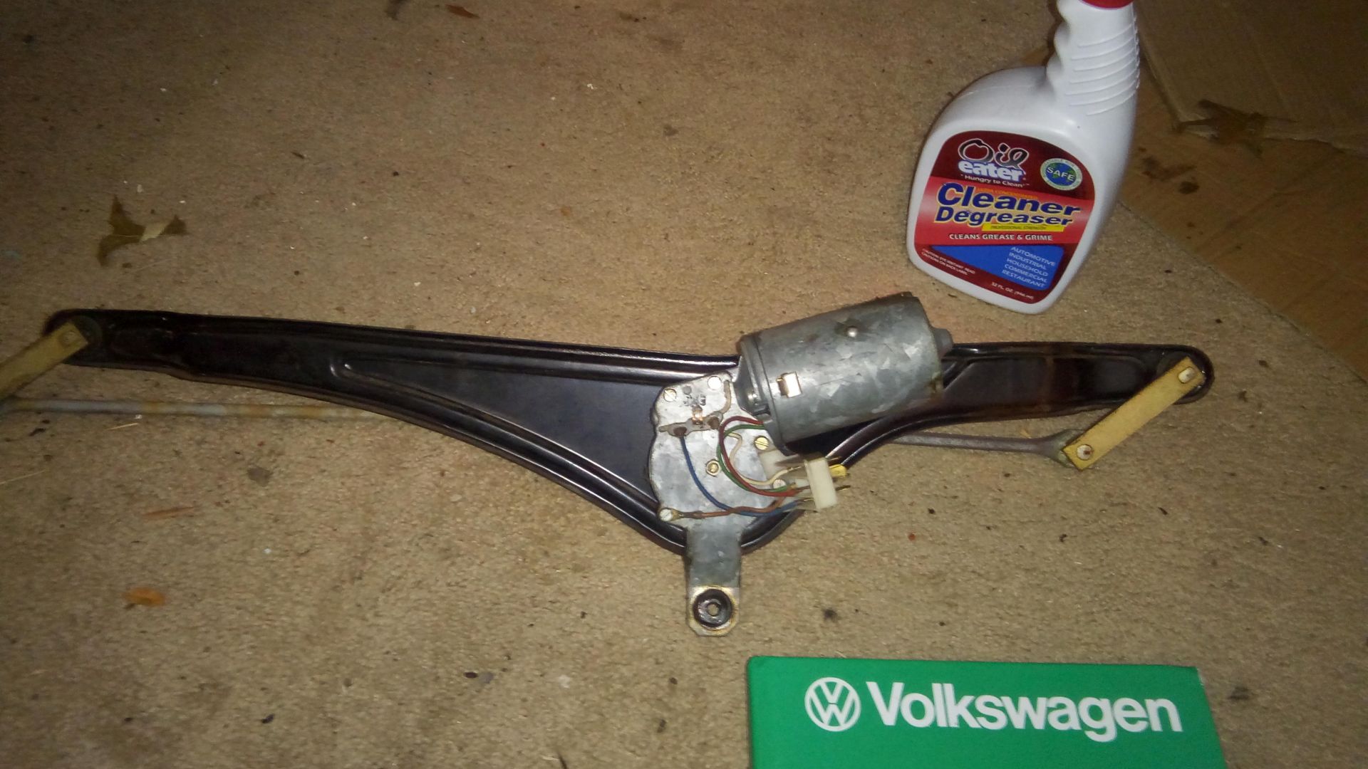

This is the wiper assembly
I could tell that the wiper has been messed with so I started by checking if it is year appropriate (1978). It appears that all 12 volt wipers have the same part number digits - 211 955 113 followed by a letter indicating the years. G is 67 only, H for 68-72, L for 73-??, E for ???, Q for late bay. Brazilian wipers end in a number instead of a letter. Mine checked out ok!

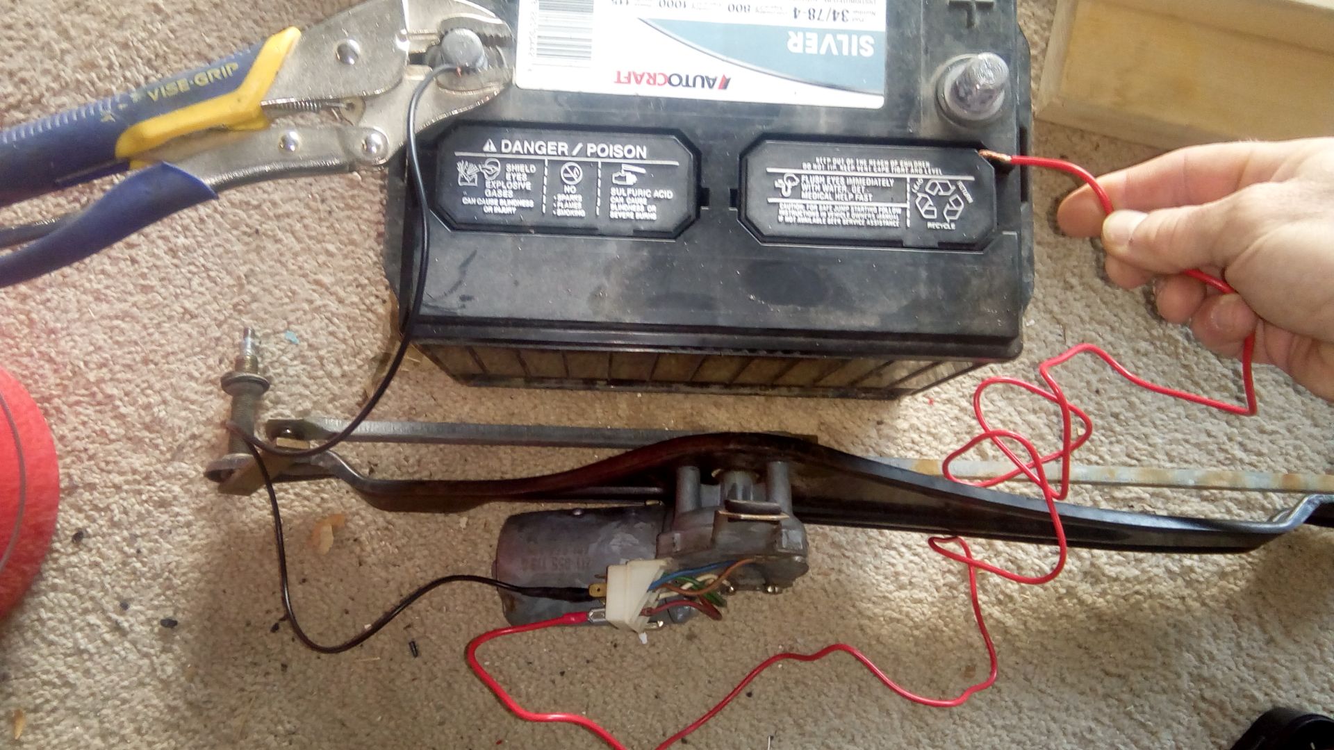

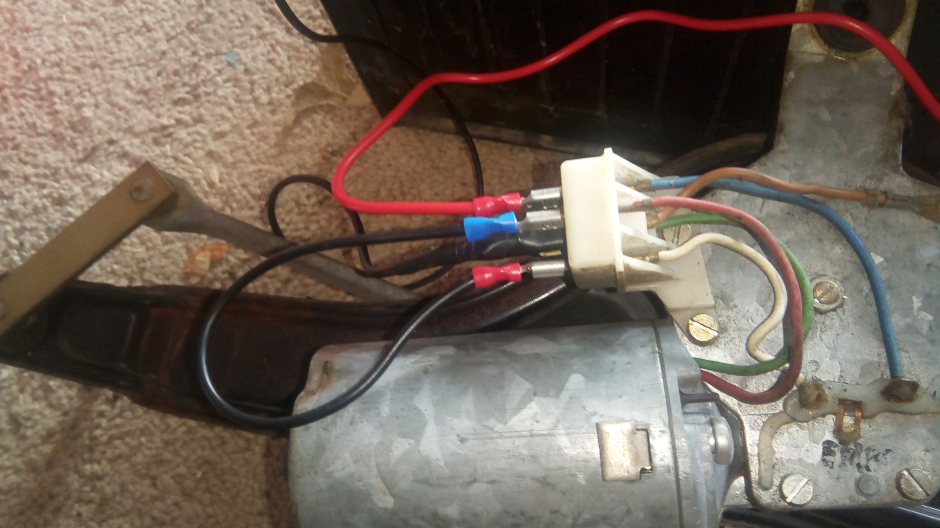

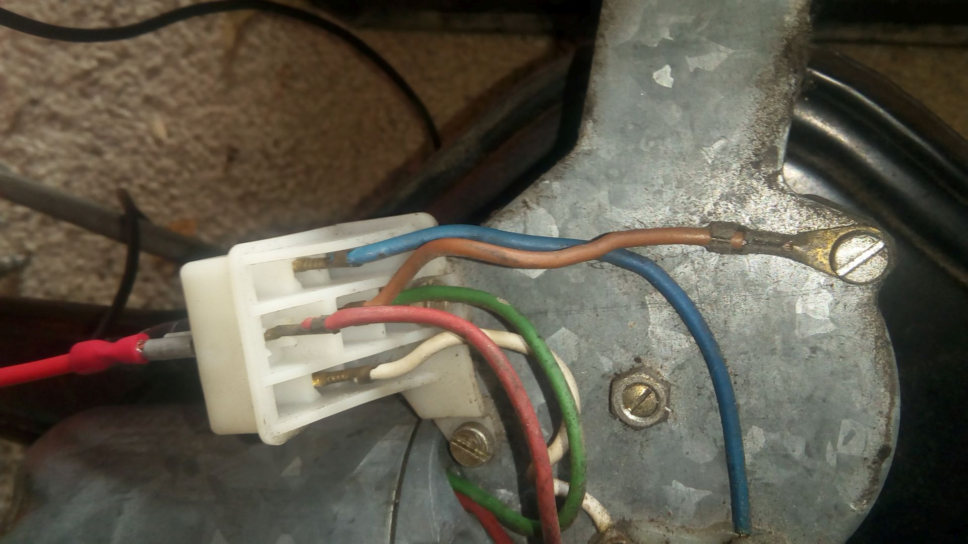

Out of the 5 wires, the brown one is obviously the ground so I clamped it to the negative side of the battery. On the socket side, I insulated the connector with electrical tape to prevent touching it when I test the other terminals.
Then I hooked up the red wire to the positive battery terminal like so, and it turned out to be the high speed.
Repeat the process for green - turns out to be low speed. On blue and white - nothing. Notice how the green and red wire go directly inside the motor, while the blue and white ones attach to the transmission housing.

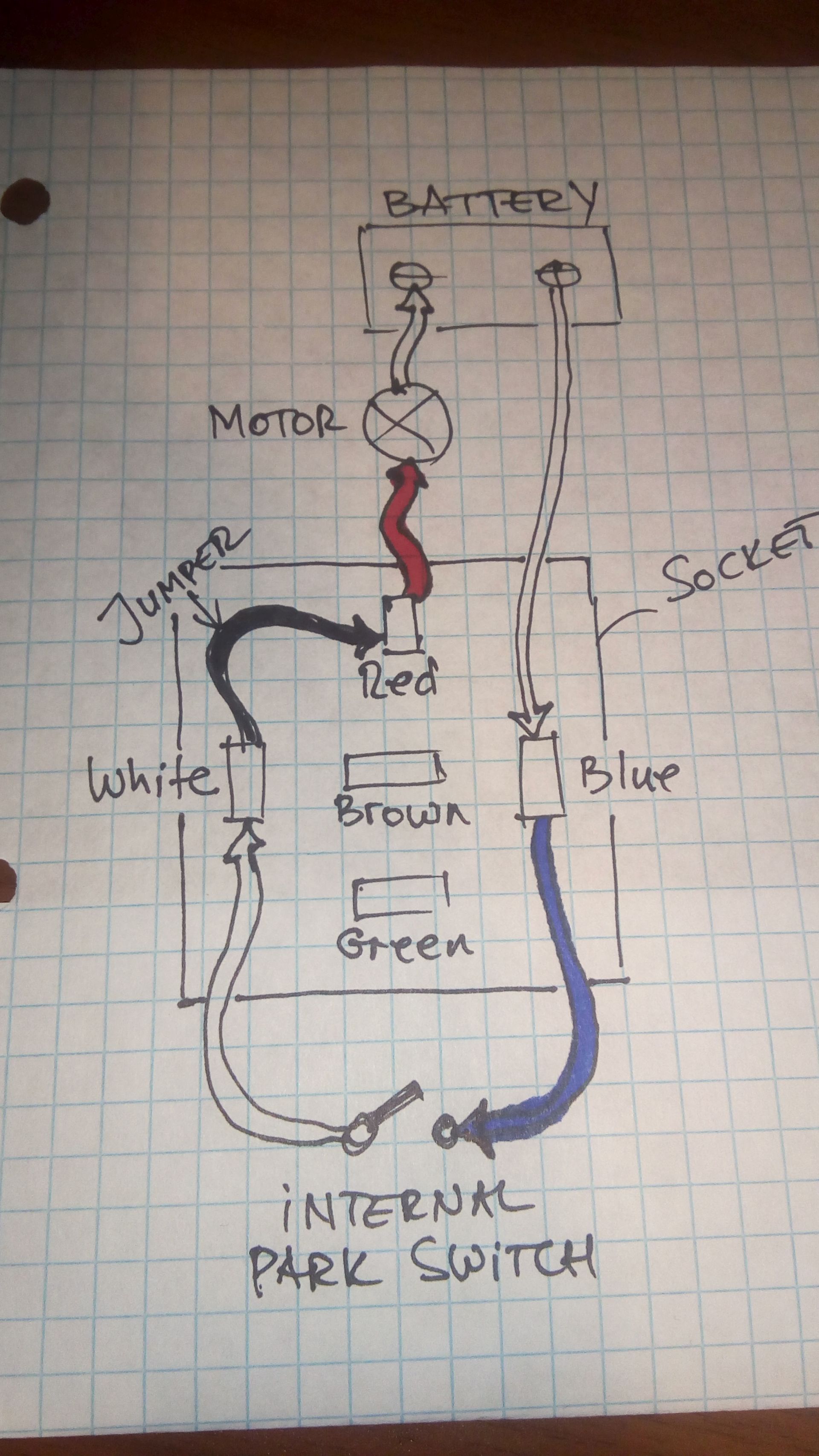

Inside the housing, there is a separately powered parking switch, that still powers the wipers after you turn them off. Otherwise, they would stop randomly on the windshield. I treated blue and white as a simple switch: power from battery enters the blue wire, comes out the white, then jumps to the red one to the motor, and it exits through the brown ground wire back to the battery.
Re: 78 westy
Posted: Sun Jan 28, 2018 7:39 pm
by ohiowesty

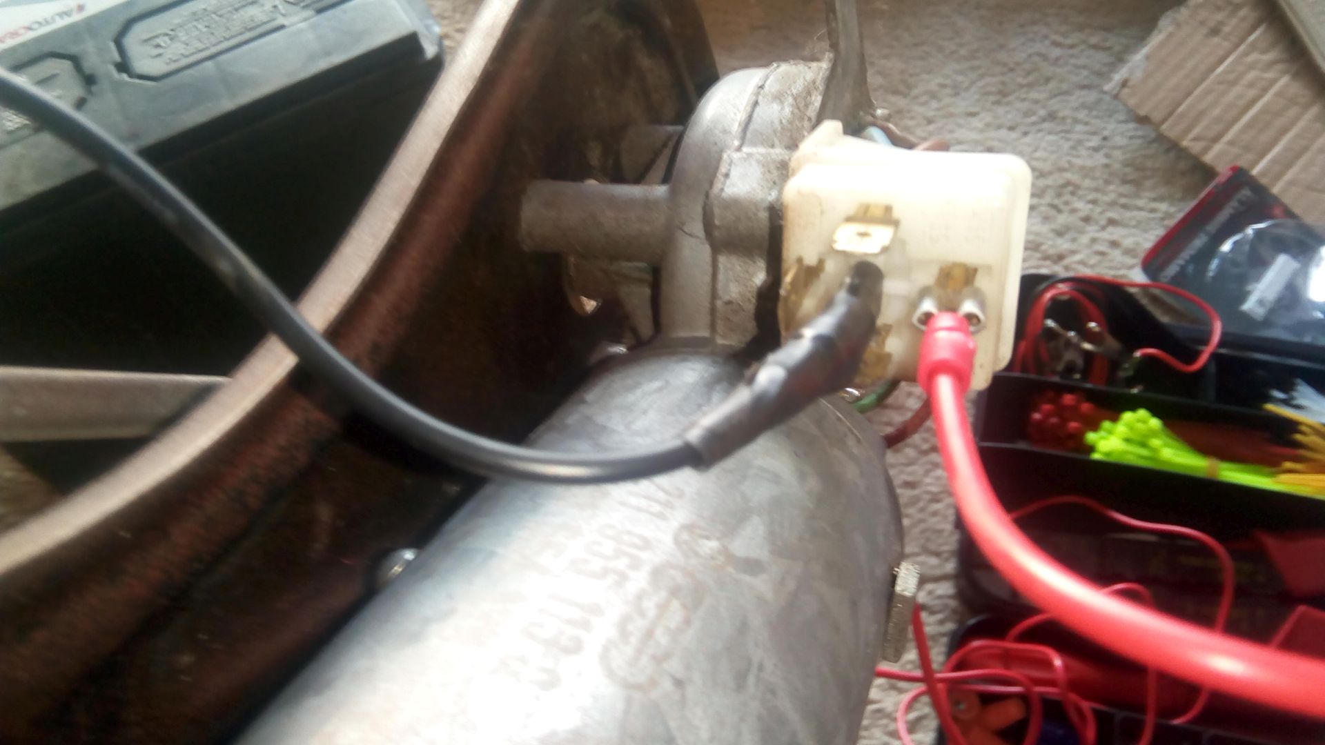

Tested it like in the drawing above,and the wipers parked themselves. Here is the jumper on the socket.

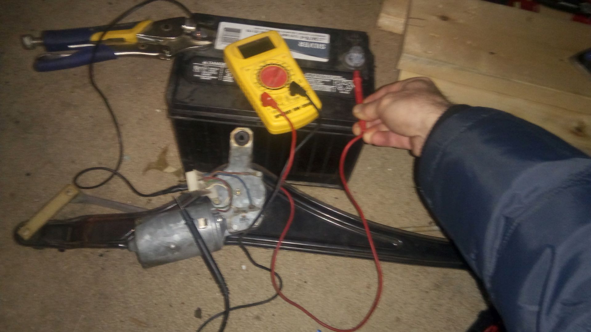

So during bench testing, everything turned out to be working properly. Back to the original issue: slow wipers, no difference between high-low speed. Maybe the motor is weak. To evaluate the motor condition, the Bentley manual calls for current draw testing: about 2.5 amps at low speed, 3.5amps at high speed, wiper blades pulled away from windshield. To measure current draw, set the multimeter to amps/DC and connect it between the positive battery terminal and the red wire terminal on the socket. like so:
Then repeat for the green wire. Both checked out good.
To simulate load (weight of blades+weight of snow+windshield friction) I held onto the wiper linkage while operating the assembly. No problems there; therefore, I probably had a weak ground or a bad connection when the assembly was in the bus.
Next step is to take all linkages apart, clean the grime and lube everything properly. Next time!
