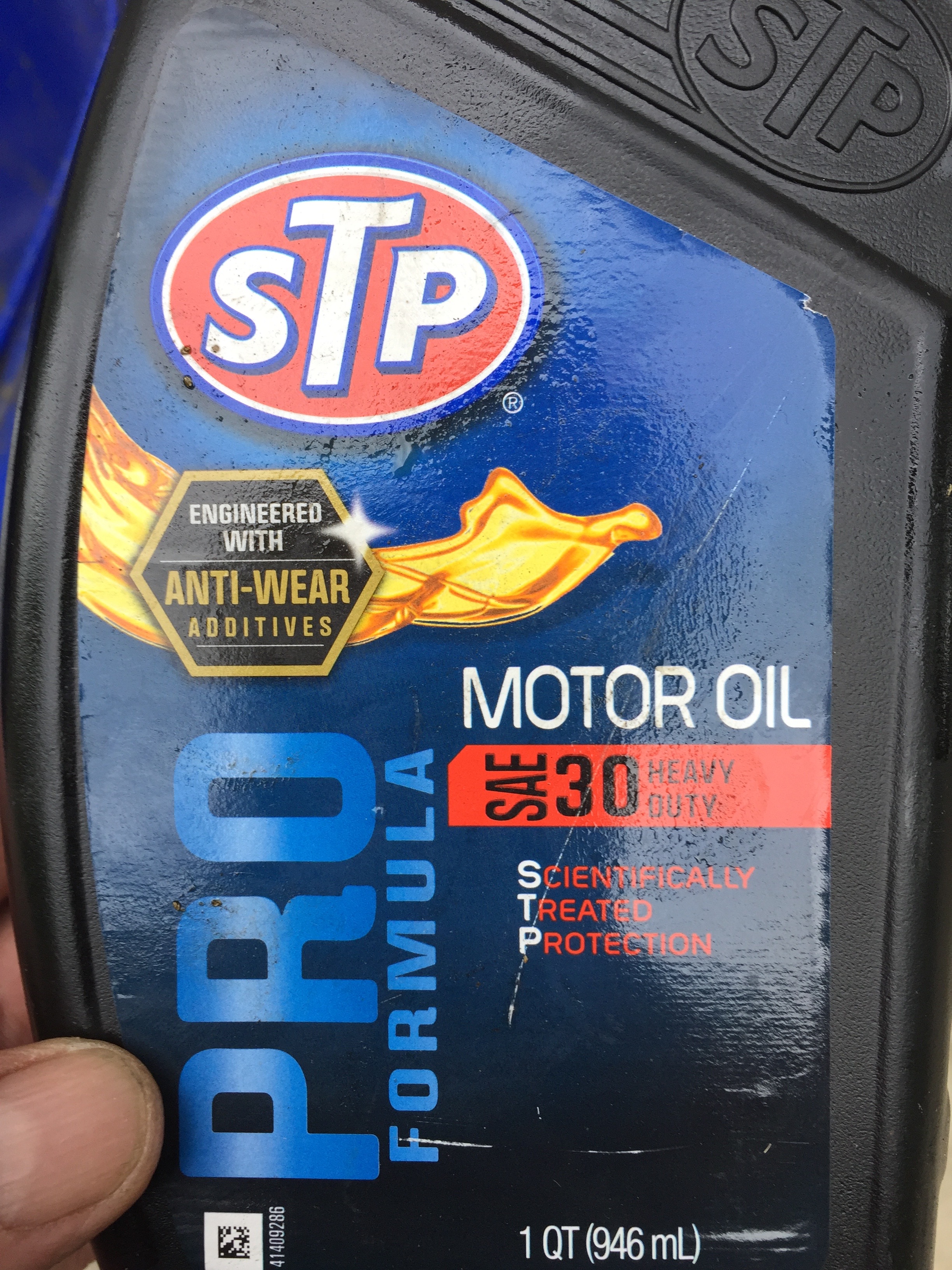

Thanks Bill. I know enough to follow your advice, but I couldn't find any 20-50w oil around here so I went with the STP 30W I've been sitting on. I'll probably order some 20-50w or figure out who sells it. I was in NAPA today and forgot to look, so maybe they sell it.

Good old STP Picked it up at NAPA I hate crap in the engine compartment. What can go wrong?
