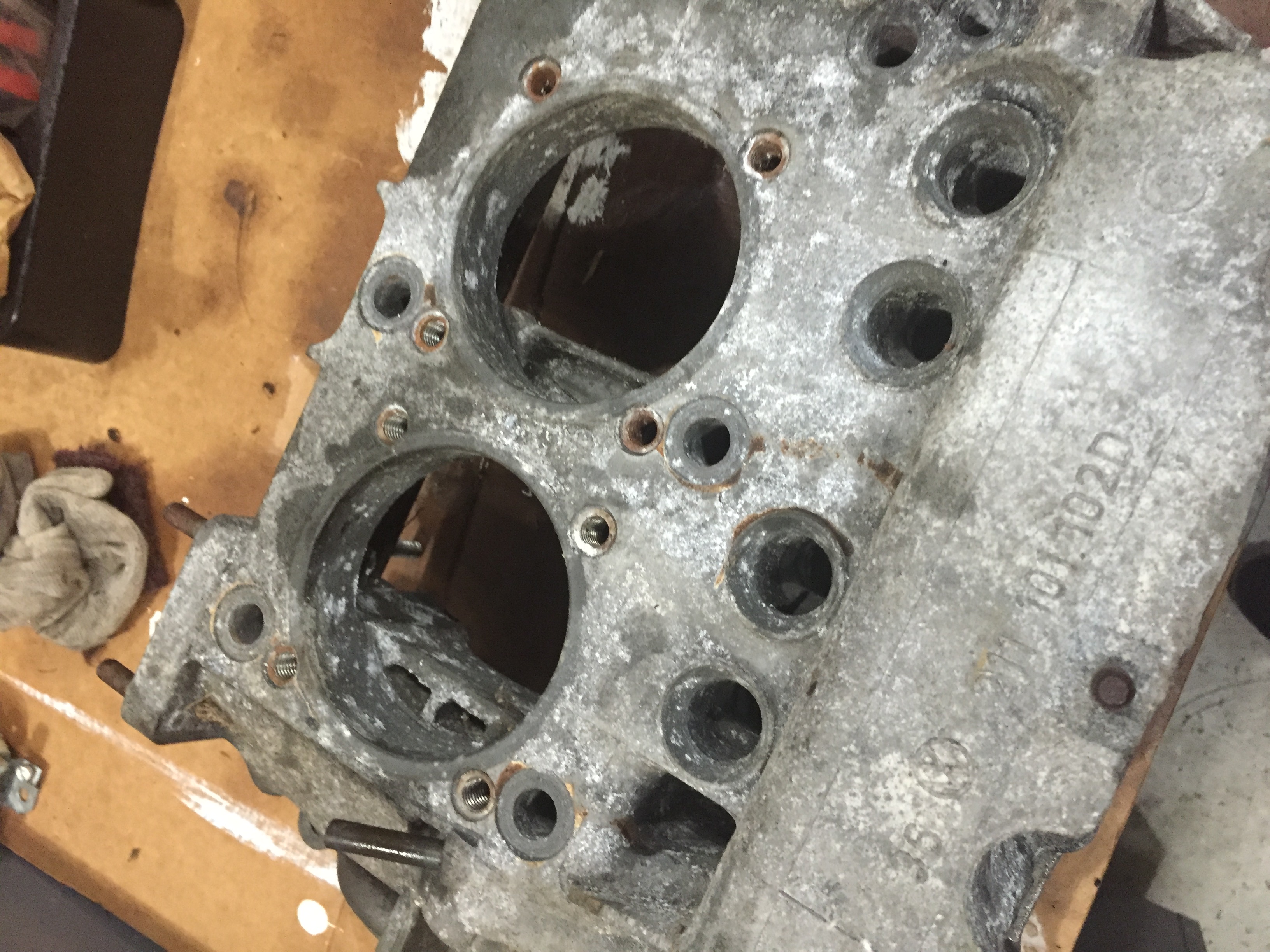

a friend and I went to rescue some VW parts from a garage in Ashland today. The start of a new engine for the beetle starts today. Heads, case, rods and lots of assorted parts to start the journey to a fresh build.

If that case checks out, I would build that in to your "daily driver" motor. Pull the one that's in there now, throw it on a shelf, and use that as your "back up"
Ashland is a lot closer than Ontario, if I recall correctly.
Nice find Keith. I think you will find, that's how things usually work In The VW world

If that's your crank on the table,it looks like a counterweighted one

The rear main on that case looks nice, no wear visible in the pic. WTF! How come you didn't have to massacre 4 motors like I did to find one!
Looks good, have you decided on what's going inside? Stock 1600 or something fun?

Actually, we're not exactly sure what to use yet except the heads. The two German cases are in excellent shape and the one is checking out to be a rare find.
He may sell a lot of the parts on the Samba in favor of gathering better ones new but the parts are in super good shape.
Mild daily driver is the focus.
I learned a lot about super high performance VW power today. The pic of the case is NOT mine! The pic of the engine bay is my current set up.
