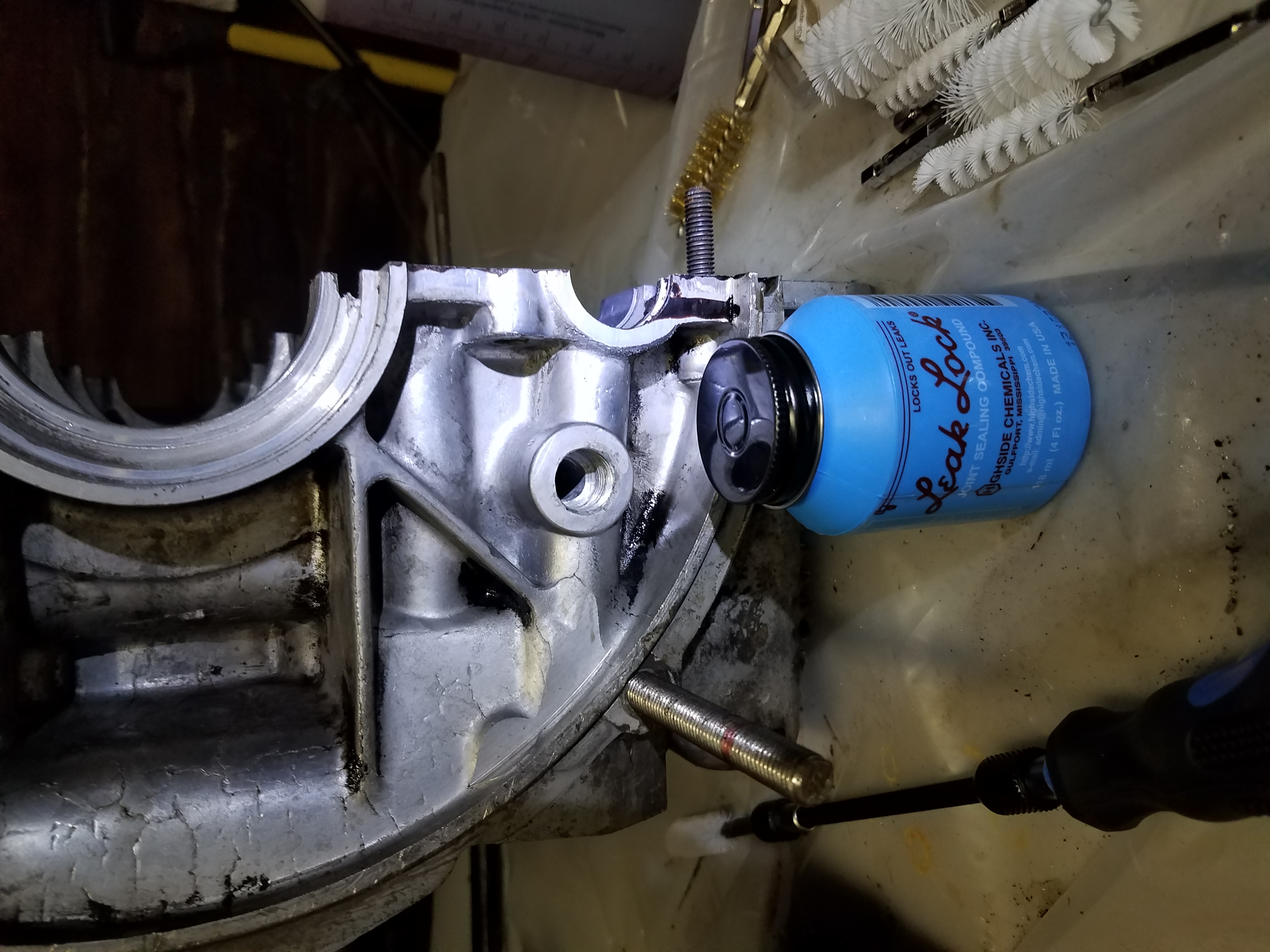

Used nylon brushes in this brush kit (also from HF) to clean out the oil gallerys
Sealed all the oil gallery plugs with Leak Lock.
