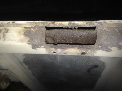

Still at it
1
Started with this piece of bent metal screwed to hinge

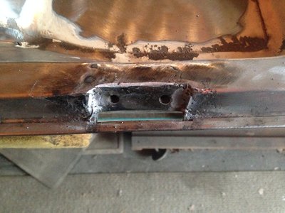

2
Missing piece of og metal

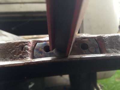

3
New piece of 22g sheet spotted to 18g spreader and nuts tacked

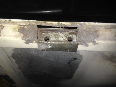

4
Welded in
Welded in

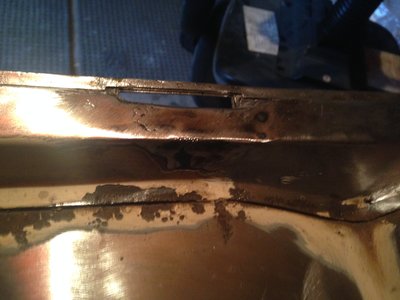

5
Some duraglass and it's a wrap
