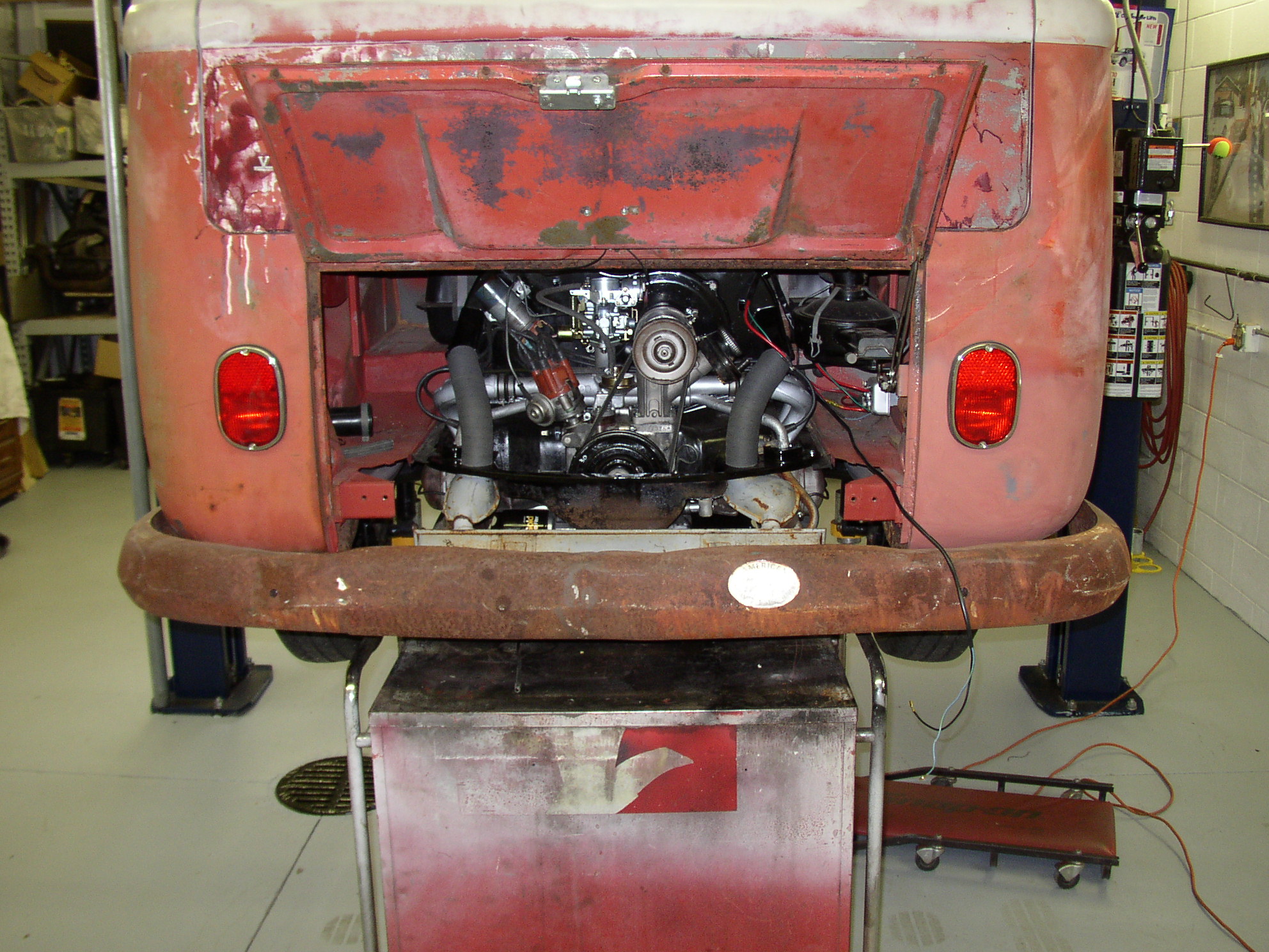

It's together and running with a temporary carb, check out the frost on a cool day.

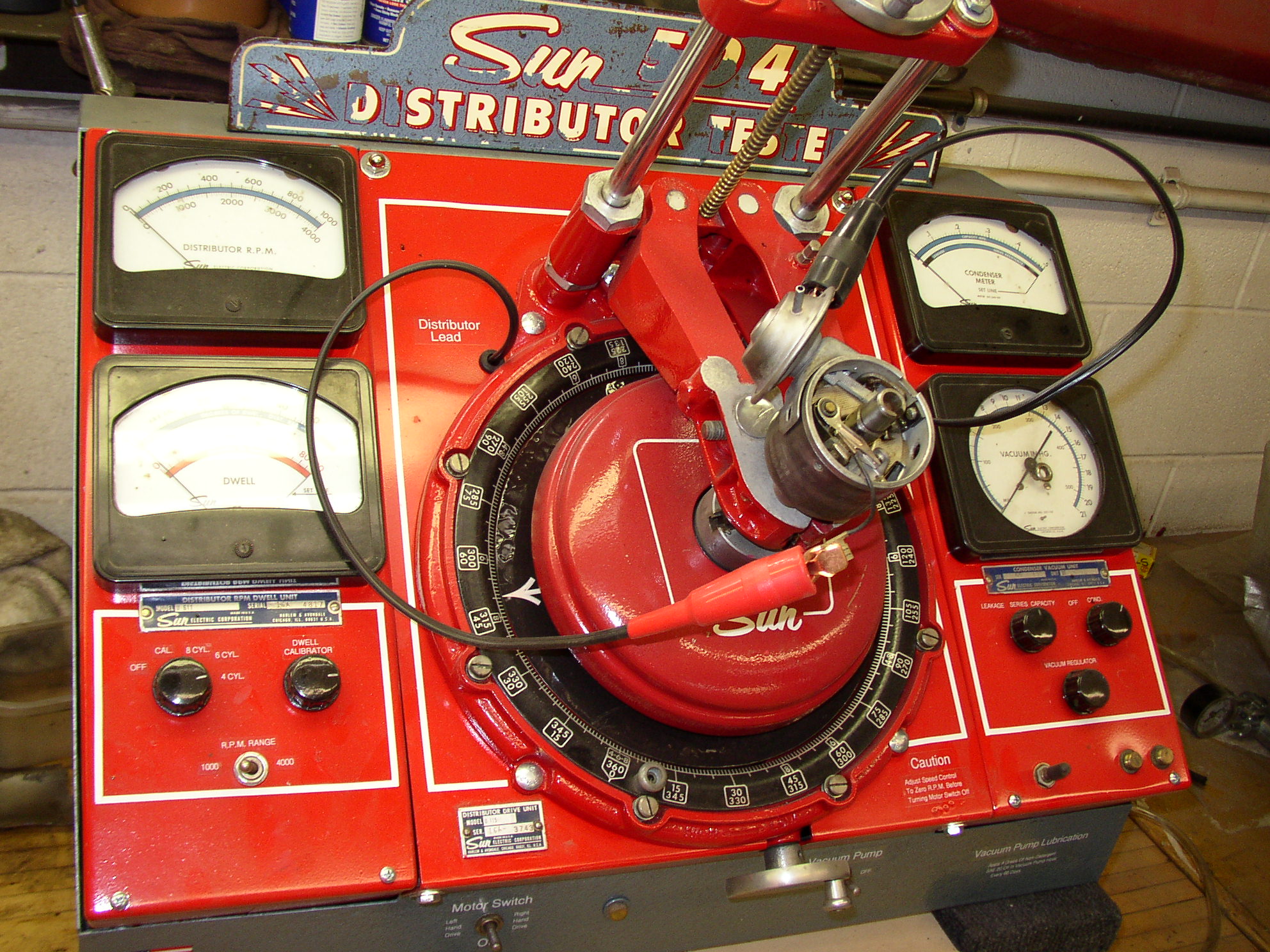

But the spark advance is too high- 35° total! That puts my initial at 5ATDC which blows. Target is 30° total at high RPM.
Let's pull it and check it on the Sun machine, yep that's what it is. Pull the dist apart and grind a 4mm nut real skinny to limit the advance weight movement. Epoxy it in place. Stop laughing, Kirk!
Dead nuts on where I want it, 10° total dist advance,(which is 20° crank) all in by a little over 2000rpm.
That puts my initial at 10°.
