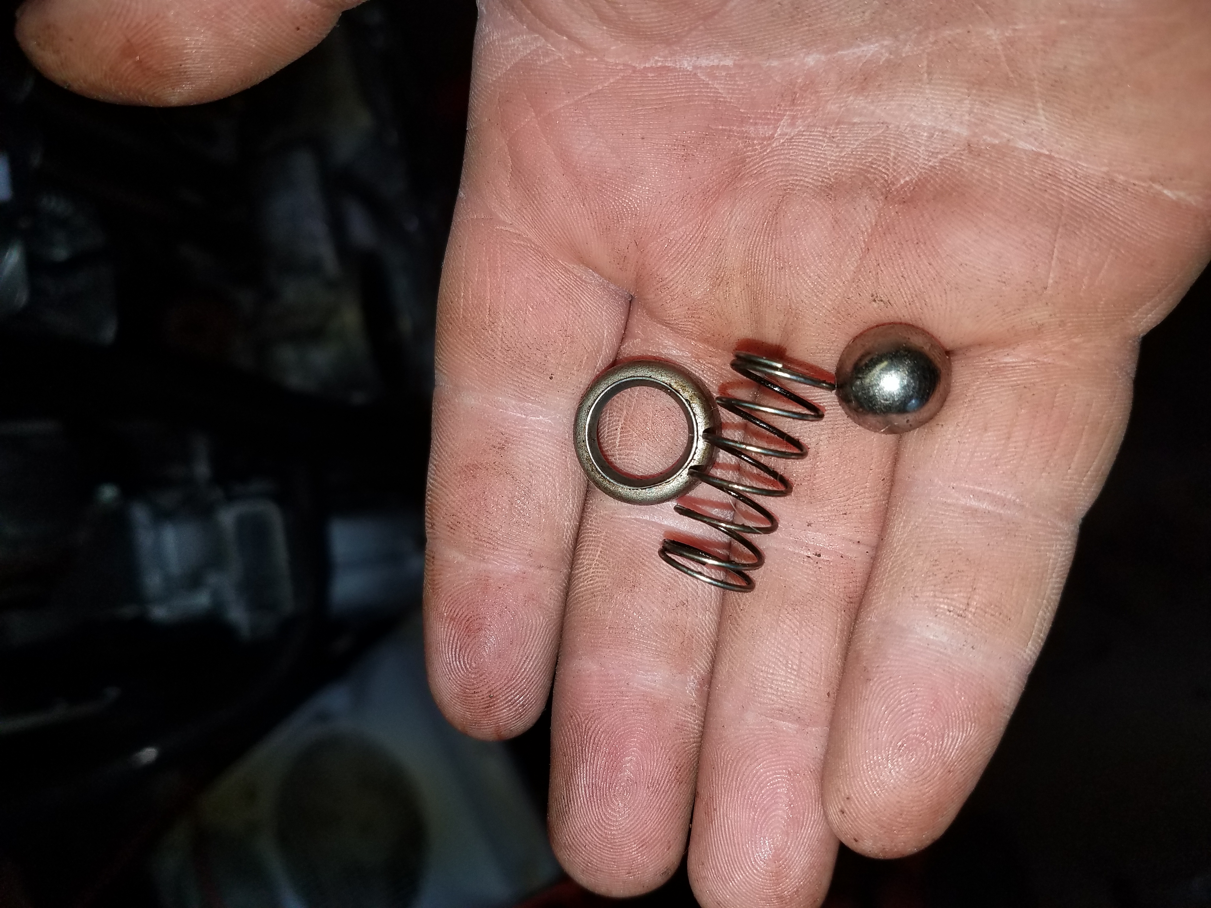

Where does this belong? I checked the oil pressure relief valve and everything was happy there...
Posted: Sat May 06, 2017 4:50 pm
by chuckspence
That is your oil filter bypass valve/relief it's part of the spin on oil filter mount (or it used to be) kinda important if you want your oil filtered,it shouldn't have come loose, you may be able to reinstall it and stake it in with a chisel/center punch or you can replace the oil filter mount (you know where to get one if you need another)
Posted: Sat May 06, 2017 7:44 pm
by Kooper271
Thanks Chuck. I was able to get it reinstalled
