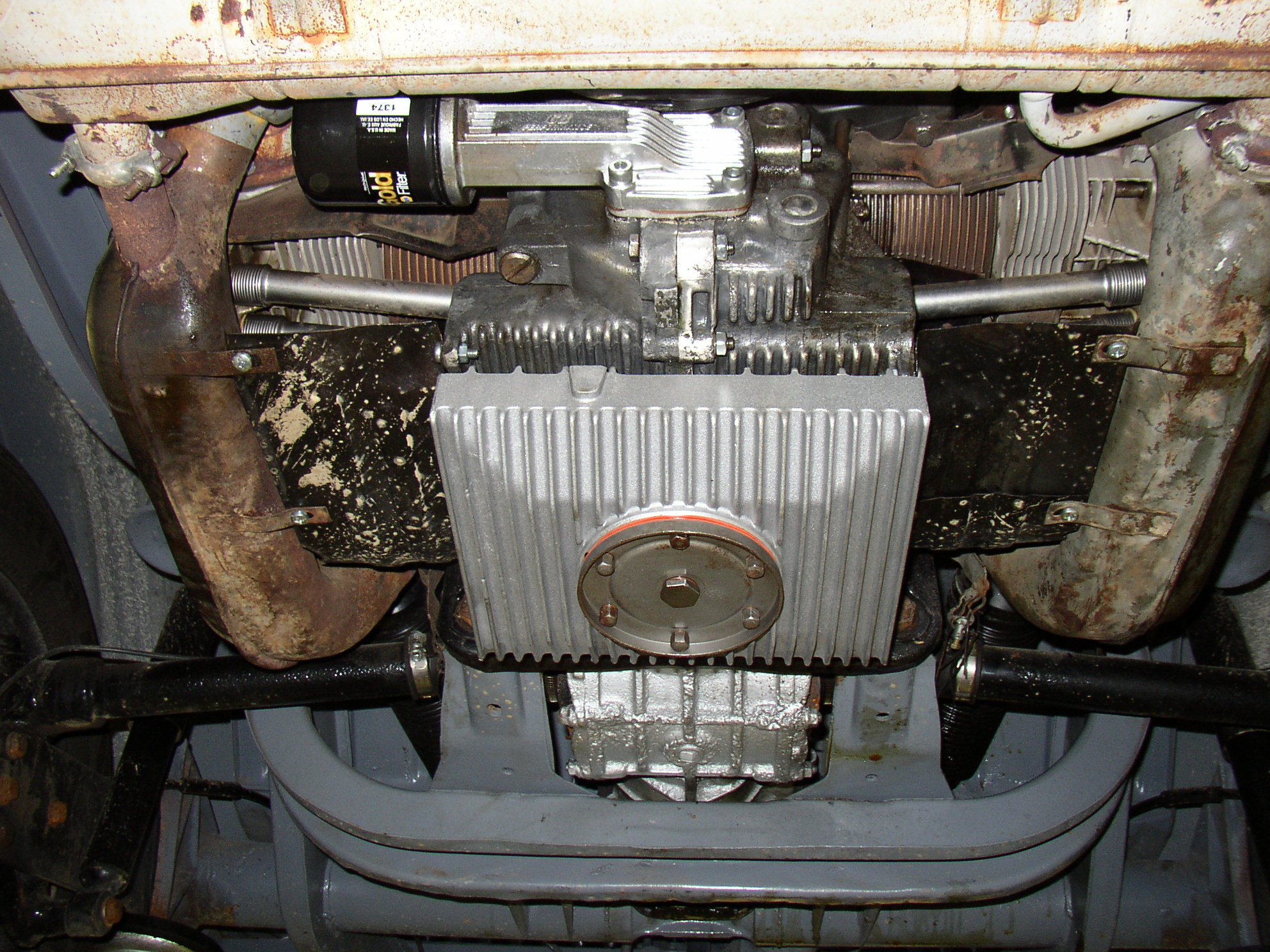

With the huge drop in oil temps I saw after installing a deep sump in Bus 1, obviously Bus 2 had to get it too.
This is the exact same Empi sump I put on Bus 1 which fit without modification, but not in Bus 2. Some grinding had to be done to clear the case properly.
I ran it on the high step of the cam for an hour to see big differences between the bottom of the case and the bottom of the sump, like 70-80°F. Even though this bus has no temp gauge I'm sure it will be much happier on the highway with a bigger sump.

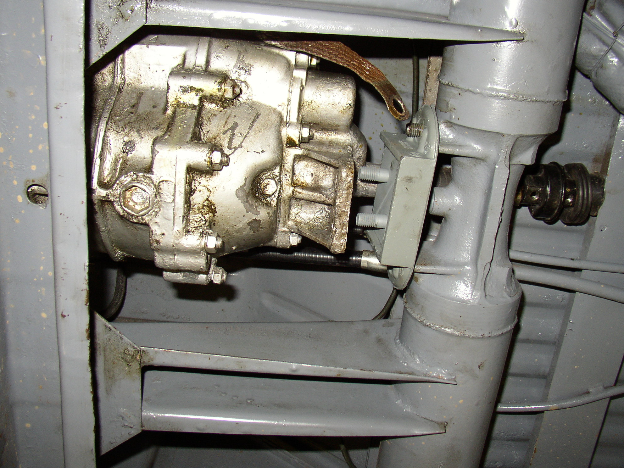

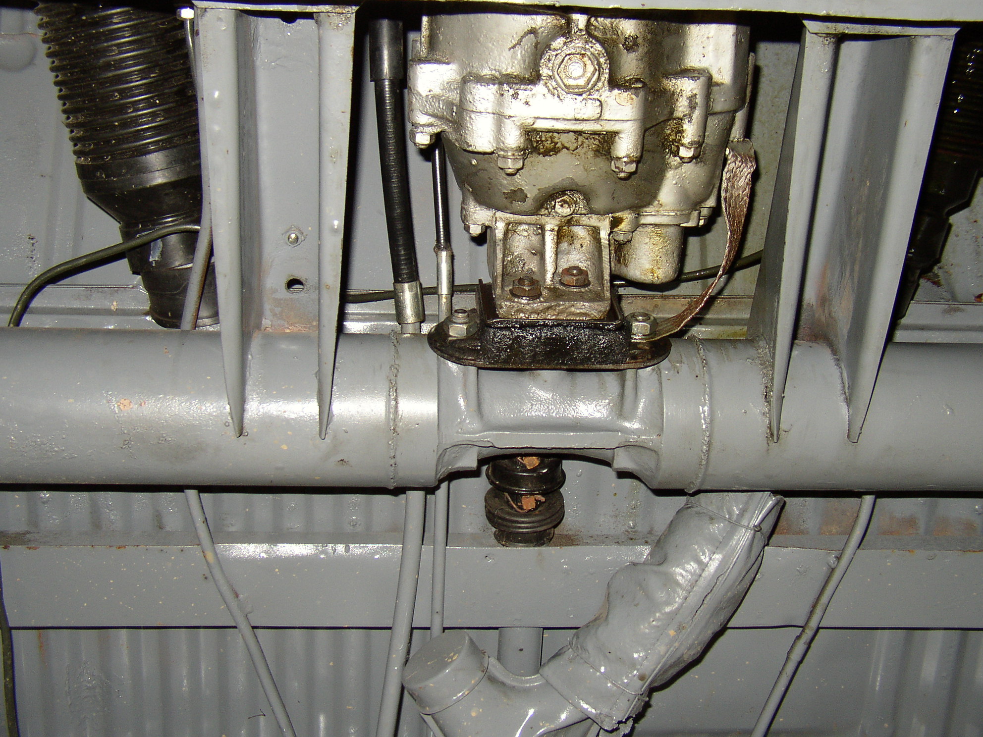

Yes, better here and now than on KI next week. Pretty much the same drill replacing it. I noticed the clutch cable Bowden tube didn't seat right away in the picture- this explains the big "bang" the first time I pushed on the clutch. I thought something was going wrong in the bellhousing....
I adjusted the valves, too.

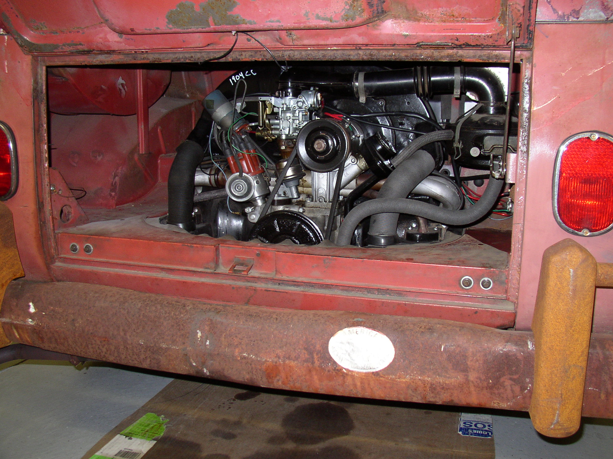

Remember "Musical Chairs" when you were a kid? I'm doing Musical Motors. The 2180 from the Ghia went into Bus 1, the 1904 from Bus 1 went into Bus 2. The 1600 CWC goes from B2 to the shelf. I didn't take a lot of pictures to document the process but it went smoothly. Out with the 1600:
In with the 1904:
The last time I tried to beat the clock, on page 14 I hustled and did it in 1:15 with the bumper on. I thought I'd take my time and to make it easier I pulled the bumper. Even with switching the clutch, modifying the throttle tube and R&Ring the bumper it still only took 1:40, much quicker than I though it would be. That was Monday, I took it for a long ride then and yesterday too. I saw an old T3 fastback on Rt 82 in Grafton driving in it yesterday.

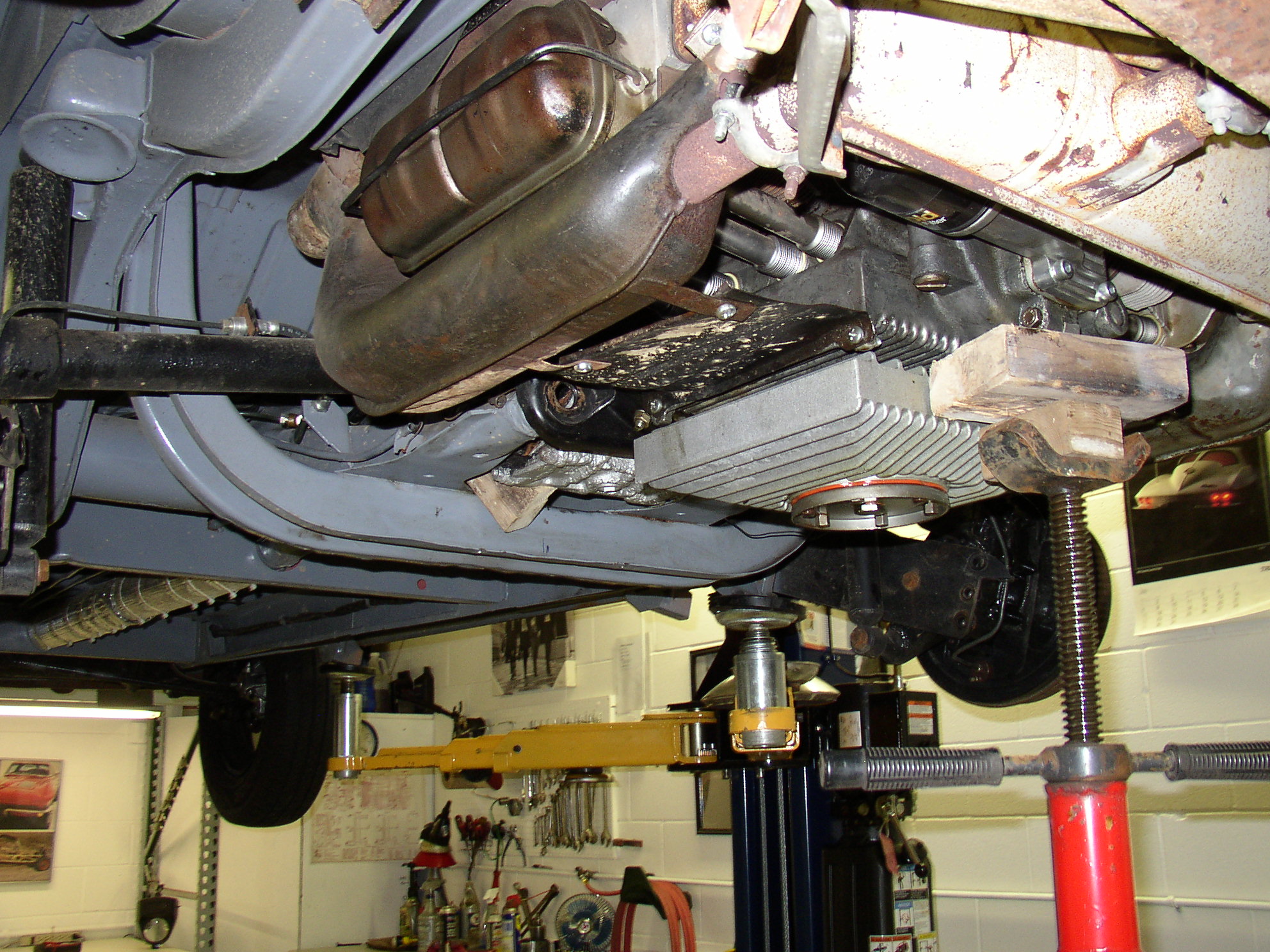

Jim's Custom finally got my tranny done so I picked it up at the show Saturday. It needed the normal stuff, a couple of synchros, 1st gear, bearings, etc. I'm splitting my time between Sean's motor and Bus 2 right now. I got Sean's long block done so I'm going to change my tranny now.
Exit motor!
Exit trans!
I sure wish I could snap my fingers and get those axles to jump over from the old trans to the new trans. These things are a royal PITA to change axles on, the whole RGB and everything has to be torn down. At least it's all fresh so it shouldn't need anything.
