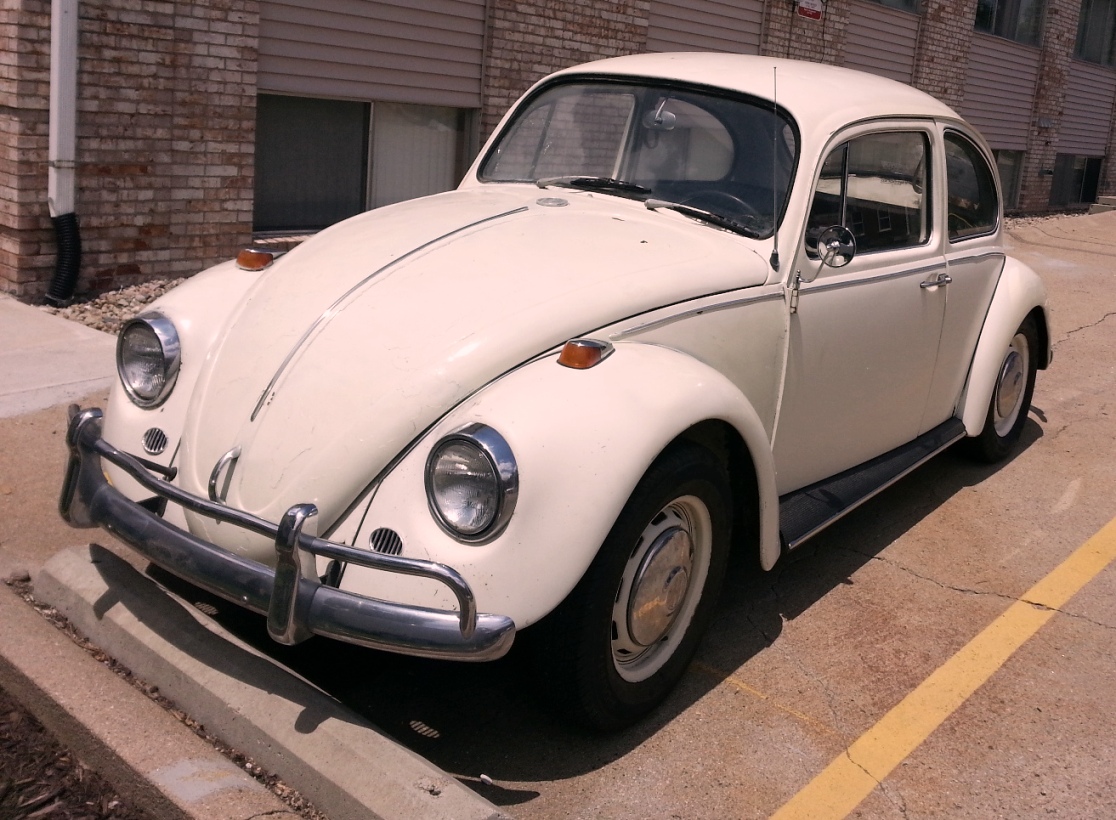

What's been going on with this thing:
I drove it last weekend and it didn't want to make it up the damn hill to where I live, yet it had before. After lots of playing (carb was clean) I finally made it home. It died in first going up the hill. I again checked the float level and all that fun stuff.
Cleaned tank with pressure washer, some junk came out and it looks decent now.
Got a fuel tank sock from a shop in town and some trim bits I was missing.
Determined the heater box levers are rusted so the heat is always on, need to fix that issue. Yes it does indeed actually work to make 90 degree days even warmer.
While checking the heat exchangers I found a wonderful :roll: surprise of another clear filter in line by the transmission. It was black and full of sediment. I replaced it. I haven't had the 67 on the jack yet because it was buried in my storage closet. Maybe this will solve some of my problems with it dying on me going up hill?
So in total this thing now has 4 filters for fuel and a pressure washed tank: fuel tank mesh sock, plastic filter by transmission, filter in fuel pump, and a plastic filter after the pump.
Next is the windshield after I watch more videos on how to replace them, then figuring out the wiper armature.
