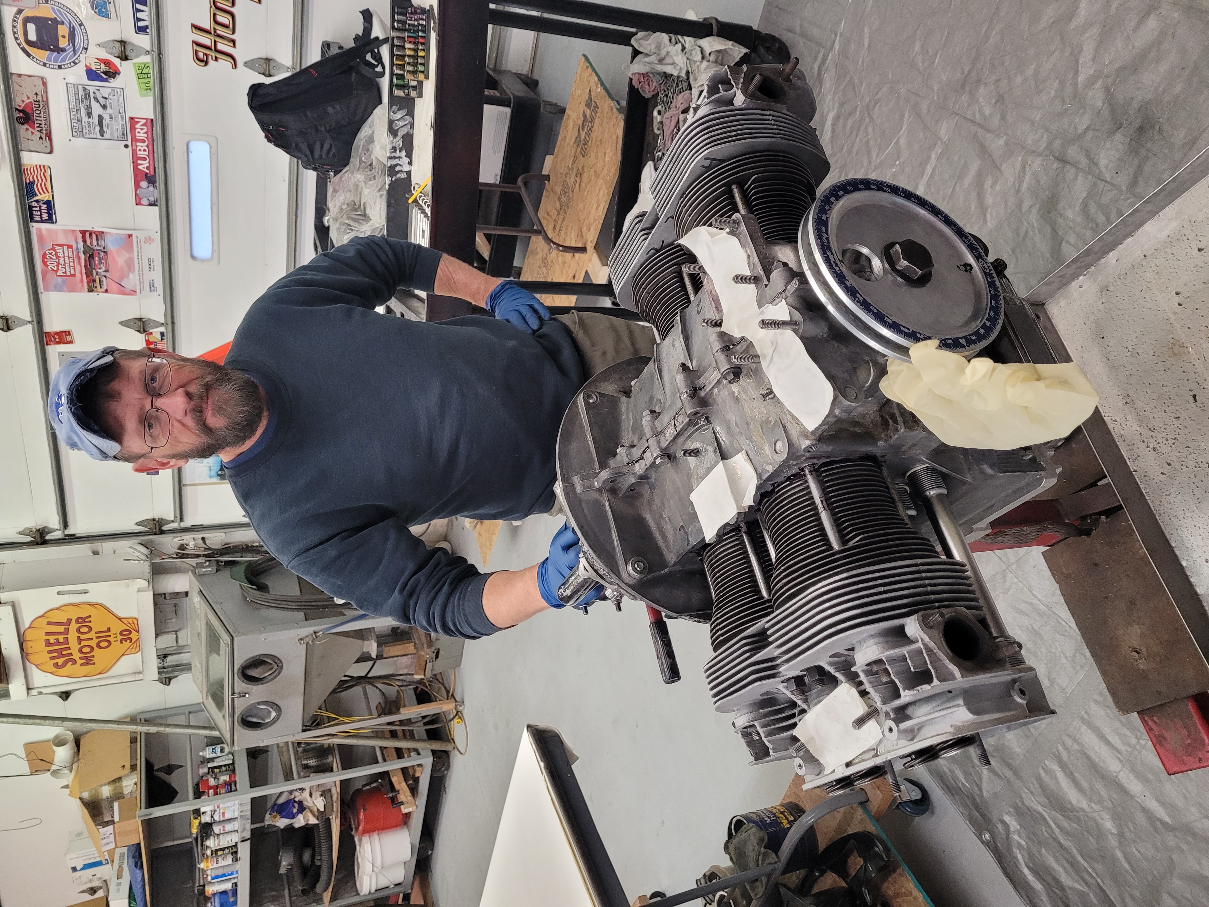

New motor starting to go together, his case was already .060" over so not usable, but I had a case upstairs that wasn't cut yet. We had that line bored, heads done, new CW crank, mild Crower cam, as the CB cheater cam is on perennial backorder right now. (the 2280 I like) New cases are hard to find and about $1200 now, double what they were two years ago when I built Sean's.
Jim's is doing a tranny too, so it will have a whole new drivetrain. He did a nice job on the line bore, with my tooling it measures within a tenth (.0001") of what it should be, and that was with an inside mike (not the perfect measuring tool). Spec gives .0007" leeway. New Bugpack Chinesium crank measured dead on.
Rob's polishing the new crank with 2000 grit in the picture. We polish the cam journals, too, as I think that's what caused the premature cam bearing wear on my 2180. You can see and feel a difference after polishing with 2000. Rotating mass was balanced, too, and the pistons/rods are within a gram. (spec is 5 grams) Yes, I have a gram scale and it's for measuring parts, nothing else!
End result will be a stock 1600 with a CW and cam, and stock gears in the trans. Engine was low mileage with Brazilian heads, Mahle jugs and slugs so we'll reuse those, honed with new rings.

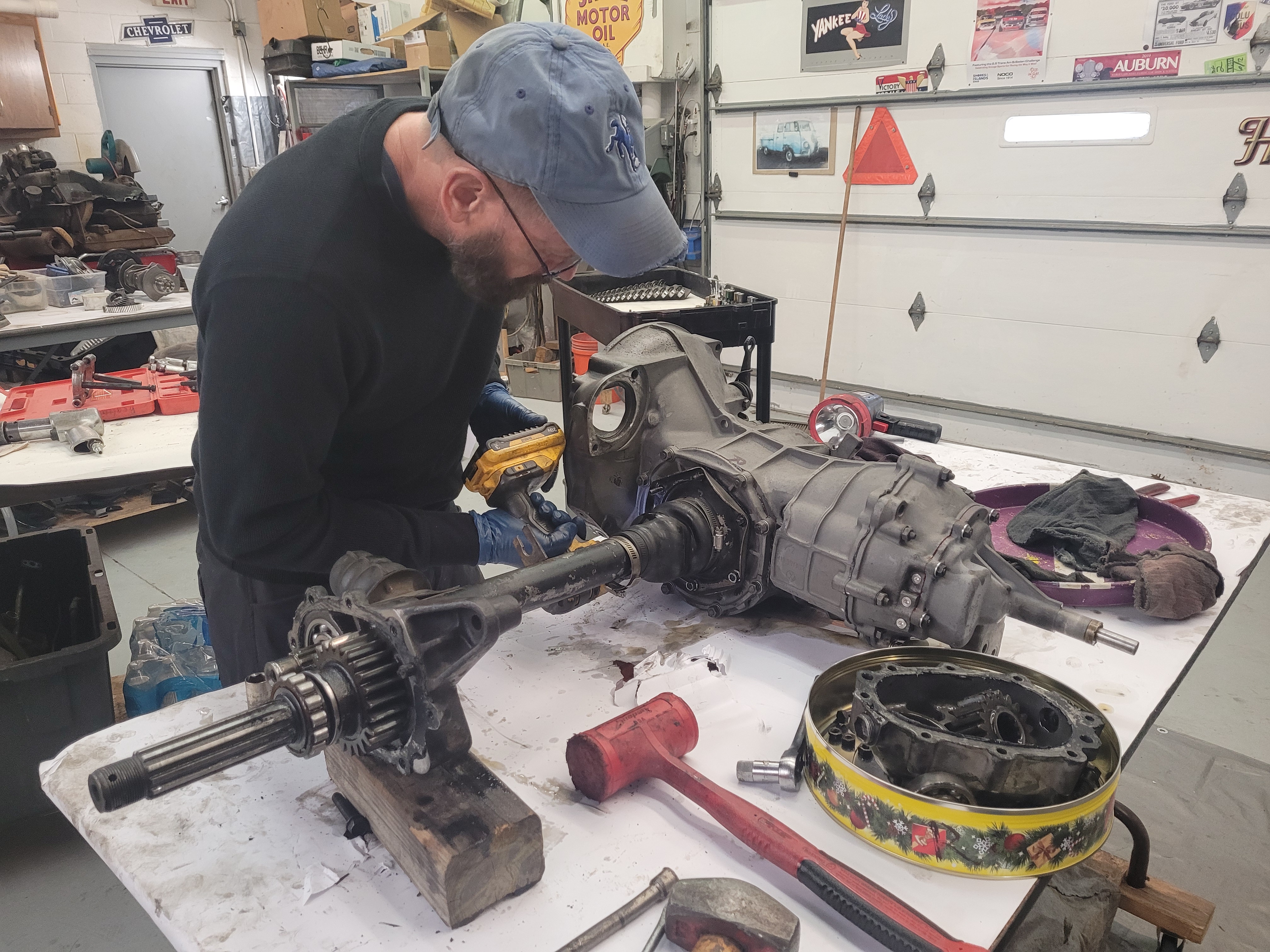

Double bad luck on this one, the motor and trans (both new) were both junk. The tranny done by Jim's Custom jumps out of first and fourth and has a wicked gear whine.
Rob's motor (which he built but I take responsibility for) lasted 400 miles and quit in MI, the crank turns but the cam was not. :cry:
First, pull the drivetrain and split the axles for the tranny to go back to Jim's.
Get the tranny back to Jim for warranty work while we figger out what's wrong with the motor. :?

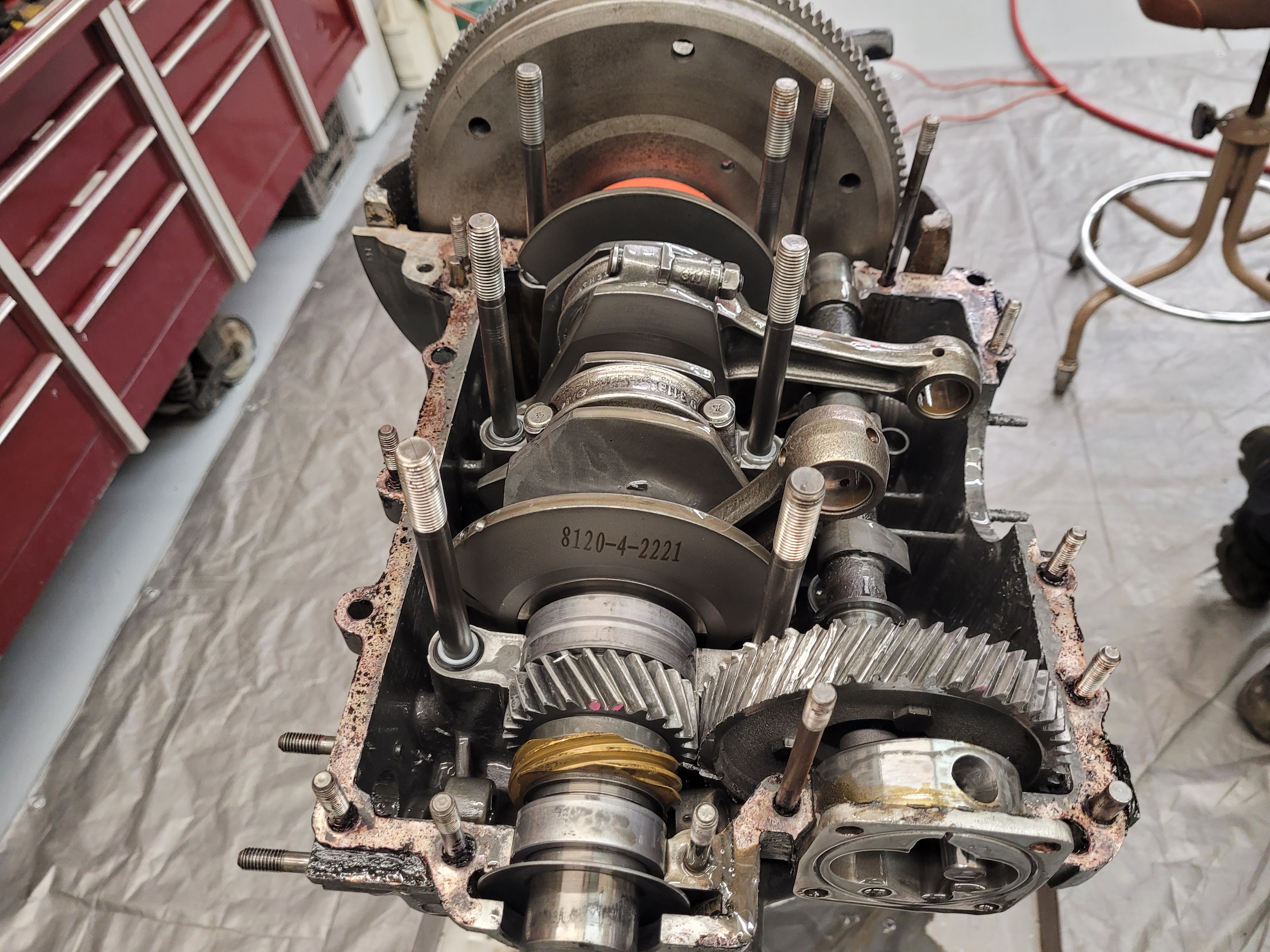

Then tear the motor down (with Joe's help) to find the cam gear sheared half of the teeth off. Neither Jim's Custom or Bill have ever seen this before.
Piece of cam gear tooth stuck in the crank gear.
They were good used OEG gears from motors I have torn down over the years. Backlash was perfect through 720* (.000-.002") and everything went together smoothly. The gears looked perfect going together originally but were from different engines- not a matched set. Case was linebored and we took a lot of time to measure all tolerances. All I can say is the crank gear probably had an imperfect finish on it when it went together and ate the aluminum cam gear.

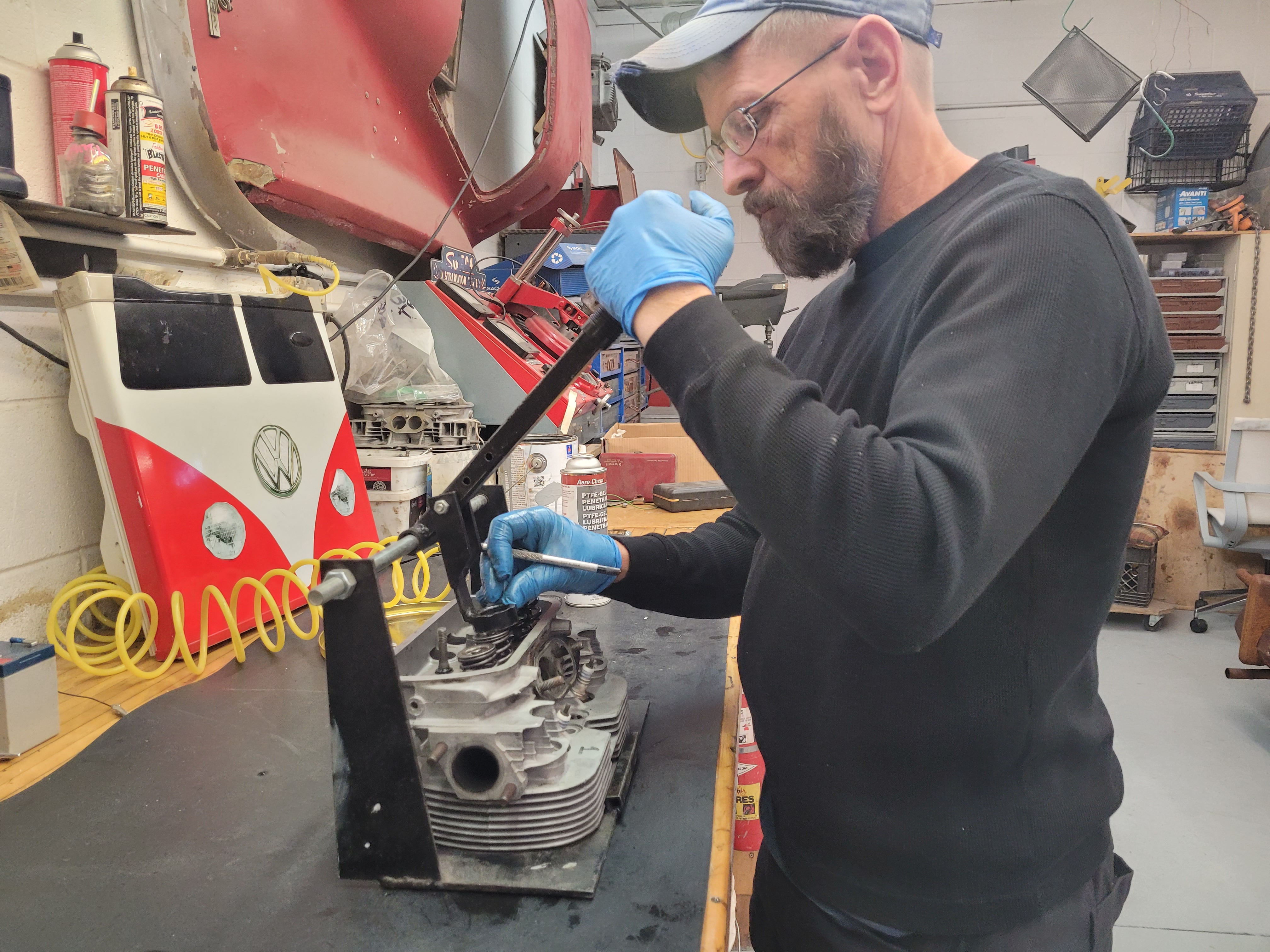

We tore down the heads to inspect and clean them in case there was debris in the guides. All looks good and the valves were seating nicely.
