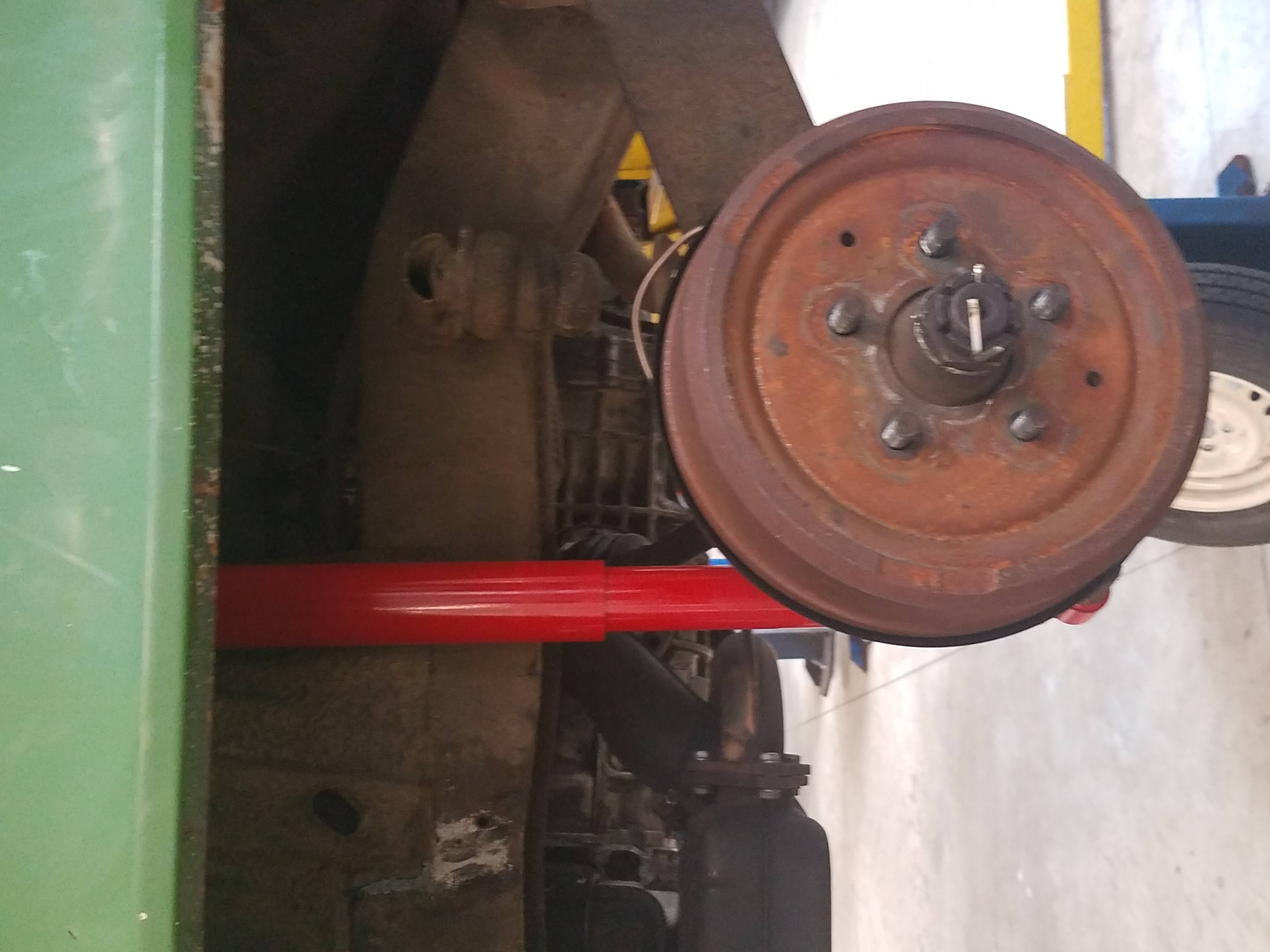

The brake grinding was caused by my new backing plates and new drums rubbing. According to my research the spacer inside the rear hubs changed in size and I should have replaced it with a new style one. I got a new style backing plate and drum but still had the old spacer. I ground off enough material so they no longer rub.

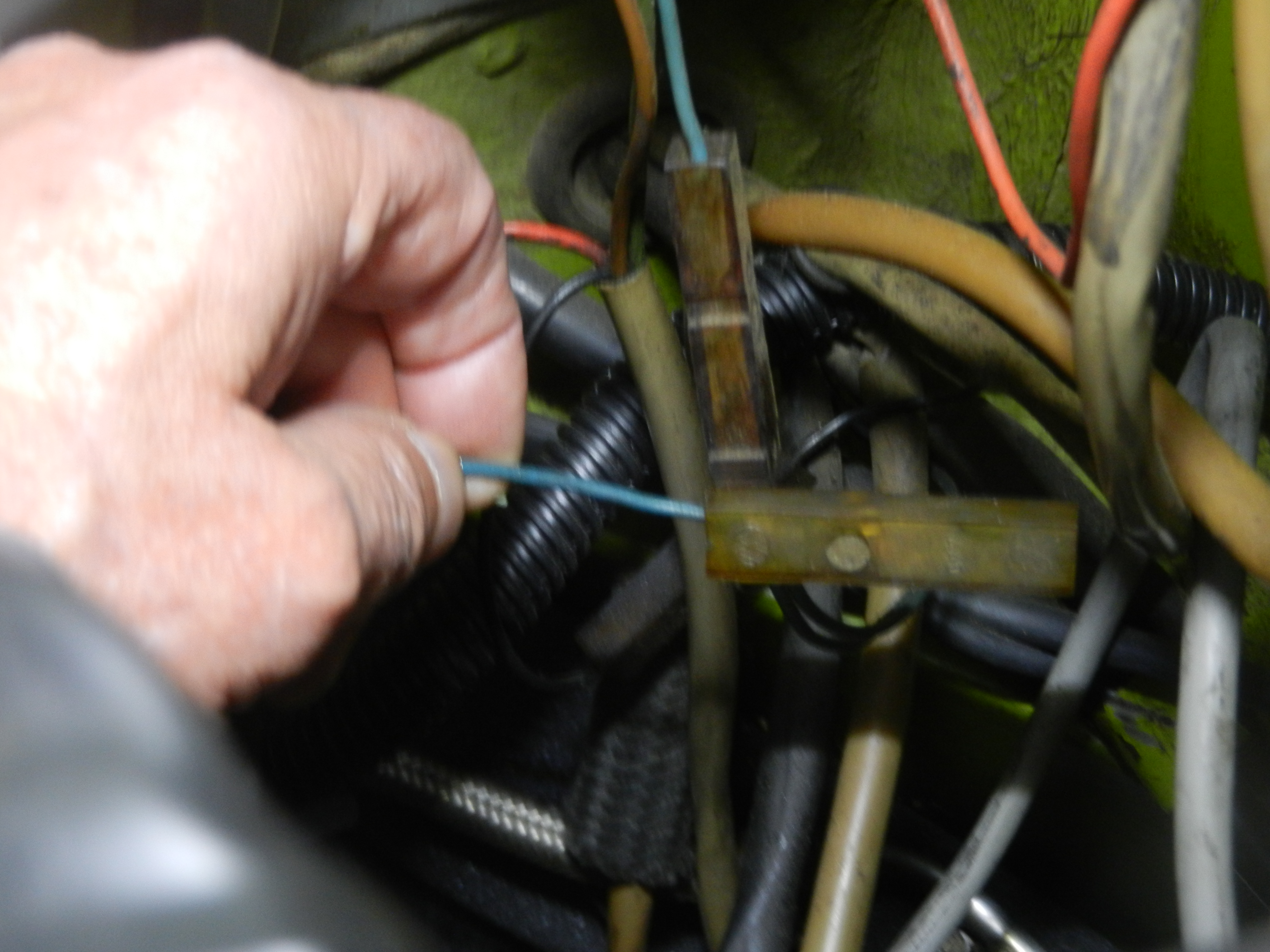

Look closely at wiring diagram for alt/reg. I will try to post a pic today. There is a blue wire that dangles near the regulator. It is the excitor wire that goes to the lite on the dash. Alt will not charge battery if this is not connected.

About the blue wire: its connected and the alt light functions correctly. I fixed a bad splice and now I'm getting about 12.8 volts. Still seems low.
