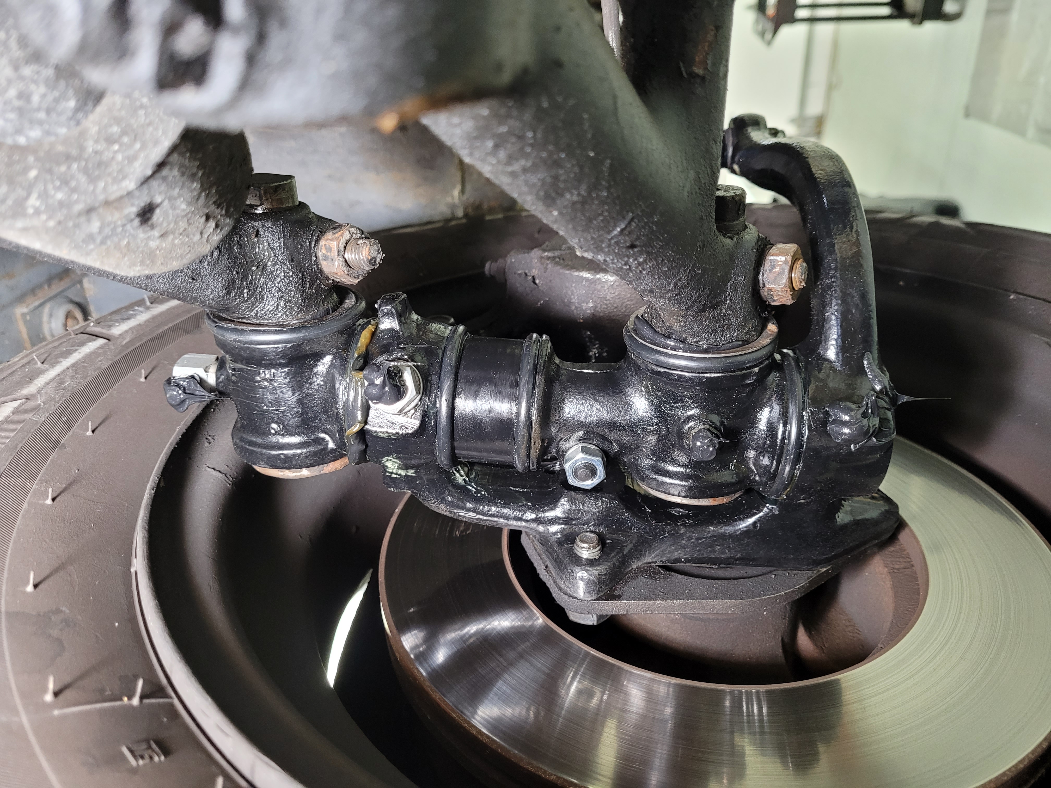

by Dual Port
Spindles are on.
I pulled the center pin out to find it is like new.
I pulled and resealed all of the JayCee pushrod tubes, as the o-rings had gotten square and leaked from age.
The weather finally cooperated for a long test drive yesterday, it drives great and doesn't leak!
