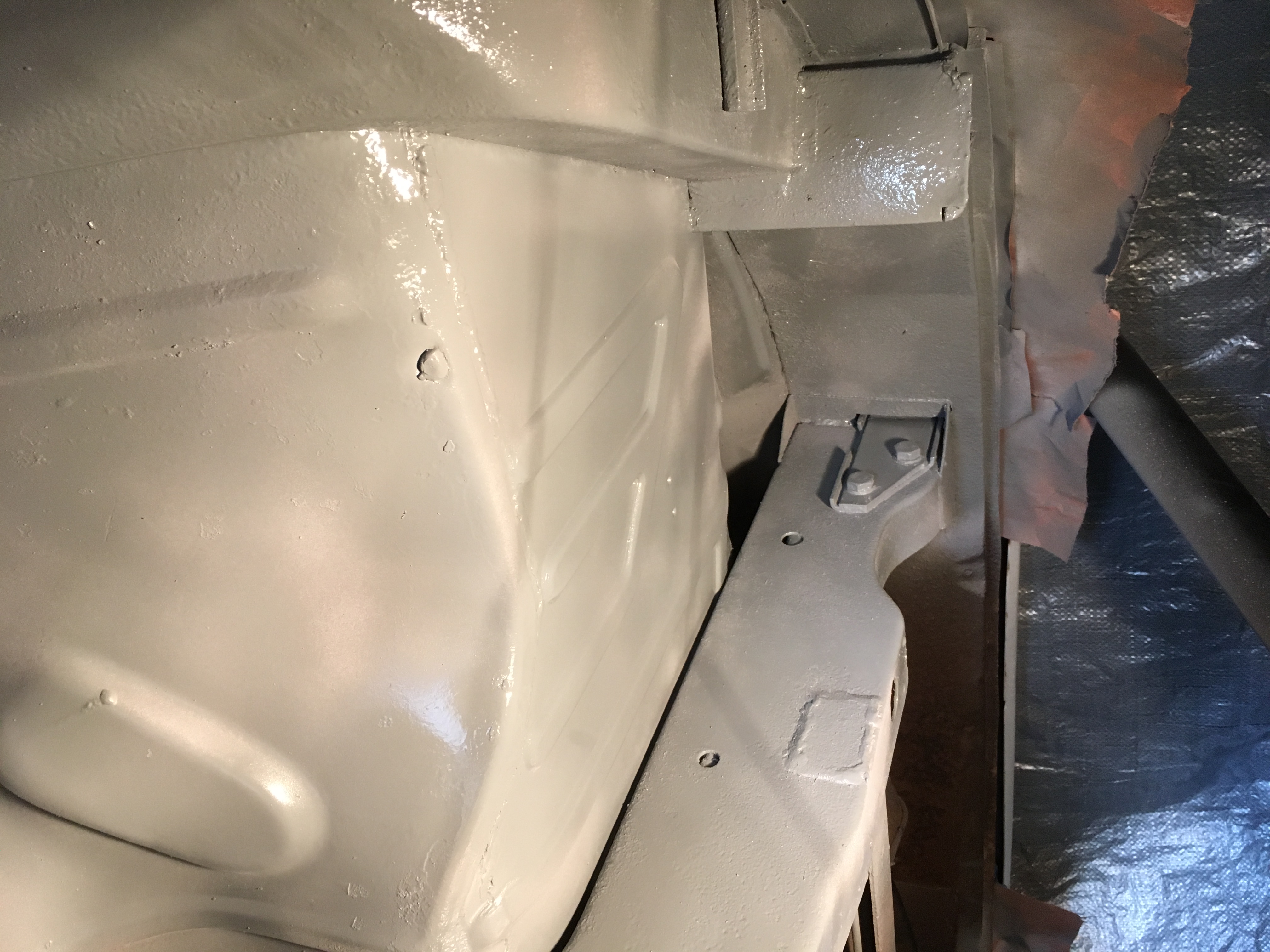

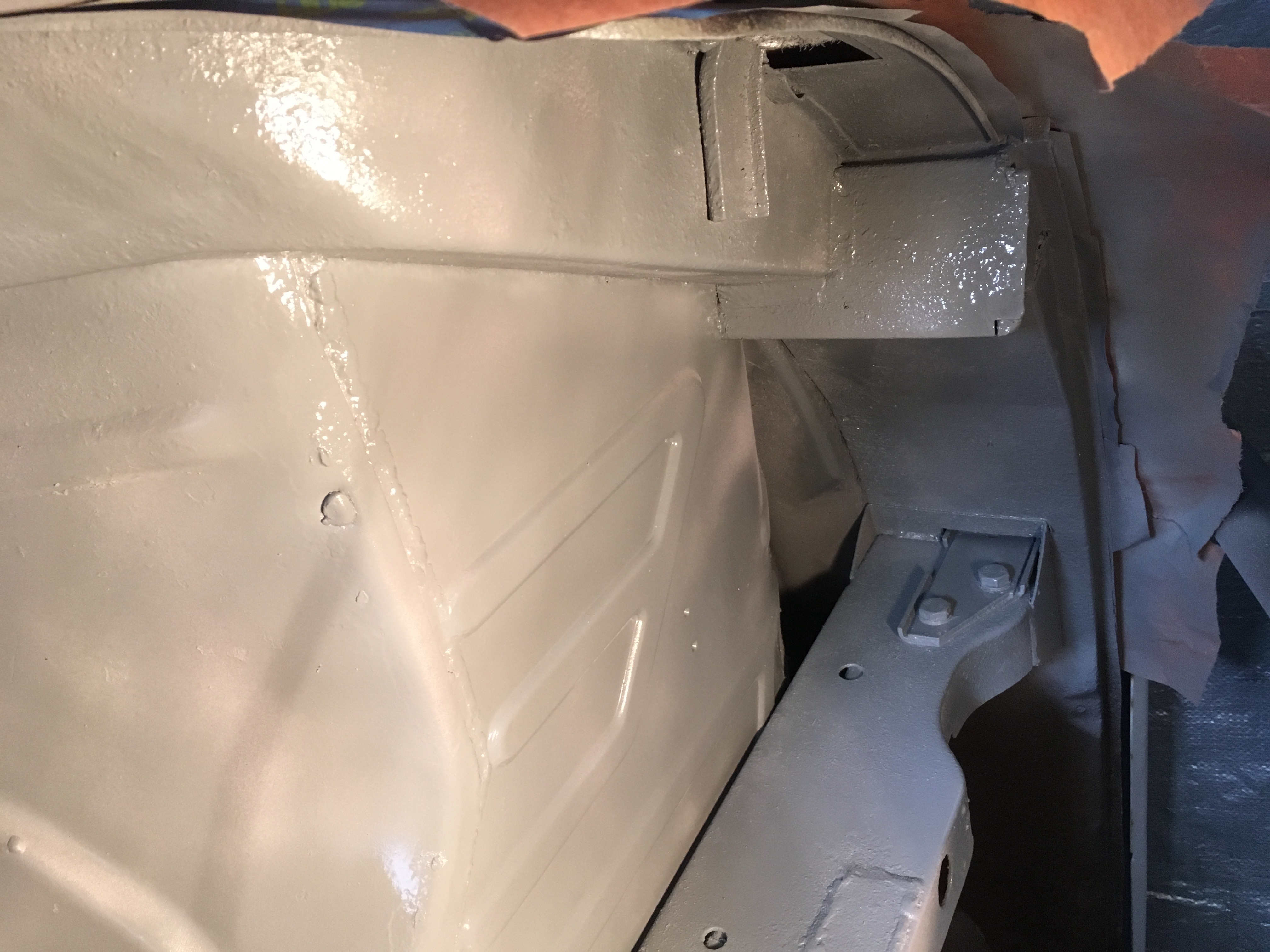

I finished getting the wheel wells painted and decided to do under the front nose as well. The underside of the nose was very solid. Some surface rust was about all I saw. I used the same process and just finished putting the final coat on this AM.
Now that I am done with that and the bus is still up in the air, I am going to check out my front brakes. This is another project I intended to do a few years ago and just never got around to it. I have the parts to replace the shoes but I am not going to that extent yet. I am just going to see what is going on inside for now. I am debating on going to a disc brake set up depending on what I find.
Here are some photos of the underside to share. Click on the photo to see them right side up

Good Job Marla! I can't believe how solid it is. :!:
