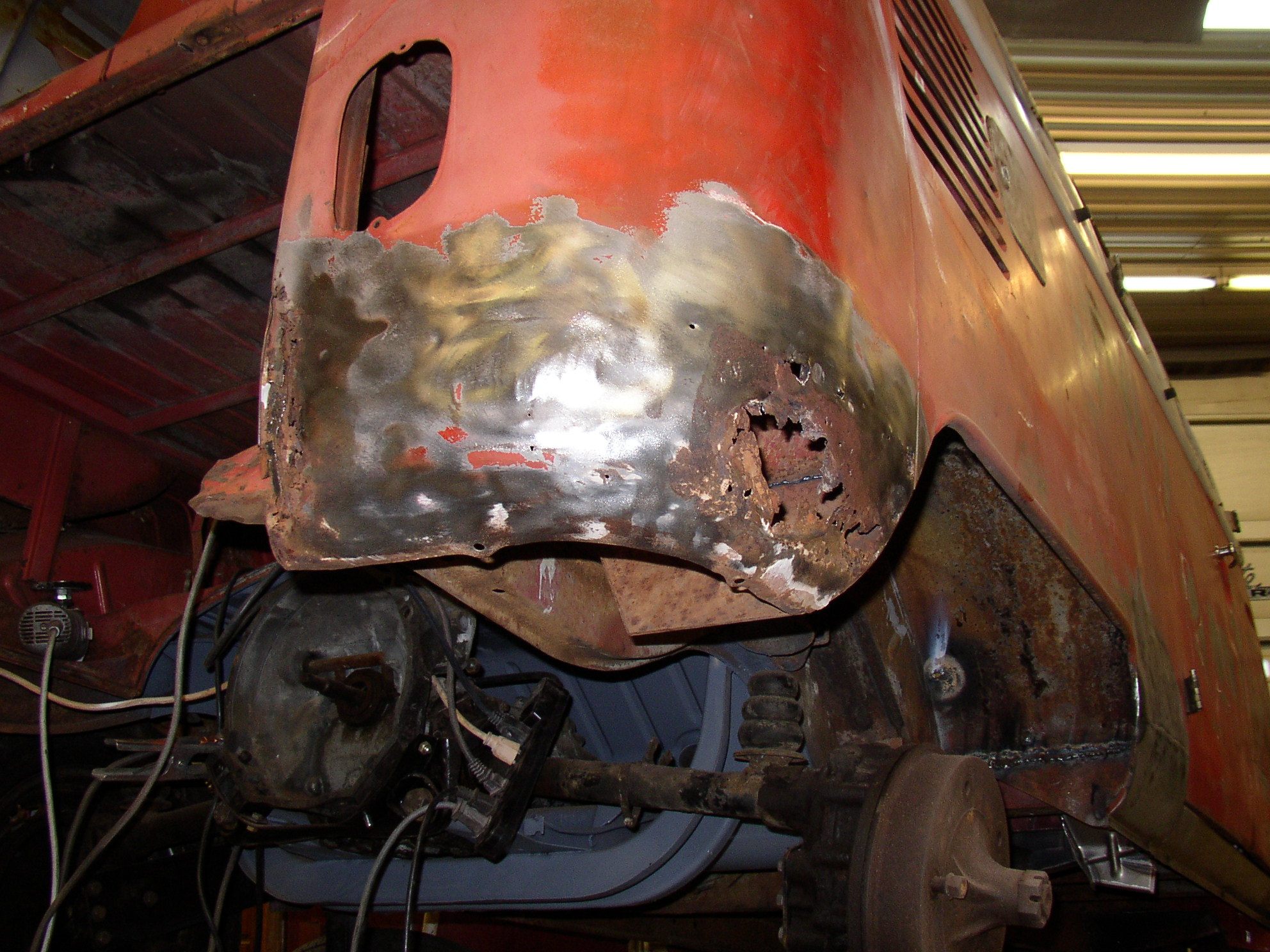

Anyway, back to the bus. The RR corner was next and it was crumpled up from a light hit. My gut instinct is to not cut the crumpled metal off, I generally straighten it back to near-correct before cutting so I don’t get too much going on at one time. So I took my monster wire wheel/bondo/flesh remover and took off all of the bondo, which takes about 30 seconds. Then I hammer and dollied out the crumpled metal until it resembled the correct profile.
I then cut the wasted portion of the metal away and started eyeballing the new panel, which was the curved section and not the flange next to the engine lid.
