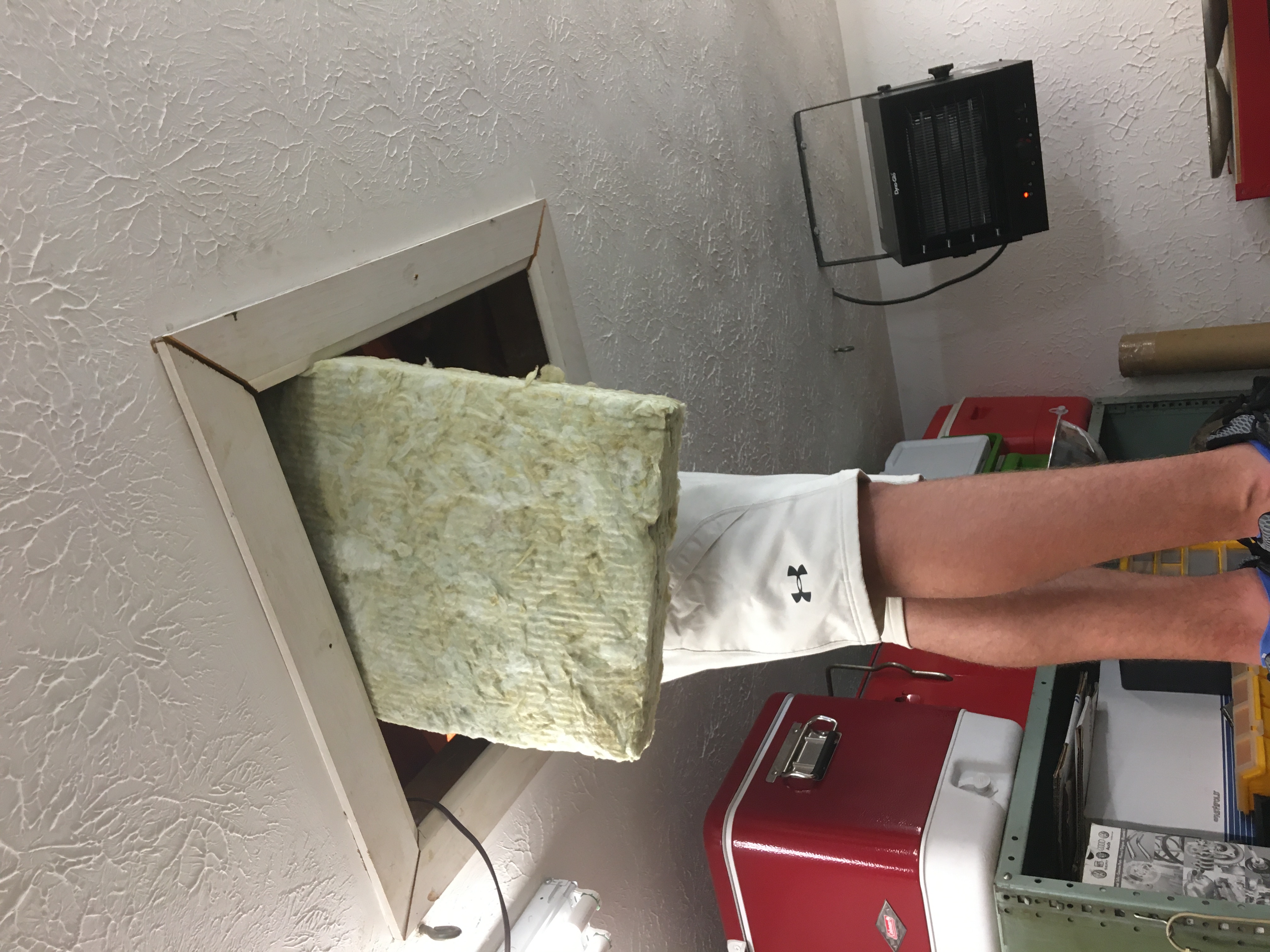

Thanks for the suggestions on insulation. Someone had mentioned mineral wool and that is what I went with. It was very similar to the original and easy to work with.
I used the old pieces as templates. It cut very easily with a utility blade. The original was about 2 inches thick and this was 3, but it was very easy to peel an inch off. When I was done I had my son, gotta love bored teenagers, haul the left overs to the attic above my garage :lol:
