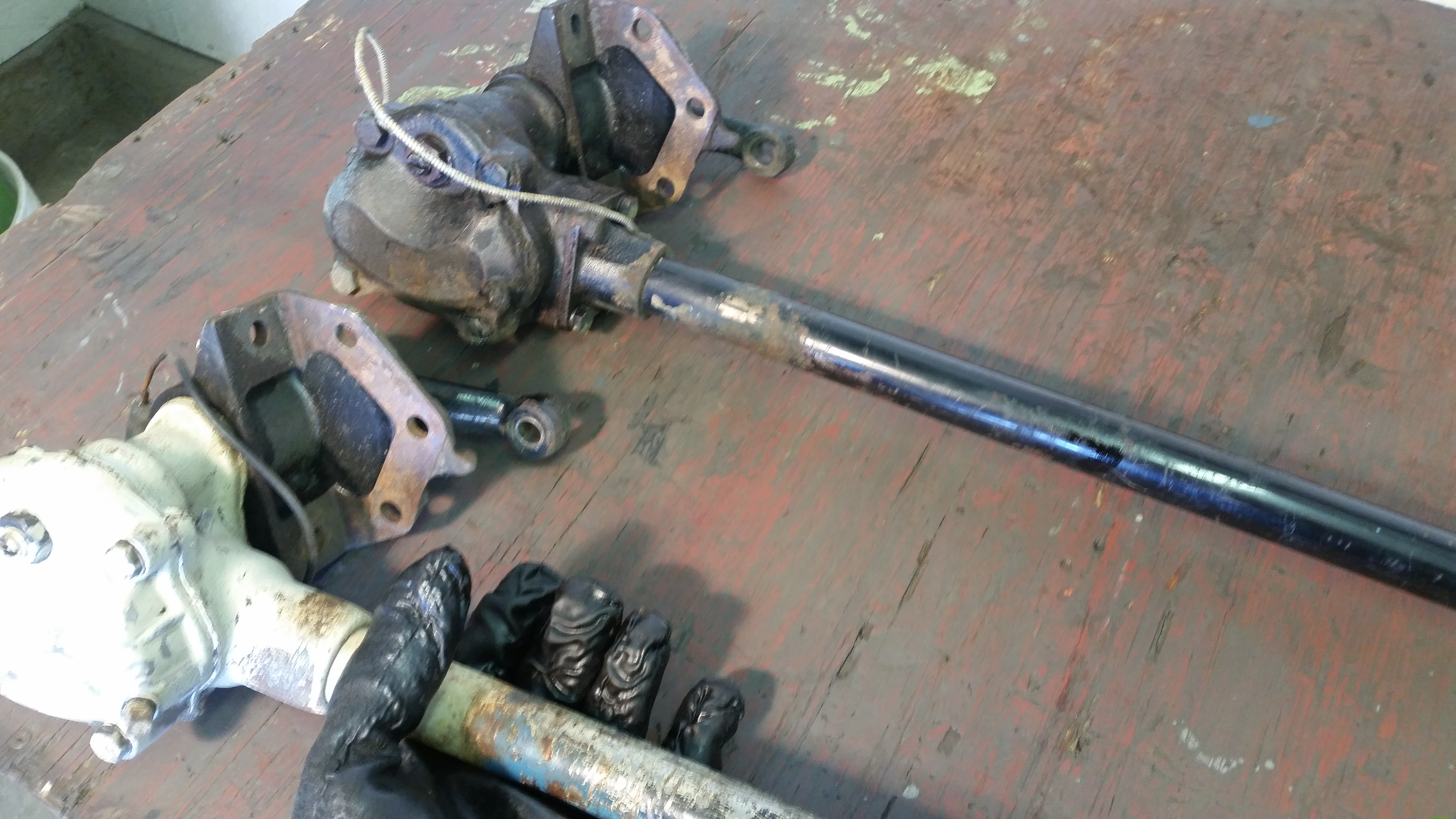

I think I'll break one of this open and see what's inside

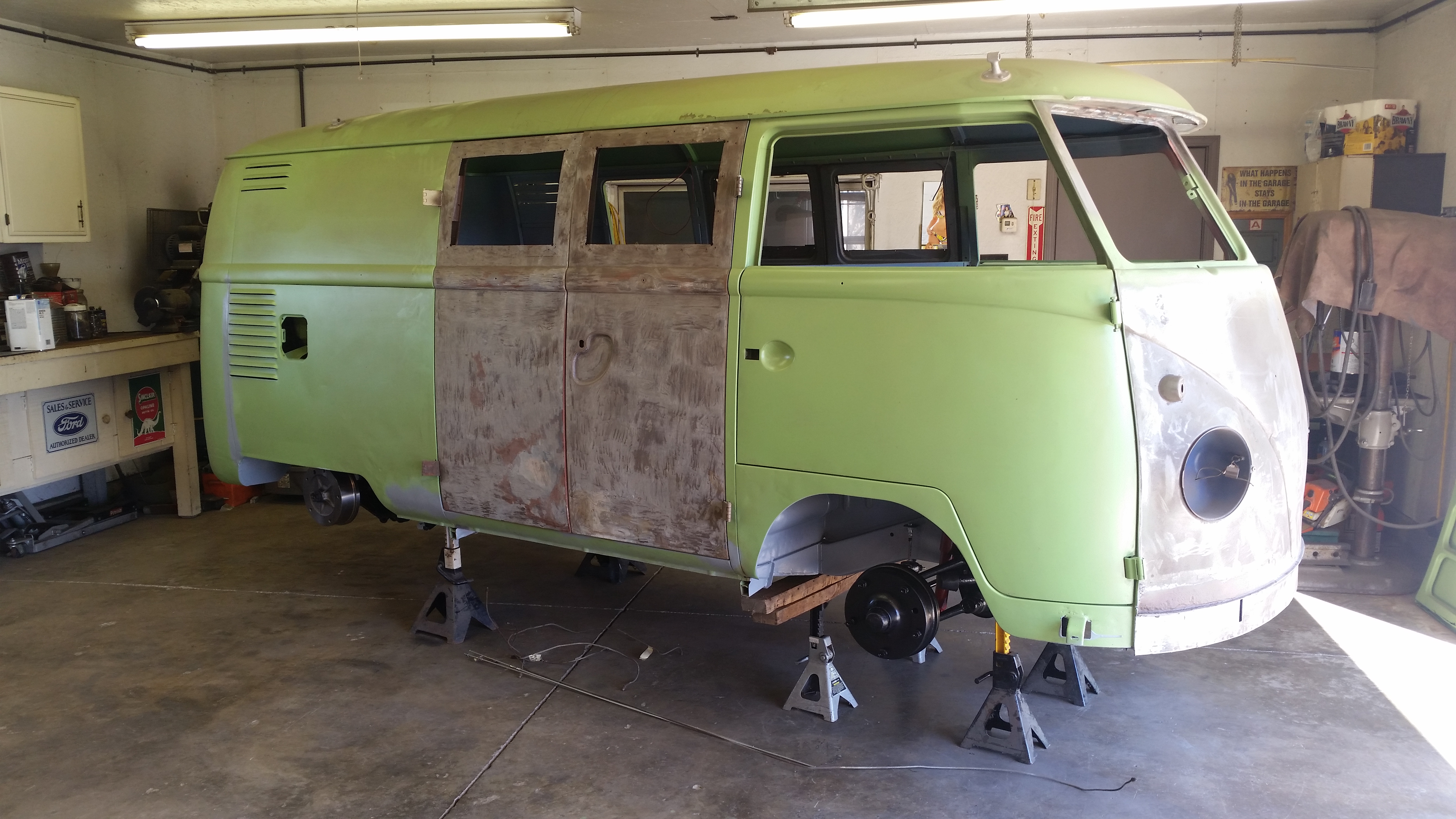

Lots of stuff bolted on....but a long way to still go.

You've got the mount for your circus tent. Don't remember seeing a post for that.
How is that going to work with your rack?

Mike Kever Kombi wrote:How is that going to work with your rack?
It might not work, it'll be one or the other, or modify the awning??

Is that bus all Gerson except the nose and two doors? :lol:
