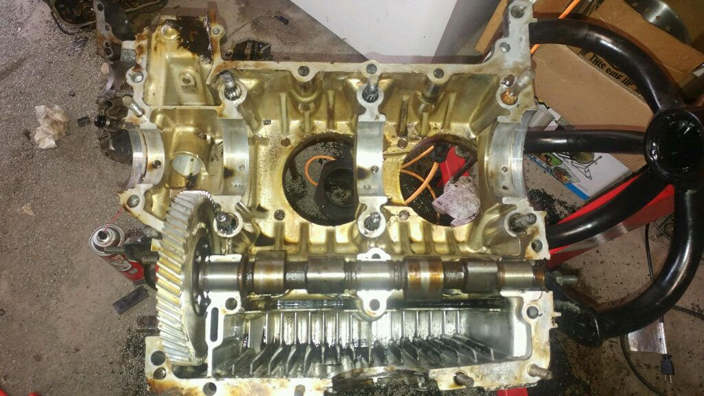

Posted: Sat Oct 01, 2016 11:55 am
by Kooper271
Do these cracks mean its time for a new case?
Edit: They aren't cracks. Whew.
Well guys, Mike especially, I guess its time for you to say "I told you so." The inside of this case is very, very clean. Everything looks like it has < 10,000 miles on it. I assumed because of all the sludge, missing tin, etc on the outside that the inside would be rough but it honestly looks like someone rebuilt the engine drove it a little bit then let it sit for so long.
The only issues I saw were the P&C's, the mounting studs, and the heads. Oh well, no turning back now.

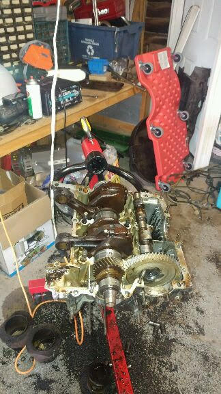

Posted: Sat Oct 01, 2016 2:14 pm
by Kooper271
Here are some more pictures. No cleaning here at all, this is how it looked when I opened it.

Posted: Sat Oct 01, 2016 7:06 pm
by wwebner
Looks like you've been busy today. Next step is clean,clean,clean. Curious. Do you have a bolt on cam gear? which would mean the cam had been replaced at some point.
