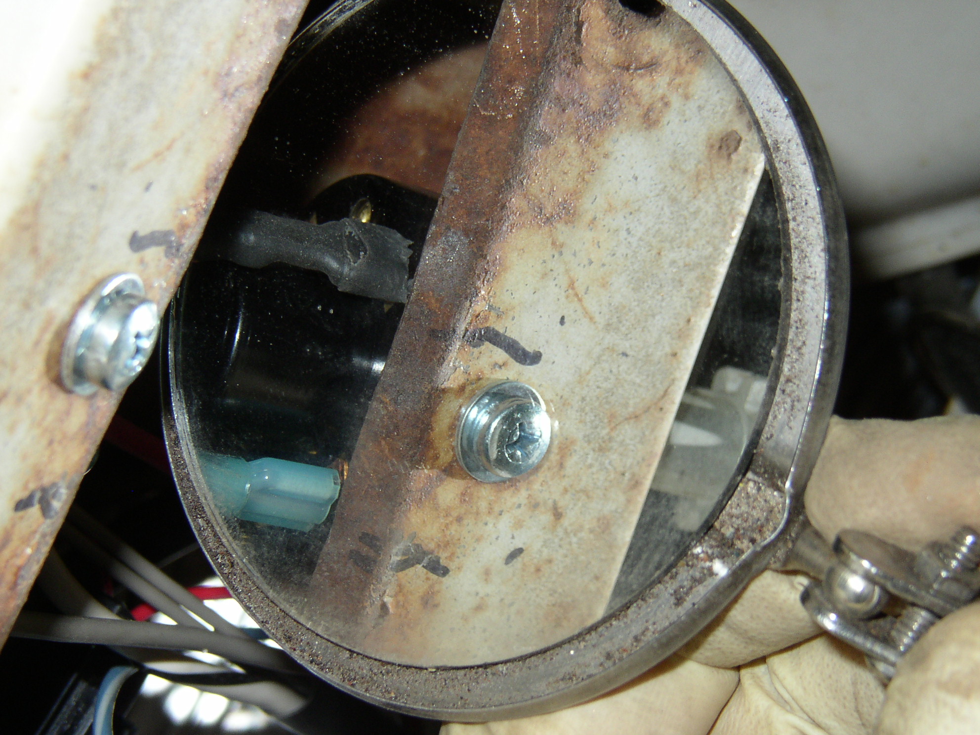

Clamped a bubble mirror to the garage door so I could see the taillights while I was sorting out the electrical.

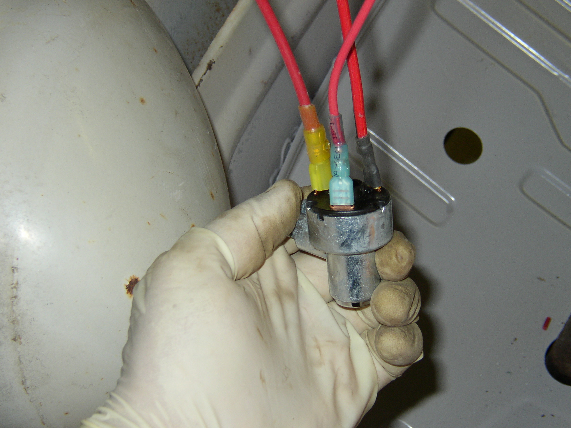

Here's why you need a 40a fuse in the back feeding the dash harness- the aftermarket ignition switch had the hot lead (blue connector) scary close to the lip on the dash. A little wiggle, a good bump, and your red wire turns bright red.
Quick work with a die grinder fixes that.

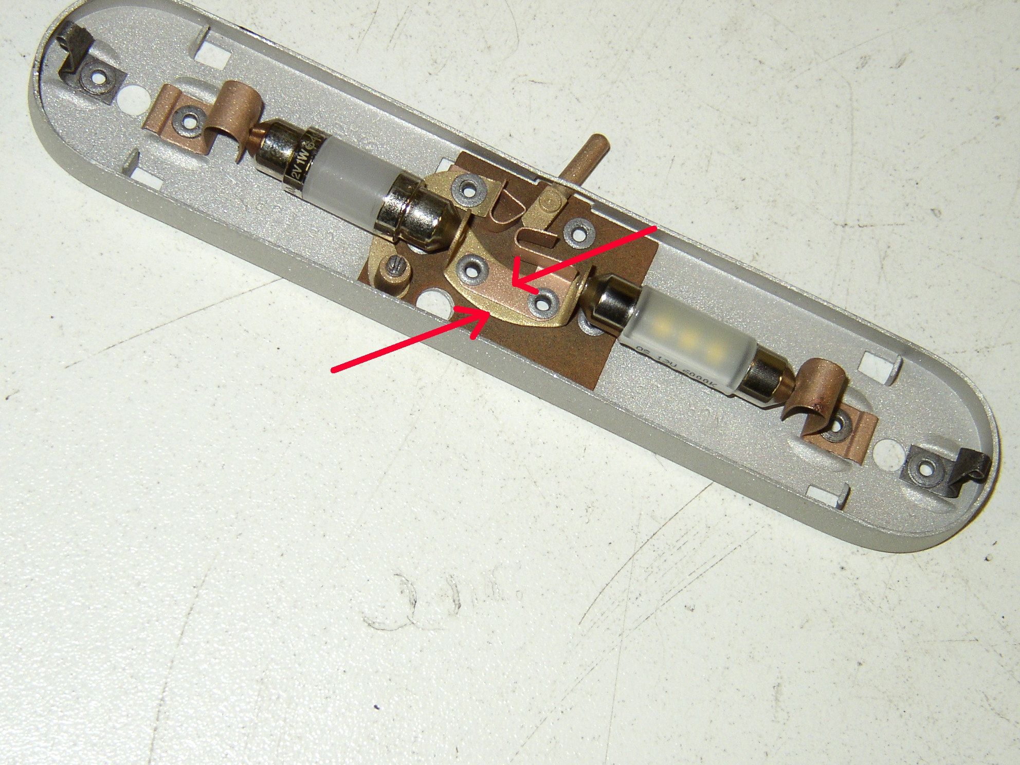

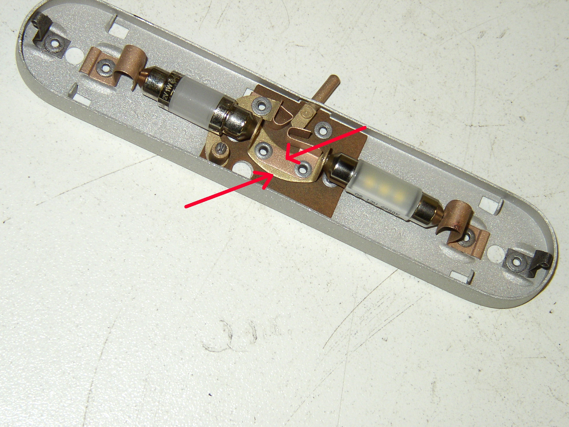

Just because it's bead blasted doesn't mean it makes good connection. Note the two pieces with the arrows are riveted together but do not have continuity!
A dab of solder fixes that, just like 6v's HL fusebox.
And we have LED interior lights!
Each of the four bulbs draws only 30ma (.030a) so one bulb could be left on for several months before running the battery low. I love these things and am currently converting my home bulbs all over to LED, and am thinking about changing all of the shop fluorescents to LED too.

Here's the back of the ignition switch showing the updated wiring and shrink tube, It's kind of important to shield hot leads from accidental grounding, (right, Volkswagen?).

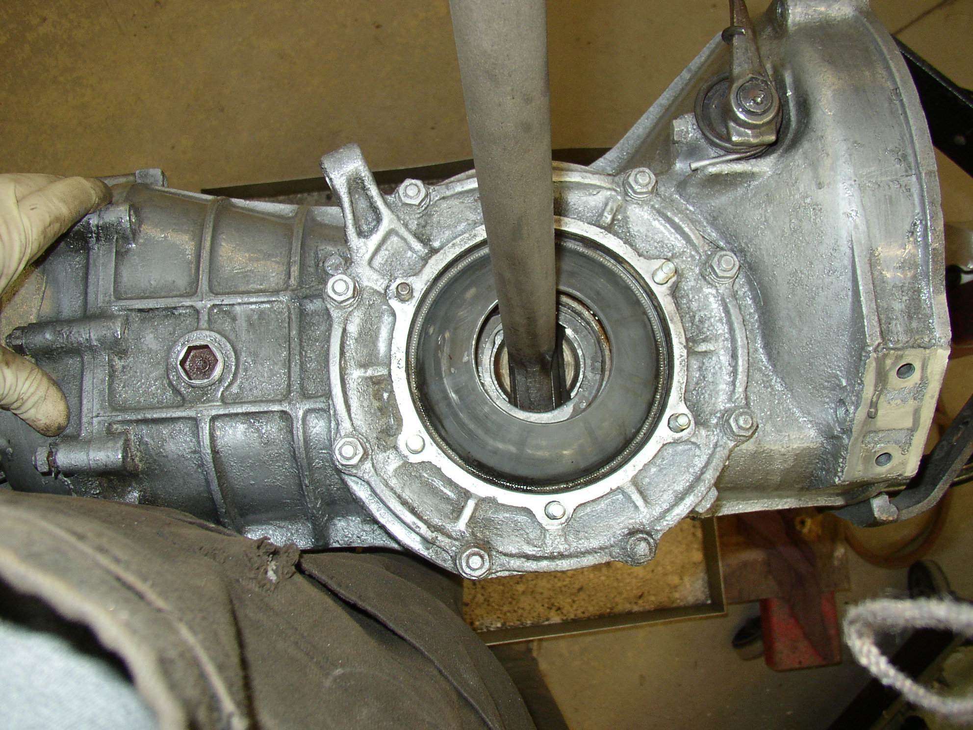

On to the Mystery Trans. First, run the selector through all 5 gears and see if they are present, check, but the hockey stick bushings are worn pretty well.
Second, hook up my homemade drill driver tool and see if all five gears are present, check. Note reverse gearshift pattern written on cardboard to help me figure out where I am.
OK, the trans
might be OK, proceed with putting new shift bushings in the nosecone. Most people would buy a new $40-60 nose, but not me.

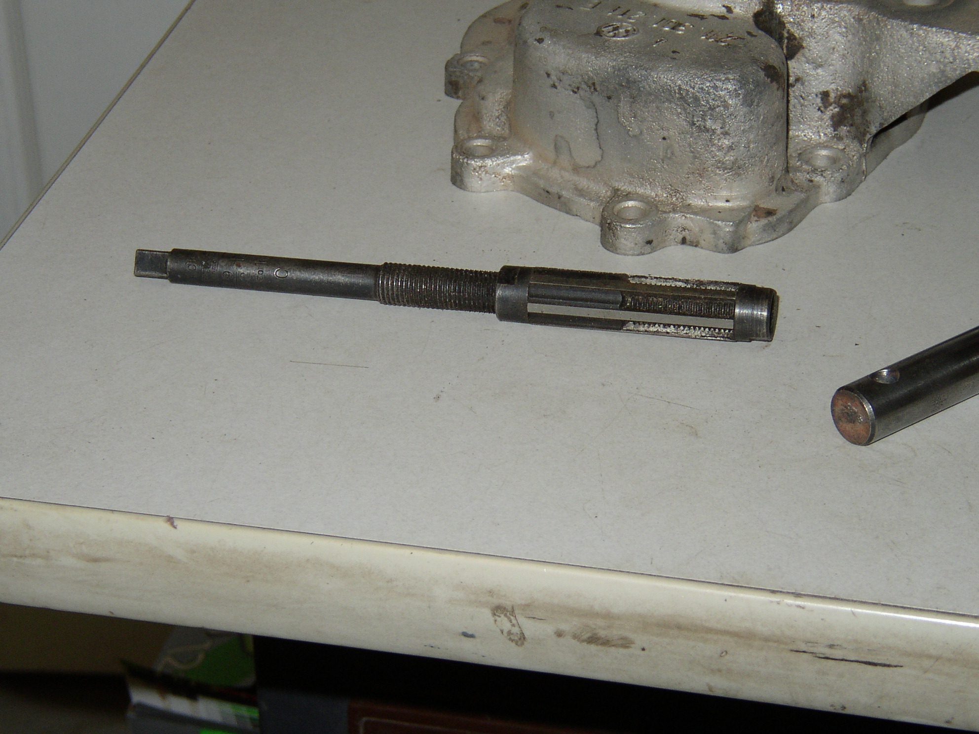

I didn't even need to ream them!

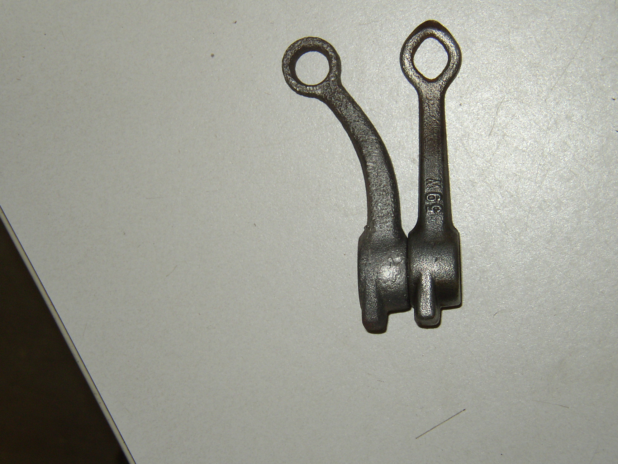

The clutch lever return spring was broken and the shaft was frozen, this gave me a reason to change the lever. Glow the old lever and remove it, and switch to the later '66 up lever that uses a wingnut and doesn't block the bellhousing bolt. That stupid early lever is ridiculous.
Note the lever on the left blocks the bellbolt making access very difficult. And if you've ever adjusted an early clutch with this double-nut setup it's enough reason to sell the car and buy a newer one.

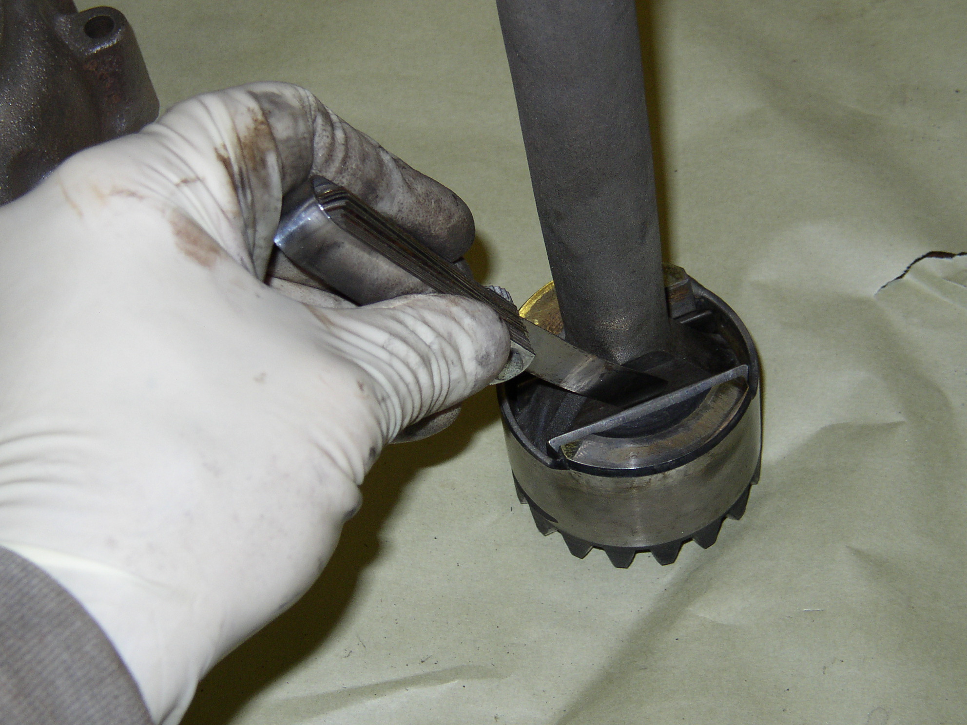

Here's all of the parts soaked, cleaned, wire wheeled, blasted, scrubbed, inspected, threads chased, brake cleaned and ready for assembly. I have two full afternoons breaking down the axles and cleaning these parts, upwards of 12 hours.
Check the fulcrums, install the side gear and axle shaft together as an assembly. Lube it well.
