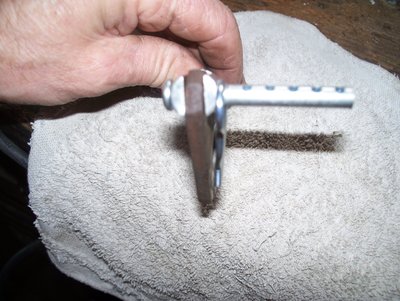

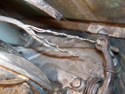

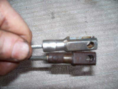

bus was grinding going into reverse, thought i would adjust cable free play. found wingnut had none, po turned it in too much. got off at noon, thought i would replace it ,have a spare. new cable end is longer and bigger, clevis pin unusable, got a replacement at the hardware store, after drilling,grinding,cutting it works. why dont those damn cables go in as easy as they come out!!!! 4 hours later all done.
cut off excess before installed

one strand away from disaster

got it from ww, close but not perfect

Pull the bowden tube off the trans next time and it will be easier to get the cable through. Check the hole in the arm of the clutch pedal, bet it is oblong. Fix it before it breaks...Best is to weld old and redrill hole.

after installing and adjusting free play the wingnut bottomed out :evil: i took it out and measuredit, 3120mm. my year calls for 3115mm. also i have a chatter when driving which i think may be the throw out bearing so i plan on pulling the motor this spring to have a look.
