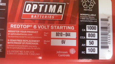

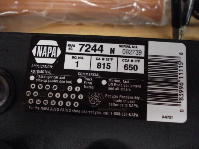

1. Replace the 10 year old NAPA Commercial battery (850 CCA) with an Optima (1000 CCA) battery.

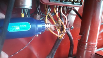

2.Cleaned and polished the wiring terminals at the battery, starting motor and fuse panel with a Dremel tool.

Ken wrote:Replace the 10 year old NAPA Commercial battery (850 CCA) with an Optima (1000 CCA) battery.
Hey Ken: Go get your reading glasses and look at those numbers again.
What do they say?
:lol:
BTW, CCA is measured at 0F, CA is measured at 32F, don't confuse the two. Because of the voltage difference the Napa battery has the same power as a 325CCA 12v battery, and the Optima would be like a 400 CCA 12v battery. Beware of discount parts stores advertising 600CA batteries cheap, many consumers read this as 600CCA......
What do they say?
:lol:
Funny you caught that. Carolyn just reminded me this morning that I'm due for an eye exam. :shock: :lol: .Thanks for your comments. Anyway there is a noticeable difference in the way the starter cranks over. Not as good as 12 volts but much better than before.
