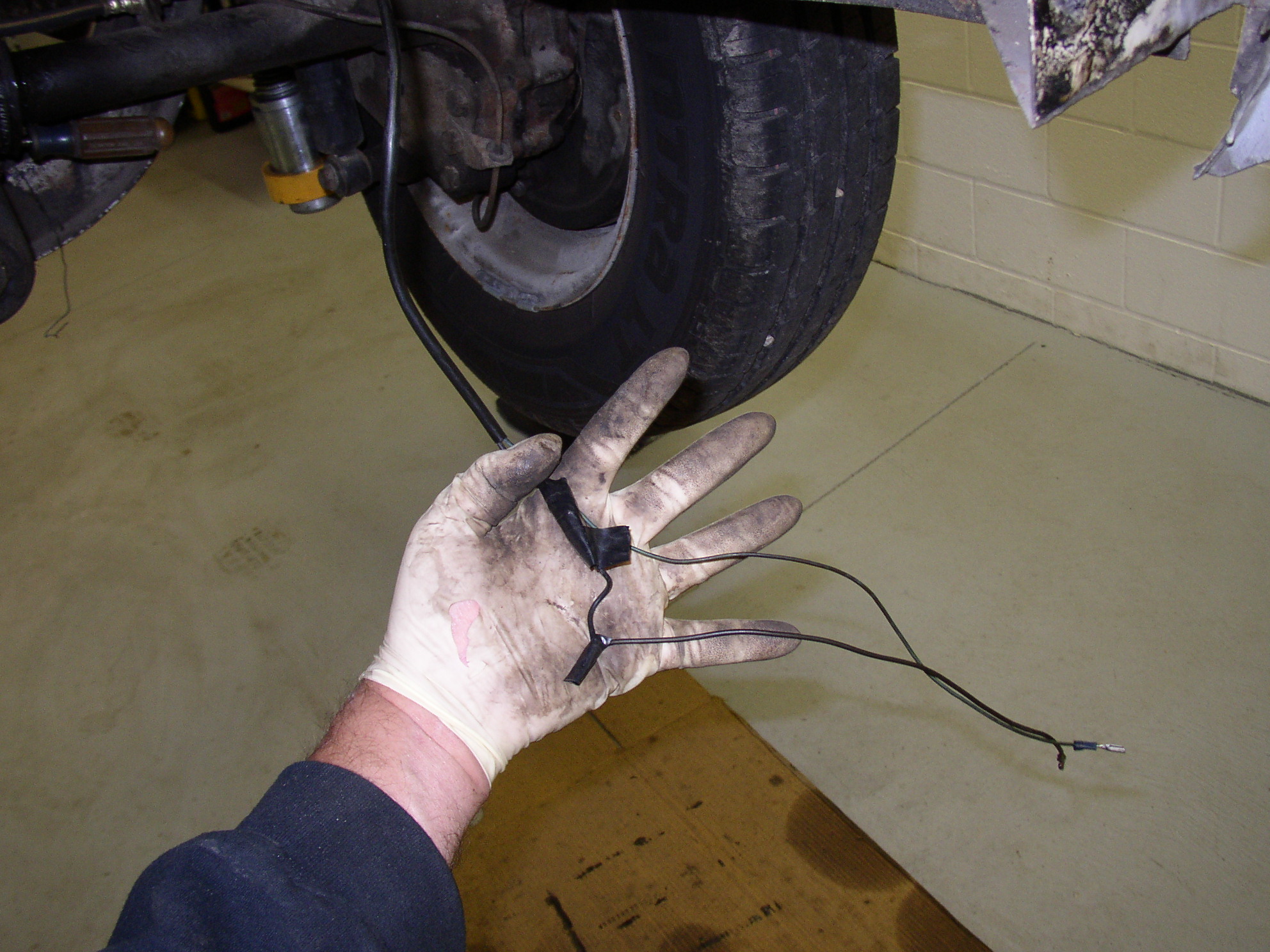

Ken's wiring:
Here's an unfused 10ga wire rubbing on a bracket, ready to short out and start a fire.
Voltage regulator feed wire, yech.
Coil feed, yech.
