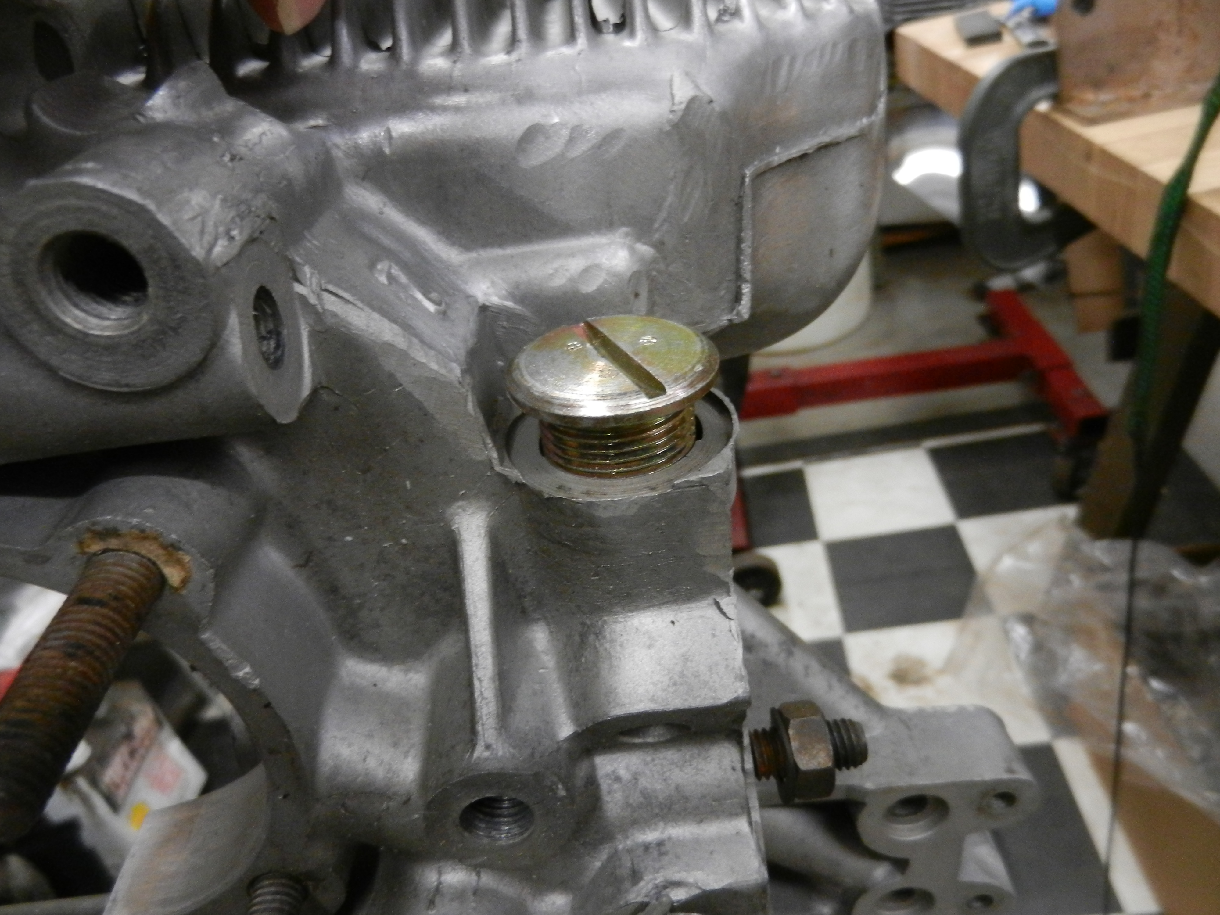

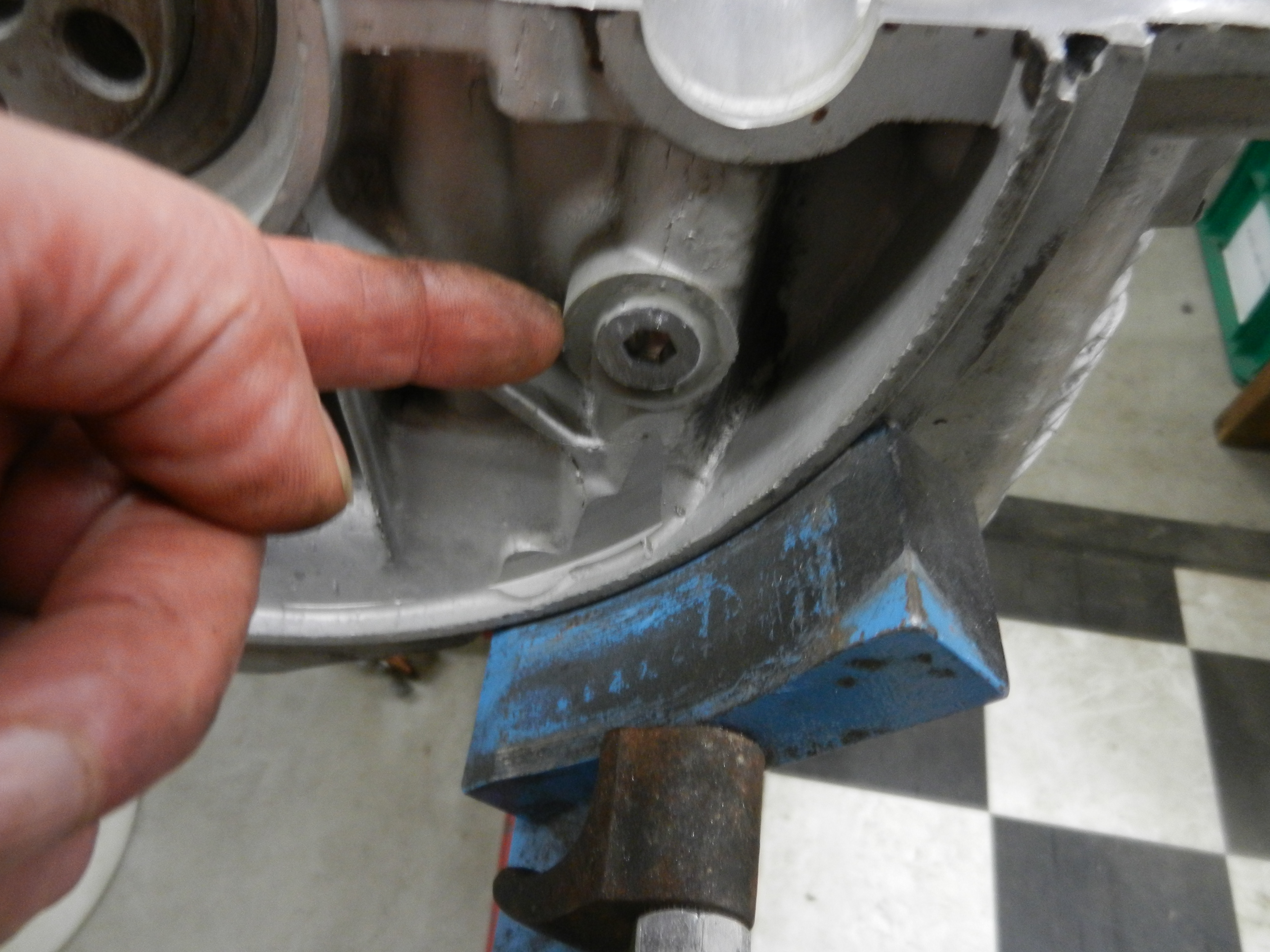

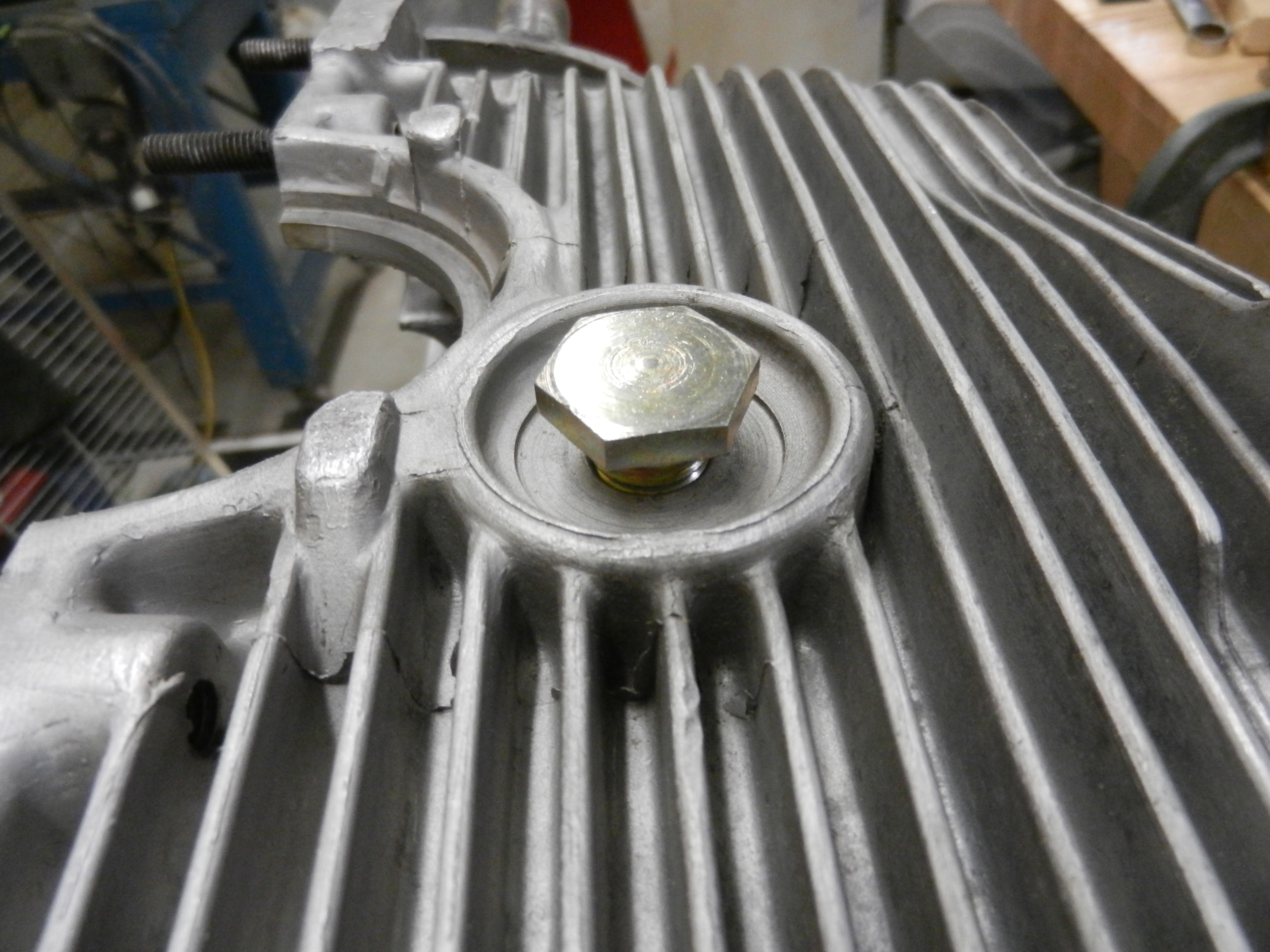

First, I pulled the oil galley plugs(pressed in) and tapped them for threaded plugs. This does 2 things. That they are not going to blow out and puke oil and allows for thourough cleaning of the Main oil galleys. There are 5 of them.
this pic shows them installed. Actually I don't install the plug until I am done with all the case work

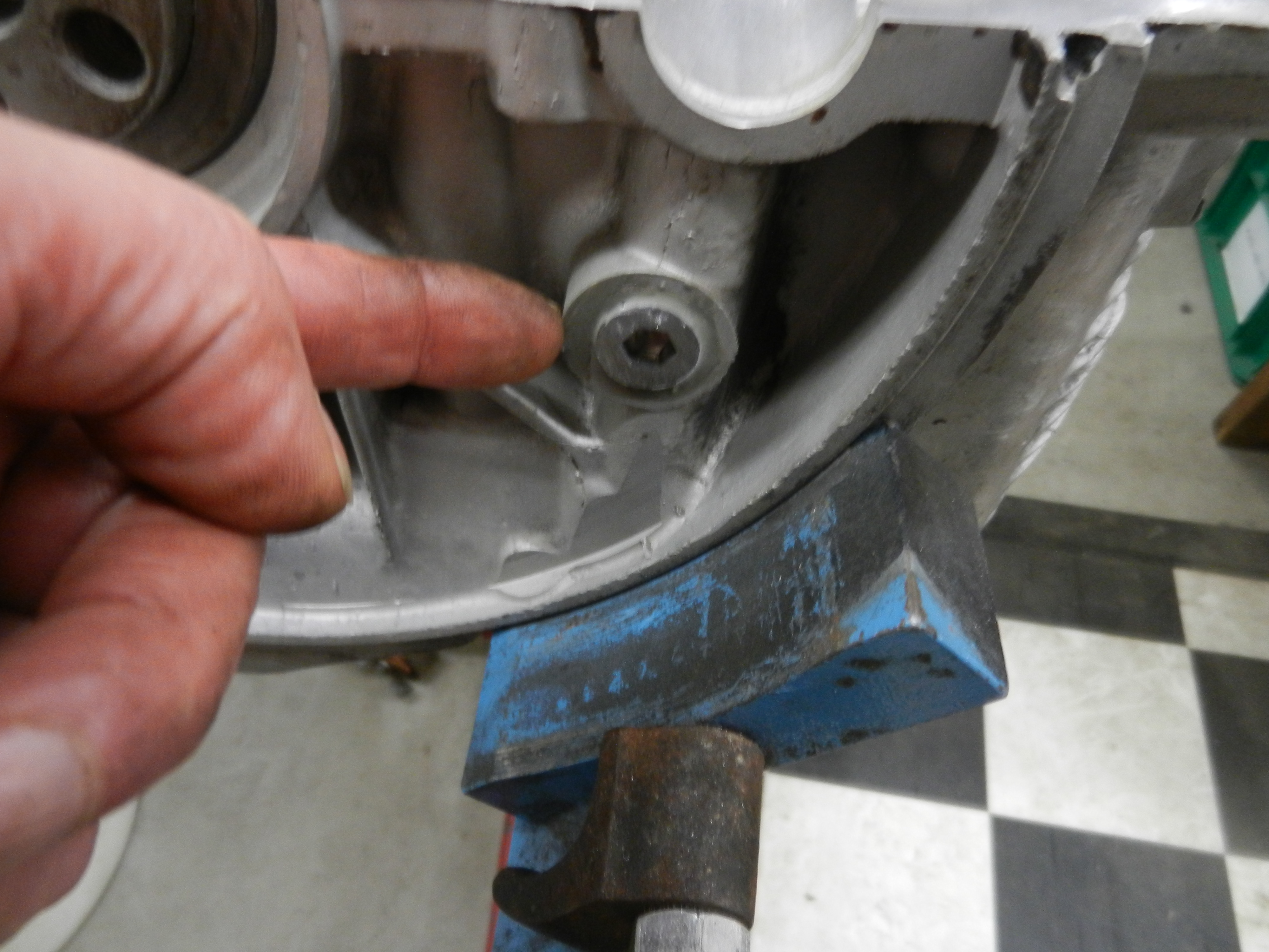

This one after being installed, needs to be ground down a bit( you may find a shallow plug for this)

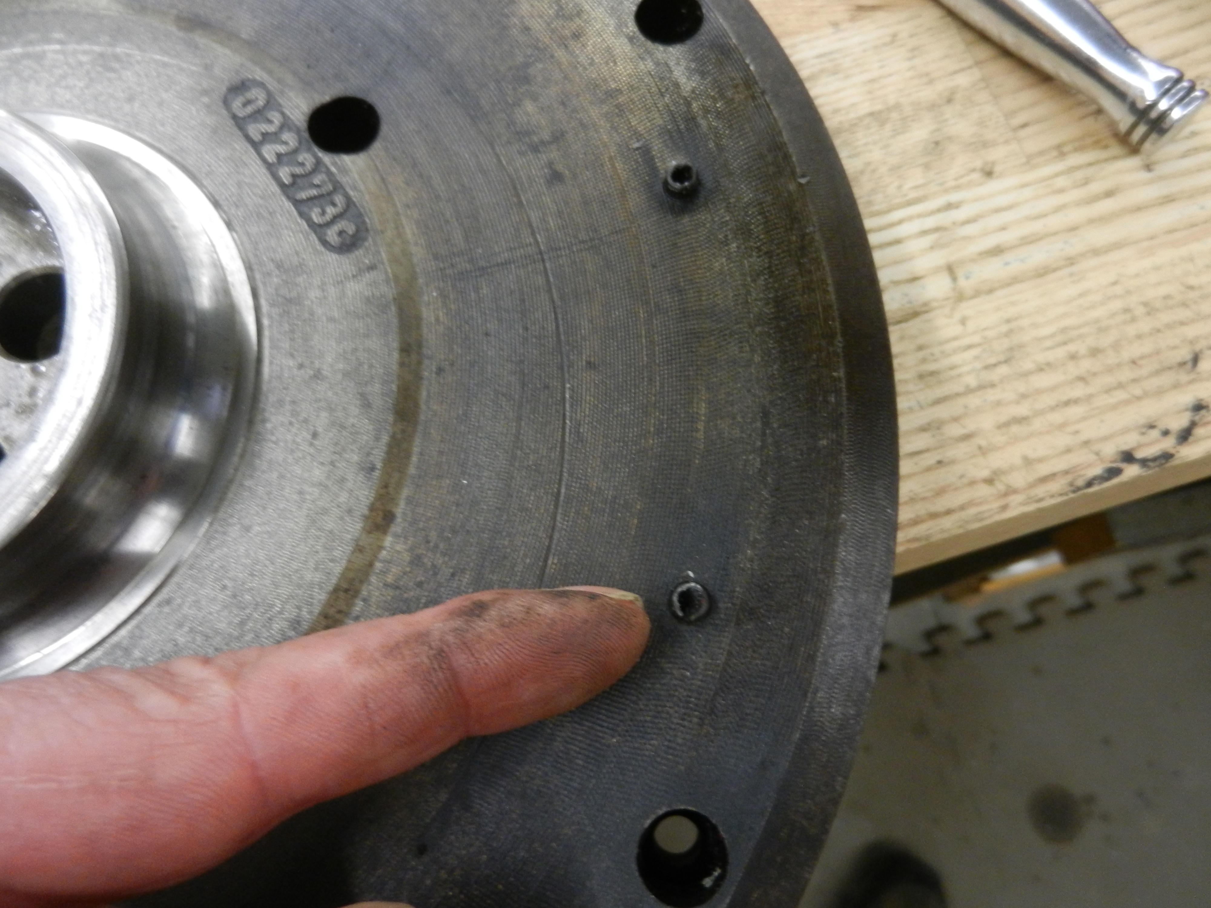

This is why. These dowels on the flywheel will hit the protruding plug and when you try to turn over the engine, you will only get so far before it stops.

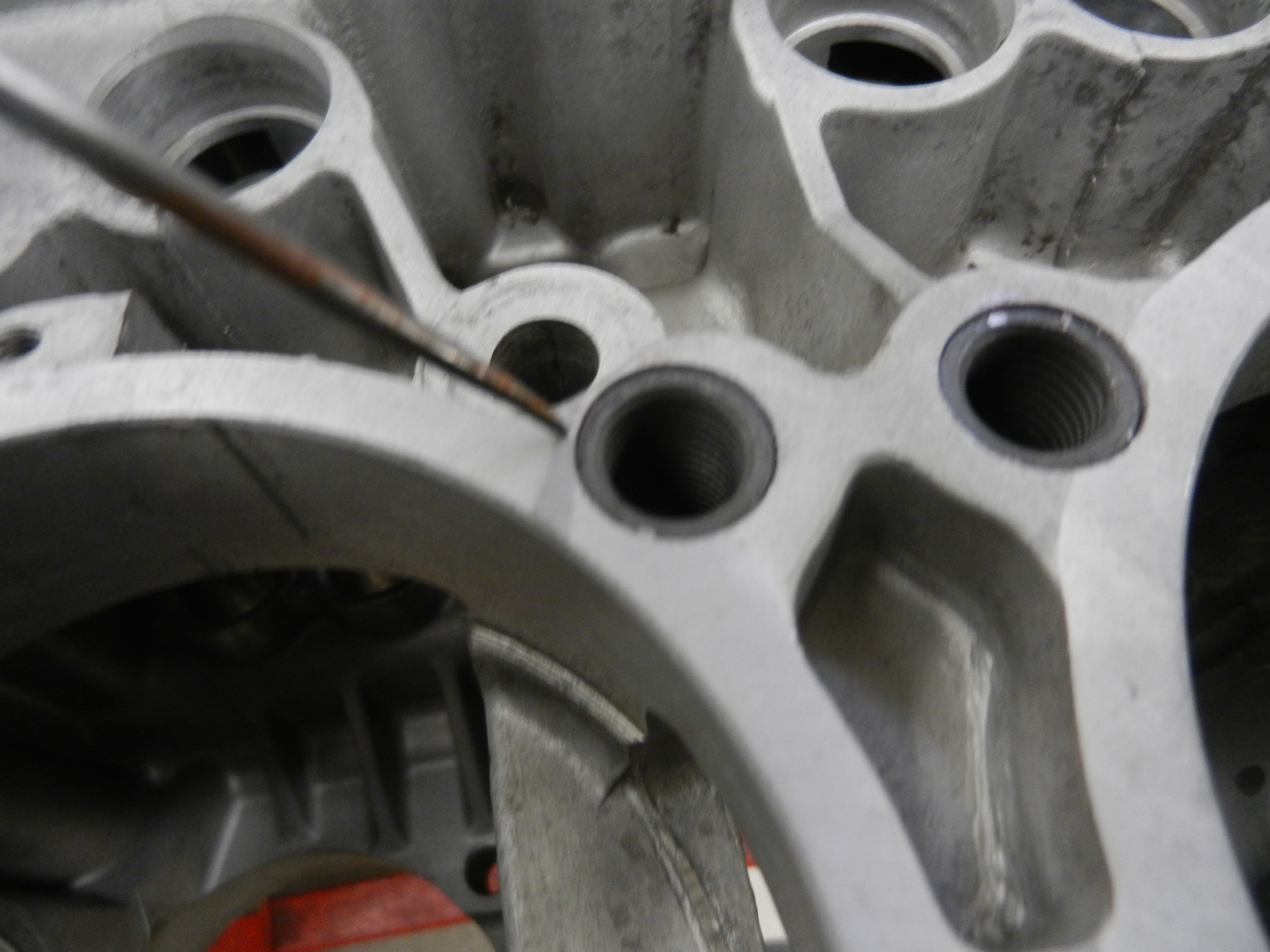

OK. Now we need to check ALL the threads in the case. Important to do this now as it can be a big problem later,ESPECIALLY if it is from a motor that is not just torn down for rebuild. In this case, none of the components are coming from the same motor.

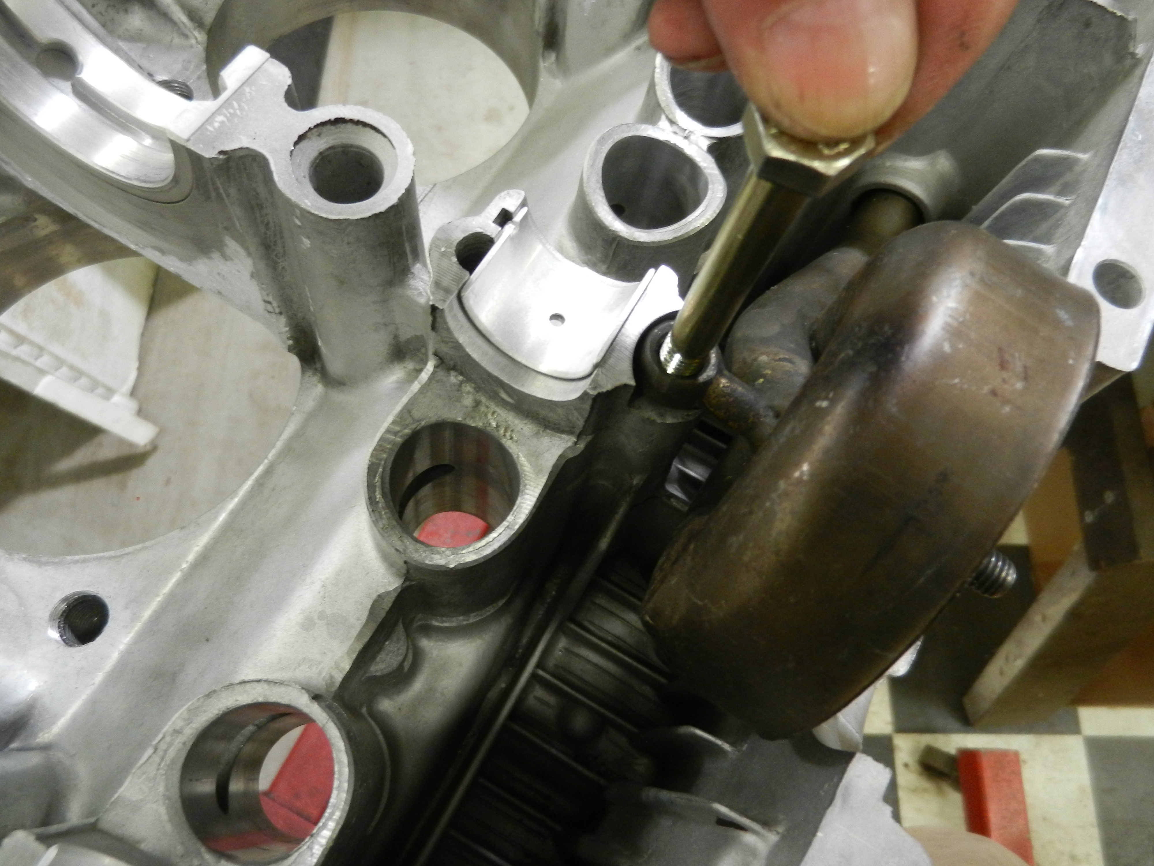

This one is VERY important. It holds the oil pick up in place. It is 71mm long. Too long or to short and you will have problems. Check it carefully. It is sometimes bent, do to someone over tightening the strainer sump cover,which only torques to 9ft lbs. If is bent, get another one and check the threads in the case as they may be damaged.
on assembly it goes thru the left case half here. Which is easy to miss on teardown,as it is usually buried in crud.
Now here's where I ran into a big problem. When I tried to check the cylinder studs, I found that several had f'd up threads in the alum case. Bummer. I sent the case to Jorge at European motorworks and he installed threaded inserts in all the cyl. stud holes. Nicely done. recessed.

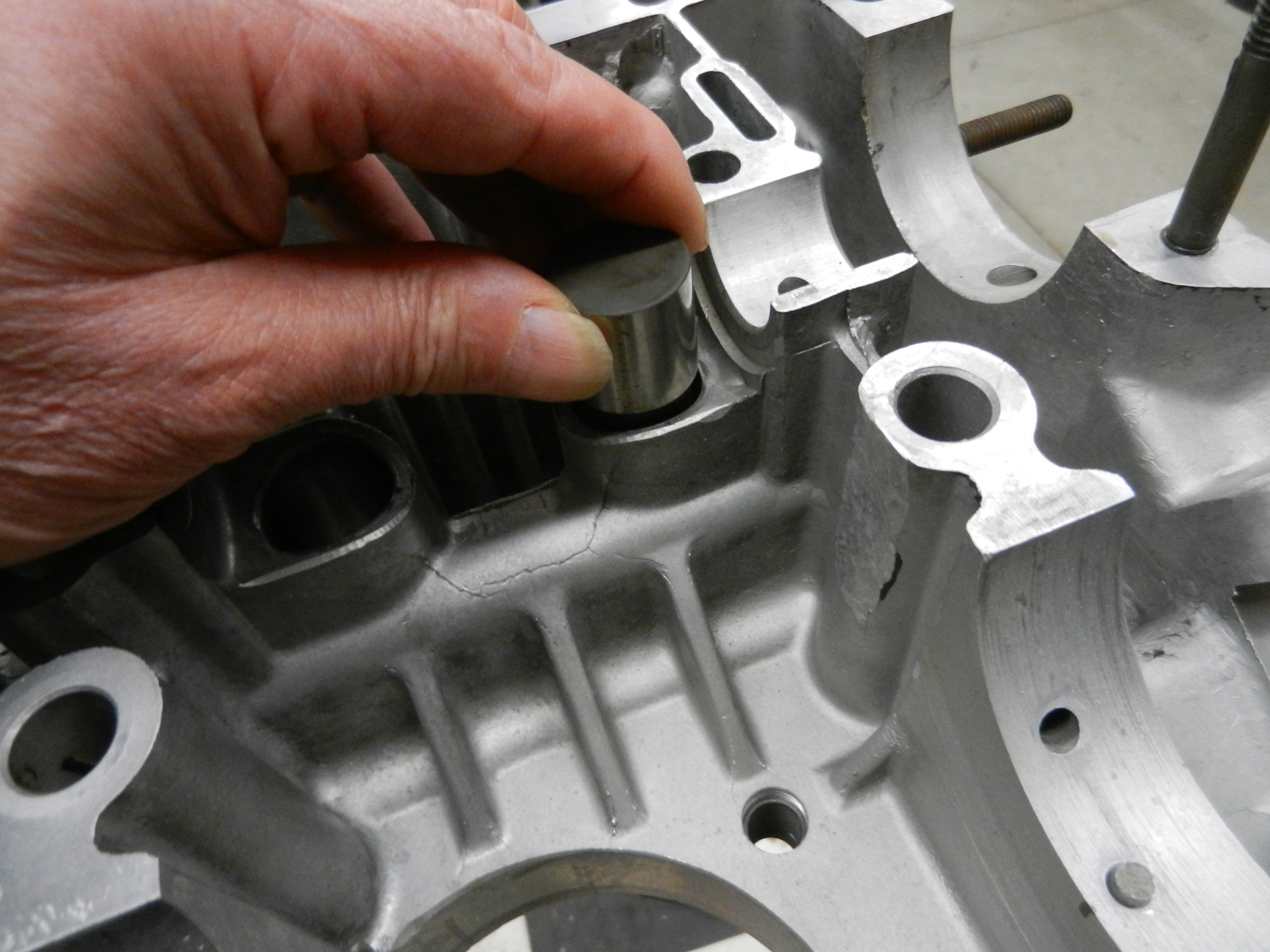

Also polished the lifters. They should slide thru the bore without hang up,( bore diam was checked prior)

I'm assuming that the "cracks" in the casting between the lifter openings are superficial and not really anything...
Re: Bill's T4 engine build
Posted: Thu Dec 12, 2019 5:14 pm
by wwebner
Joe, yes superficial casting marks. Identical to other cases I have.

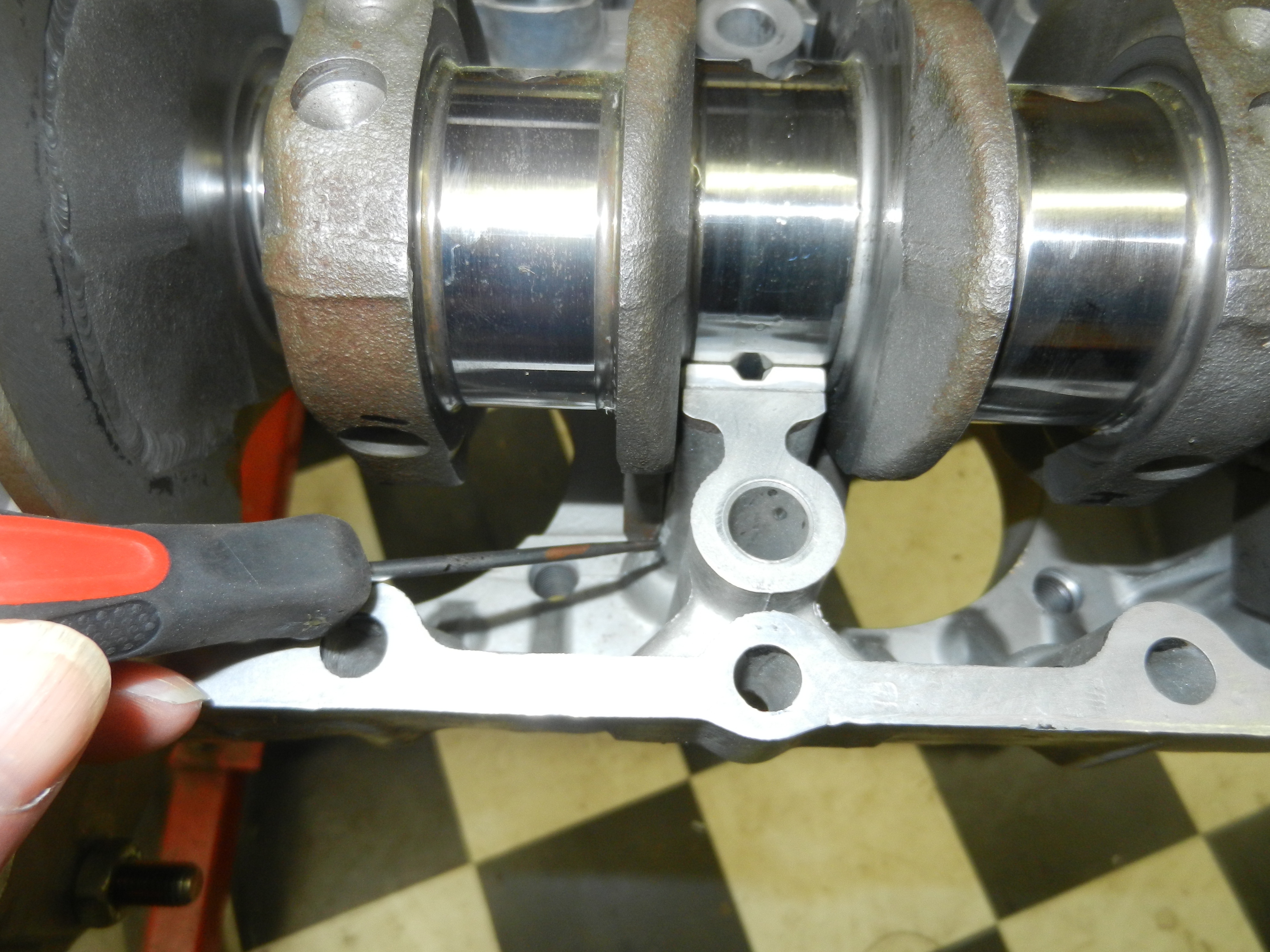

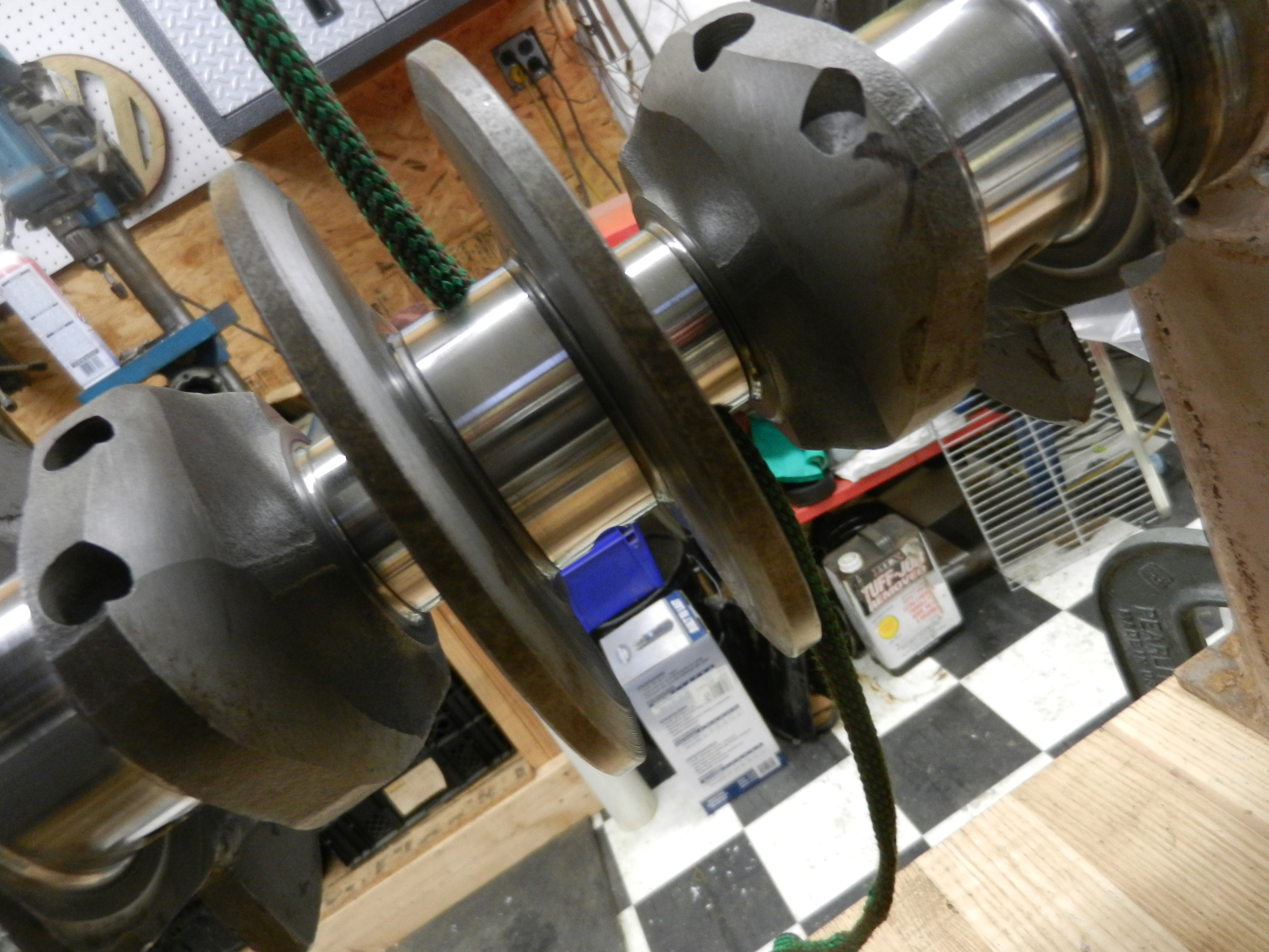

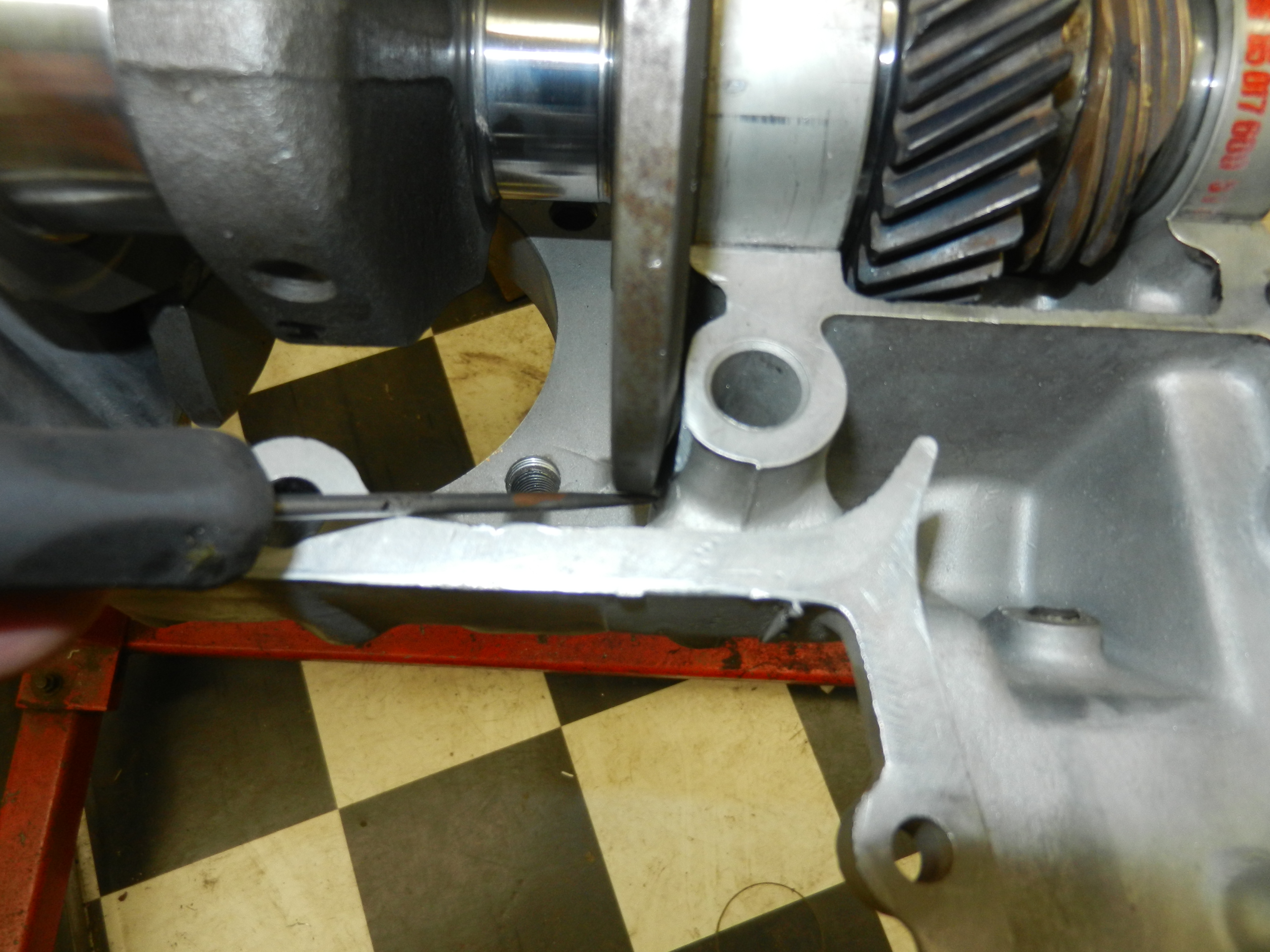

Now, a little more case work for today. since it involves the crank shaft I will jump ahead a bit.
Current motor has a counter weighted crank, as will this one. It's the ONLY crank that I would use on any air cooled VW.
The crank on the right is a stock crank. Notis the 2 center rod journals are on the same side. This creates an imbalance.
The counter weights are welded on a stock crank to offset this imbalance.The crank is then balanced. The result is a crank that rotates perfectly with no "whip" do to imbalance. Which results in an extremely smooth running engine capable of much higher RPM without beating the center main bearings and journals.
Do to this added material, it is sometimes needed to :clearance some areas of the case.
I use a couple of used bearing for this since it may require taking the crank out and back in a few times.
It's also a good idea to install the flywheel with a couple of the flywheel shims for this process.
Here you can see where some material needs to be removed from the case.
after a little grinding. You do need todo this check with the crank in both case halves.
most of the work was done on this journal.

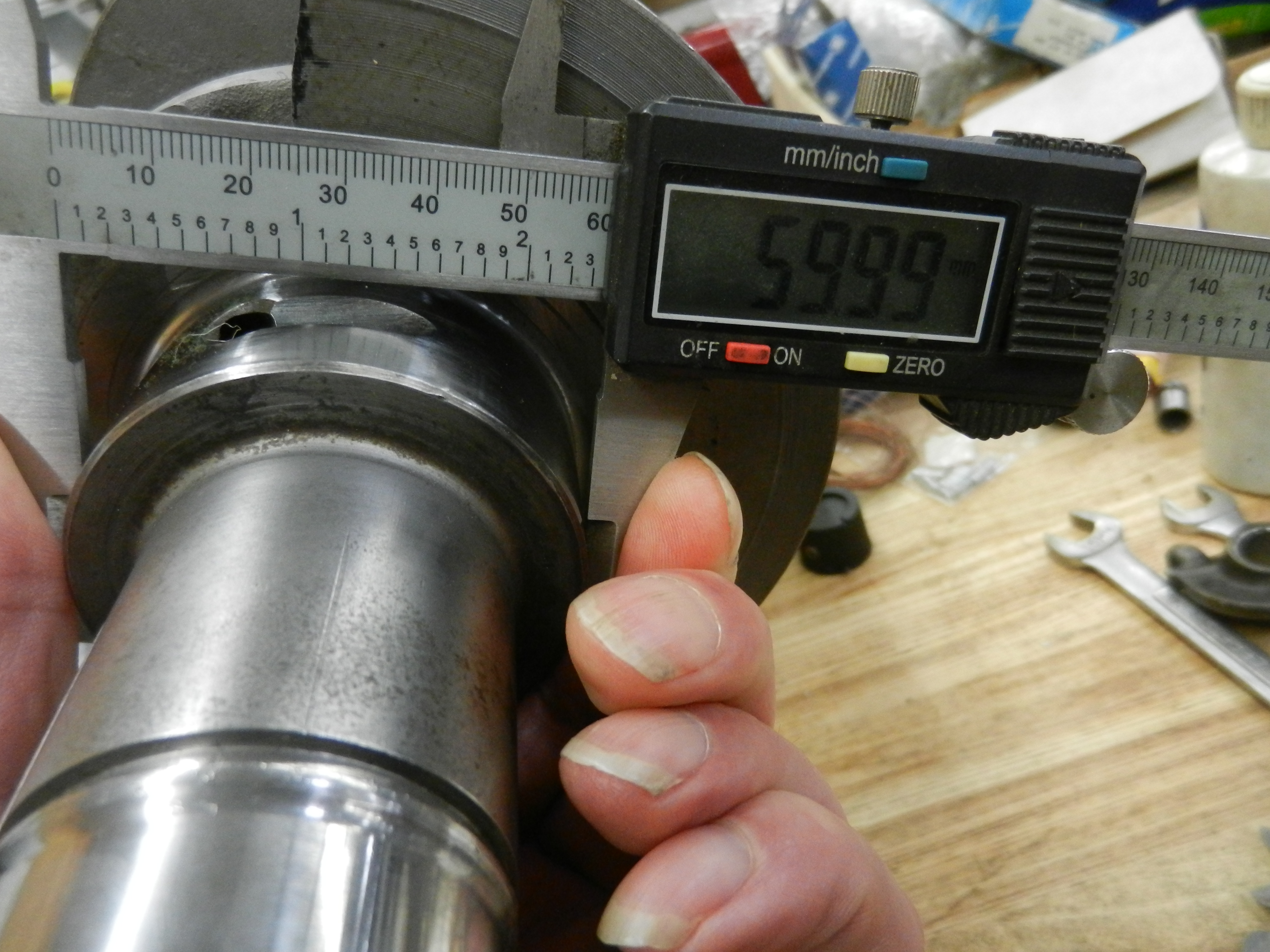

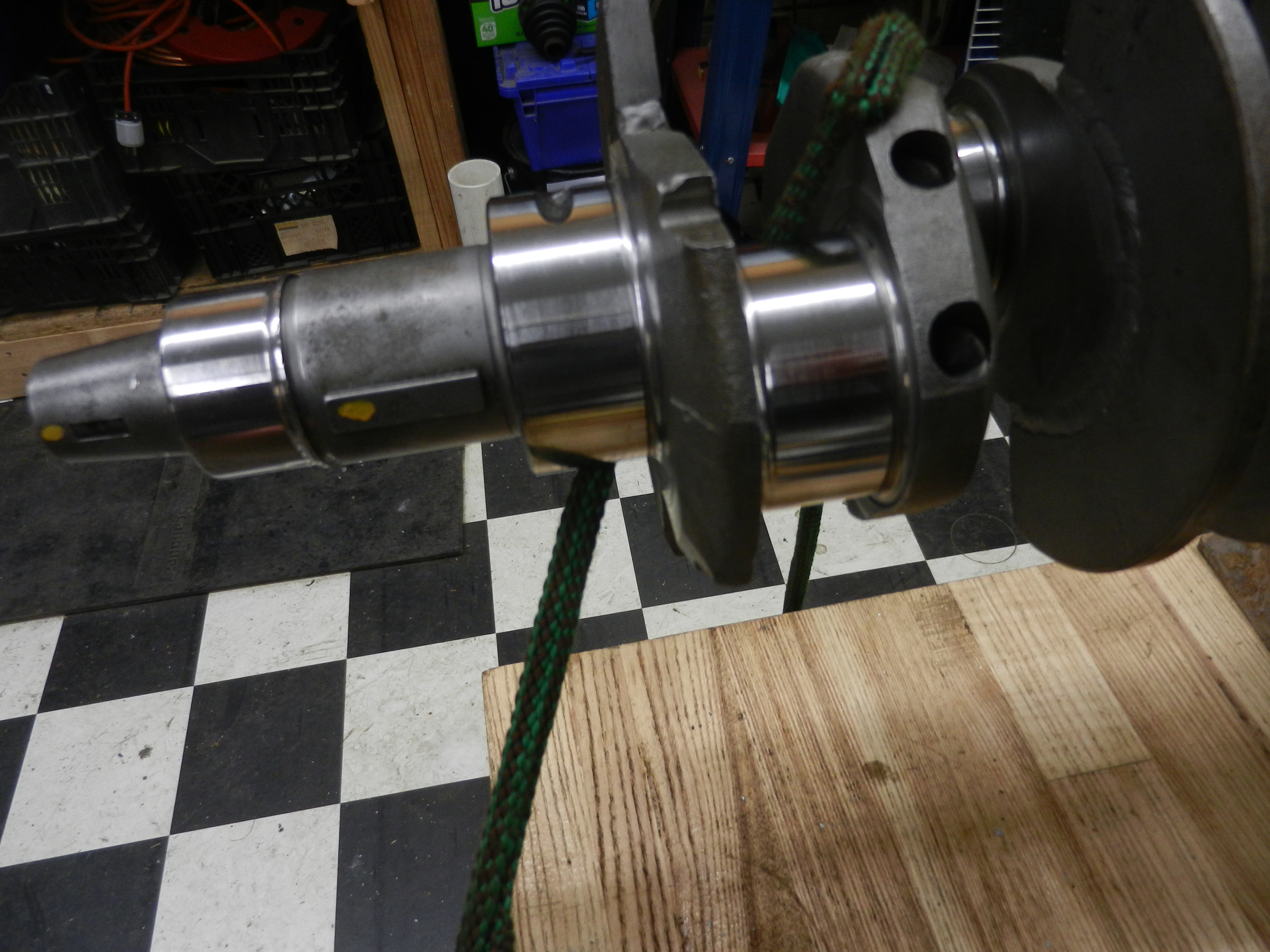

We are going to set the case aside and move to the crank shaft.
Check it AGAIN. 1,2 and 3 spec is 5.97-5.99 they were all spot on. No pic for #4, but it was also spot on.

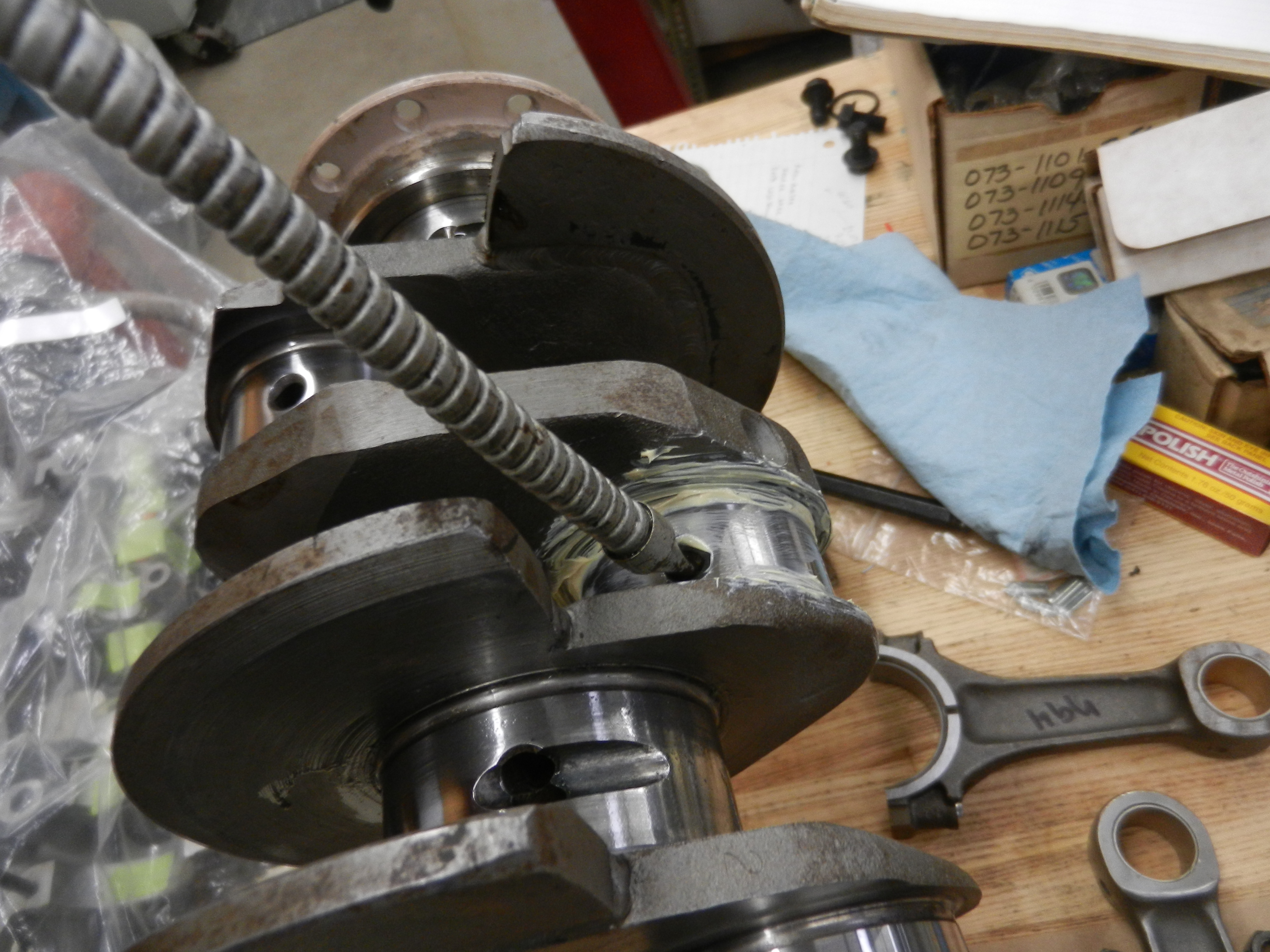

Now clean the oil passages. A gun cleaning bore snake works well for this.

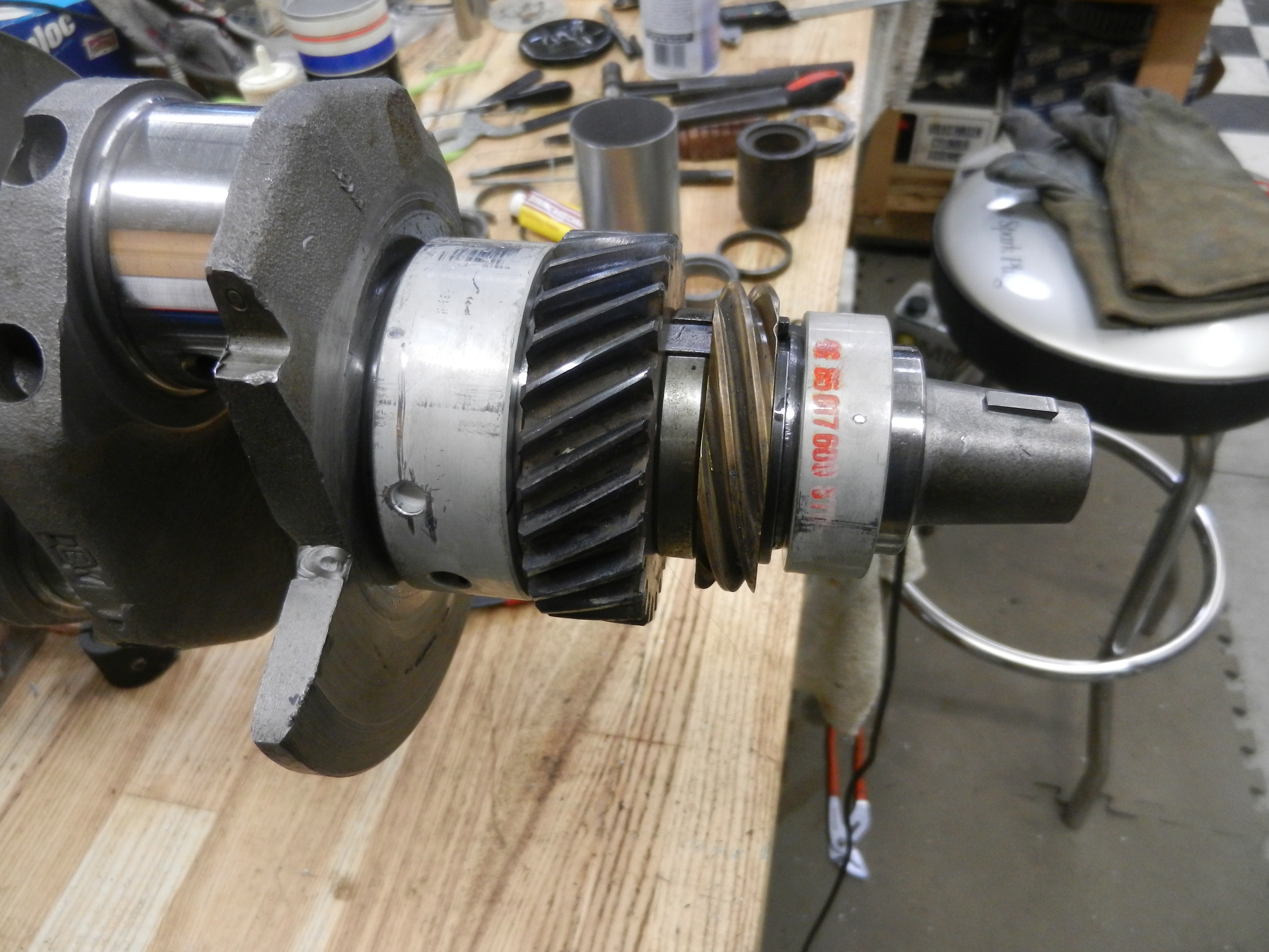

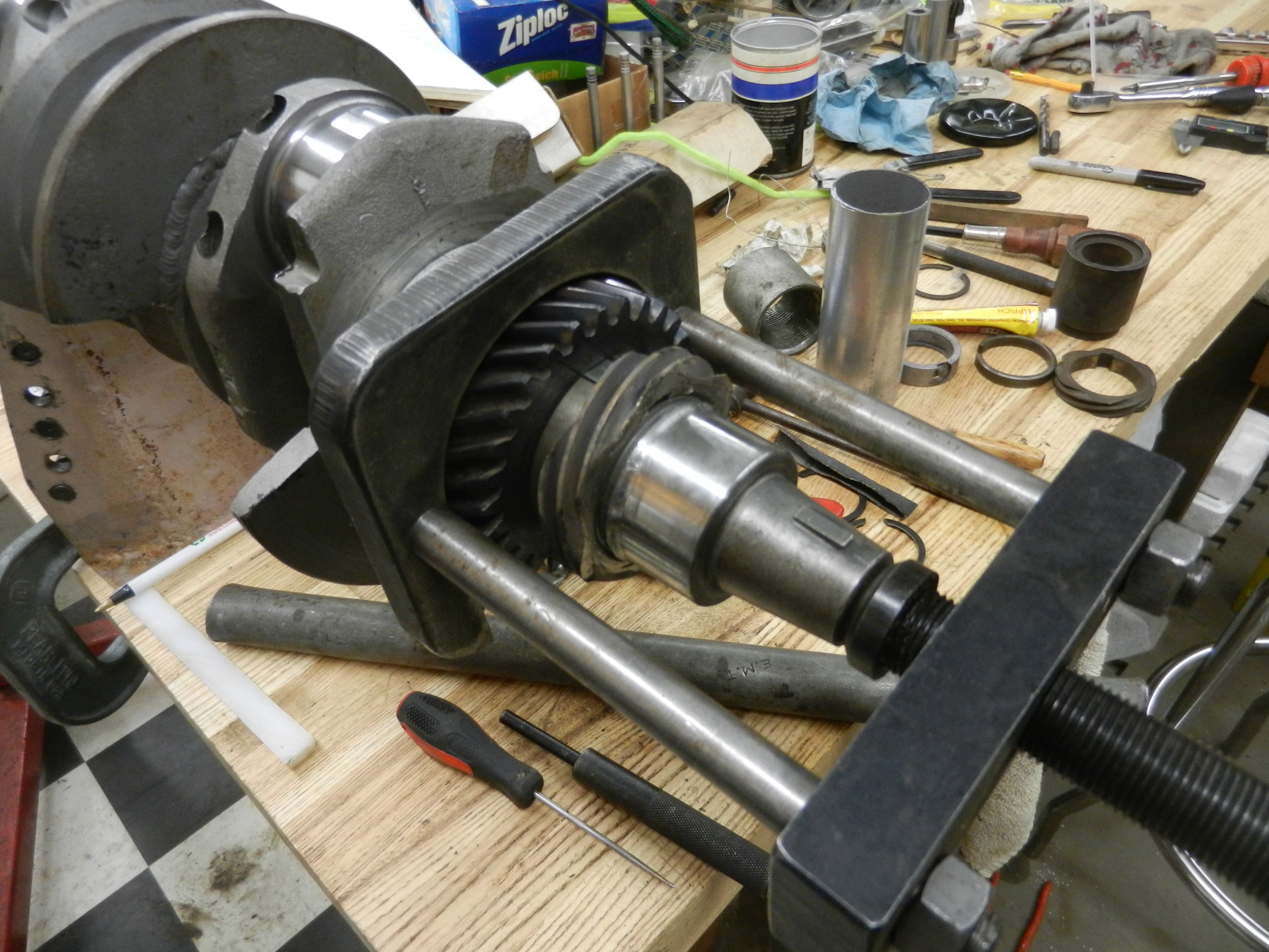

Now to install the crank gears and # 3 bearing. Bruce documented this well and the procedure for type 1 and type 4 are the same. BUT, I had a little problem.
After wiping the journal and bearing with brake cleaner and wiping the journal with assembly lube,
I pump a little oil into the journal. This pic shows another journal (no pic of #3)

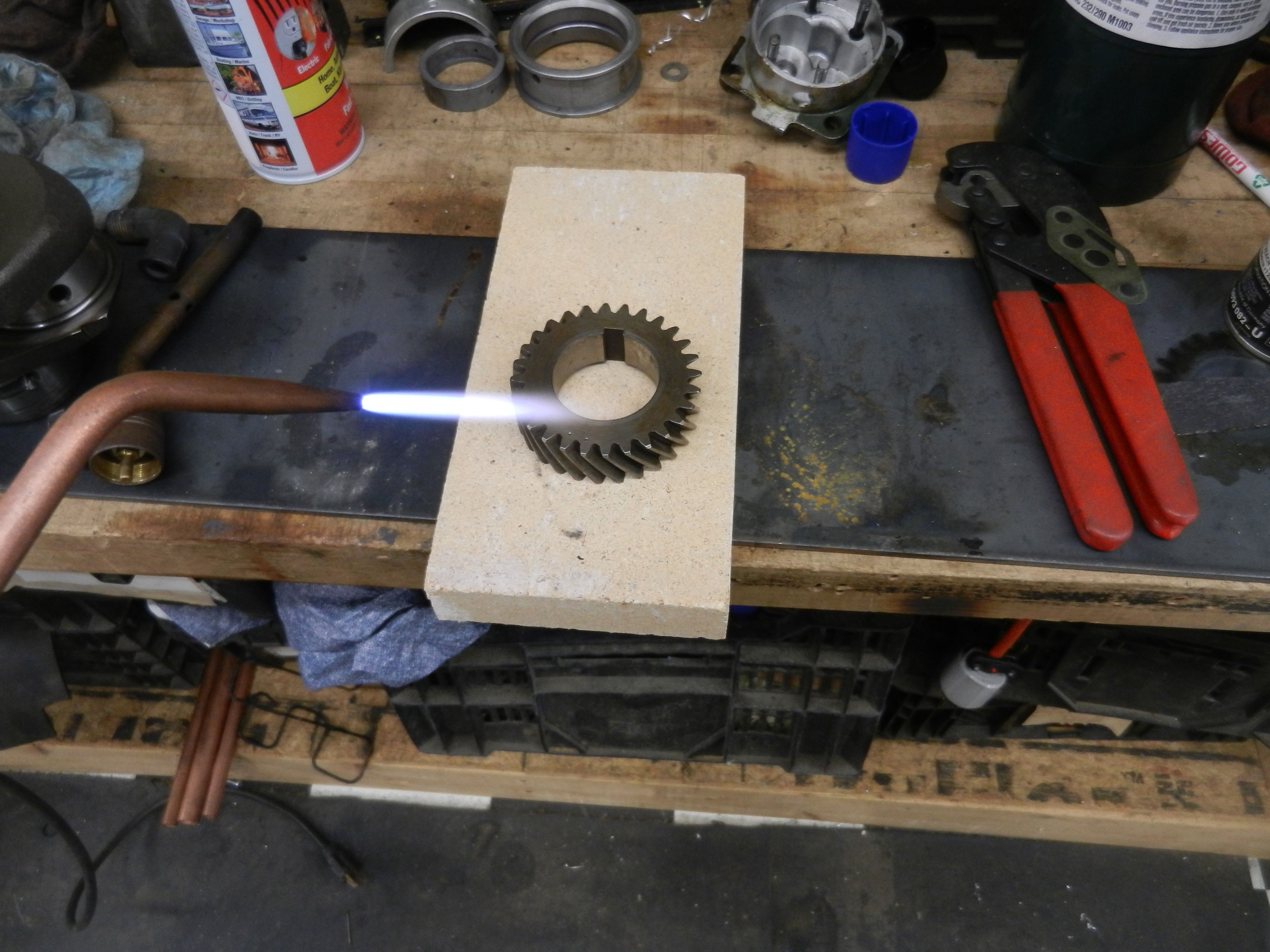

I heat the gears on a piece of fire brick with a torch.
Be sure you orient the gear so the timing marks face the nose of the crank.
Install the spacer and heat and install the dist drive gear.

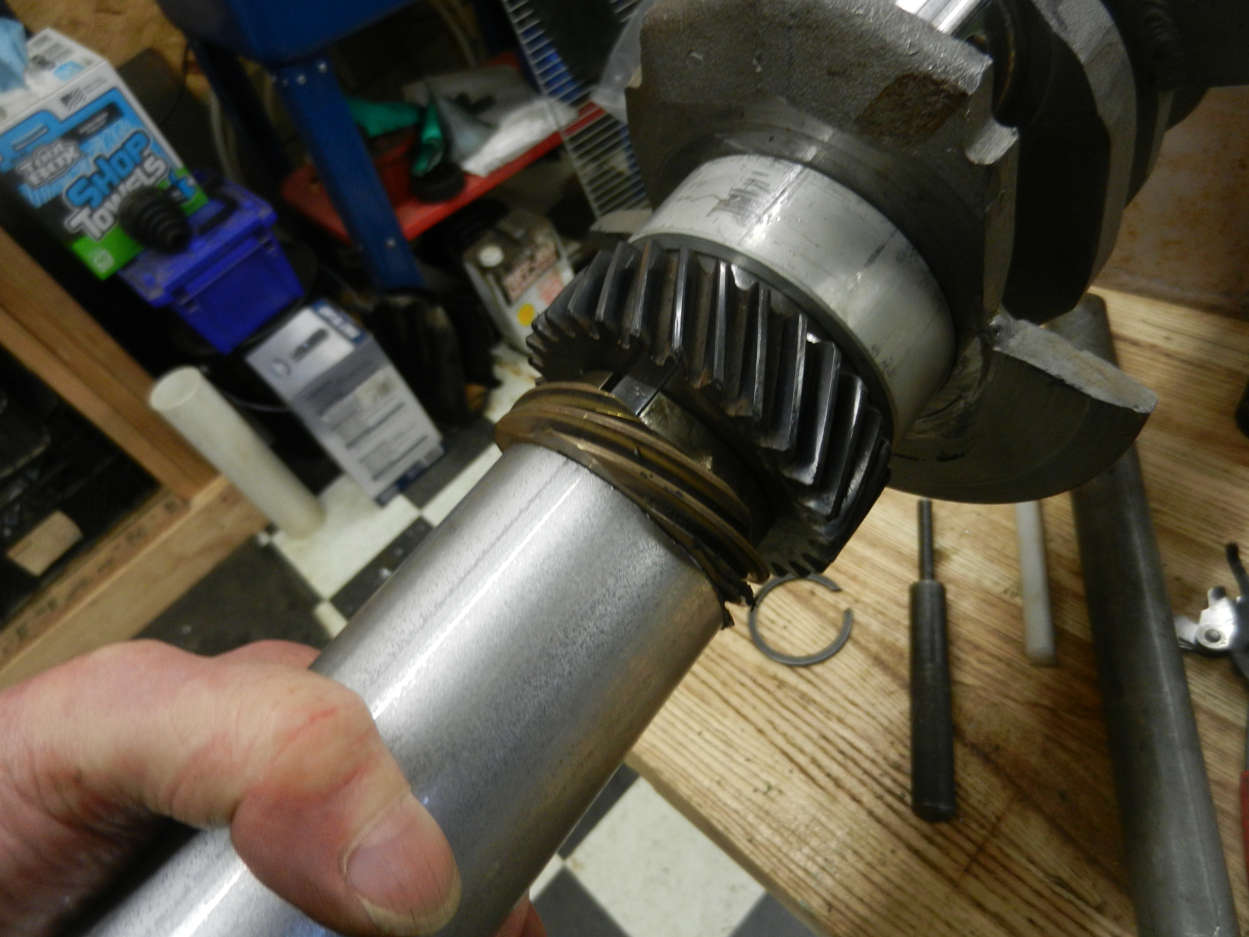

Then, install the snap ring in the groove in the crank. This is where i had a small problem. The snap ring would not seat in the groove.
Shit. Maybe I did not have the gears seated. Pull them off and try again.
Re installed and had the same issue. Pull them off again.
I had used a NEW brass dist drive gear. Let's check it out.
POS
Grab a used dist drive gear and guess what.

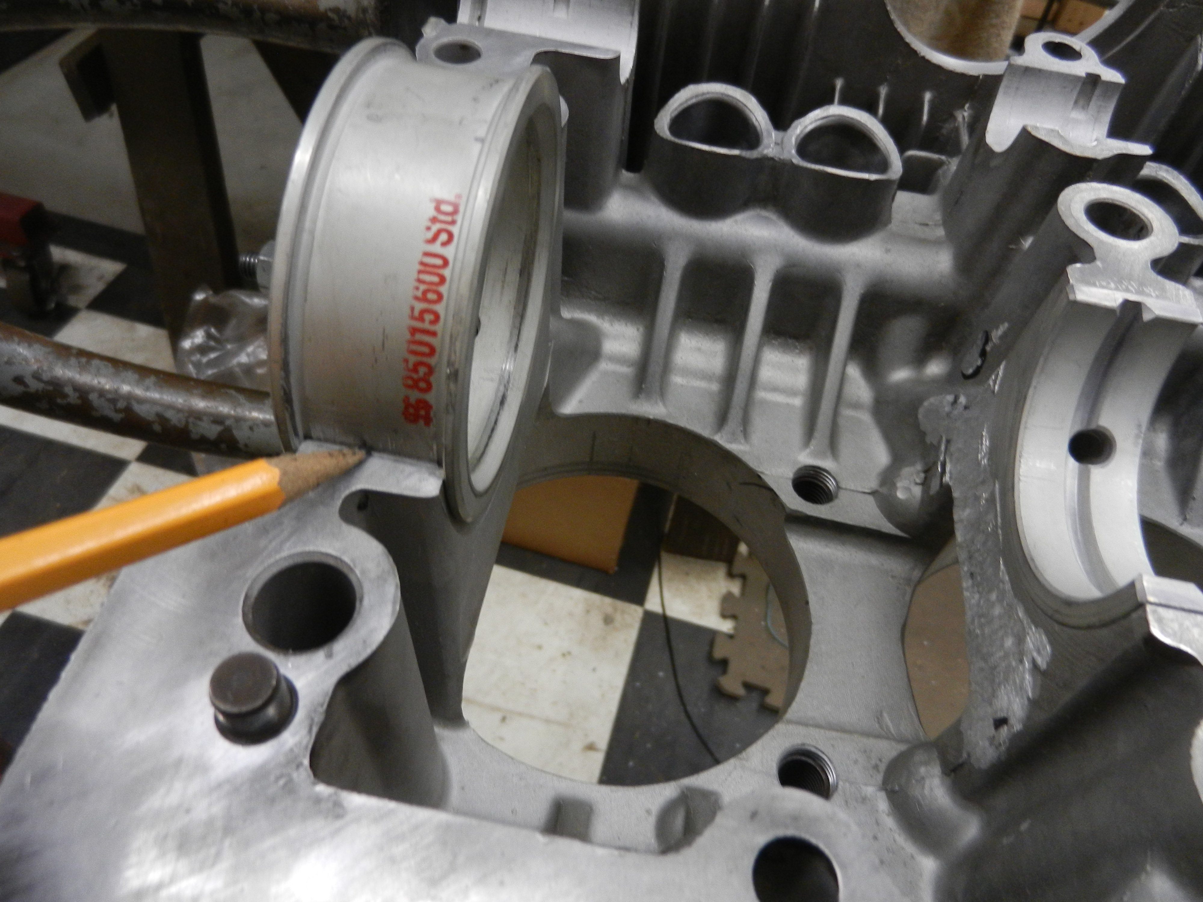

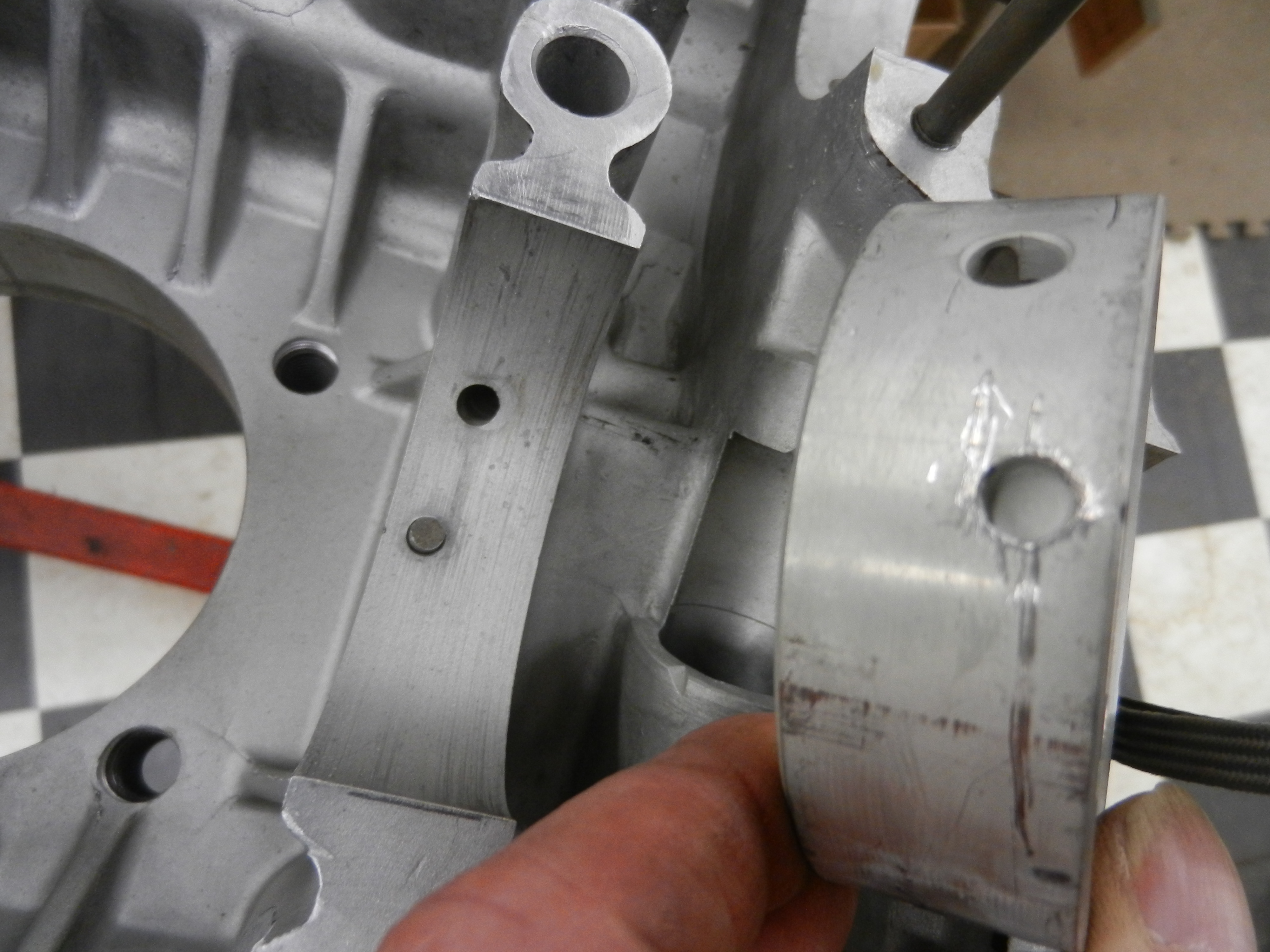

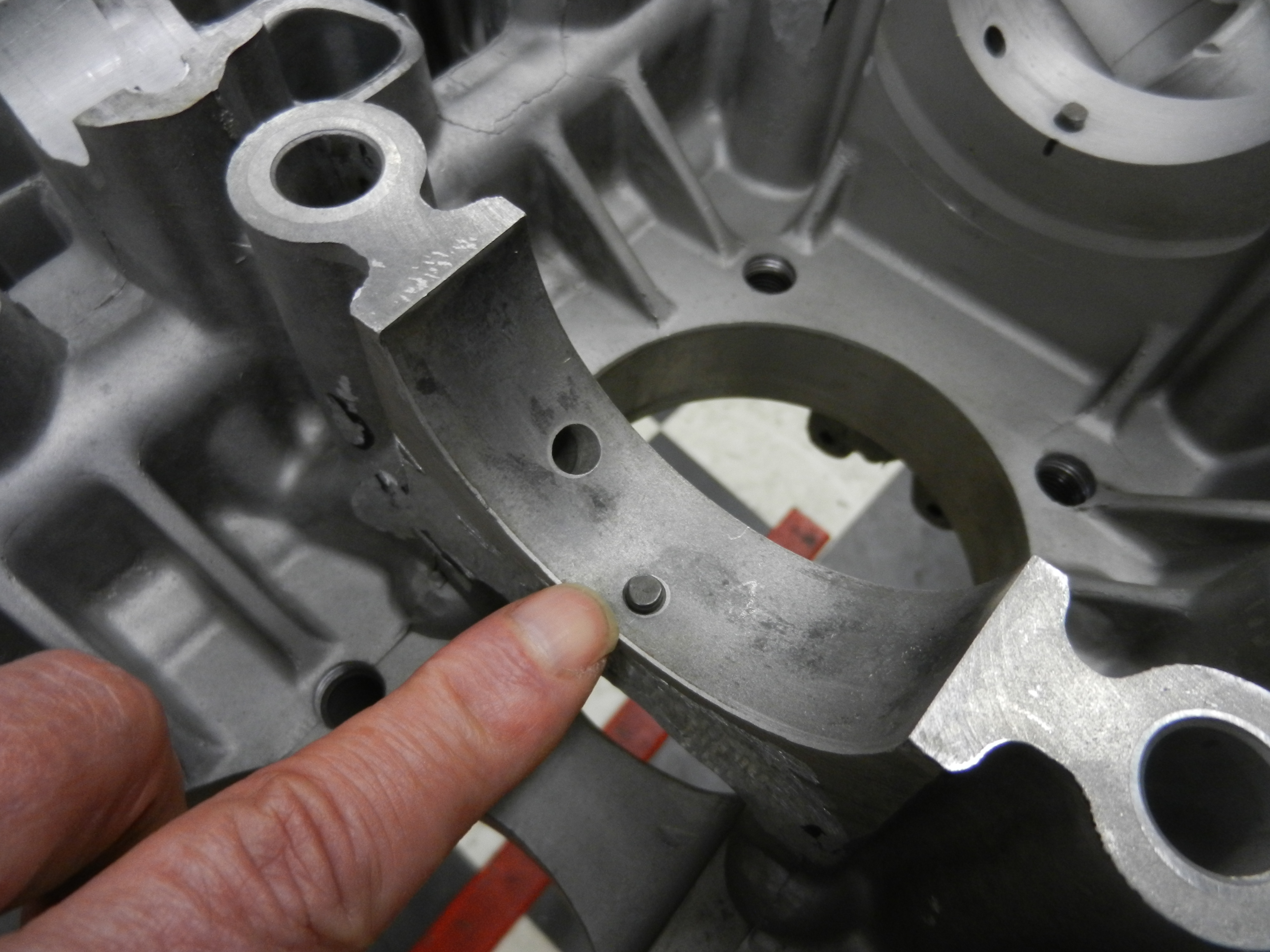

Before we move on. I am going to back up a bit. Before installing # 3 main bearing, you need to orient the bearing, so the dowel holes are aligned.
Note, the dowel holes are offset.
They are all offset towards the flywheel end.
Also, set the bearings in the case, making sure they seat nicely and mark the parting line. Also a good idea to put a magic marker mark on the.flywheel side of the bearing. #1 shown, but the same was done to #'s 3and 4

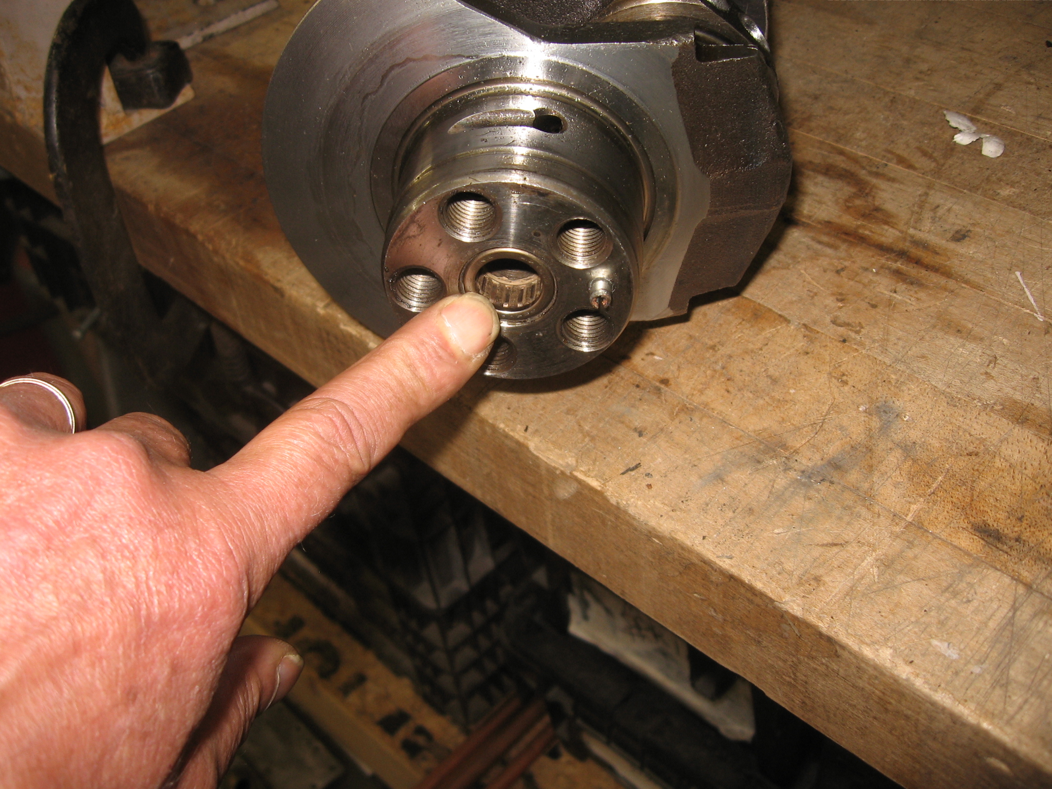

The pilot bearing in the type 4 is in the end of the crank. It is in the gland nut on Type one, and in the flywheel on 914.
ALWAYS REPLACE . When this bearing fails, it grabs the trans mainshaft like a Chinese finger and you are stuck in whatever gear you are in. Then, it's pull the motor, which is not easy,as the crank and mainshaft are locked together.
Pull the old one out
Pack the new one with grease, I use Spectro synthetic
Install the new bearing.

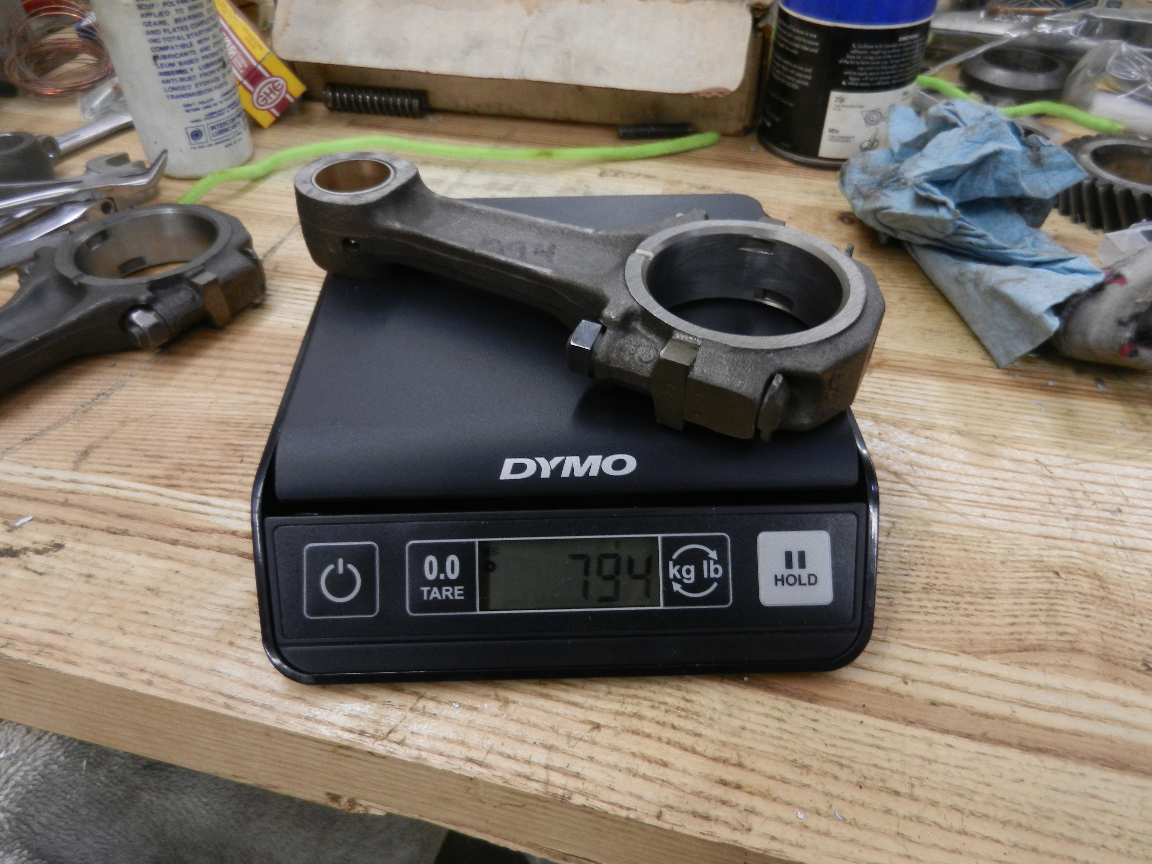

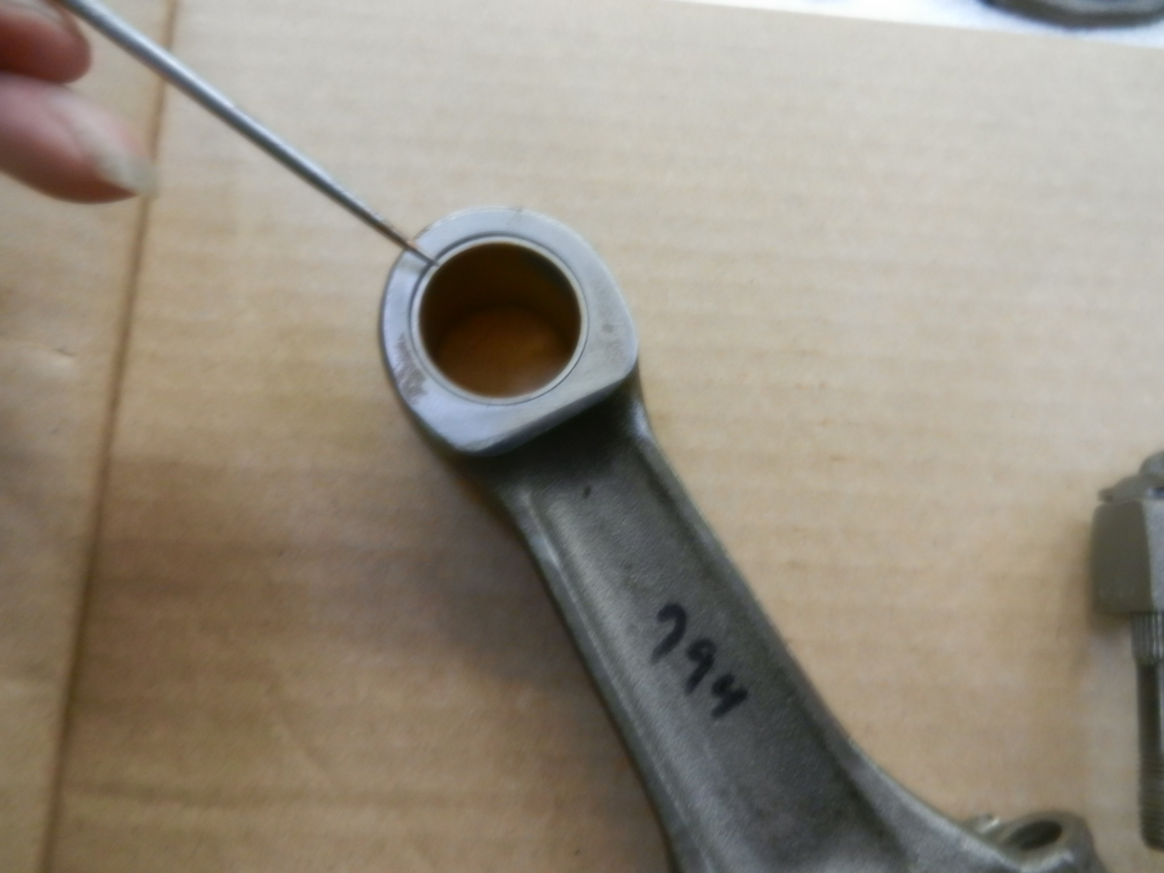

sometime,way back around 2000, I took a set of stock 2 liter rods to the machine shop to have them re-bushed sized and balanced, total weight and end to end.
To re-bush them, install new bushings in the small end. For this process, they press out the old bushings and press in new bushings which have a smaller inside diameter, then hone them out to spec, using one of your wrist pins for measurements.
To "size" the big end, they remove a few thousandths from the mating surface, in this case the rod ,as opposed to the cap.
The big end is now oval. Then they hone the big end perfectly round and size to spec.
I also had them machine this groove,per a VW tech bulletin that I had. According to VW, this increases "oil splash" to the bottom of the piston.
Now let's check the weight.
They got them pretty nuts on within 1 gram 794 -grams. VW specs a 6ram difference between rods new .
Short break . I am being beckoned for supper ;)
This pic shows where they machine off material on the small end to balance end to end with the other rods.
(the difference in weight is this one has the rod bearing install, which is 37grams.)
