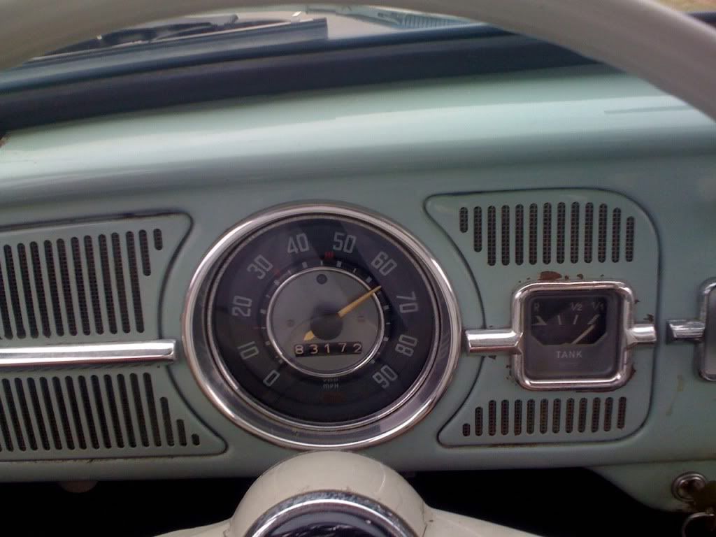

In the meantime, I took the beetle to Sandusky this week and with 139 miles on 4.8 gallons I got a whopping 28.9mpg. Yes, mostly on the highway, but with about 20 of those miles in stop and go city traffic. I'm very pleased.
The heads from RIS Richard Sedoris are 'spot on'. Sedoris obviously knows his stuff. He's Aaron's guy, so obviously he knows what he's doing. I'll be back out to see him again with some of my other stuff. Very happy with his work.
Time to close out this thread, but as it goes out, here's a couple pics of me cruising the beetle in the "right" lane.
