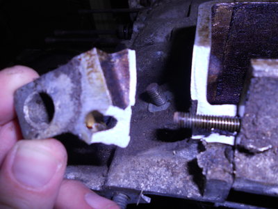

I got inspired to continue the rebuild on my 1976 2 liter. I took out all the bolts so I could split the case. However, I didn't follow Chuck's advice, which was to remove ALL the bolts and then take 2 more out!
So.... I tried to split the case and ended up breaking off the tab at the oil breather. :roll:
Here are some pics
I'm pretty sure I have all the hardware removed now, but would really appreciate finishing splitting the case with someone who has case-splitting experience.

I've never done a T4, but split several T1s without a "splitter tool". I use a block of wood in the oil pump hole to bump the halves apart. It is somewhat important to have all of the bolts out. :lol:

westy66 wrote:time for some JB Weld
Will someone let the Administrator know that Howie is logging in under other people's accounts!!!
Dual Port wrote:Where are you in Grafton?
We are right off Rt. 83 on Law Rd.
Aaron, I think I will go with TIG over JB! :lol: I also think I should get an engine stand rather than try to do this on the bench.

The 2 bolts that are easy to miss are the 1 behind the flywheel and the one on the 3/4 side that holds the oil pick up tube in there.

There are 20 of them on the type 4 motor.2 of them are easy to miss.! on the bottom inbetween the lifter bores,ussually covered with grease and oil. It is a long bolt and may be bent if the oil strainer cover was over tightened.This bolt goes through the oil pickup and holds it in place. The other easy one to miss is behind the flywheel above the cam plug.Also ussually covered with grease and oil
