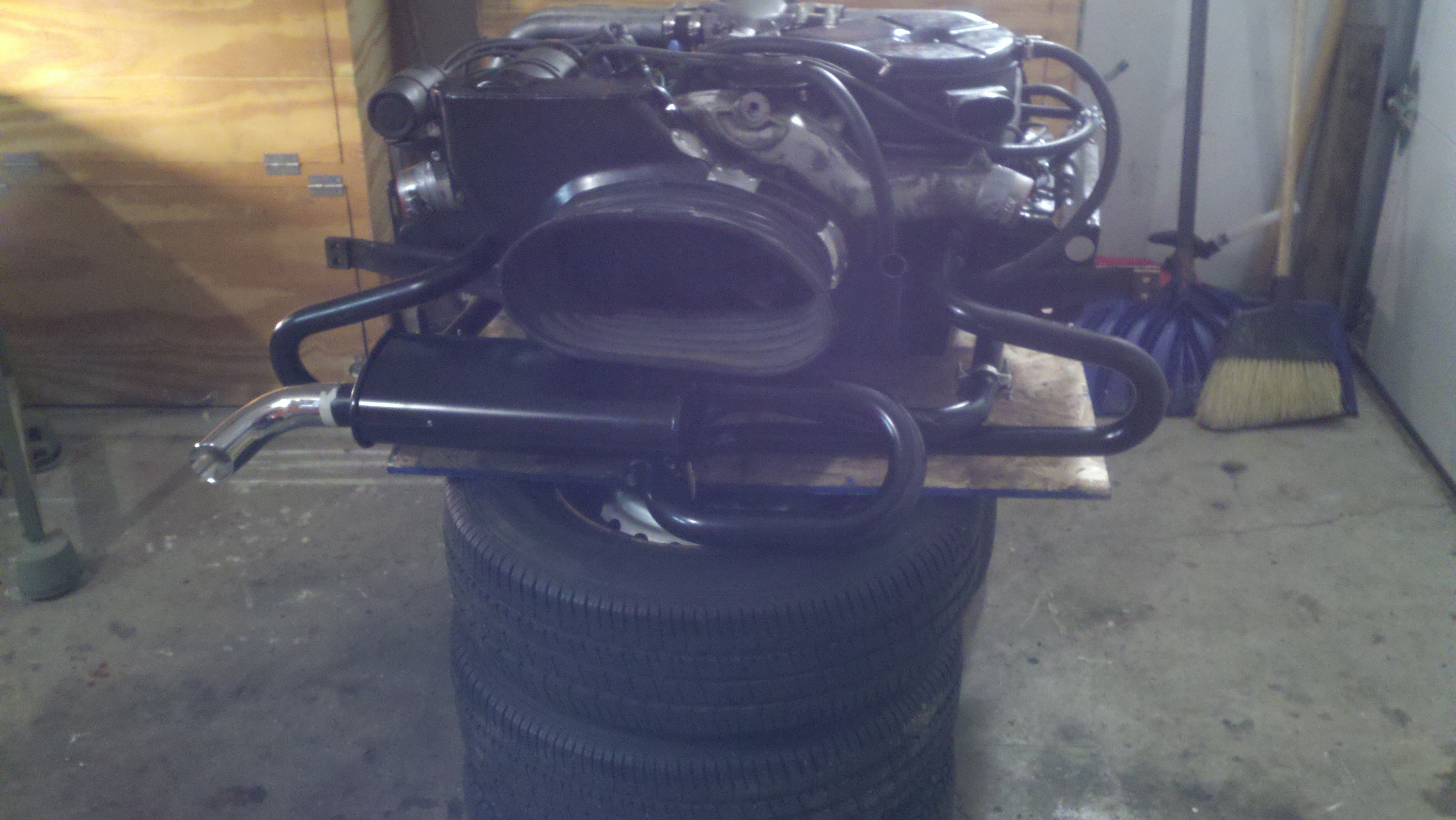

Post by framingsilly »
New exhaust :D. No more smelly ride. :D
