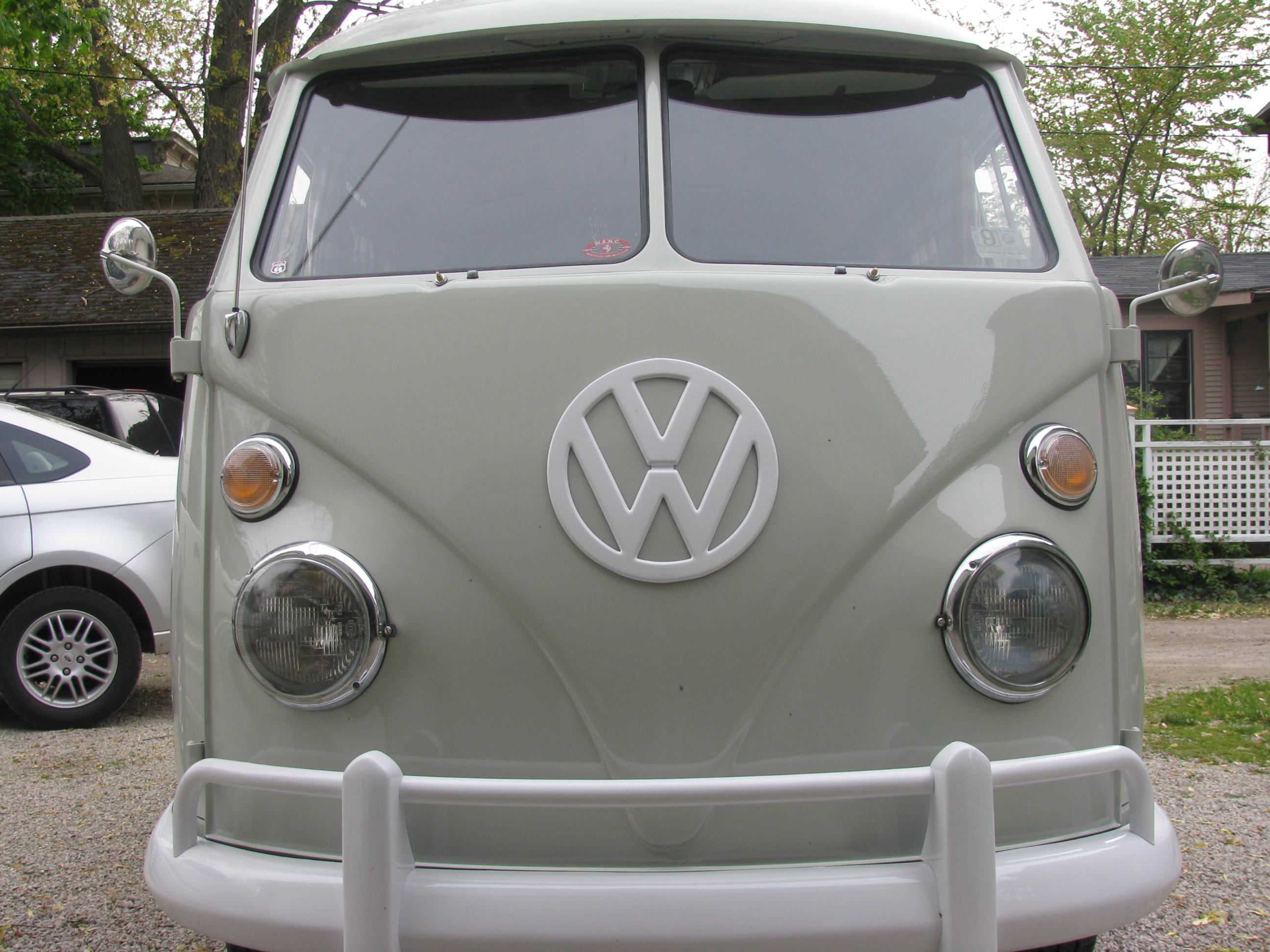

Took the Westy over today to the doctor for a nose job. Hope to have it done in time for the cruise on May 5th.

Picked up the Westy today. He did a great job on it. Can't tell it was ever hit. Got a scare on the 10 mile drive coming home though. The engine quit and I coasted over to the shoulder. Looked around and noticed that the metal inlet tube for the fuel line had popped out of the carb with the fuel line still clamped to it. Should I put some Locktite on it?
