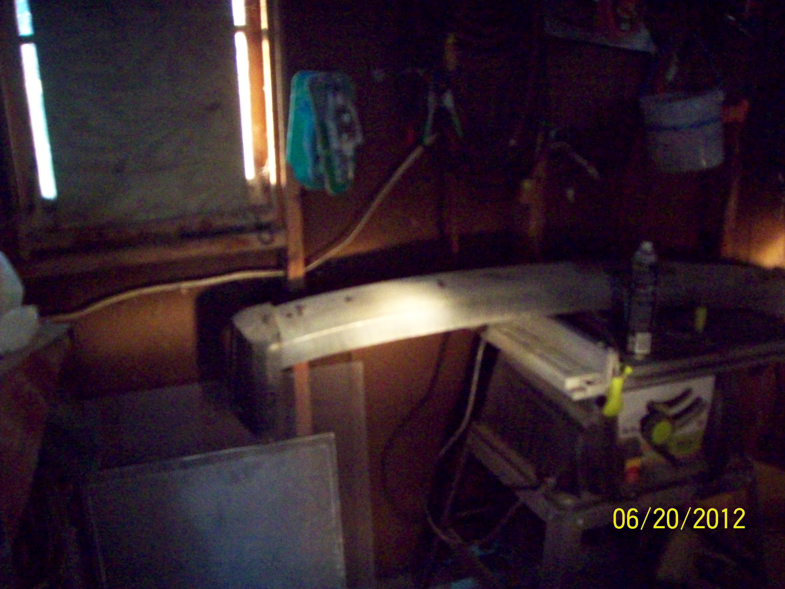

some pics of my H 4s..,there not very good pic s,but yes if you drive your vintage v w at nite especially if you drive in farm land area s,,get them,there no street lites out here..even though my h 4 s are bright i think my stock headlits are just as bright on my 04 towncar....
new ,low beam
new ,low beam
still day lite,old lite low beam
Re: H 4 upgrade?
Nice job! :D Nice picture of "bike shop Dale" too! :lol:

yes H 4 s rock.relays are installed,slightly modified to my wireing to suit my needs,all in about two hours..
Re: H 4 upgrade?
have been doing some nite driving and these lites,and they are the best,even with the high wattage lamps i have not been flashed w/brites by others.well worth the money. :!:
