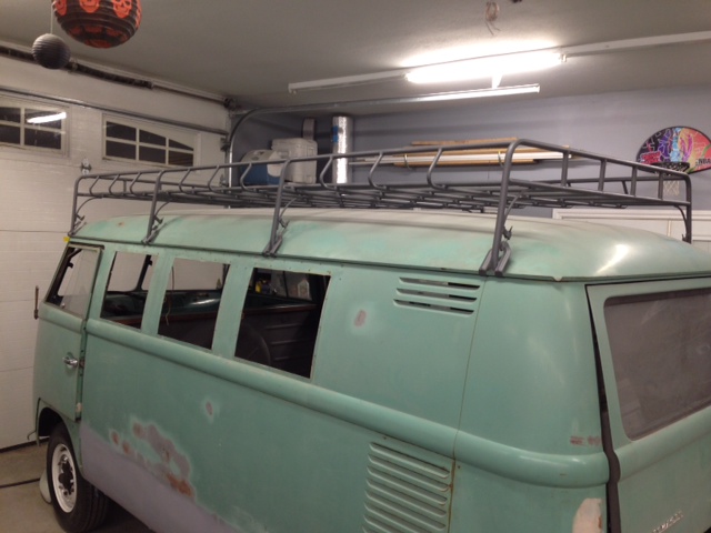

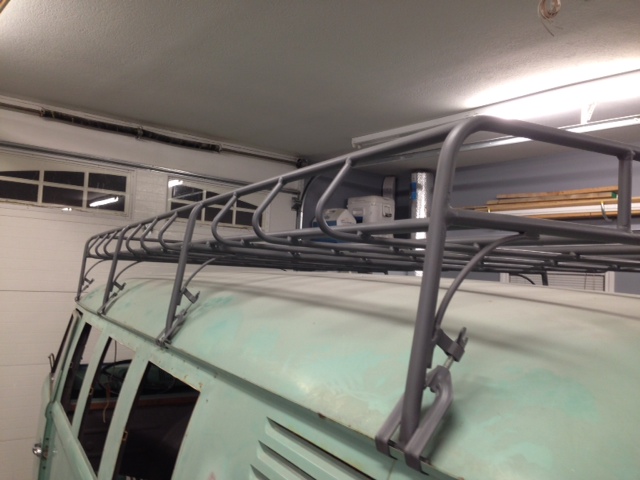

Rack finally done.
Grinded Welds , all 1000 of them and primed and painted.

CraigOnTheBoat wrote:Rack finally done.
You mean Kirk didn't grind his own welds? :roll: :lol:
It looks awesome! :D
