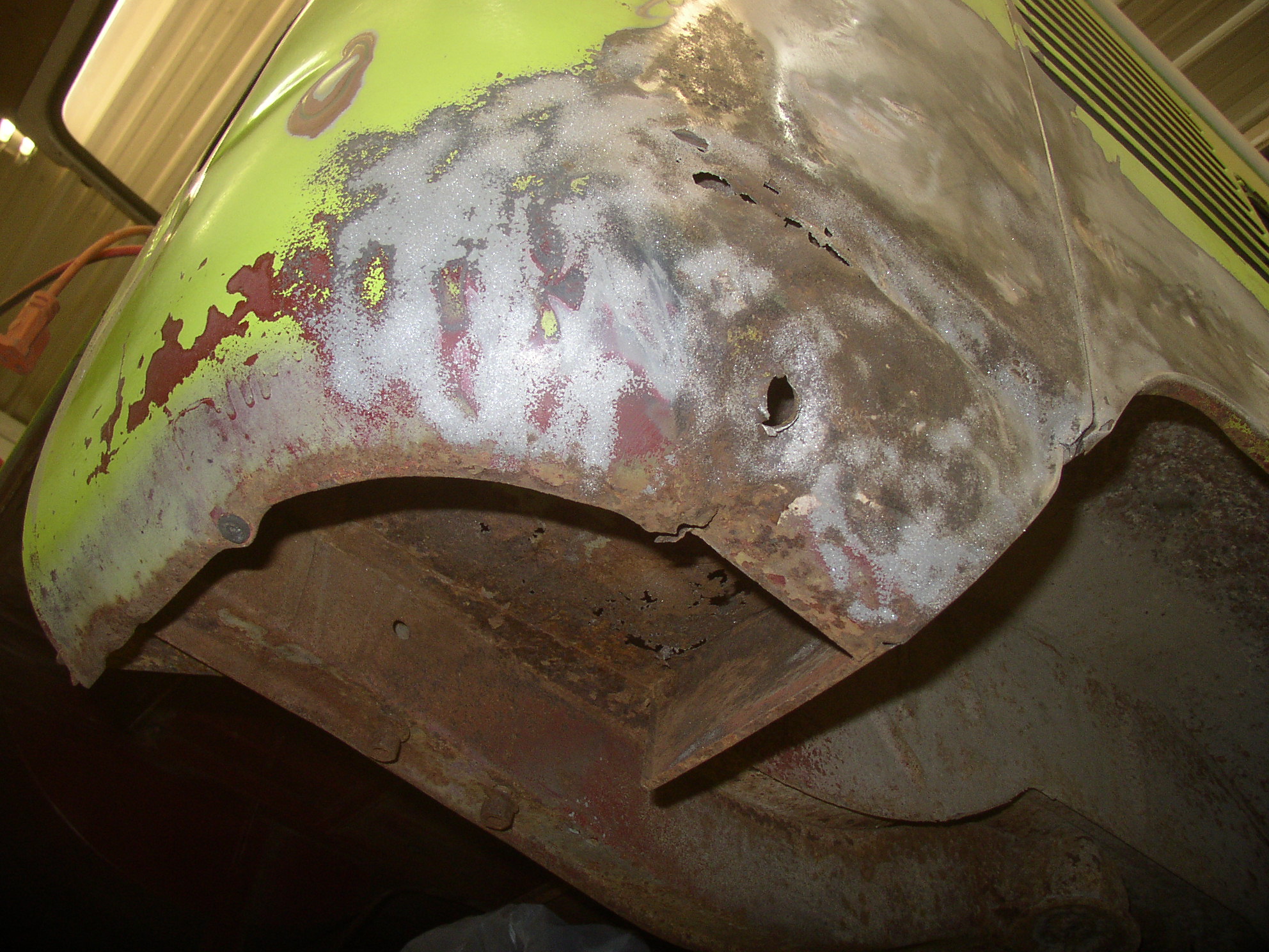

That's dirt on the roof, not dents:
It needs rockers, some floor patching but not the whole floor, and outriggers. Roof is virtually perfect, all side window frames are perfect but there is some rust under the windshield. Nose and the rest of the body has almost zero impact damage, only a couple of small bruises that are easily repairable. This is a very restorable bus and will go back red and white, originally titian red and beige.
