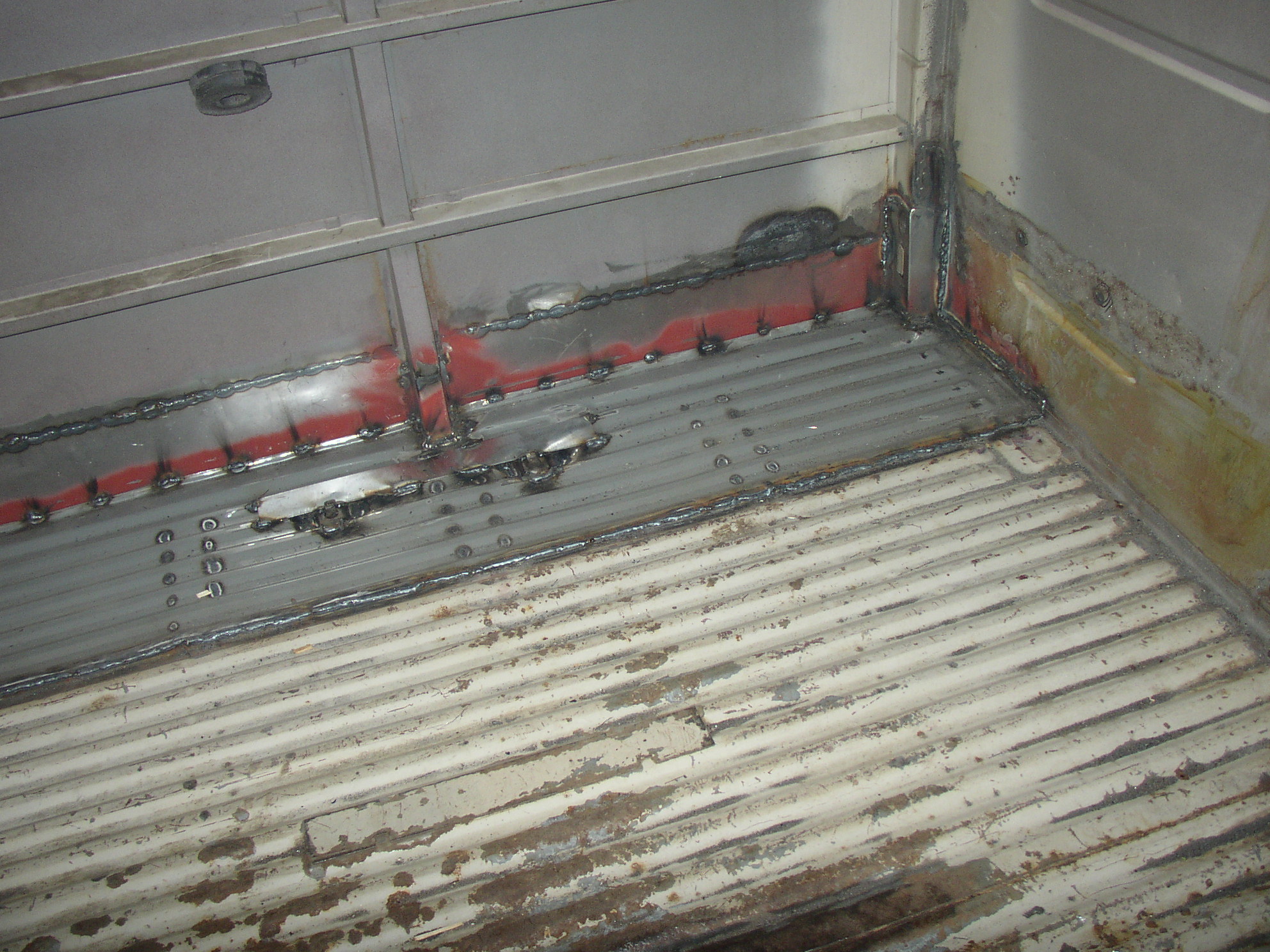

I finished the left cargo floor today, hooray! I bought a left repair half from Wolfsburg West and they sent a full left half. They did credit me partially on it, but the shipping was a killer. I have a chunk of left floor for sale if anyone needs it.
I wanted to "test" my tranny somehow before pulling the shift linkage, so Aaron donated a junk clutch disc so I could weld a fitting to it.
This allowed me to drive my tranny with a 1/2" drill, which works in all 5 gears without any appreciable noise. When the gear oil is cold, you better hang on to that drill!

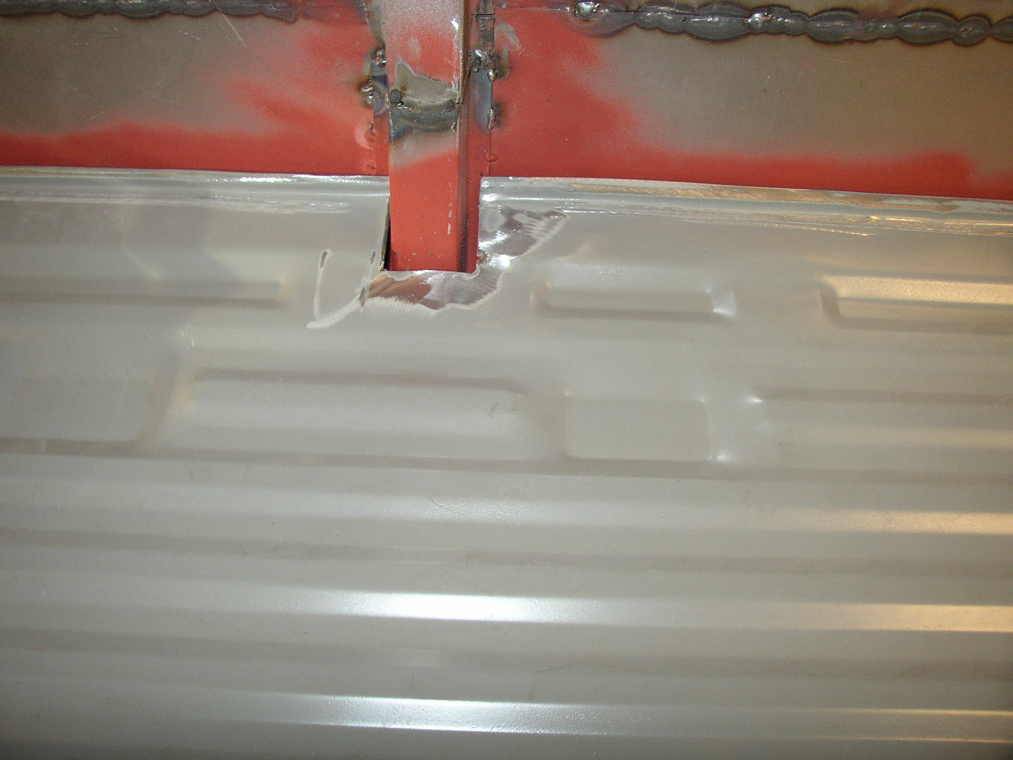

Installing the joists and uprights:
Here I'm fitting the WW floor, and there's some obvious gaps that will need to be filled in. :(
Here's the floor done with seat mount in, but I didn't have time to grind it out yet. Thankfully with the new Miller there's a lot less grinding. :)
Who knows anything about seat mounts? It appears this bus was fit with a full width middle seat? There's no middle clamp mounts, only far left and right, with two "foot plates" in the middle two spots. Is that weird for a walkthru? I think I'd prefer a 3/4 seat (like the gay bay seat I bought) so that means I need to install some clamp mounts at the 3/4 point, right? Can anyone verify this?

More shipping from Wolfsburg West :lol: You will have to get the seat mount plate and weld it in. I had to do that with Bill Duval's Deluxe. I'm sure I don't have to tell you to set the seat in to get the mount plate in the proper location.
