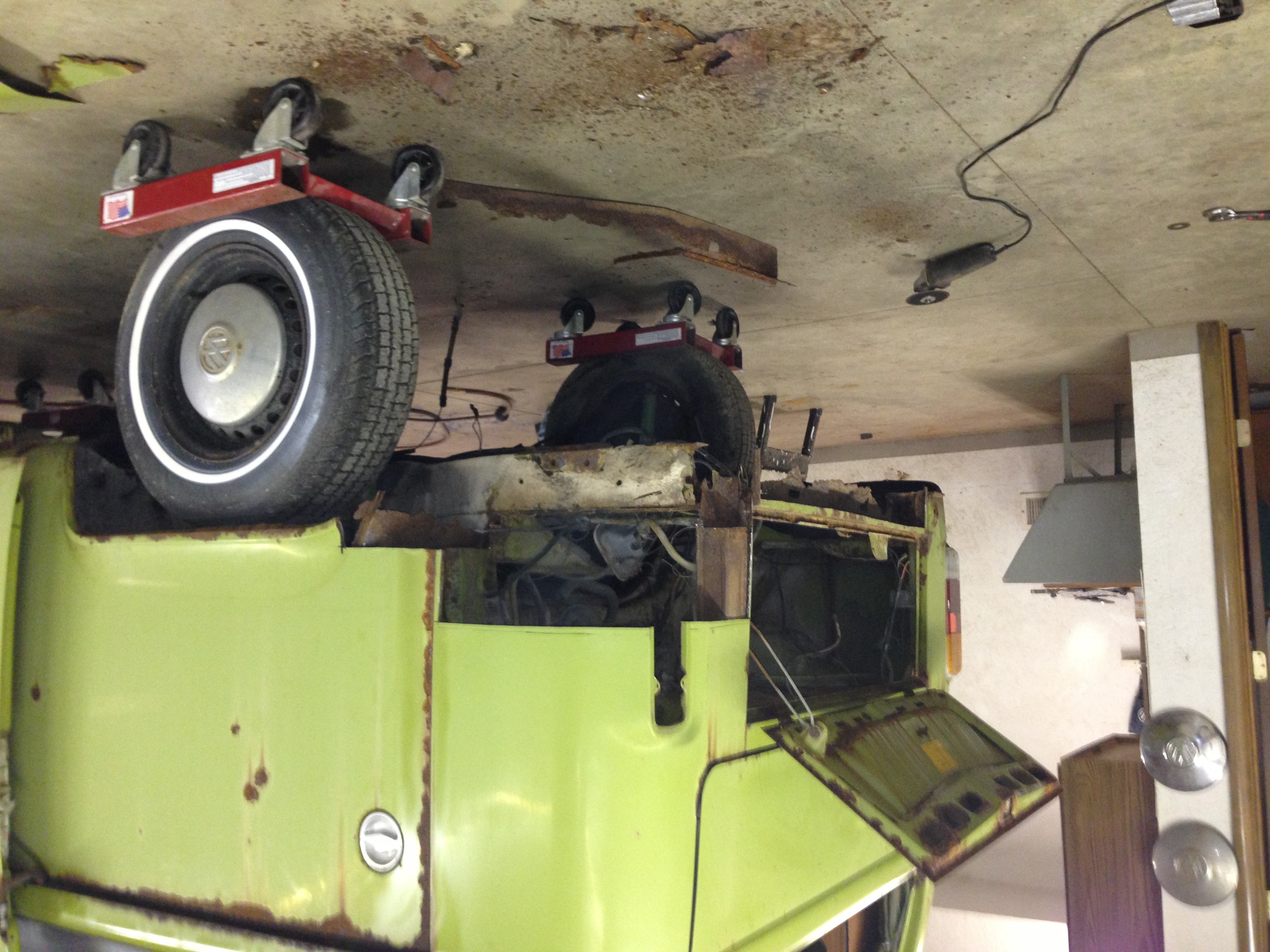

Made a lot of progress today on the body work. 90% of the undercoating is still there I had one bad area to cut out. I made the rear apron from scratch and part of the rear fender.

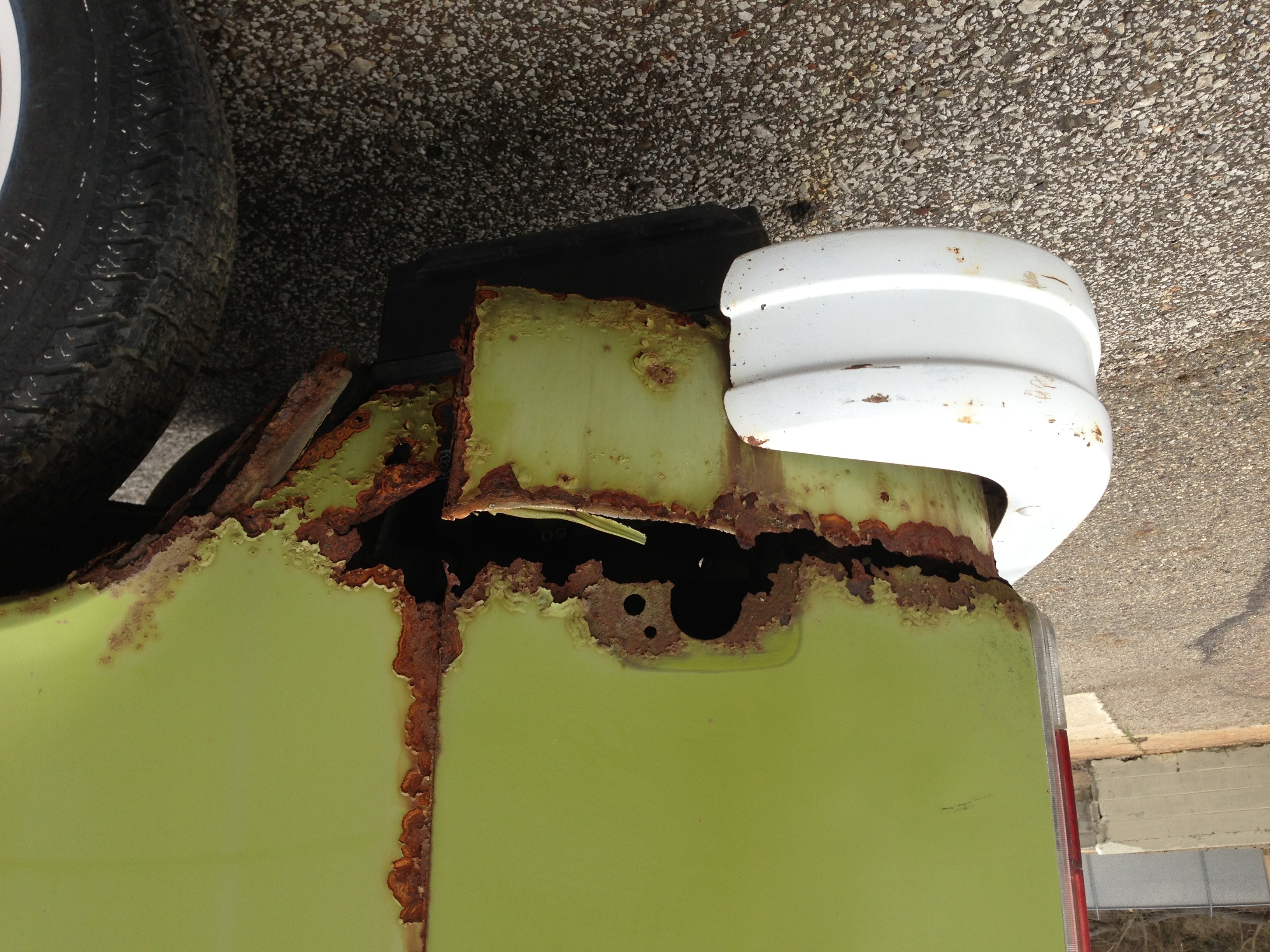

Cut out.

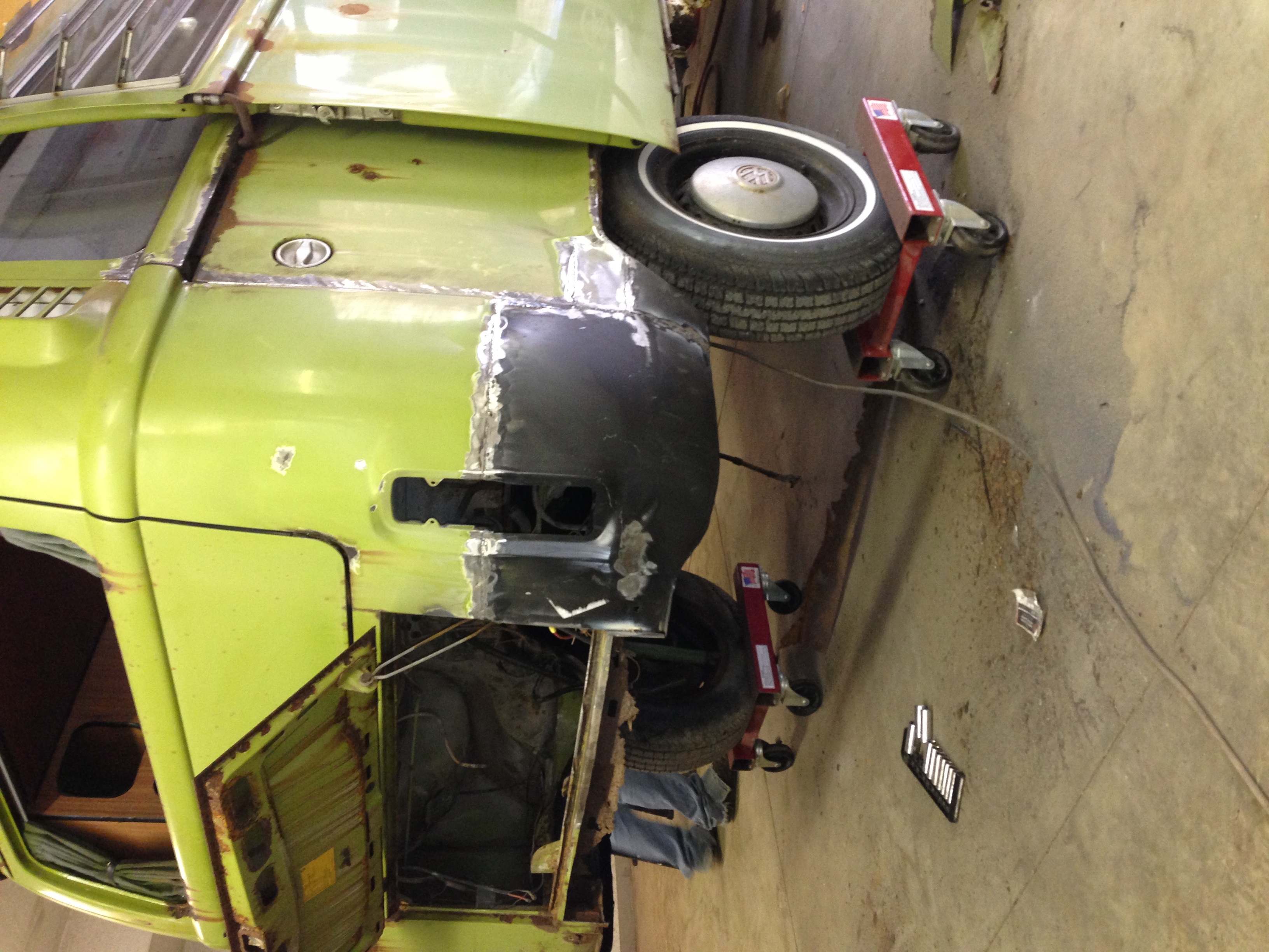

All welded in.

It's coming along nicely 8-)

I see your problem! You need to get that bus UPRIGHT!!!!

Remark wrote:I see your problem! You need to get that bus UPRIGHT!!!!
:lol: :lol:
Must be using an IPAD :lol:
Re: New bus for me :-)
:lol: :lol:
Lmao!! Im using iphone5. All my pics are upright when i loaded em? Oh well. Maybe i can edit them before i upload them so their upside down then when they make it to the site thier right side up.
