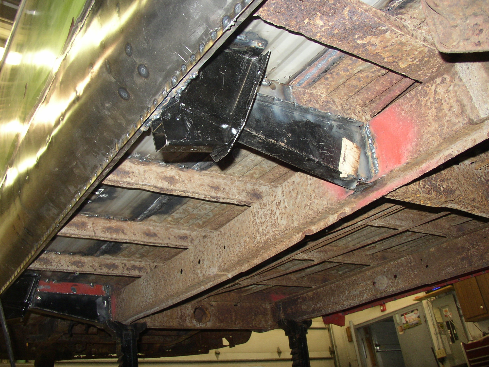

I was in Florida last week so nothing got done. I had some time this week, so I finished putting the outriggers and jackpoints on. I also took some wire rope and cleaned out the clutch tube, brake cable tubes, and throttle tube with a drill and brakeclean. I'll do the heater cable tubes later.
LR outrigger/jackpoint. I used Autocraft on the right side and "Brand X" on the left side. Sure hope I don't get a flat on the left side. The black ones feel really chincy compared to AutoCraft.

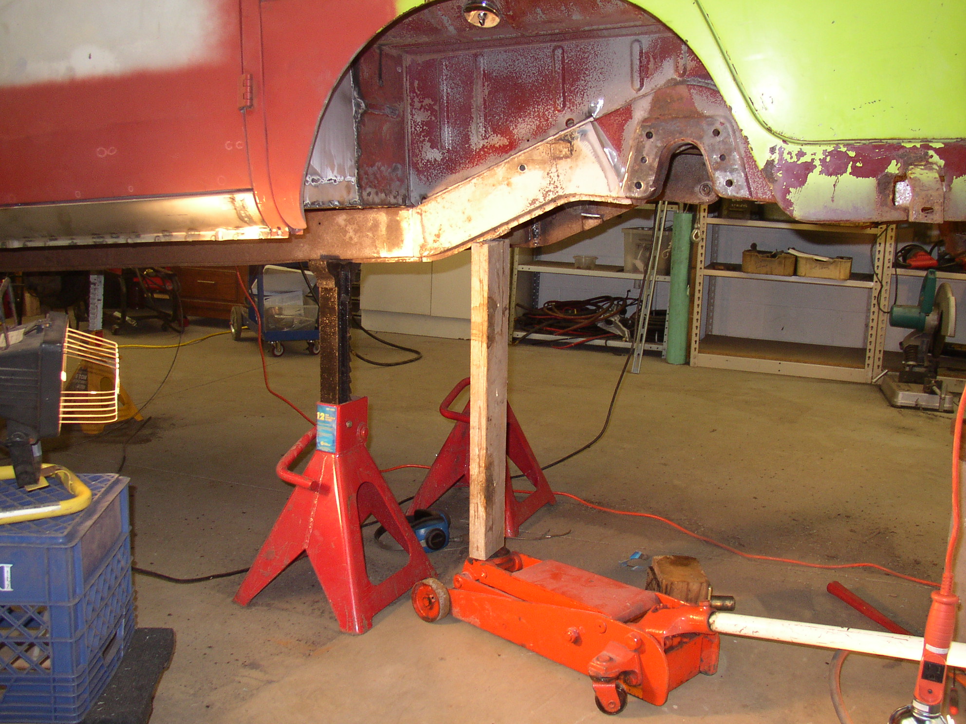

LF outrigger/jackpoint.
LF jackpoint/bulkhead, the glare in this shot makes the left rocker look pretty straight, which is not incorrect:

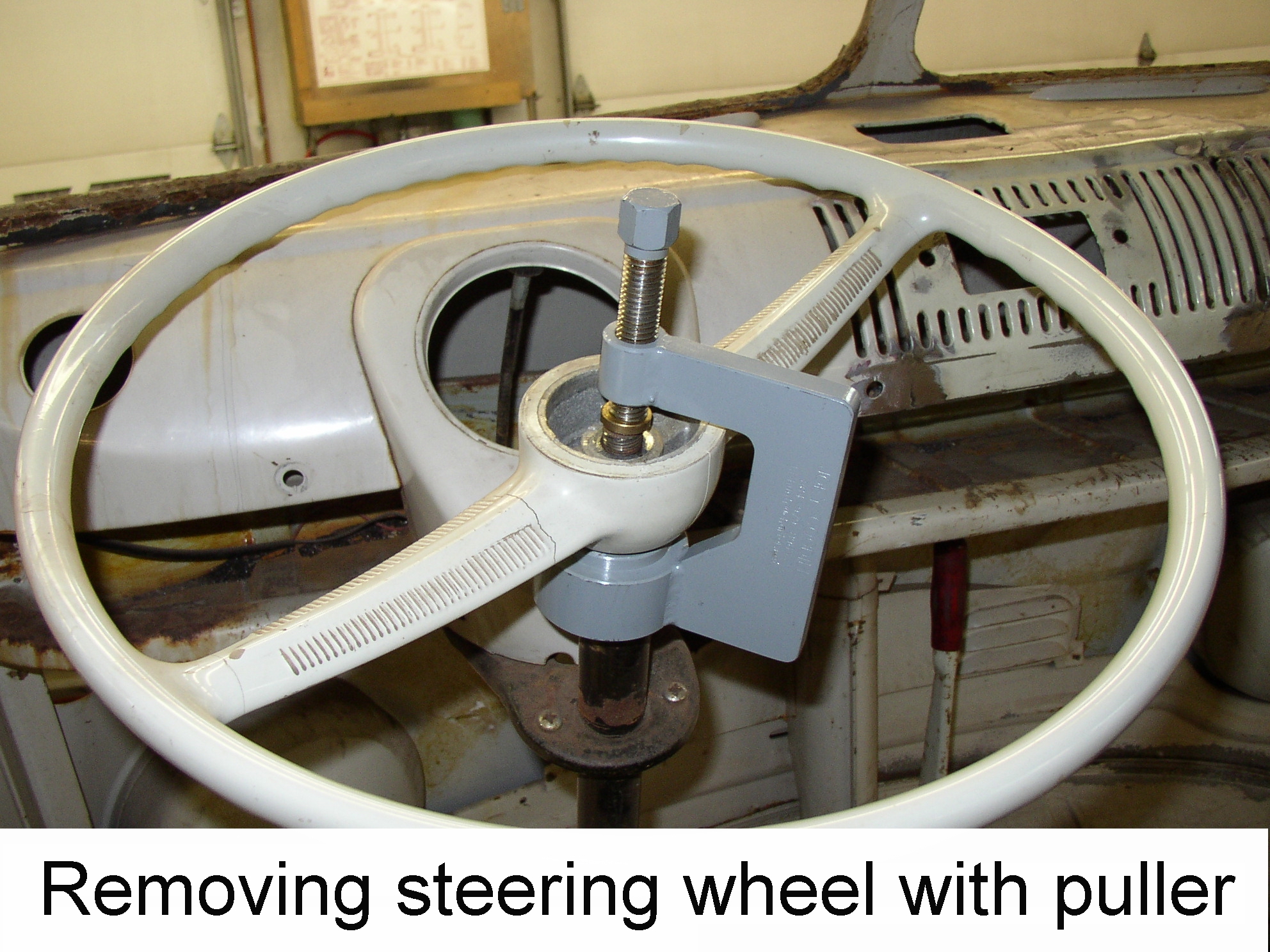

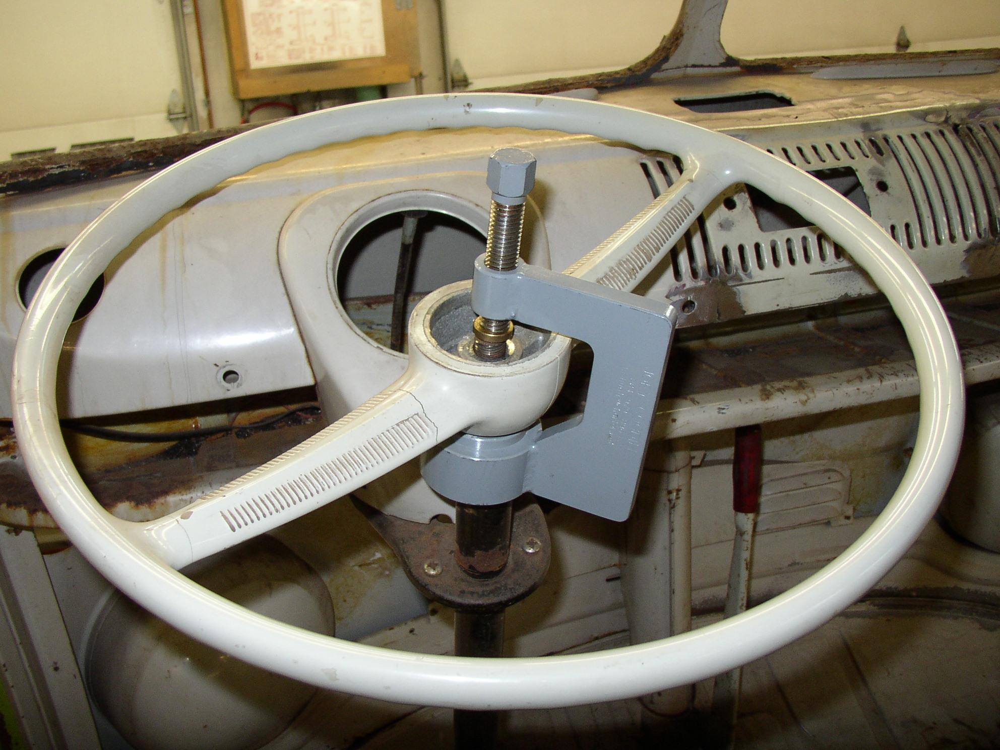

I pulled the steering wheel off with a borrowed puller (nice, eh?) and pulled the box out. It leaks so I'll open it up and at least reseal it if everything looks OK. I was fighting the brake lever pin with the torch and VGs but I didn't shoot any pics of it.

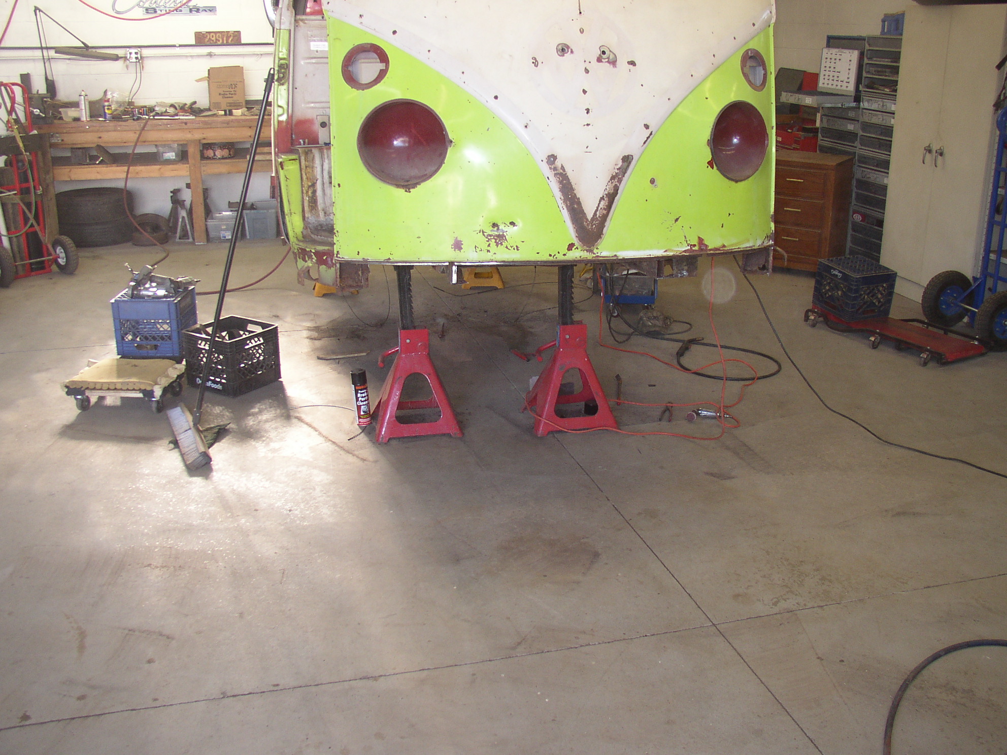

I took the column, package tray and doors off. Looking pretty empty up front right now, I can easily lift the front of the bus off the stands by hand. It's so light it's wobbly on the jackstands because there's not enough mass to keep it stable. I have a safety chain looped through the windows to an overhead beam in case I pull it off the stands while I'm working on it. Scary.
I'm roughly 180-190 hours into it, probably 3/4 of the way through the welding. I'm happy, and it's going quite smoothly in my opinion. Like I said previously, I'm revisiting skills I haven't used in decades.

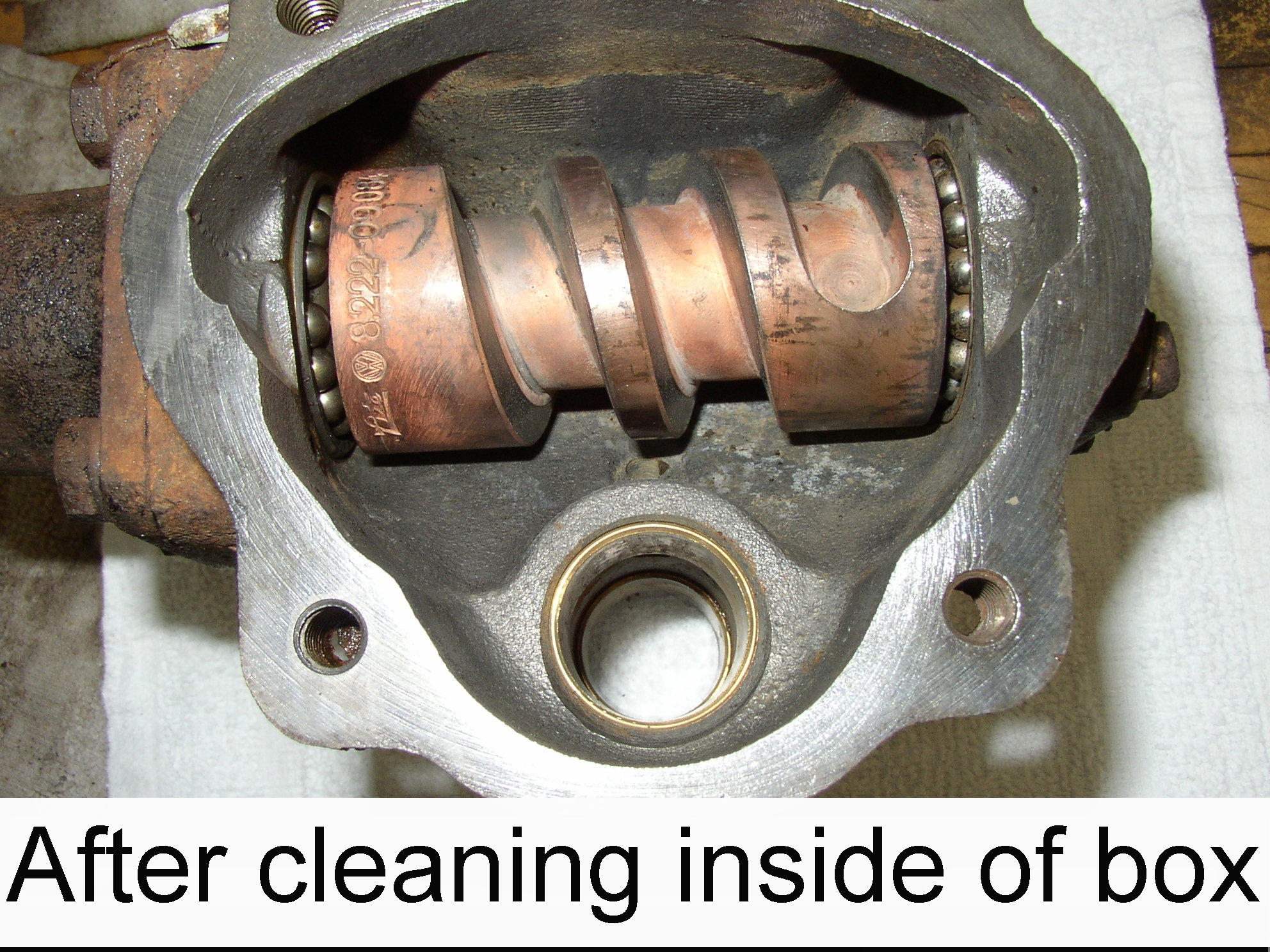

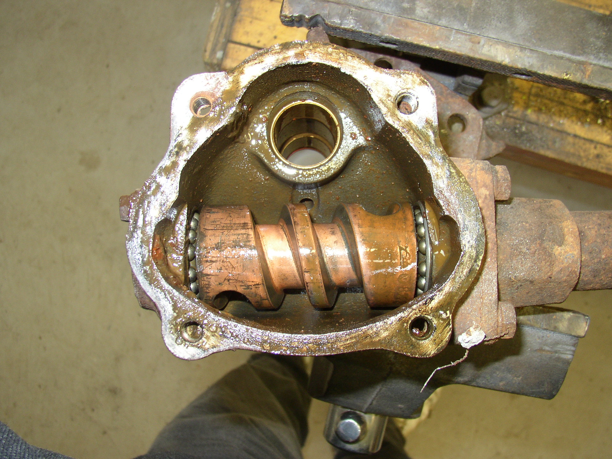

I pulled the steering box apart to make sure things were OK inside, and to clean the pitman shaft before putting a seal on it. I drained the oil which was really ugly with traces of water. If you guys haven't ever changed your steering box oil you might want to think about it!
I didn't know if the pitman arm was indexed onto the pitman shaft or not (most are) so I figgered I'd shoot a couple of reference pics of the arm at each lock point. Good thing I did, 'cause the pitman shaft is NOT indexed to the shaft....

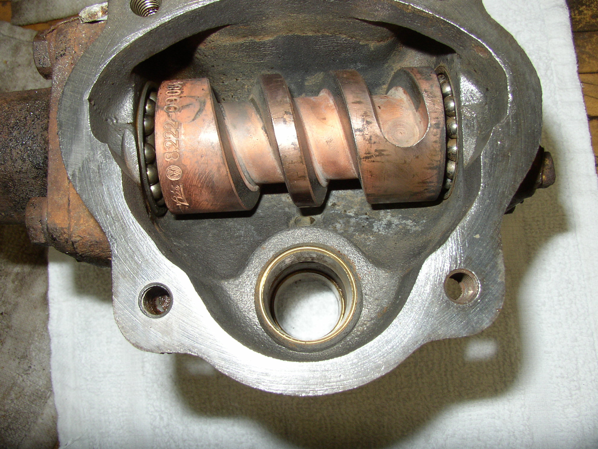

Once I got the cover off and looked inside, it was yucky but still usable after cleaning up with brakecleaner:
There was evident of water inside, but not enough rust to get excited about:

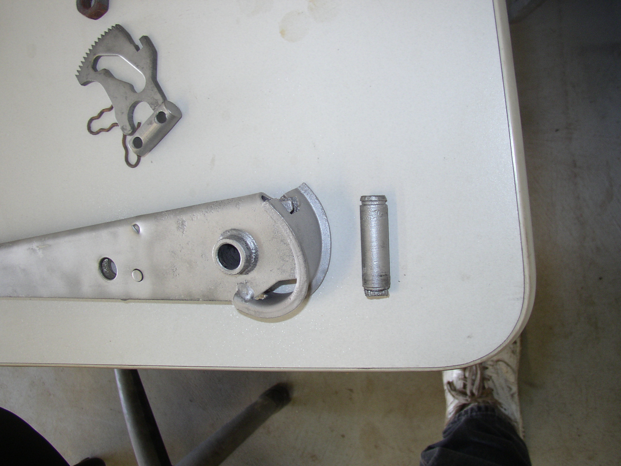

This little pin for the parking brake lever was a true MF, it took a couple of glow-twist-tug-pry sessions to get the little bastard out. On Samba it seems like they usually use a Sawzall or hacksaw to cut the pin but I didn't want to resort to that.
Oddly, once beadblasted, the pin falls right into the lever and is almost reusable.

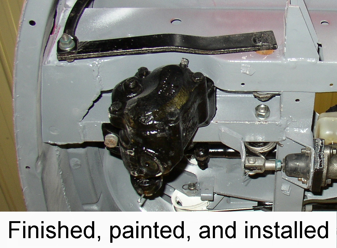

I cleaned stuff up and resealed the steering box. Local bearing places did not have the seal in stock and wanted to charge me freight to get it in, so it was cheaper to buy it off of Ebay for $12 delivered. Strange how that works......
Box looks like new inside once cleaned up.
Cleaned the seal bore with a wire brush in a drill, it and the bushings look like new.
Cleaned the pitman shaft with 400 grit. There's still a slight line where the seal rides, but it will be fine on a manual box.
Tapped the seal in place with a seal driver and some High Tack.
The box cover does not get a gasket so I used High Tack like it's an engine case half.
Done, filled with oil, and ready for final clean, blast, and paint. It has a high spot in the center so I adjust it just like any other American box, (it's an ATE/Ross box!) to zero lash on the high spot. (pitman arm zero side play- no "click")

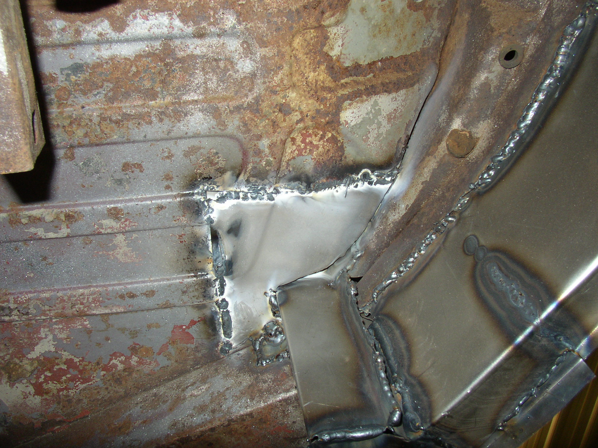

Left side, A pillar done, floor done, weatherstrip rail done. Not pretty, but functional.
