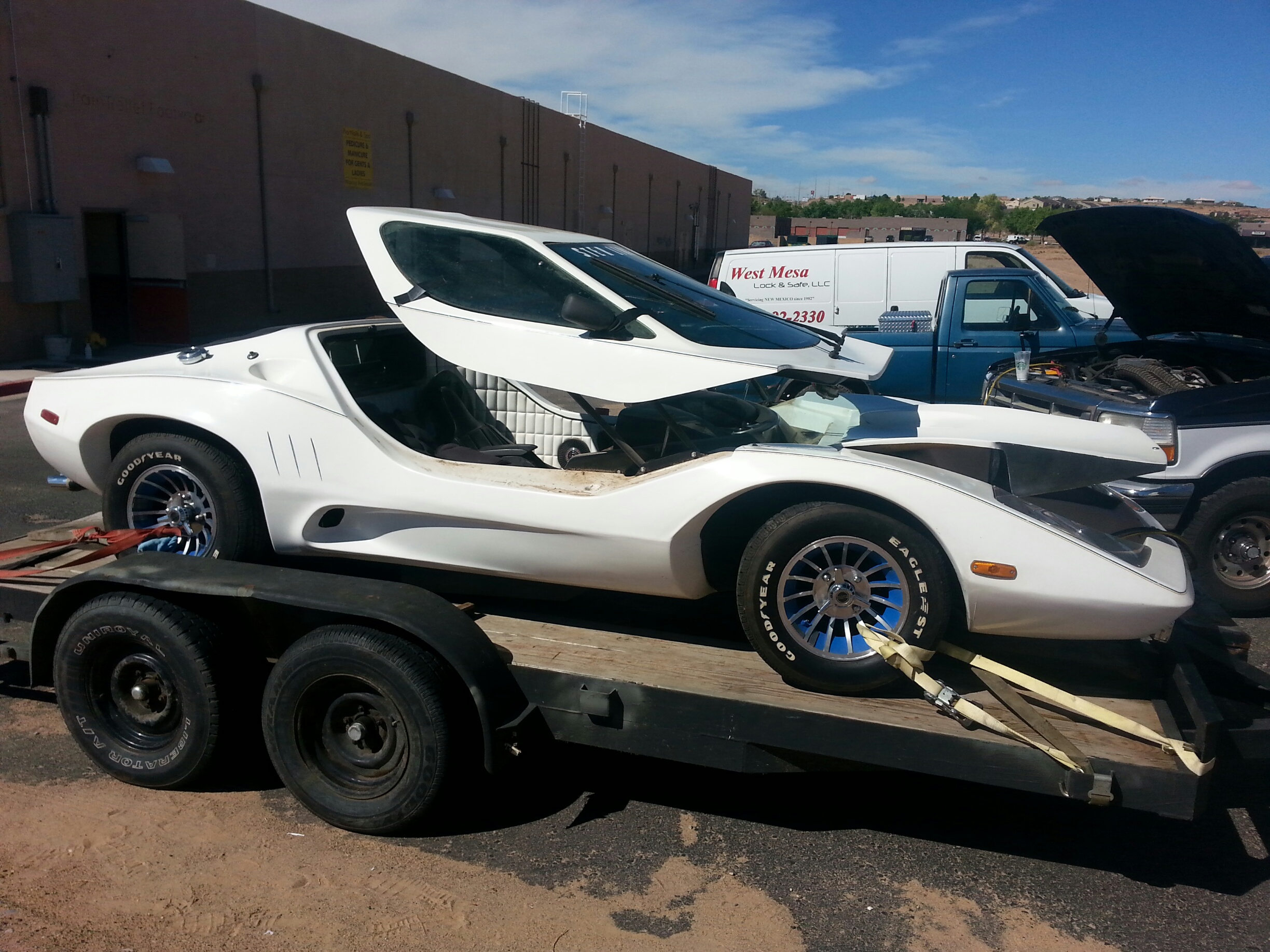

76 vw sterling nova kit car
my little brother just picked up this car from nm. our grandfather helped build it,took best in show in the 80's at some museum car show... got parked in the garage.shortly after the owner "mark" went missing and has never been found? I think like 28 years a go.. it sat in there ever since like a ghost in the shadows of a creepy ass old garage...marks mother barb I think Is bitter sweet about letting it go but I think she will find some peace after she see's her sons dream come back to life..Ill post some pics when my bro gets home..
